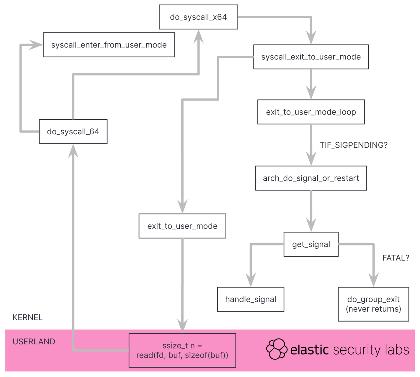

Signals can’t be handled online; instead, they must be post-processed at safe points. By online we mean: If I'm doing a system call, and a SIGKILL arrives, I cannot just cease to exist. Signals must be checked at safe points, and in most UNIXes this is done before returning to userland.
The check for signal pending is done after running the system call at exit_to_user_mode_loop(). If TIG_SIGPENDING is set in the current task structure, the process branches into the signal handling code. When SIGKILL (a fatal signal) is pending, the process branches into do_group_exit() which never returns, resulting in the end of the process.

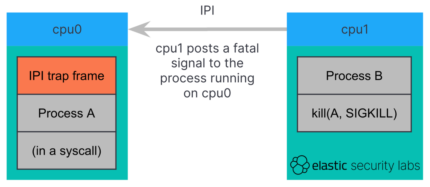

Signals must be post-processed and handled at safe points, otherwise the kernel would have to account for the process involuntarily exiting due to a fatal signal. We can conduct a thought experiment and imagine an implementation that attempts to process signals the moment they arrive. This could be implemented by interrupting the running process and forcing it to exit from the interrupt context, for example:
  • Process A running on cpu0 performs a system call
  • Process B running on cpu1 sends a SIGKILL to process A
  • An IPI would be sent from cpu1 to cpu0
  • cpu0 would trap into an interrupt frame, realize it is here due to a signal being sent, and perform an exit of the current process
Thankfully this is not the case, you cannot exit from an interrupt context – furthermore, this couldn’t be implemented without introducing significant changes to resource management. When a process exits, it must release any resources – like locks, reference counts, or any other kind of mutable data that may be influenced by the exiting process.

Let us follow the lifecycle of a SIGKILL originating from an eBPF program until the process is terminated.
When an eBPF program calls the special helper bpf_send_signal(SIGKILL) we end up in bpf_send_signal_common(SIGKILL, PIDTYPE_TGID). PIDTYPE_TGID is the "task group id" and it specifies that any task (meaning any pthread) of the current process may accept the signal. But eBPF also provides bpf_send_signal_task() which sends the signal only to the current task by specifying PIDTYPE_PID instead.
bpf_send_signal_common() has to be used with caution because it must be able to generate a signal from any point in the kernel where you can attach an eBPF program; which is tricky work that has resulted in some past bugs like this deadlock. This is an interesting imposition created by eBPF; before it, signals generated from the kernel were done so in controlled points.
Most of the heavy lifting of posting a signal is done in __send_signal_locked() and complete_signal() and we get there through the following stack:
complete_signal()          ^
__send_signal_locked()     |
do_send_sig_info()         |
group_send_sig_info()      |
bpf_send_signal()          |
static int __send_signal_locked(int sig,
    struct kernel_siginfo *info, struct task_struct *t,
    enum pid_type type, bool force)
In our case, in __send_signal_locked: sig is SIGKILL, info is SEND_SIG_PRIV, t is the current task (the running thread), type is PIDTYPE_TGID and force is true, which is always set when info is SEND_SIG_PRIV, this means this is a signal originating from the kernel, not from some userland program.
__send_signal_locked() will register a SIGKILL as pending inside a structure of the current task (our t), which is a process-wide structure shared by all tasks (pthreads) in this process (since we're using PIDTYPE_TGID), and control is then passed to complete_signal().
SIGKILL is a bit special in complete_signal() as it is a fatal signal, the pending signal bit that was set in the shared structure of the process will then be replicated to a per-task pending set. This means a SIGKILL is marked as pending for every pthread of the current process.
complete_signal() then wakes up all threads via signal_wake_up+signal_wake_up_state() so that they can be terminated. Each thread must terminate on its own and send a signal politely asking the thread to “please exit next time instead of returning to userland”.
In the signal_wake_up() stack, a flag TIG_SIGPENDING will be set, warning the task to check its pending signals. It might be that the thread is in userland at the time we try to wake it up, even worse it might be infinitely looping. In that case, it would not enter the kernel until the scheduler decides to preempt it or an interrupt fires. This case is avoided by forcing the thread to enter the kernel via kick_process(), which sends an IPI to the remote CPU, forcing it to trap the process into the kernel, which will then try to return to userland, check TIG_SIGPENDING, find a SIGKILL, and terminate.
