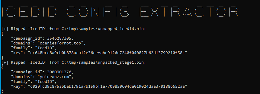

Usage
All samples need to be unpacked prior to execution extraction attempts.
We can either specify a single sample with -f option or a directory of samples with -d.
docker run -ti --rm -v $(pwd)/data:/data icedid_loader_config_extractor:latest -d "C:\tmp\samples"
ICEDID configuration extractor
You can collect the extracted configurations from the directory you set when running the extractor.
