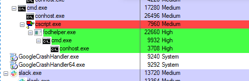

Example of cscript.exe running as Medium spawning a cmd.exe instance with High integrity via a UAC bypass:

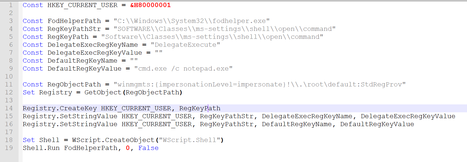

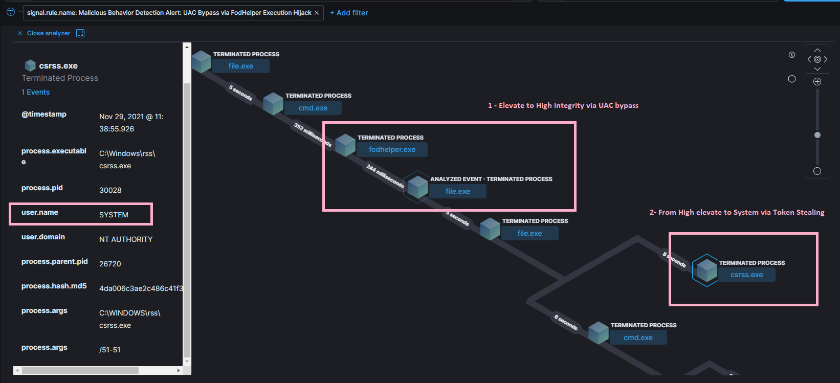

For instance, when fodhelper (a Windows binary that allows elevation without requiring a UAC prompt) is launched by malware as a Medium integrity process, Windows automatically elevates fodhelper from a Medium to a High integrity process. The High integrity fodhelper then attempts to open an ms-settings file using its default handler. Since the medium-integrity malware has hijacked this handler, the elevated fodhelper will execute a command of the attacker’s choosing as a high integrity process.
Below is an example of Glupteba malware leveraging this method to first elevate from a Medium to High integrity process, then from High to System integrity via Token Manipulation (token stealing):

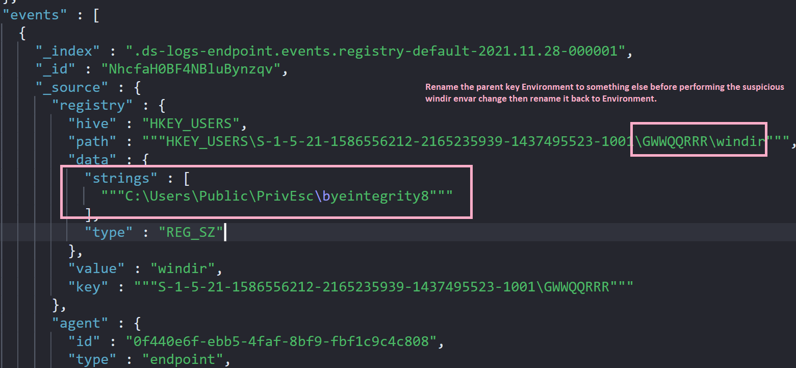

An example of a UAC bypass that manipulates the Windows environment variables registry key is byeintegrity5. To illustrate this, this bypass uses this primitive to redirect the normal execution flow of the CDSSync scheduled task (set to Run with highest privileges) and elevate the integrity level as shown below.
When the CDSSync scheduled task is run, taskhostw.exe will try to load npmproxy.dll from the %windir%\System32 folder, but because the malware controls %windir%, it can redirect taskhostw.exe to load a DLL named npmproxy.dll from a path it controls as shown below.
UAC bypasses based on environment variable manipulation often work when UAC is set to Always Notify (the maximum UAC level) as they often don’t involve writing files to secured paths or starting an autoElevated application. Changes to SystemRoot or Windir from the current user registry to non-expected values are very suspicious and should be a high-confidence signal for detection.

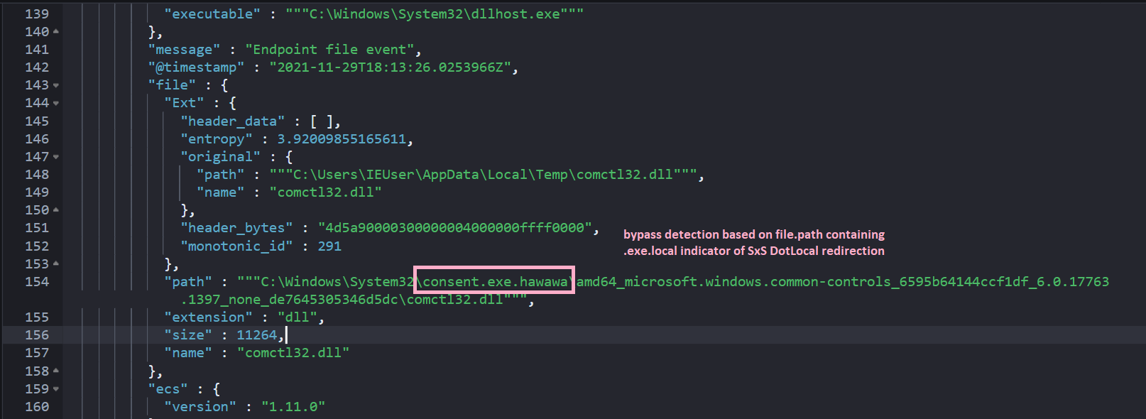

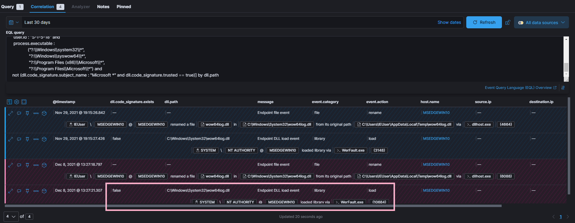

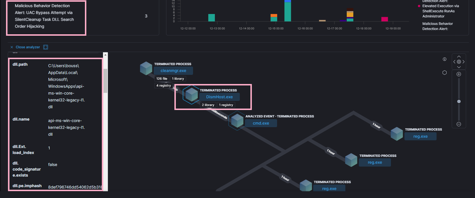

This is an example detection of UACME 30 sideloading wow64log.dll into an instance of WerFault.exe running as System (which provides a good direct jump from Medium to System integrity) shown below.
If UAC is set to Always Notify,then finding a missing DLL or winning a file write race condition into a path writable by a Medium integrity process is a valid option. This is an example of UAC bypass hijacking the SilentCleanup scheduled task (via a file write race condition) which spawns a high integrity descendant process DismHost.exe executing from an AppData subfolder (writable by Medium integrity) and this is another variation that abuses the same task but for a missing dependency. api-ms-win-core-kernel32-legacy-l1.dll.
Another DLL Hijack primitive that can achieve the same goal is to use DLL loading redirection via creating a folder within the same directory of the targeted elevated program (e.g. target_program.exe.local and dropping a DLL there that will be loaded instead of the expected one).
This technique can be also used as a primitive for local privilege escalation in the case of a vulnerability that allows the creation of a folder (with a permissive Access Control List) to a controlled location such as described by Jonas Lykkegård in this blog From directory deletion to SYSTEM shell.

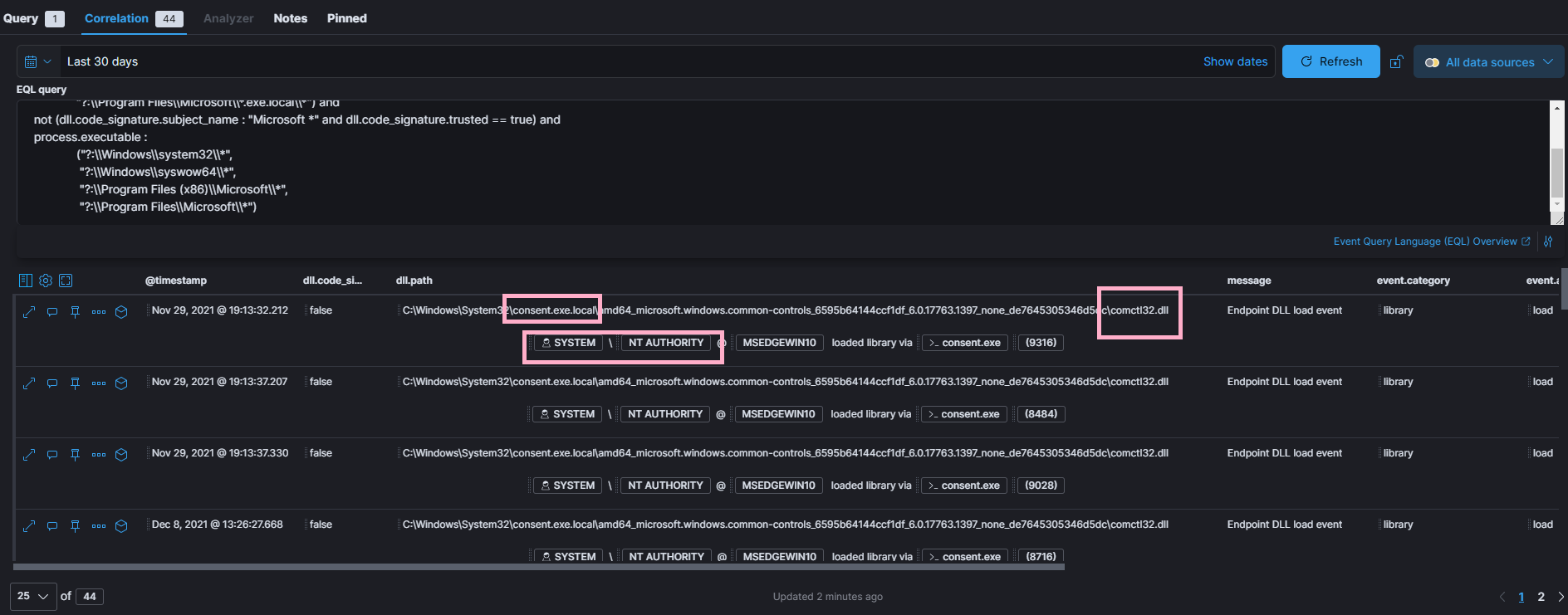

This query matches on UACME method 22, which targets consent.exe (executing as System), tricking it into loading comctl32.dll from the SxS DotLocal directory instead of System32:

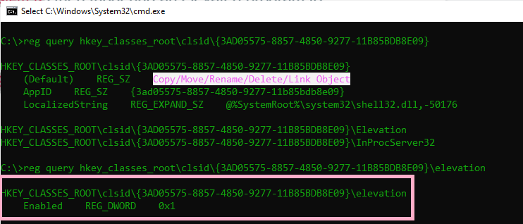

From a behavior perspective, usually, those COM interfaces will be executed under the context of dllhost.exe (COM Surrogate) with process.command_line containing the classId of the targeted COM object, this will usually result in the creation of a high integrity child process.
Below are examples of different malware families adopting this method for UAC bypass (such as DarkSide and LockBit ransomware families) to elevate integrity level before launching the encryption and evasion capabilities, which is good prevention choke point:

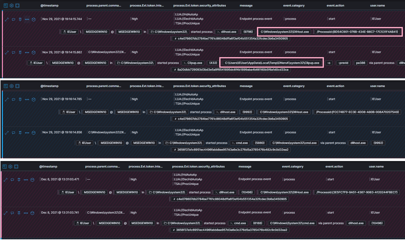

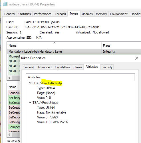

An insightful observation was made by James Forshaw for the possibility of leveraging process token security attributes to identify processes launched as descendants of an auto-elevated application.
ProcessHacker also captures this type of information. Below is an example of Token Properties for a notepad.exe instance launched via the fodhelper UAC bypass.
The LUA://HdAutoAp attribute means it’s an auto-elevated application (populated also for elevated COM objects and AppInfo hardcoded whitelisted processes). LUA://DecHdAutoAp means it’s a descendant of an auto elevated application, which is very useful when tracking the process tree generated via a UAC bypass.
Elastic Endpoint security 7.16 and above capture this information with process execution events (process.Ext.token.security_attributes) which open up the opportunity to hunt and detect UAC bypasses hijacking the execution flow of an auto-elevated program or COM Interface with no prior knowledge of the bypass specifics (targeted binary, COM Interface, redirection method, and other important details):
Suspicious Auto Elevated Program Child Process:

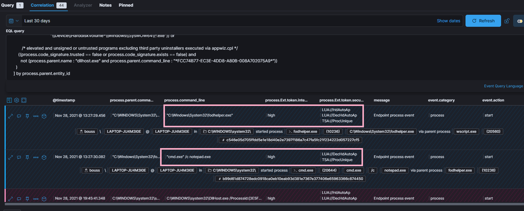

The above query also matches on all the descendants of a UAC bypass and not only the direct child process.
Here we can see this approach detecting the fodhelper execution flow hijacking via registry key manipulation:
Here is an example of this matching UAC Bypass by Mocking Trusted Directories.

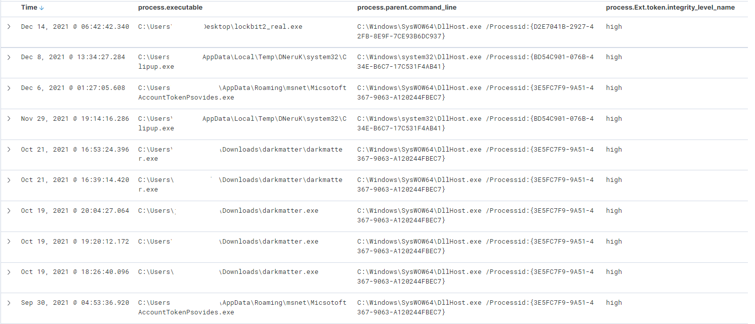

Below are examples of matches for 3 different UAC bypasses via Elevated COM Interface:

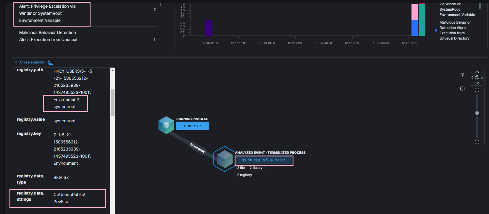

Here is an example of registry key path monitoring evasion via key rename (byeintegrity8).

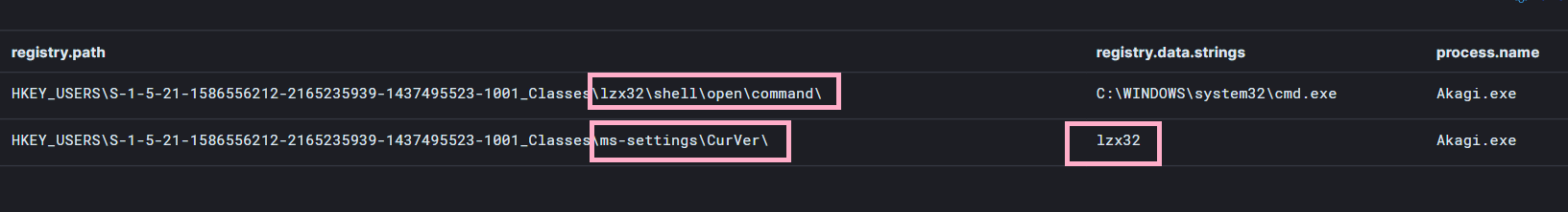

Another interesting evasion trick that was added recently to UACME v.3.5.7 is the CurVer subkey, which can be used to redirect the shell Default handler. This effectively bypasses detections looking for hardcoded suspicious registry path/values:

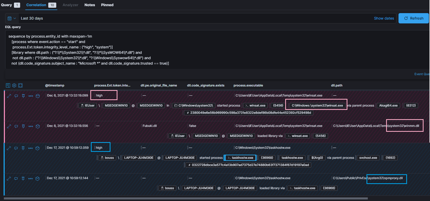

For file-based detection related to DLL hijacking, it is better to use DLL load events (Elastic Endpoint Security 7.16 logs non-Microsoft signed DLLs). For registry ones, a mix of registry.data.strings, and value names should be a bit more resilient than the full key path.
The example EQL correlation below shows how to detect DLL loading from a directory masquerading as System32 (i.e as a result of windir/systemroot environment variable modification):
EQL search - Detect redirection via rogue Windir/SystemRoot

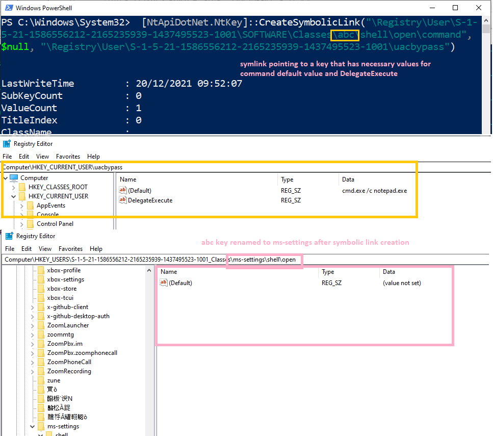

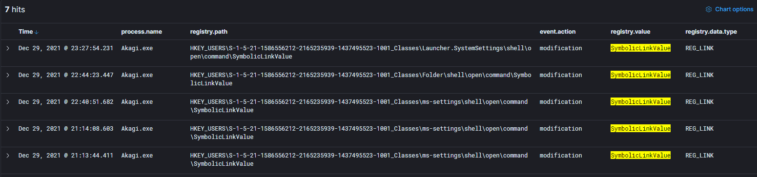

This example shows matches for 2 different techniques (registry key manipulation and DLL hijack via fake Windir):
The next example combines a registry symbolic link and registry key rename to evade fodhelper UAC bypass detection based on registry key changes monitoring (ms-settings or shell\open\command):
UACME v.3.5 and above implements this evasion for methods involving registry key manipulation.
You can hunt using Elastic Endpoint or Sysmon logs registry symbolic link creation by looking for registry modification with value name equal to SymbolicLinkValue.
An example KQL query to detect this evasion is: registry.value :"SymbolicLinkValue" and registry.key :S-1-5-21-15Classes\\*`:
