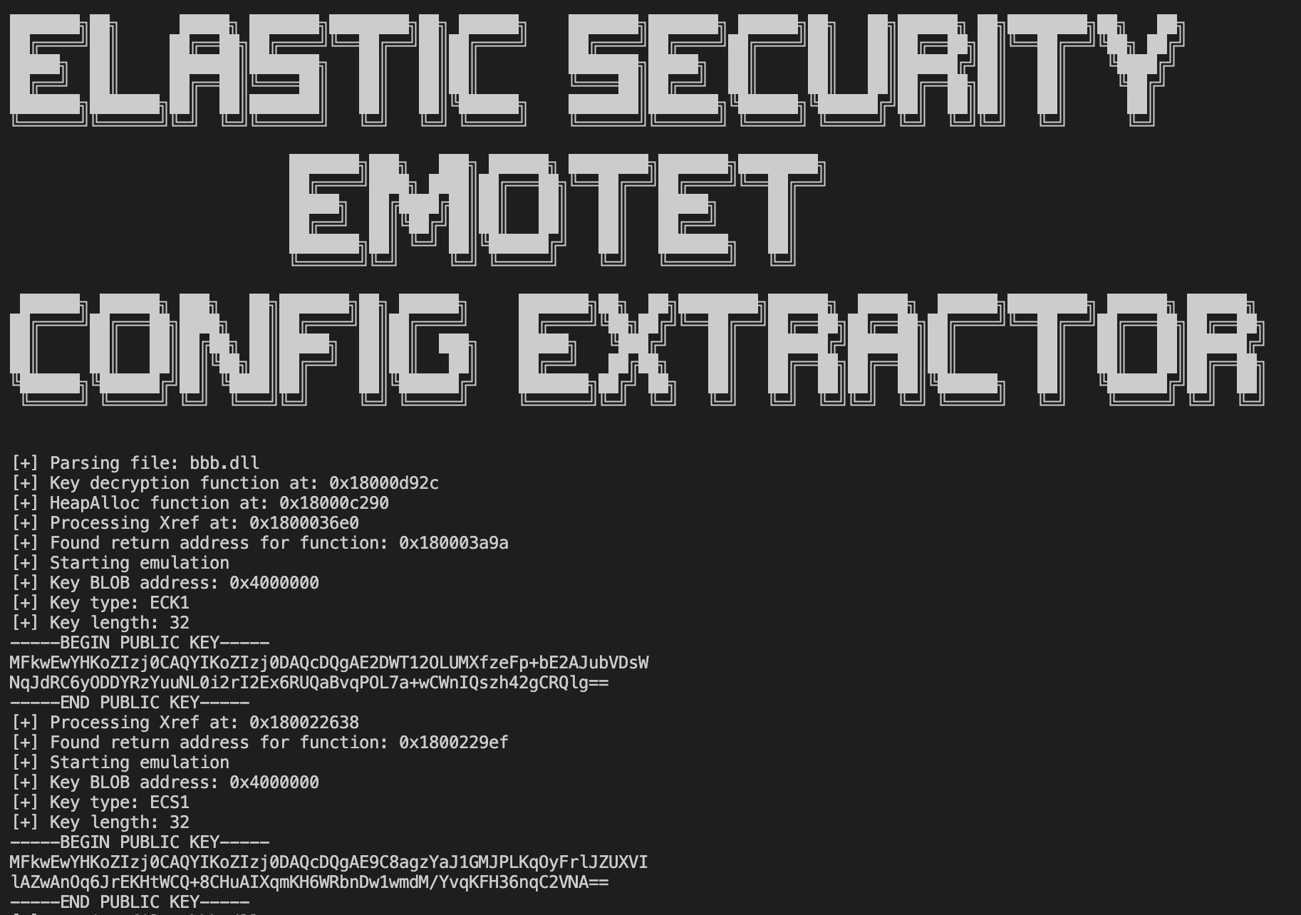

docker run -ti --rm -v $(pwd)/data:/data emotet-config-extractor:latest -d "C:\tmp\samples"
EMOTET configuration extractor
You can collect the extracted configurations from the directory you set when running the extractor.
