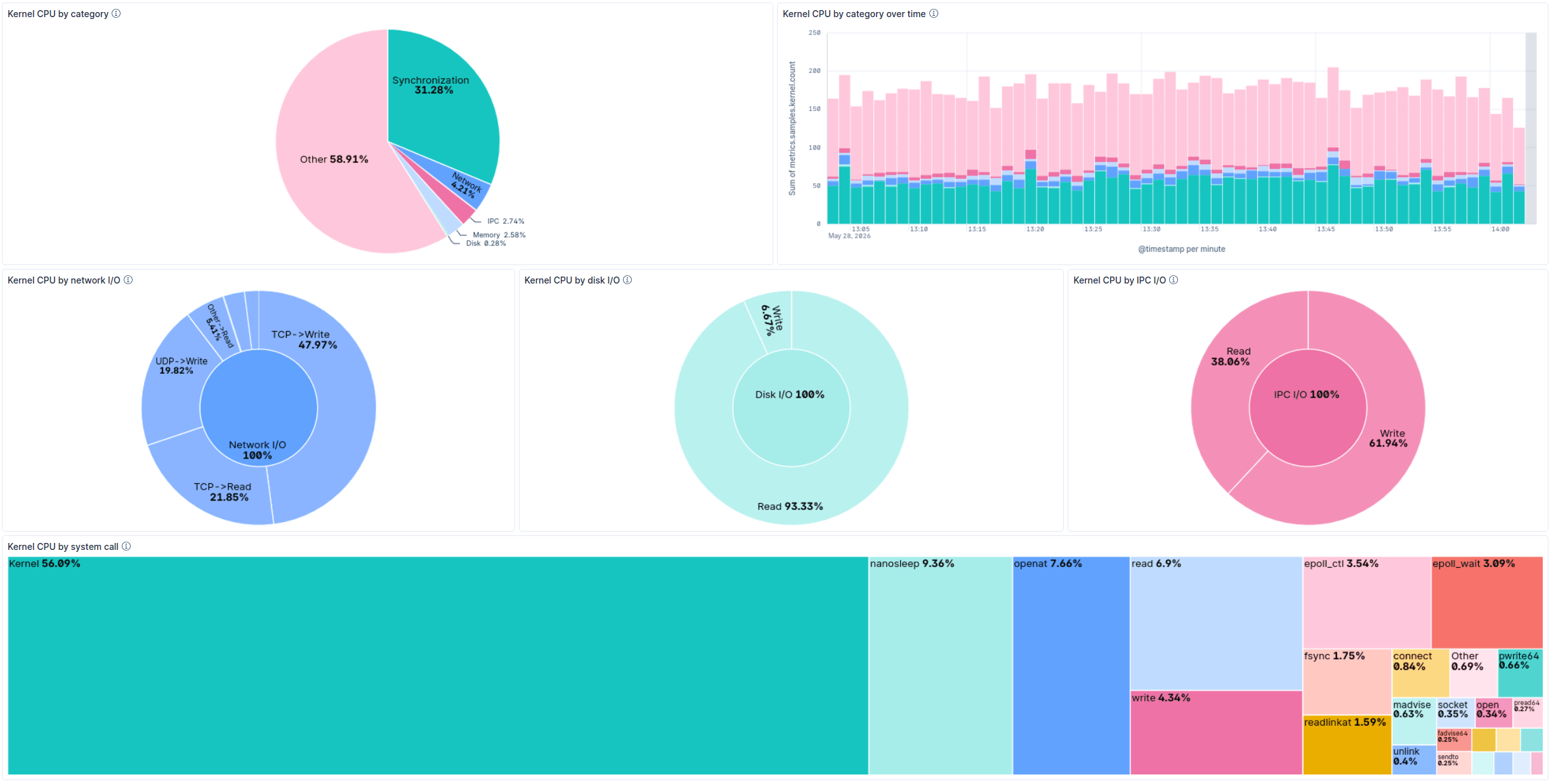

kernel.countKernel leaf framessyscall, category (disk/rw, ipc/rw, network/{tcp,udp,other}/rw, memory, synchronization, …)

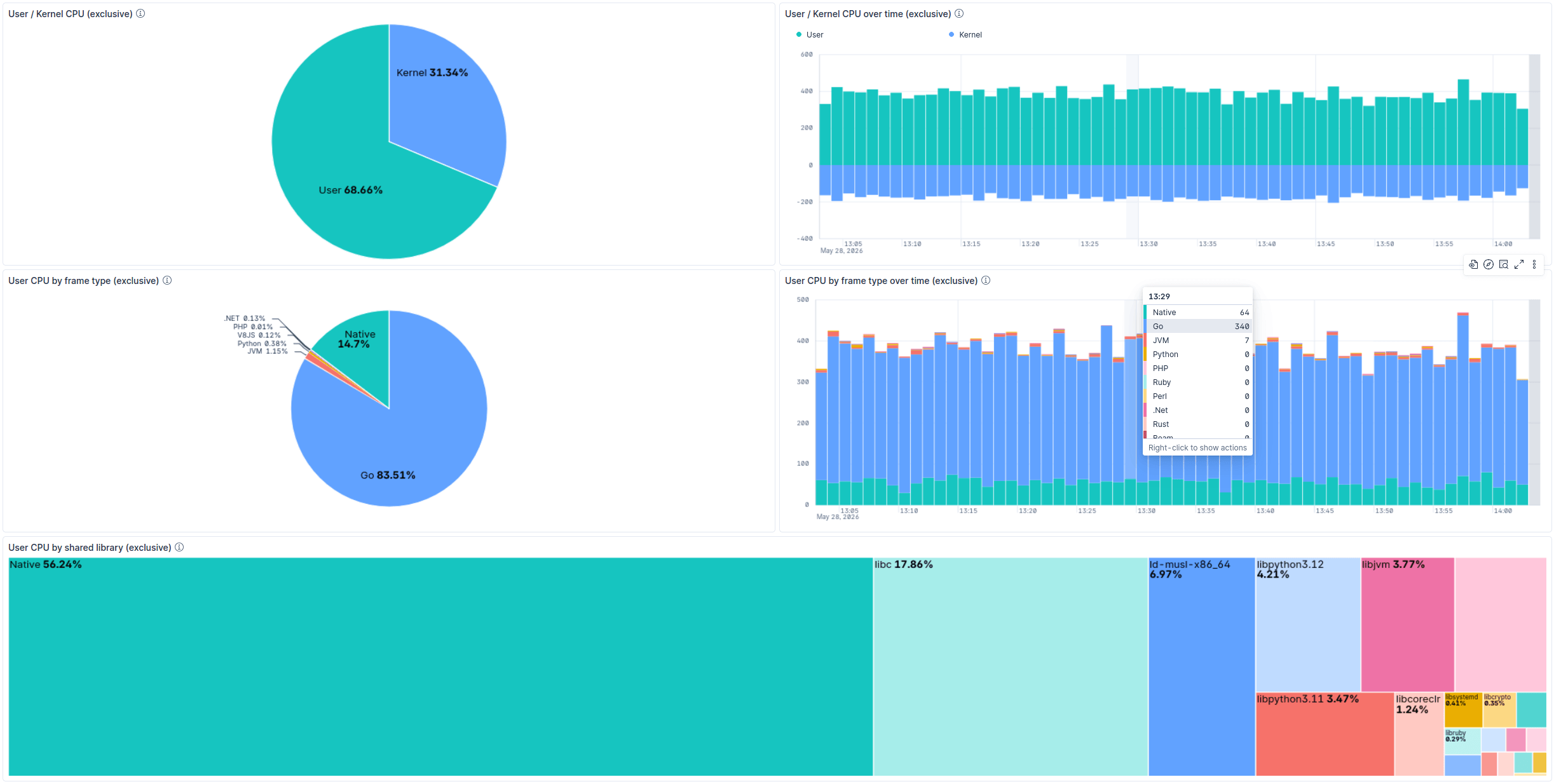

native.countNative C/C++/Rust leaf framesshared library name (libcrypto, libclrjit, libsystemd, …)
hotspot.count, go.count, python.count, …Runtime-specific leaf framesruntime-specific attributes
The kernel categorization is worth a closer look as a modern Linux kernel has more than 400 system calls. However, most of what shows up in CPU stacktraces falls into a handful of subsystems: filesystem read/write, network read/write, memory management, scheduling, synchronization. Some syscalls (e.g. read, write) are ambiguous on their own and only become specific when one examines more frames down the stack: ext4_file_read_iter points to filesystem, tcp_v4_rcv to network. The connector handles this disambiguation as part of frame iteration.
Native frames typically lack symbolic information beyond shared library names, but those names are still informative: libssl and libcrypto mean cryptographic work as part of OpenSSL or one of its variants; libz means compression; libclrjit means the .NET JIT is busy. We don't need to enumerate libraries statically as the connector dynamically generates shlib_name attribute values using the trimmed library name (e.g. libssl not libssl.so.3) for clean cardinality.

  • Standard dashboards: These are ordinary OpenTelemetry time-series counters and can be visualized ad-hoc using stacked bar graphs, pie charts, top-N panels or any other visualization Kibana supports out of the box. The same Lens and TSDB-backed views for application metrics work here.
