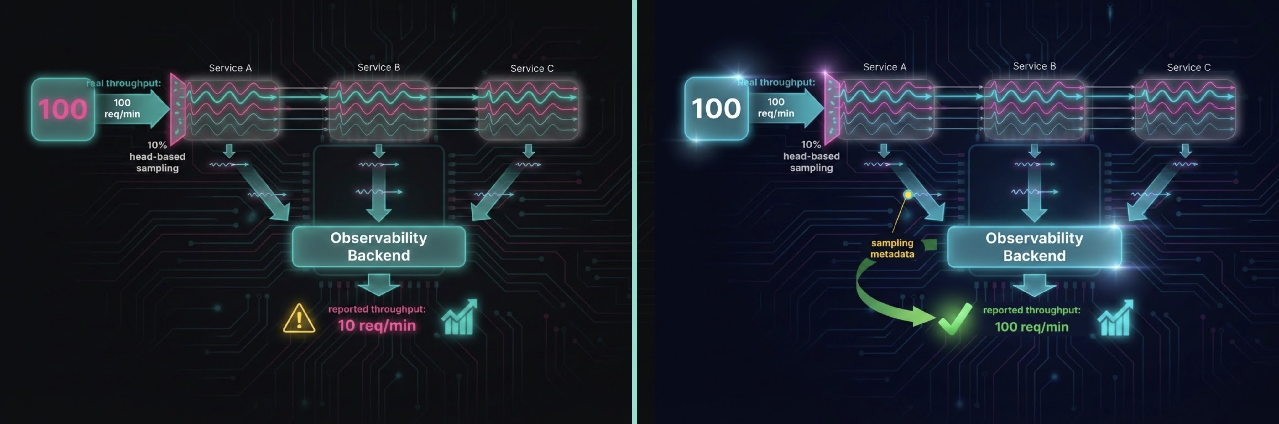

Head-based sampling in OpenTelemetry is cheap and practical, but it used to create a major analytics problem: sampled traces reduced raw span counts, so backend throughput charts became wrong. The fix was to carry sampling probability in tracestate so a backend can estimate how many original traces each sampled trace represents. This article explains the problem, the spec, and how we implemented the fix in OpenTelemetry Java, JavaScript, and Python.
Why sampling creates a throughput problem
Most production systems sample traces because sending every span is expensive. Two common approaches are:
  • Head-based sampling: decide at trace start whether to keep or drop the trace.
  • Tail-based sampling: decide later, after seeing more or all spans from the trace.
Head-based sampling is fast and low-cost because it decides early. But if your backend only sees 10% of traces, a naive throughput chart built from ingested traces can undercount real traffic by 10x.
In other words, without extra metadata, sampled telemetry loses the context needed to reconstruct volume-based metrics.

What changed conceptually
The important shift is not "sample more" or "sample less". It is:
  • keep probabilistic head-based sampling,
  • propagate probability metadata with the trace,
  • let backends compute weighted rates from sampled data.
This keeps ingestion costs manageable and restores correct aggregate analysis.
