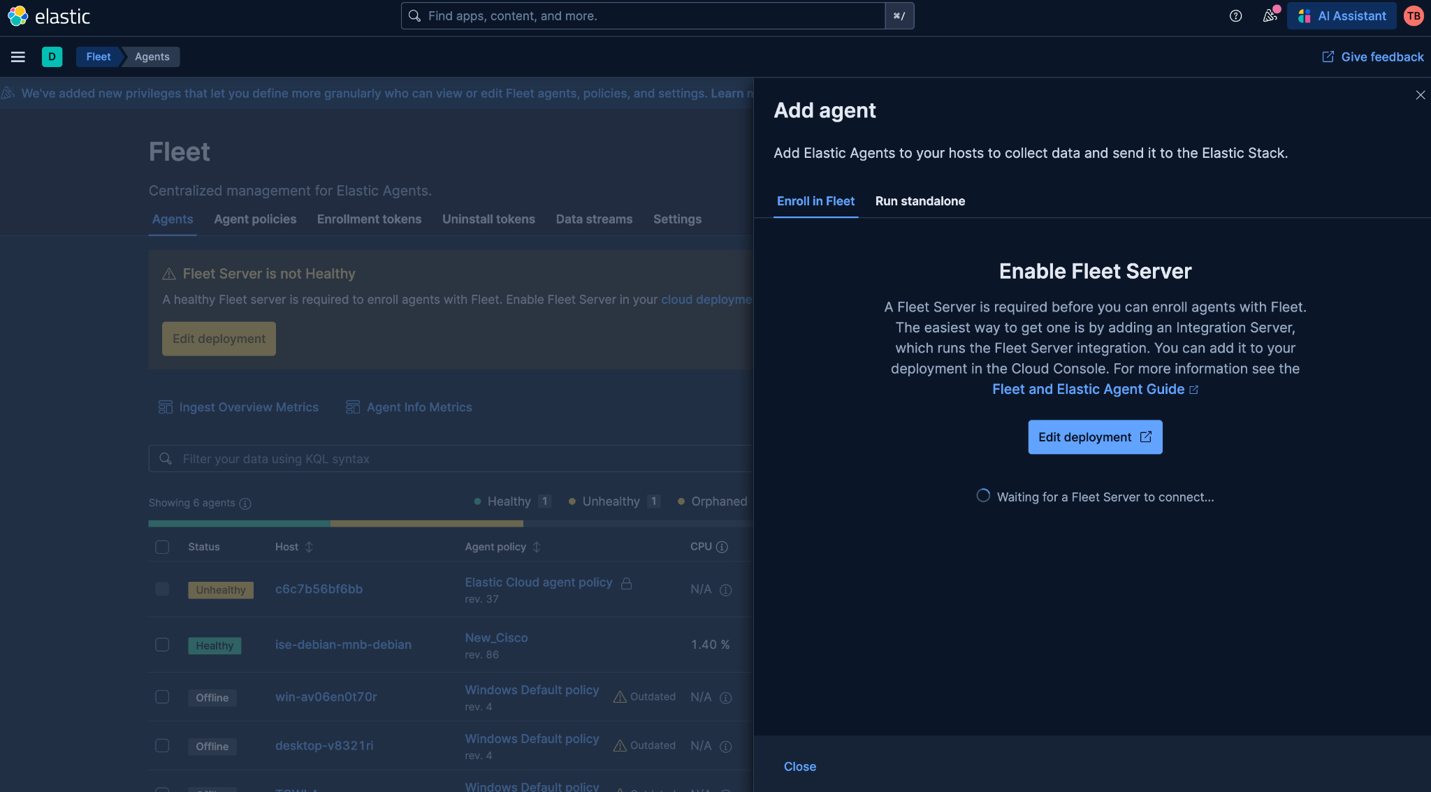

1. Install the Elastic Agent (Setup)
The Elastic Agent is the single, unified way to collect telemetry from your network devices and infrastructure. It replaces the need for multiple Beats or Logstash pipelines for most use cases. Deploy it on a collector host that can reach your network devices via syslog, SNMP, or API.
From Fleet in Kibana, navigate to Fleet → Agents → Add Agent. Select your platform, copy the generated install command, and run it on your collector host. The agent self-registers with Fleet — future policy changes are centrally managed, no SSH required.
Tip: For high-availability NOC deployments, deploy multiple Elastic Agents behind a load balancer pointing to your Fleet Server cluster. This ensures telemetry collection continues if a collector host goes down.

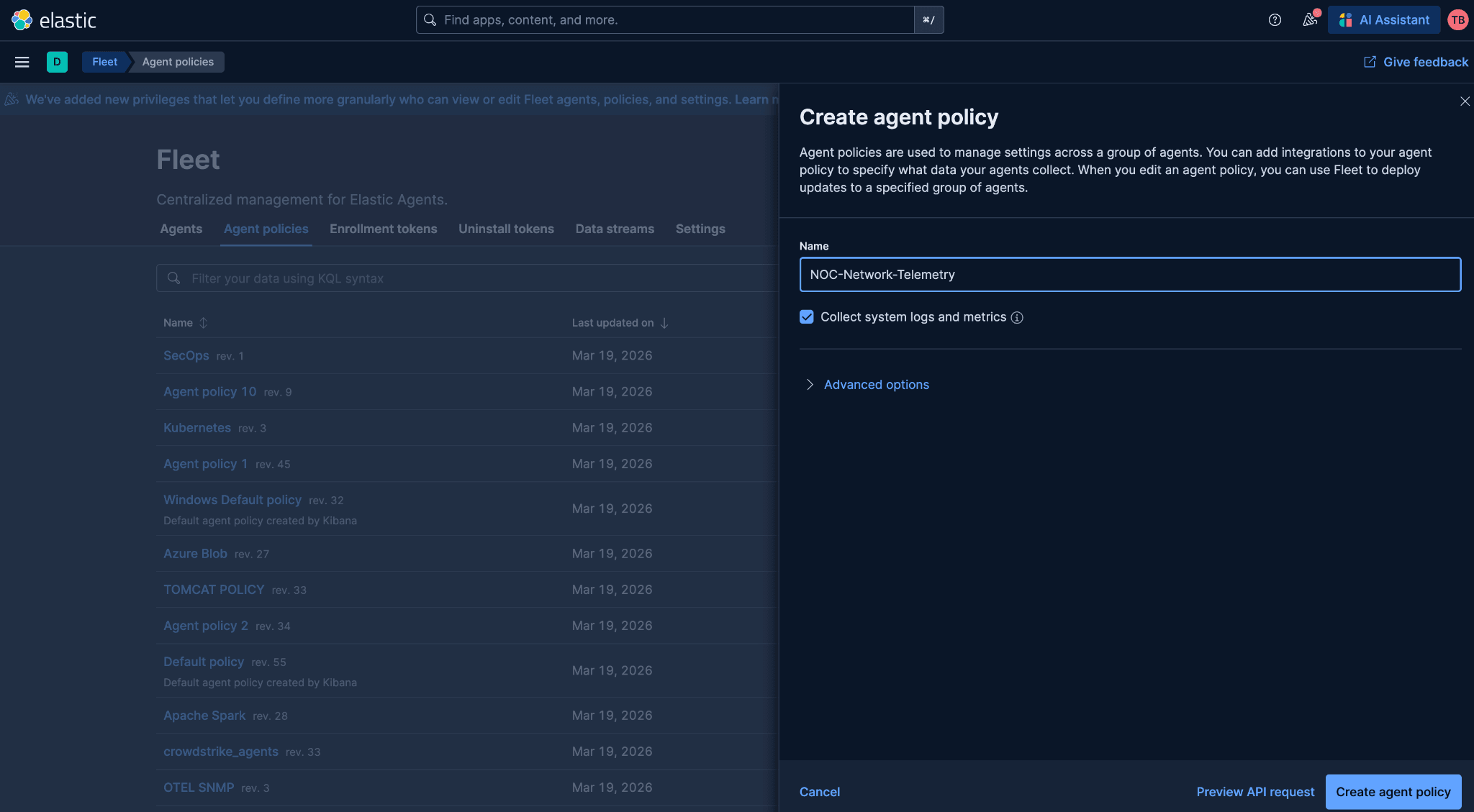

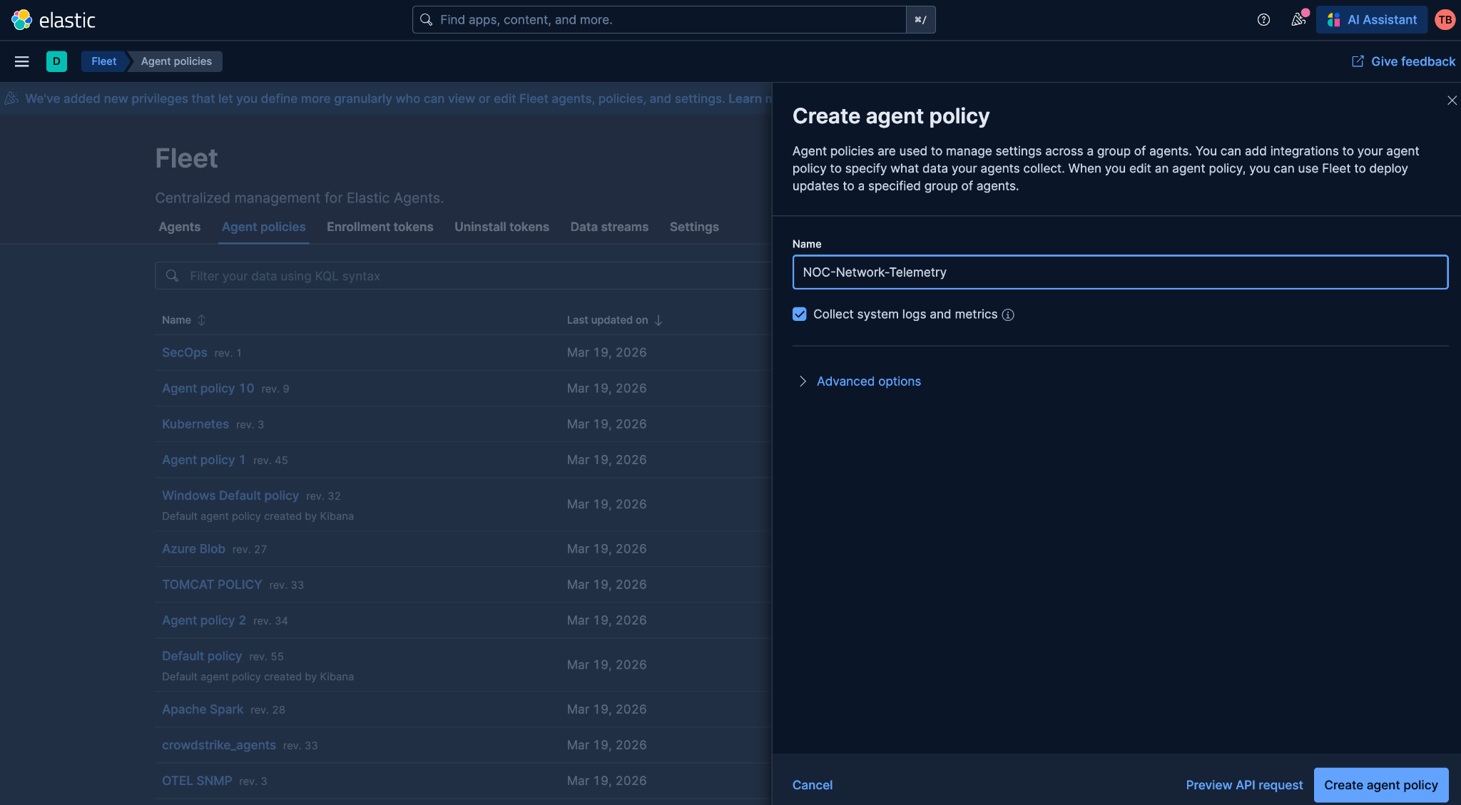

2. Configure an Agent Policy (Setup)
Agent Policies define what an Elastic Agent collects. In Fleet, create a new policy named "NOC-Network-Telemetry". Policies group integrations and apply to one or more agents — this lets you manage collection for an entire class of collector hosts as a single unit.
Within the policy, you'll add integrations for each telemetry source. Start with the integrations relevant to your environment (Cisco ISE in this use case), and add NetFlow, SNMP, and others as you expand coverage.
See screenshot below:

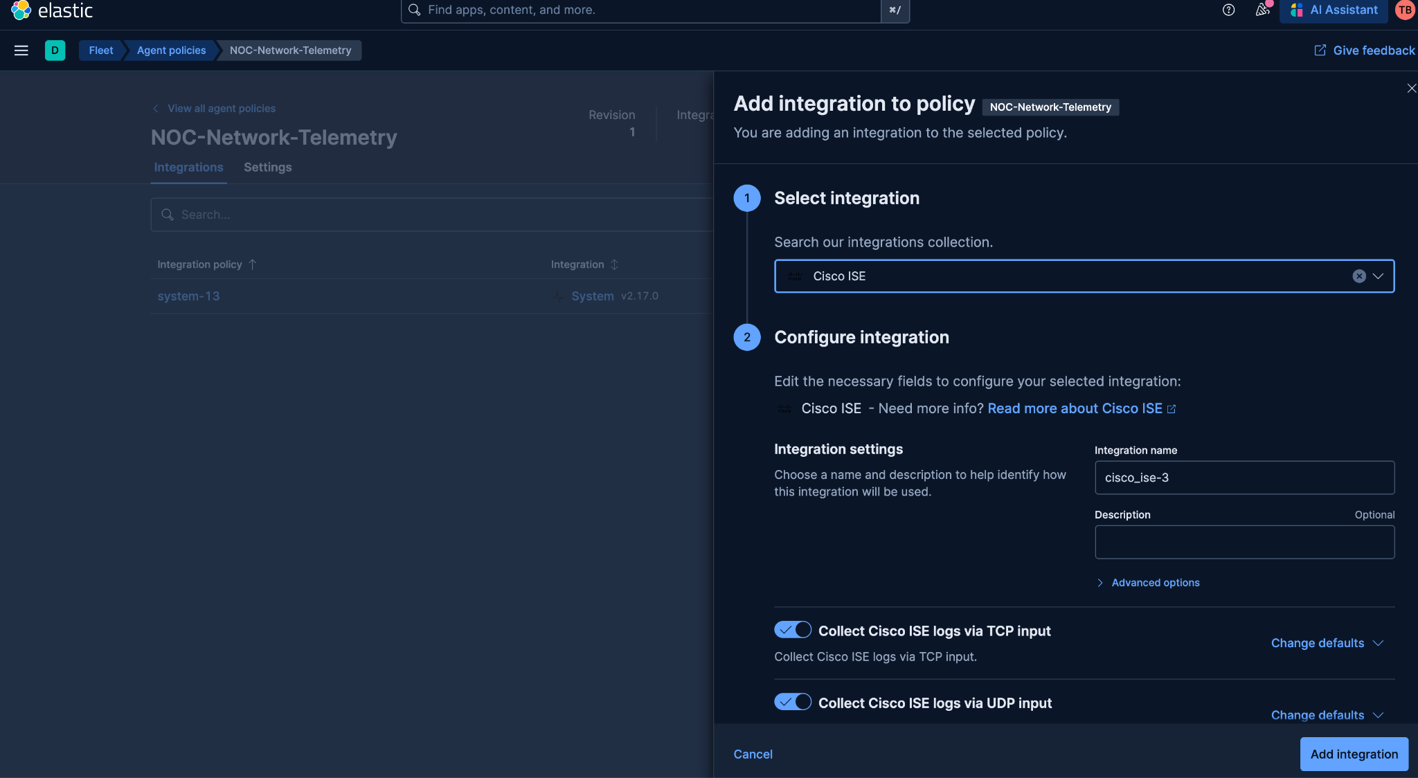

3. Add the Cisco ISE Integration (Integration)
In Fleet, go to Integrations → search "Cisco ISE" and add it to your policy. The integration ships pre-built ingest pipelines that parse ISE's syslog format into structured ECS fields automatically — no custom Grok patterns required.
Configure ISE to forward syslogs to your Elastic Agent collector on UDP/TCP 514. In the integration settings, match that port and set the log categories: authentication events, posture assessments, guest access, and profiler logs are the most valuable for 802.1x troubleshooting.

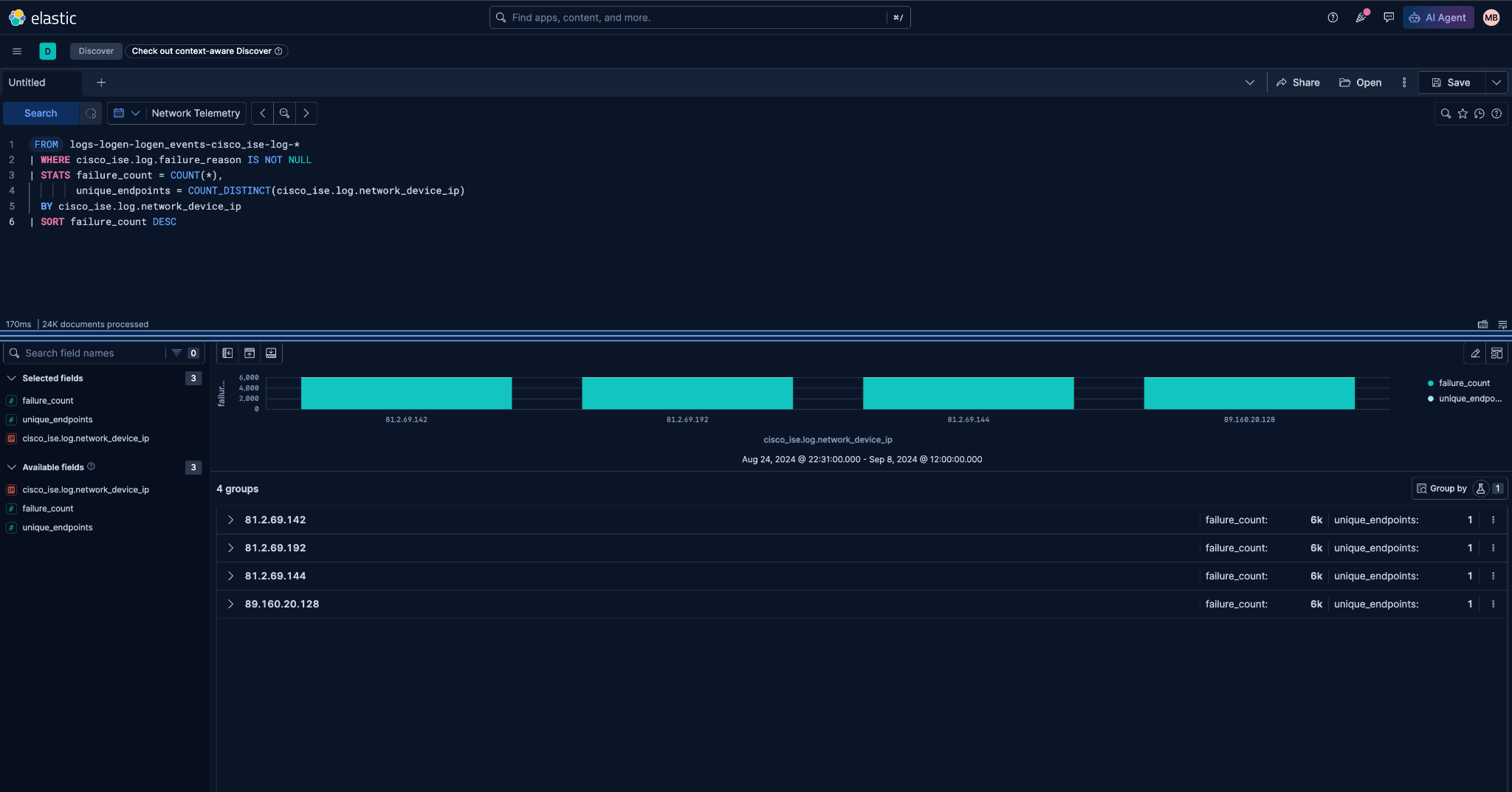

5. Leverage ES|QL for Advanced Queries (Analysis)
Elastic's ES|QL takes analysis further than KQL by enabling SQL-style transformations, aggregations, and enrichments directly on your data. For the NOC, this means failure rate statistics, top-N offending devices, and time-bucketed trend analysis — all without building dashboards first.
// Top access points by authentication failure count
FROM logs-logen-logen_events-cisco_ise-log-*
| WHERE cisco_ise.log.failure_reason IS NOT NULL
| STATS failure_count = COUNT(*),
        unique_endpoints = COUNT_DISTINCT(cisco_ise.log.network_device_ip)
  BY cisco_ise.log.network_device_ip
| SORT failure_count DESC
Tip: ES|QL results can be pinned directly to a Kibana dashboard. Build your investigation queries first in Discover, then save them as panels — giving the NOC a live view of the problem while troubleshooting is still in progress.

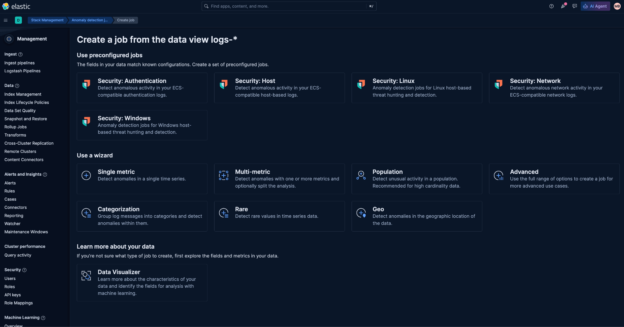

6. Create a Machine Learning Job (Machine Learning)
Navigate to Machine Learning → Anomaly Detection → Create Job. Choose "rare" job type and point it at your logs-cisco_ise.* index (your index name may be different). The ML job learns each device's historical authentication failure baseline and flags deviations that are statistically anomalous. No threshold configuration, no model training — Elastic handles it automatically.
# ML Job Configuration
Job ID:       ise_auth_failure_anomaly
Detectors:    rare by "cisco_ise.log.failure.reason"
influencers:     cisco_ise.log.failure.reason host.hostname
Bucket span:  15m
Datafeed:     Real-time (continuous)

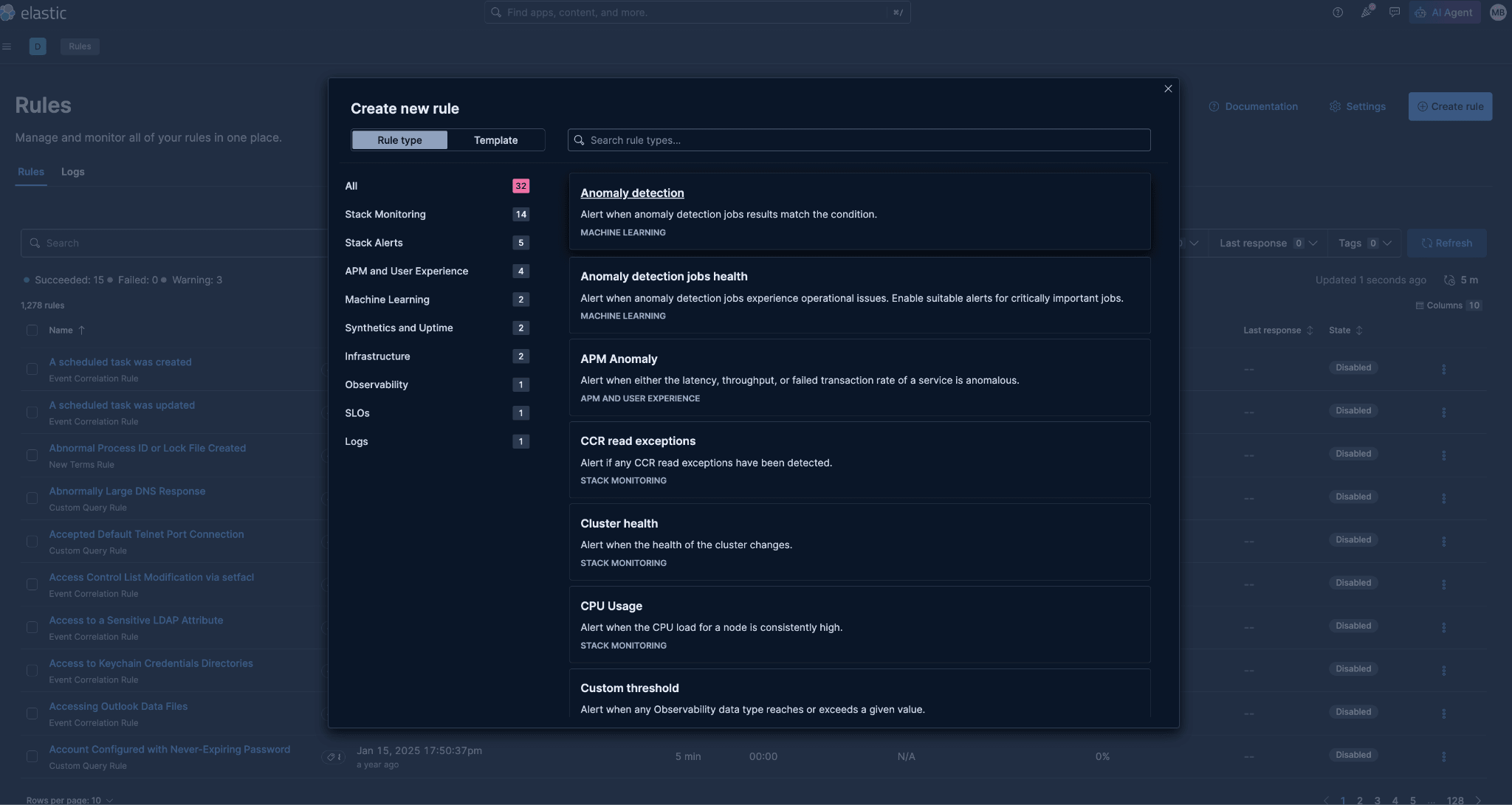

7. Create an Observability Alert Rule (Alerting)
Navigate to Observability → Alerts → Manage Rules → “Create Rule”. Select "Anomaly detection alert" and reference your ise_auth_failure_anomaly job. Set the anomaly score threshold to 70–80 and configure the action to notify your NOC via Slack, PagerDuty, or ServiceNow. After you are finished, select “Create Rule” at the bottom of the screen.
Tip: Set a flapping detection window of 30 minutes to prevent alert storms during brief transient spikes. Your NOC should only be paged for sustained anomalies, not blips that self-resolve.

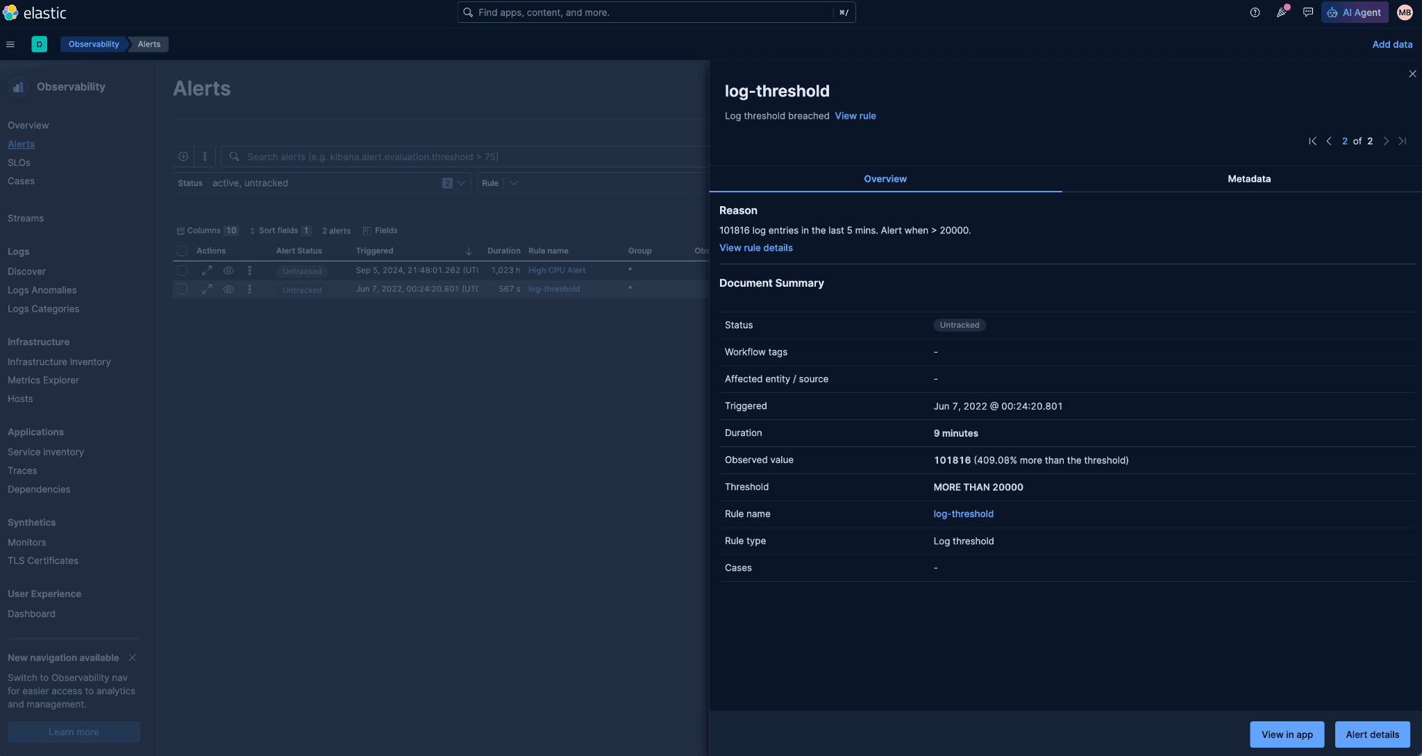

8. Review Alert Details in Observability (AI Assistant)
When an alert fires, navigate to Observability → Alerts and click "Alert details". You'll see the anomaly score trend, impacted devices, the time range of the anomaly, and correlated events — all in a single view.

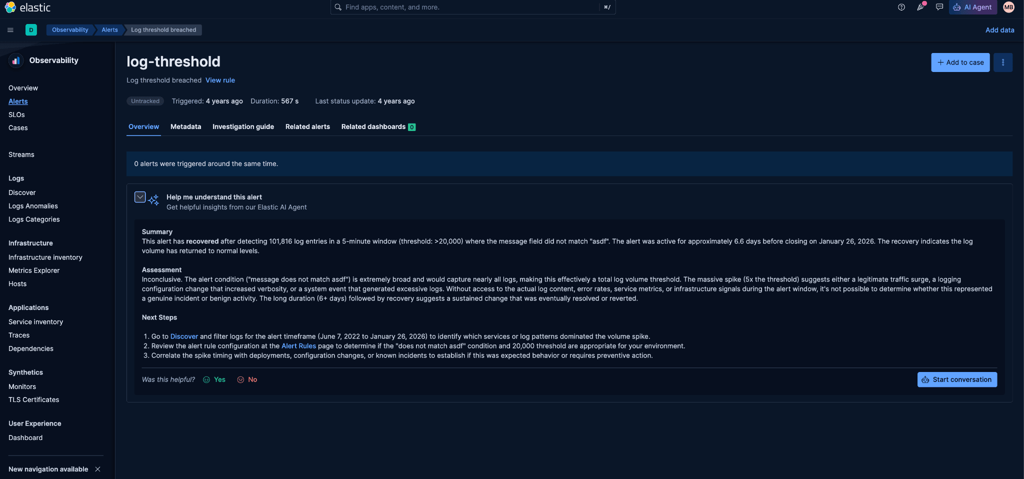

9. Invoke the AI Assistant (AI Assistant)
On the alert detail page, click "Help me understand this alert". The Elastic AI Assistant reads the full alert context and provides a plain-language summary, probable root causes ranked by likelihood, and suggested investigation steps:
AI Assistant Response (example):
Alert Summary: Anomalous spike in 802.1x authentication failures
detected across 3 wireless APs between 09:15 and 09:45 UTC.
Failure count is 847% above the learned baseline.
Probable Root Causes:
  1. RADIUS server certificate expiry (ISE error 5406 in logs)
  2. VLAN misconfiguration on the wireless controller
  3. 802.1x supplicant profile mismatch on endpoints
Recommended Next Steps:
  1. Check ISE certificate validity: Admin > System > Certificates
  2. Verify RADIUS shared secret between WLC and ISE PSN
  3. Review Authentication Detail Report for affected MACs
In seconds, your Level 1 NOC analyst has a prioritized investigation checklist that would have taken a senior network engineer 20 minutes to build manually. This is MTTR reduction in action.

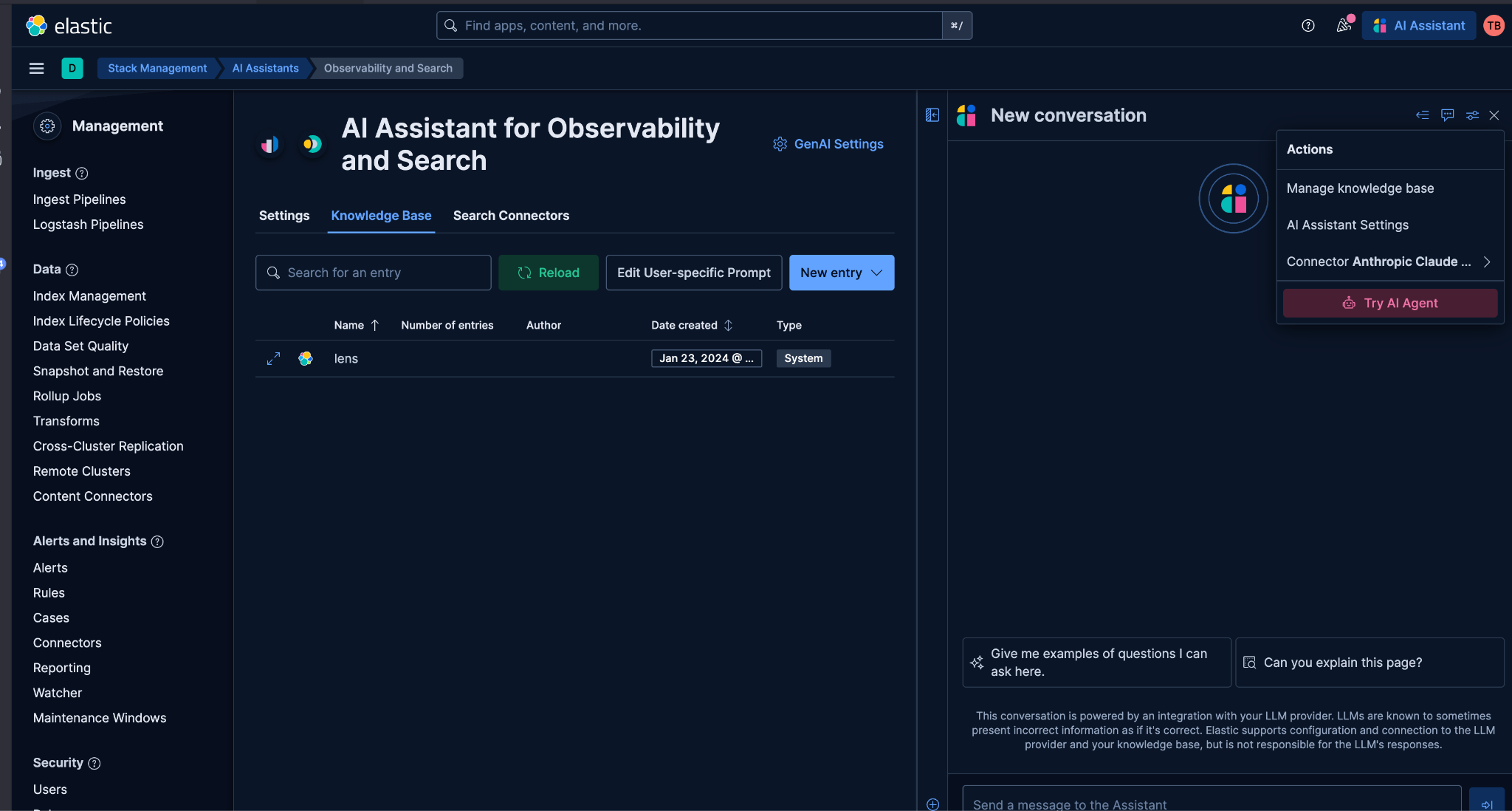

10. Configure the AI Knowledge Base (Knowledge Base)
Open the AI Assistant, click Actions → Manage Knowledge Base. Add static entries — your ISE troubleshooting runbooks, architecture notes, or past incident post-mortems. The assistant will reference these when generating analysis, tailoring guidance to your environment.
# Example Knowledge Base entry:
Title: ISE Error 5406 - RADIUS Authentication Failure Resolution

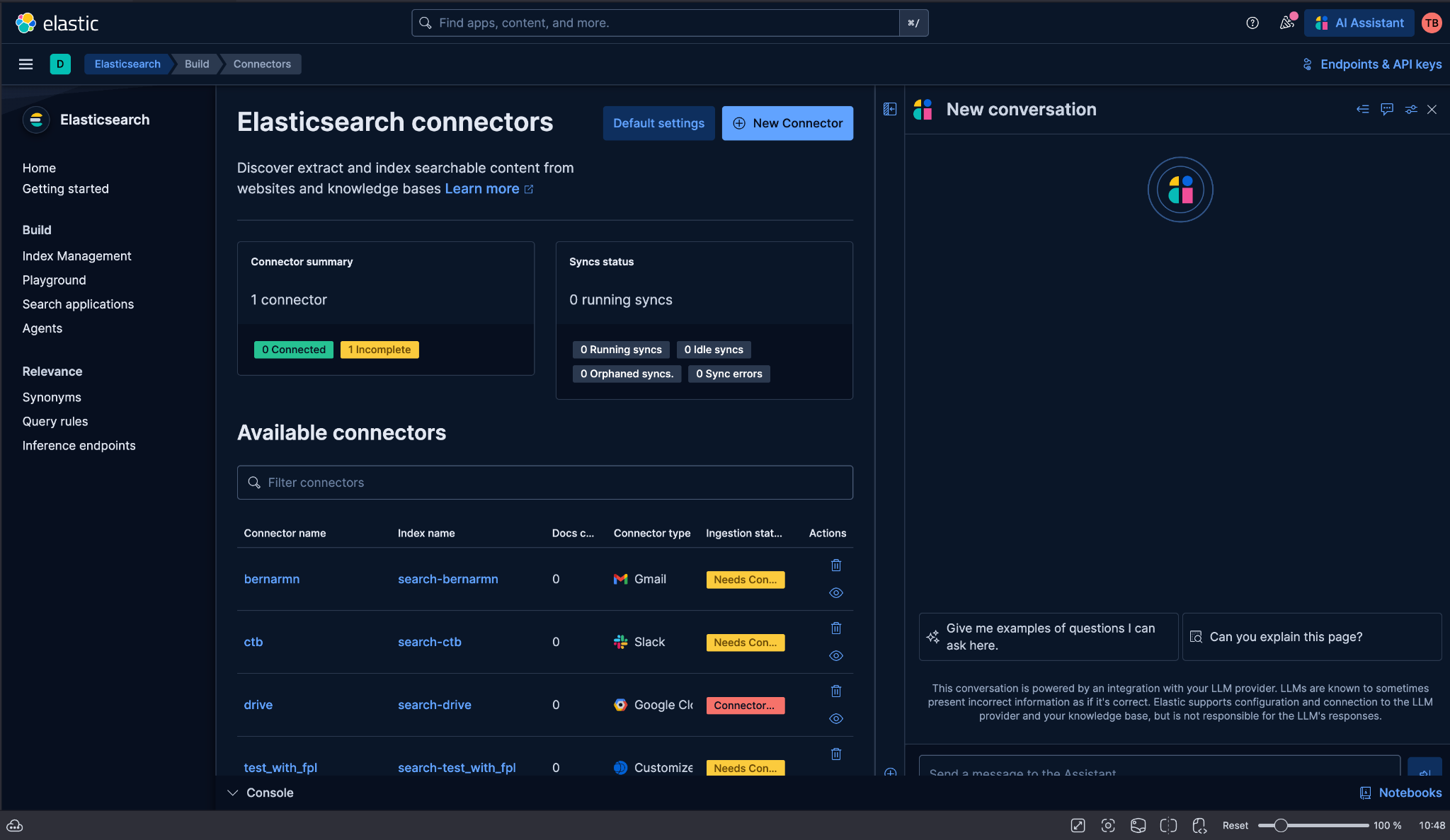

11. Connect External Data Sources via Connectors (Integrations)
For a more dynamic Knowledge base, you can leverage connectors. To do this, navigate to Stack Management → Connectors → “Create Connector”. Available types include ServiceNow, Jira, PagerDuty, GitHub, and generic webhooks. Once connected, the AI Assistant can query these systems when analysing an alert — checking for recent changes, open tickets, known bugs, playbooks, or RSS feeds — without the analyst manually pivoting between tools.
Tip: The ServiceNow CMDB connector is particularly valuable. When the AI identifies an impacted device, it can automatically pull the device owner, maintenance window schedule, and change history — context that dramatically speeds up escalation decisions. You can also subscribe to vendor product feeds, so your context will get updated as subscribers hit “new bugs” on software releases
