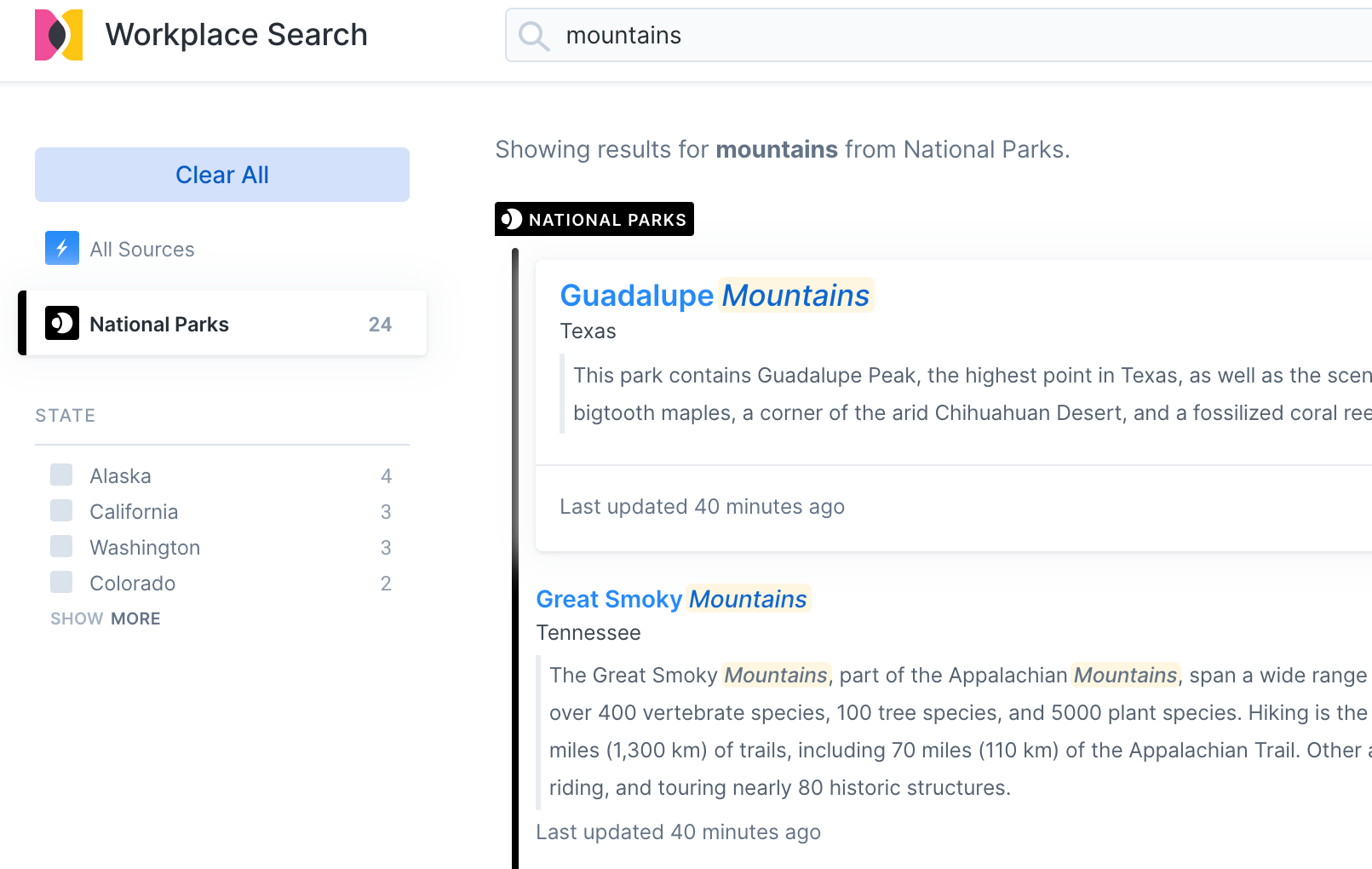

Step 5. Now we can see the search experience includes a filter for State. Note that you generally need to filter on a specific source to expose filters for that source (in this case the National Parks source).

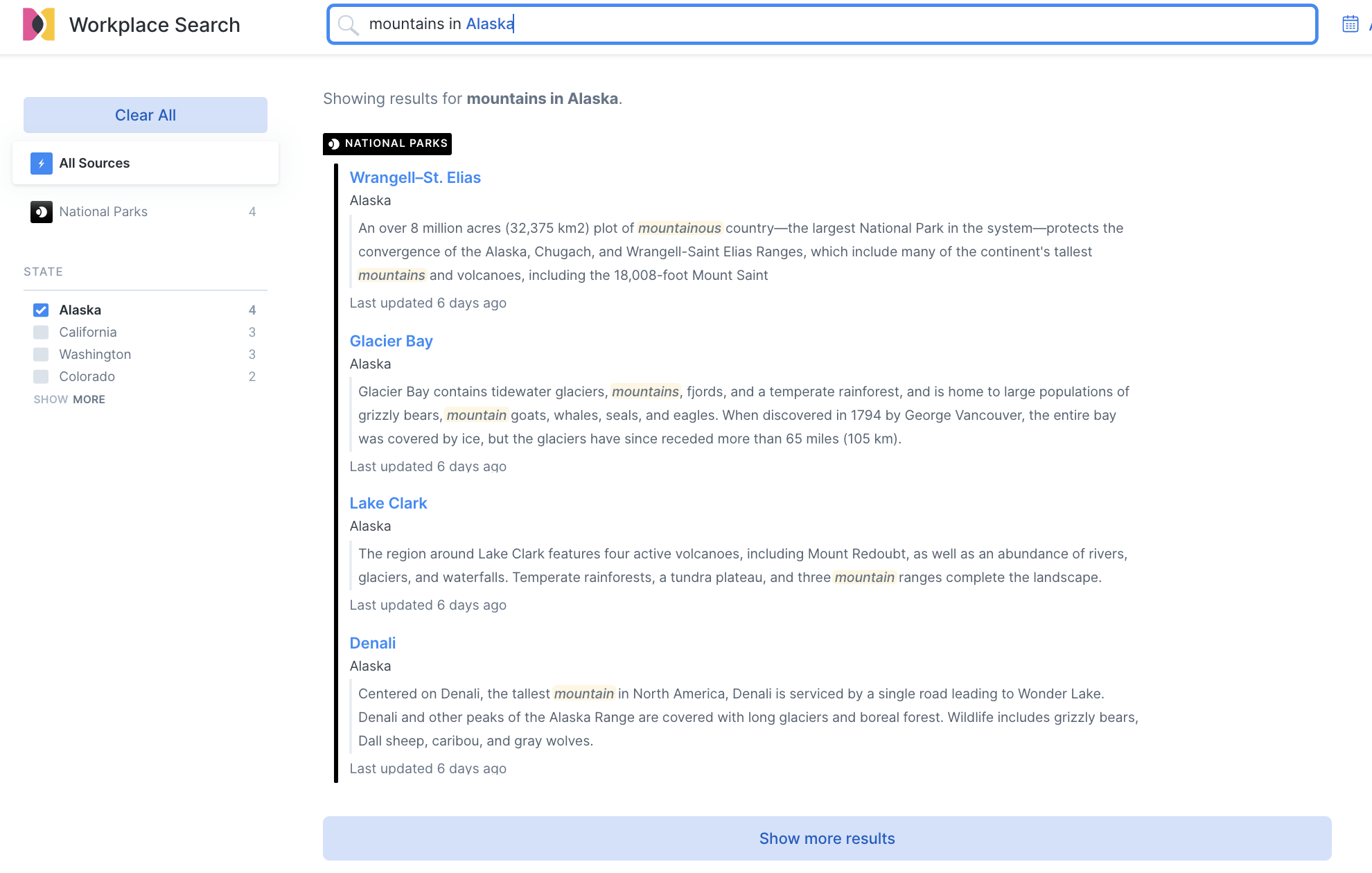

Enabling automatic query refinementedit
Content source automatic query refinements define a sort of domain-specific language that allows a searcher to limit results using natural language queries. When a query contains a configured query_expansion_phrases object followed by a specific value from the matching field, only documents with that value are found.
For example, you may want to enable automatic query refinement for this field, so that the user does not need to manually check the box for State: Alaska when looking for parks only in Alaska.
To do this:
  • Ensure the index contains documents with the states: Alaska (we saw this in the above facets).
  • Configure the field states to have query_expansion_phrases of ['inside', 'in'].

Now when your users issue queries like mountains in Alaska or mountains inside California, the state in their search box will highlight blue, and the corresponding facet will automatically be checked.

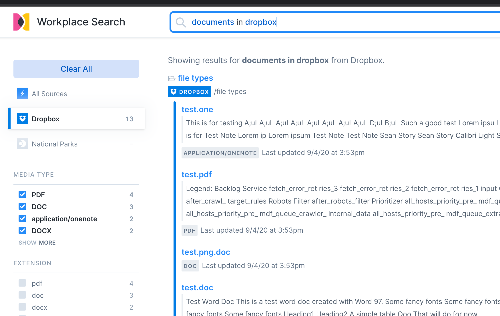

We might decide that the Media Type and Extension filters are redundant, so we’d like to hide the Extension filter.
Step 1. Using the same request as our custom API source example above, we’ll first request all sources to retrieve the source definition of the Dropbox source:

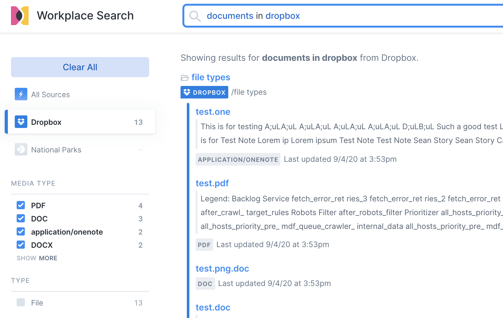

Step 3. Finally, we can see the search experience hides the Extension filter:

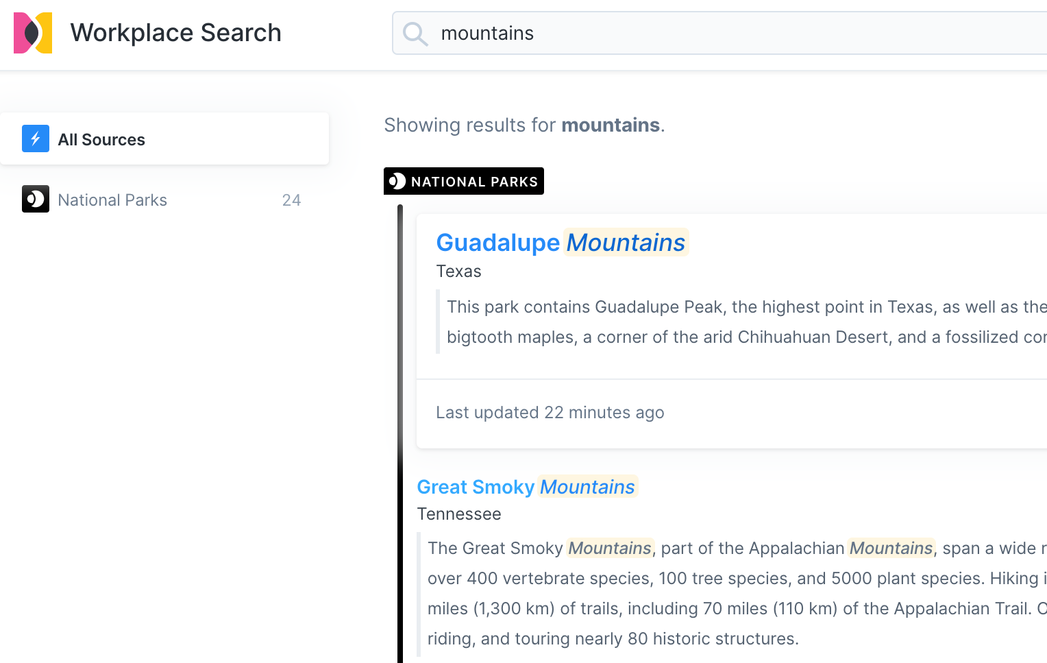

Re-enable a disabled filteredit
If you want to re-enable the Extension filter from the above steps, it’s natural to think that you should just change the enabled attribute from false to true. However, you’re really expressing the facet configuration override. The Dropbox source already has an Extension filter by default, so update the source with an empty array for overrides in order to re-enable the Extension filter:
