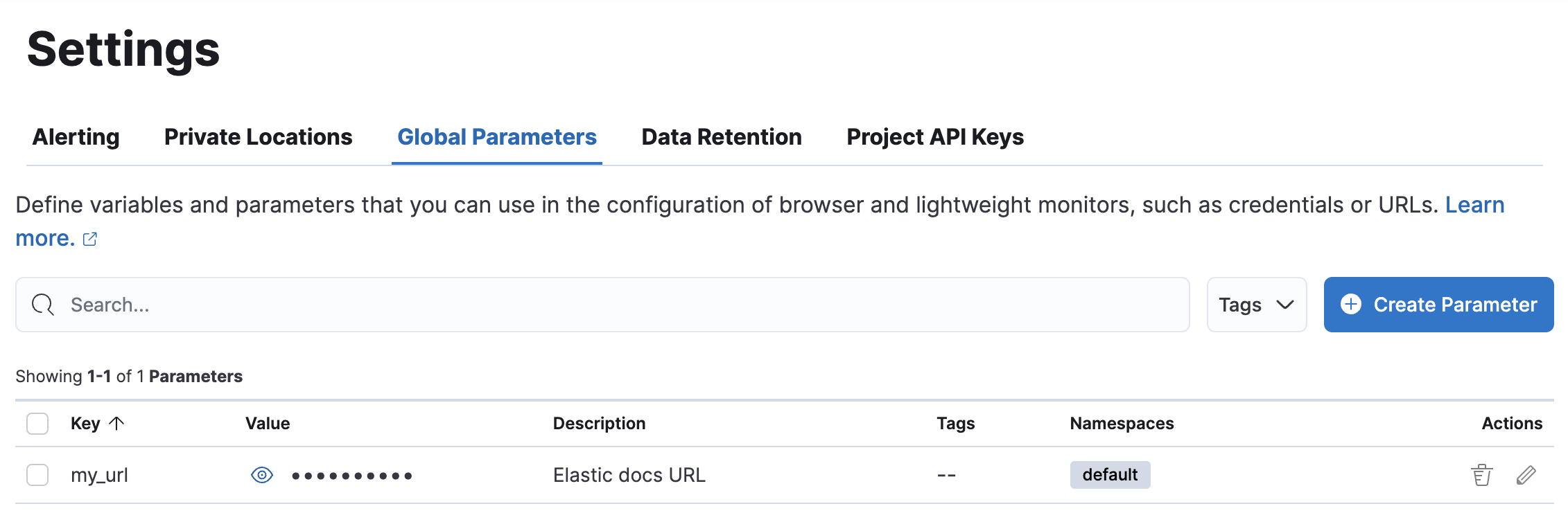

Global parameters in your Observability projectedit
From any page in the Observability project’s Synthetics section:
  1. Go to Settings.
  2. Go to the Global parameters tab.
  3. Define parameters.
Global parameters tab on the Synthetics Settings page in an Observability project

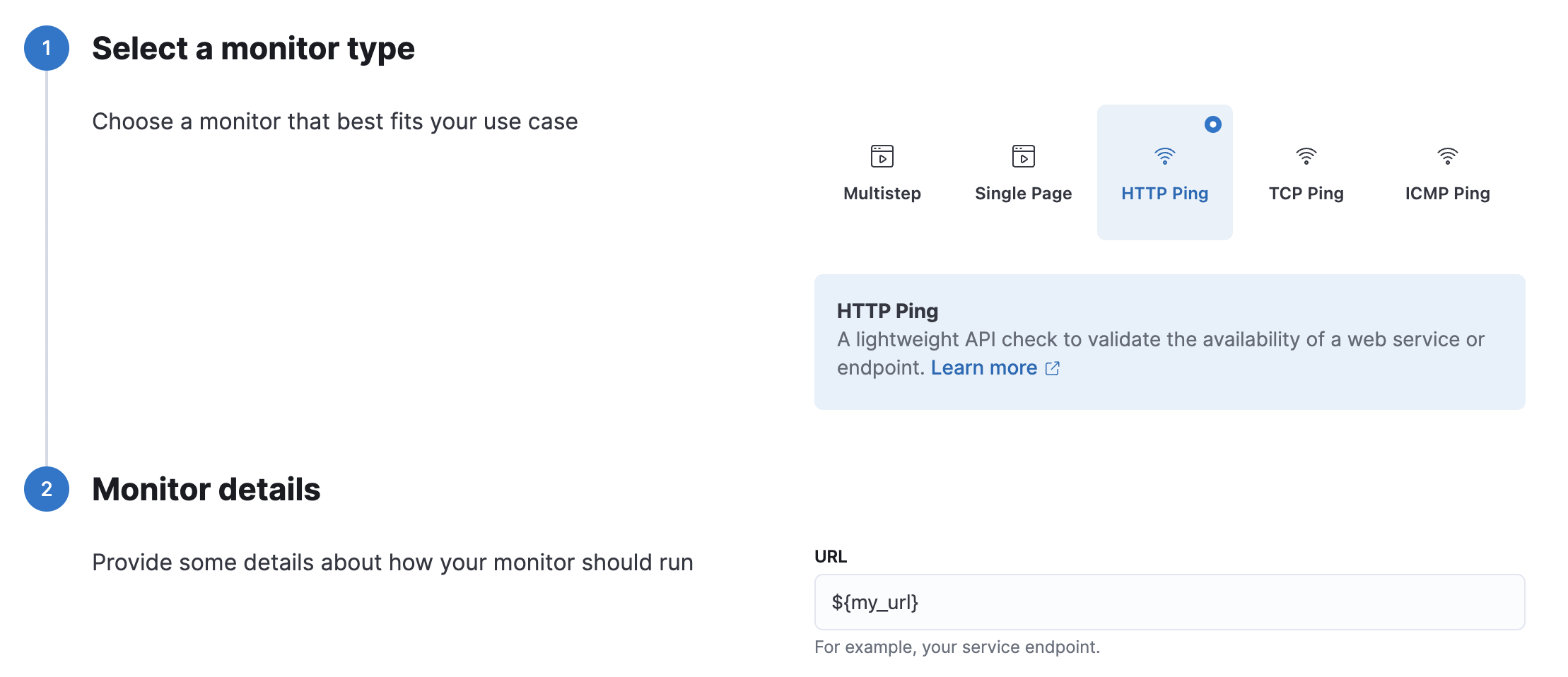

In the UIedit
To use a param in a lightweight monitor that is created in the Synthetics UI, wrap the name of the param in ${} (for example, ${my_url}).
Use a param in a lightweight monitor created in the Synthetics UI
