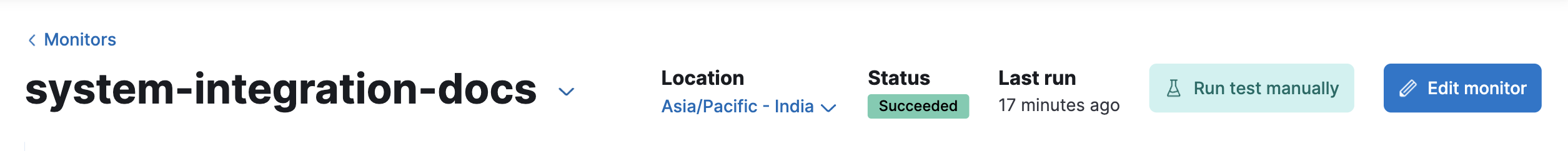

When you go to an individual monitor’s page, you’ll see much more detail about the monitor’s performance over time. The details vary by monitor type, but for every monitor at the top of the page you’ll see:
  • The monitor’s name with a down arrow icon that you can use to quickly move between monitors.
  • The location of the monitor. If the same monitor configuration was used to create monitors in multiple locations, you’ll also see a down arrow icon that you can use to quickly move between locations that use the same configuration.
  • The latest status and when the monitor was last run.
  • The Experiment Run test manually button that allows you to run the test on demand before the next scheduled run.
    This is only available for monitors running on Elastic’s global managed testing infrastructure. It is not available for monitors running on Private Locations.
  • The Edit Edit monitor button that allows you to edit the monitor’s configuration.
Header at the top of the individual monitor page for all monitor types in the Synthetics UI

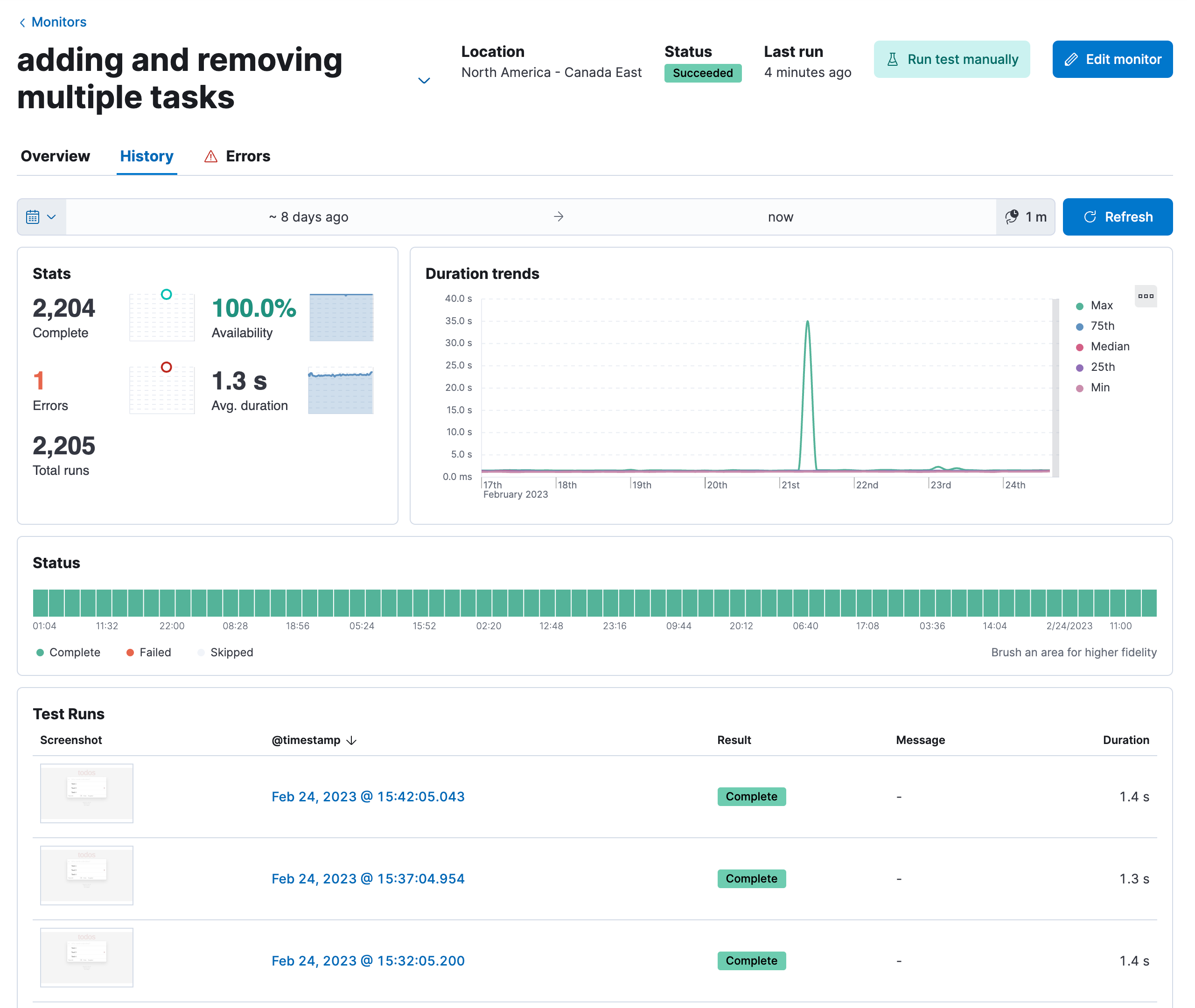

Historyedit
The History tab has information on every time the monitor has run. It includes some high-level stats and a complete list of all test runs. Use the calendar icon (Calendar) and search bar to filter for runs that occurred in a specific time period.
For browser monitors, you can click on any run in the Test runs list to see the details for that run. Read more about what information is included the in Details for one run section below.
The History tab on the individual monitor page for all monitor types in the Synthetics UI

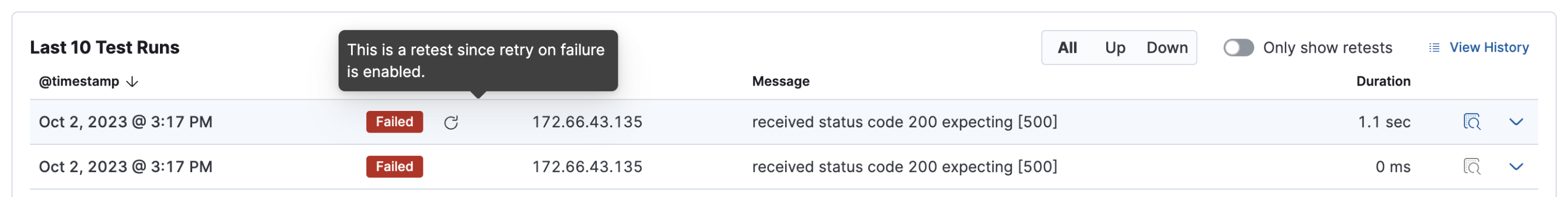

If the monitor is configured to retest on failure, you’ll see retests listed in the Test runs table. Runs that are retests include a rerun icon (Refresh icon) next to the result badge.
A failed run and a retest in the table of test runs in the Synthetics UI

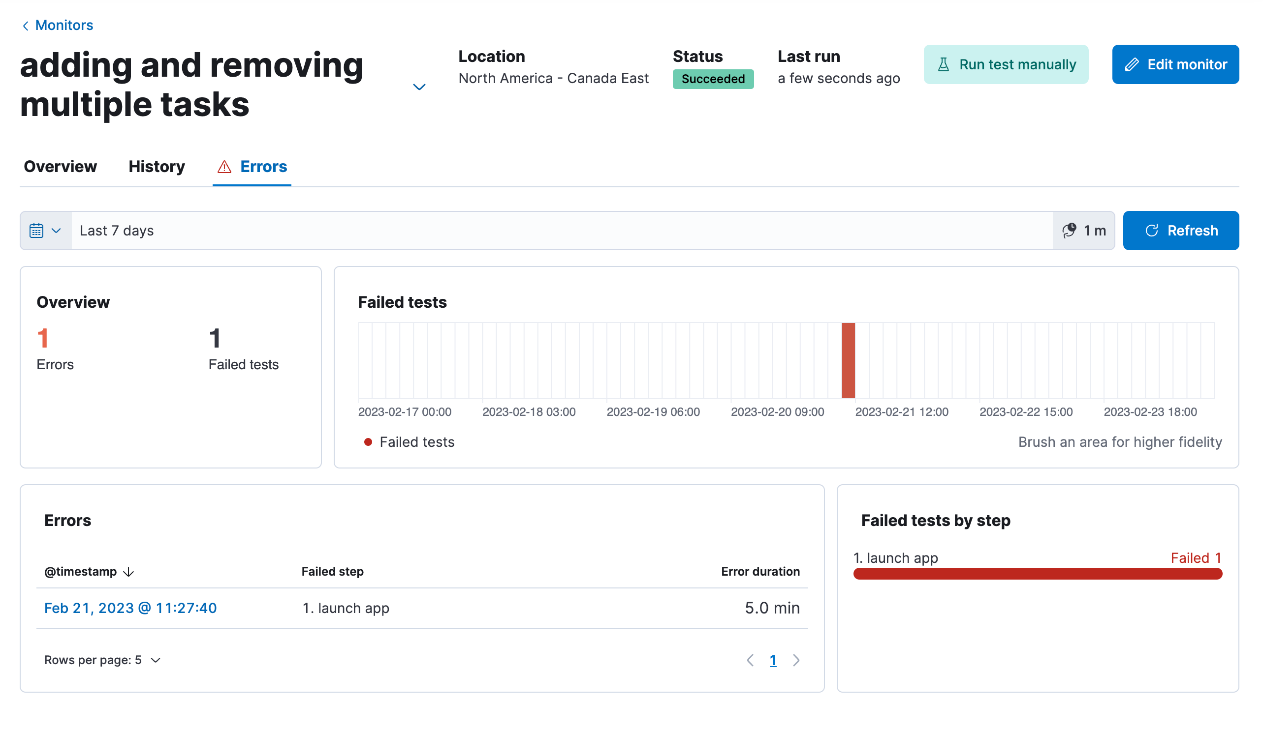

Errorsedit
The Errors tab has information on failed runs. If the monitor is configured to retest on failure, failed runs will only result in an error if both the initial run and the rerun fail. This can reduce noise related to transient problems.
The Errors tab includes a high-level overview of all alerts and a complete list of all failures. Use the calendar icon (Calendar) and search bar to filter for runs that occurred in a specific time period.
For browser monitors, you can click on any run in the Error list to open an Error details page that includes most of the same information that is included the in Details for one run section below.
The Errors tab on the individual monitor page for all monitor types in the Synthetics UI

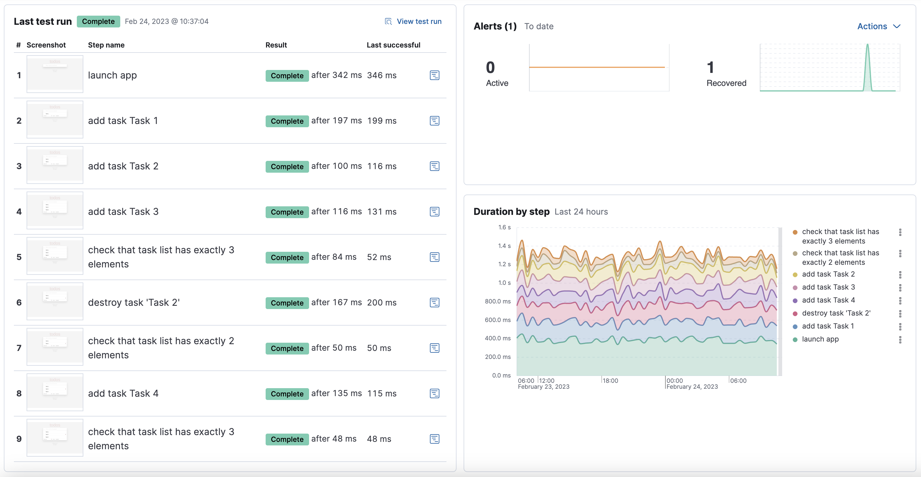

The journey page on the Overview tab includes:
  • An overview of the last test run including high-level information for each step.
  • Alerts to date including both active and recovered alerts.
  • Duration by step over the last 24 hours.
  • A list of the last 10 test runs that link to the details for each run.

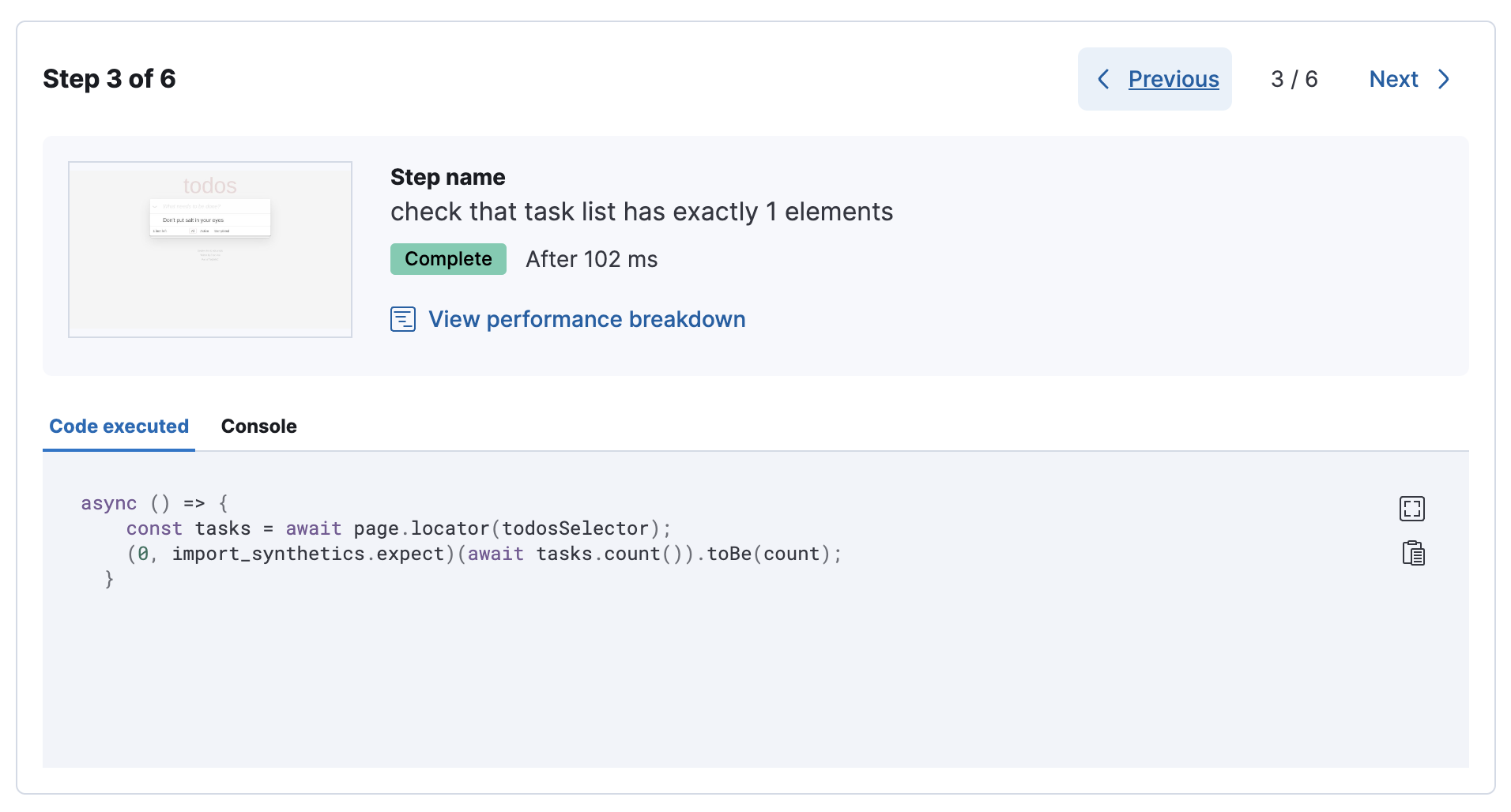

The page detailing one run for a journey includes more information on each step in the current run and opportunities to compare each step to the same step in previous runs.
At the top of the page, see the Code executed and any Console output for each step. If the step failed, this will also include a Stacktrace tab that you can use to diagnose the cause of errors.
Navigate through each step using Previous Previous and Next Next.
Step carousel on a page detailing one run of a browser monitor in the Synthetics UI

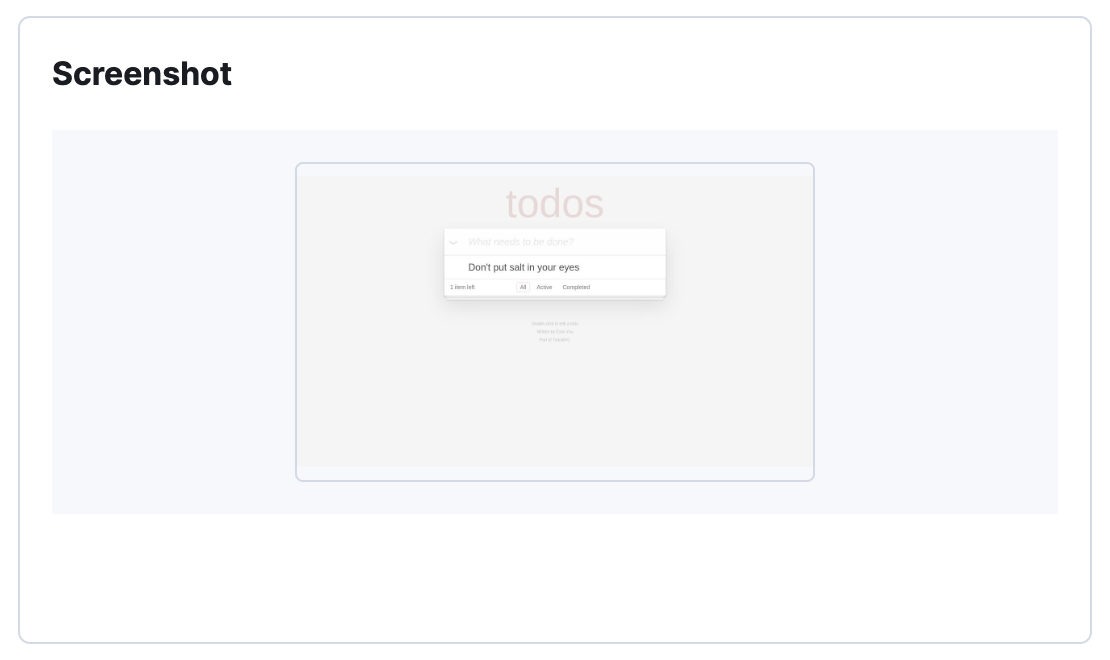

Screenshotedit
By default the synthetics library will capture a screenshot for each step regardless of whether the step completed or failed.
Customize screenshot behavior for all monitors in the configuration file, for one monitor using monitor.use, or for a run using the CLI.
Screenshots can be particularly helpful to identify what went wrong when a step fails because of a change to the UI. You can compare the failed step to the last time the step successfully completed.
Screenshot for one step in a browser monitor in the Synthetics UI

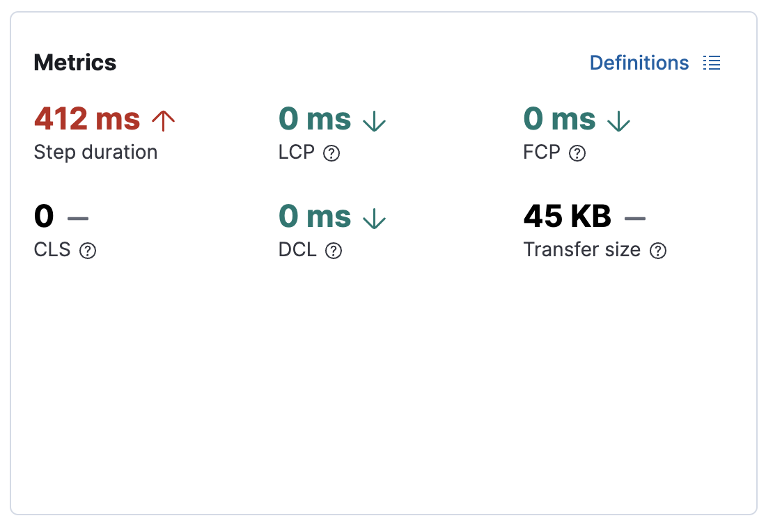

Metricsedit
The Metrics visualization gives you insight into the performance of the web page visited in the step and what a user would experience when going through the current step. Metrics include:
  • First contentful paint (FCP) focuses on the initial rendering and measures the time from when the page starts loading to when any part of the page’s content is displayed on the screen.
  • Largest contentful paint (LCP) measures loading performance. To provide a good user experience, LCP should occur within 2.5 seconds of when the page first starts loading.
  • Cumulative layout shift (CLS) measures visual stability. To provide a good user experience, pages should maintain a CLS of less than 0.1.
  • DOMContentLoaded event (DCL) is triggered when the browser completes parsing the document. Helpful when there are multiple listeners, or logic is executed: domContentLoadedEventEnd - domContentLoadedEventStart.
  • Transfer size represents the size of the fetched resource. The size includes the response header fields plus the response payload body.
Largest contentful paint and Cumulative layout shift are part of Google’s Core Web Vitals, an initiative that introduces a set of metrics that help categorize good and bad sites by quantifying the real-world user experience.
Next to each metric, there’s an icon that indicates whether the value is higher (Arrow up), lower (Arrow down), or the same (Minus) compared to all runs over the last 24 hours. Hover over the icon to see more details in a tooltip.
Metrics visualization for one step in a browser monitor in the Synthetics UI

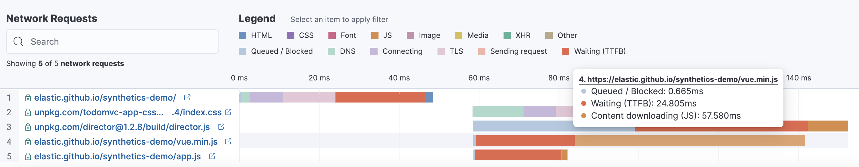

Network requestsedit
The Network requests visualization is a waterfall chart that shows every request the page made when a user executed it. Each line in the chart represents an HTTP network request and helps you quickly identify what resources are taking the longest to load and in what order they are loading.
The colored bars within each line indicate the time spent per resource. Each color represents a different part of that resource’s loading process (as defined in the Timing section above) and includes the time spent downloading content for specific Multipurpose Internet Mail Extensions (MIME) types: HTML, JS, CSS, Media, Font, XHR, and Other.
Understanding each phase of a request can help you improve your site’s speed by reducing the time spent in each phase.
Network requests waterfall visualization for one step in a browser monitor in the Synthetics UI
Without leaving the waterfall chart, you can view data points relating to each resource: resource details, request headers, response headers, and certificate headers. On the waterfall chart, select a resource name, or any part of each row, to display the resource details overlay.
For additional analysis, whether to check the content of a CSS file or to view a specific image, click the Popout icon located beside each resource, to view its content in a new tab.
