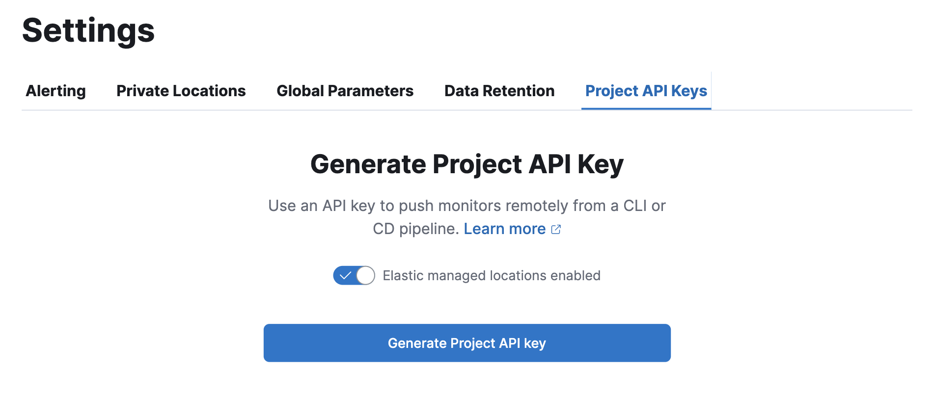

Then, follow the prompts on screen to set up the correct default variables for your Synthetics project. When complete, set the SYNTHETICS_API_KEY environment variable in your terminal, which is used to connect to your Observability project:
  1. To generate an API key:
    1. Go to Synthetics in your Observability project.
    2. Click Settings.
    3. Switch to the Project API Keys tab.
    4. Click Generate Project API key.
      To generate a Project API key, you must be logged in as a user with Editor access.
      Project API Keys tab in Synthetics settings
      To use an API key to push to Elastic’s global managed testing infrastructure, the Elastic managed locations enabled toggle must be on when generating the API key. If the Elastic managed locations enabled toggle is disabled, an administrator has restricted access to Elastic’s global managed testing infrastructure.
