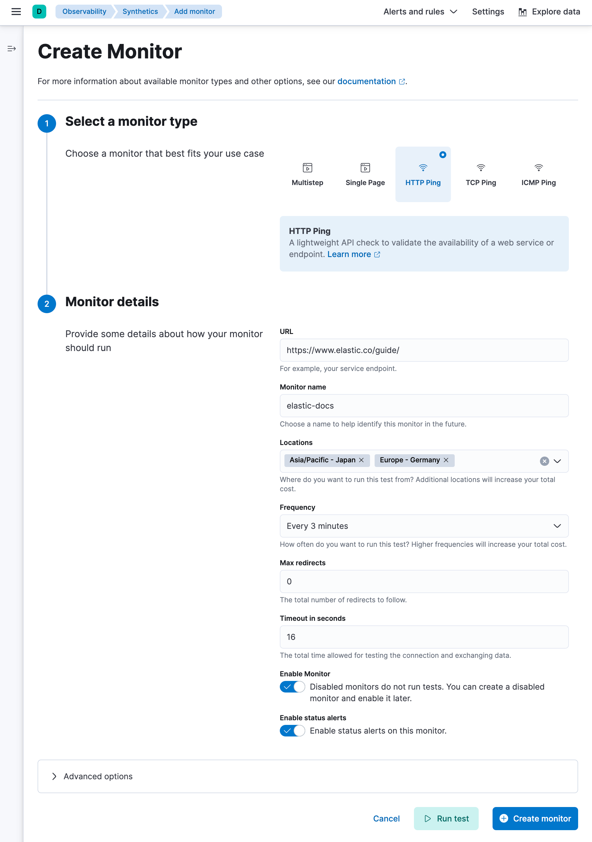

Synthetics appedit
To use the UI in the Synthetics app, go to the Synthetics app in Kibana to create and configure monitors. For step-by-step instructions, refer to Use the Synthetics app.
Synthetics Create monitor UI
