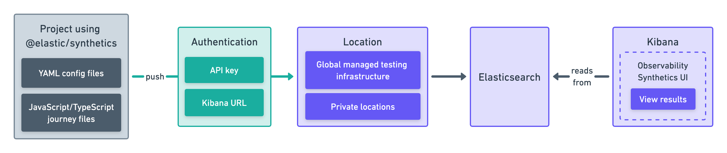

Projects are the most powerful and sophisticated way to configure synthetic monitors in the Elastic Stack. Projects let you define your infrastructure as code, more commonly known as IaaC or Git-ops. With project monitors you organize your YAML configuration and JavaScript- or TypeScript-defined monitors on the filesystem, use Git for version control, and deploy via a CLI tool, usually executed on a CI/CD platform.

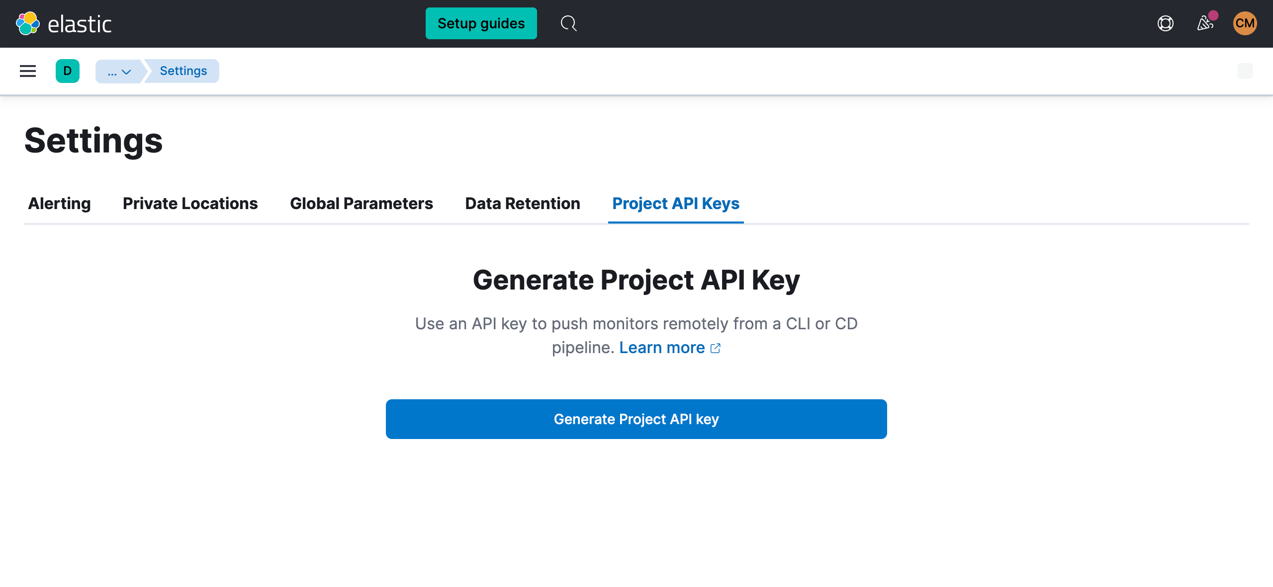

Then, follow the prompts on screen to setup the correct default variables for your project. When complete, set the SYNTHETICS_API_KEY environment variable in your terminal, which is used for authentication with your Elastic Stack:
  1. To generate an API key:
    1. Go to Synthetics in Kibana.
    2. Click Settings.
    3. Switch to the Project API Keys tab.
    4. Click Generate Project API key.
      To generate a Project API key, you must be logged in as a user with the privileges described in Writer role.
      Project API Keys tab in Synthetics settings
  2. Set the SYNTHETICS_API_KEY environment variable in your terminal. You will most likely want to set this permanently. This is done differently in Powershell and Bash.

Test and connect to the Elastic Stackedit
While inside the project directory you can do two things with the npx @elastic/synthetics command:
  • Test browser-based monitors locally. To run all journeys defined in .ts and .js files:
    npx @elastic/synthetics journeys
  • Push all monitor configurations to an Elastic deployment. Run the following command from inside your project:
    npx @elastic/synthetics push --auth $SYNTHETICS_API_KEY --url <kibana-url>
One monitor will appear in the Synthetics app for each journey or lightweight monitor, and you’ll manage all monitors from your local environment. For more details on using the push command, refer to @elastic/synthetics push.
