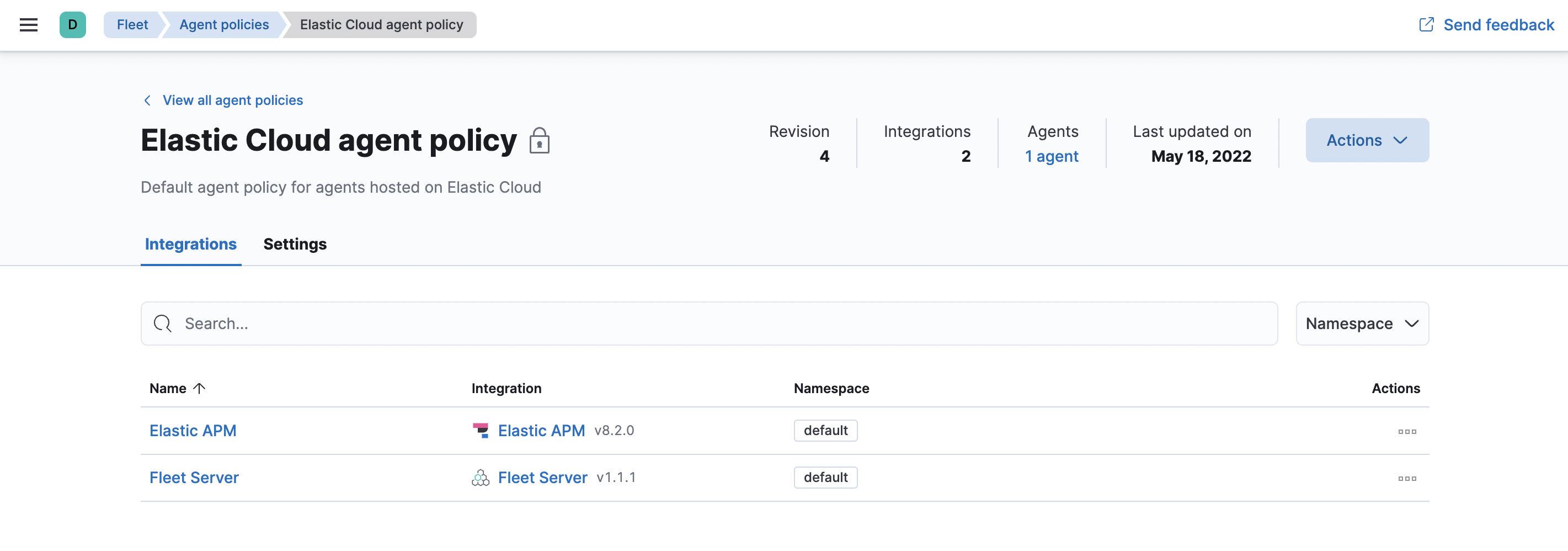

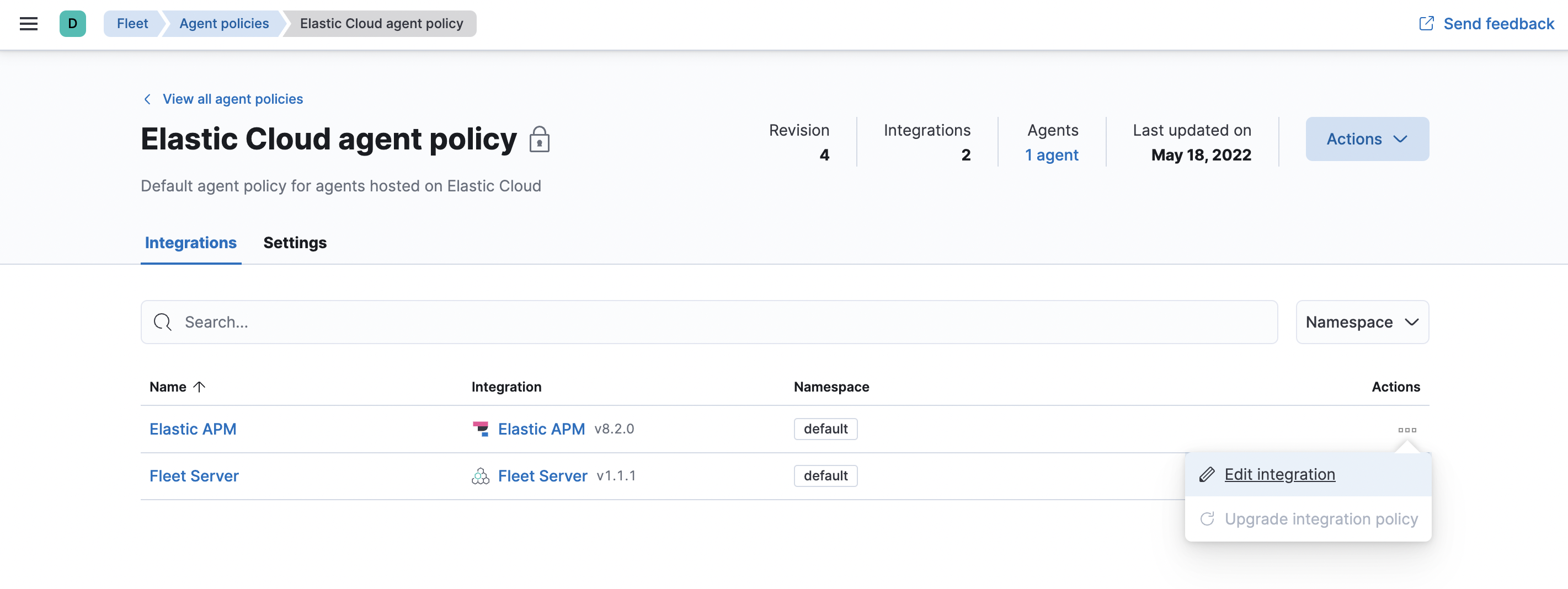

In Kibana, navigate to Fleet > Agent policies and select the Elastic Cloud agent policy. This is the default agent policy for Elastic Agents hosted on Elastic Cloud.
Next to Elastic APM in the Actions column, select Edit integration to configure the APM integration.
- Make a note of the predefined URL that the APM Server is listening on—you’ll need this in the next step.
- If you made any changes to your configuration, click save and continue.

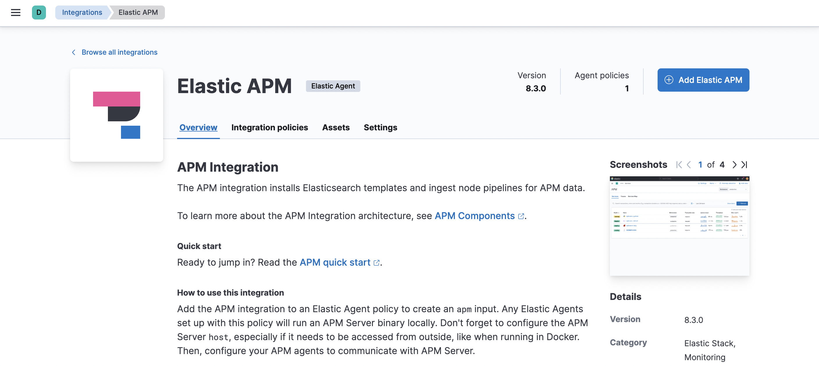

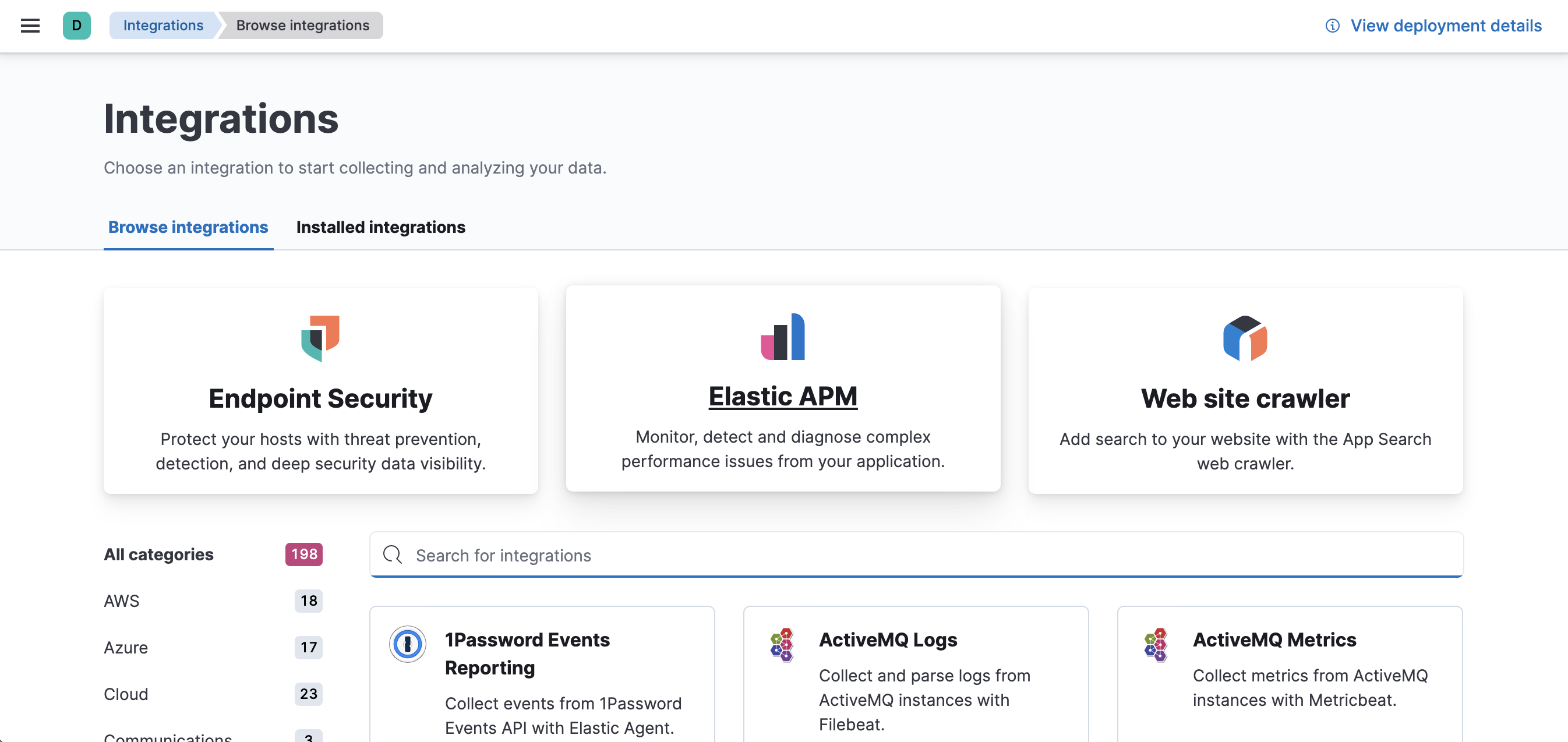

In Kibana, select Add integrations > Elastic APM.
Click Add Elastic APM.

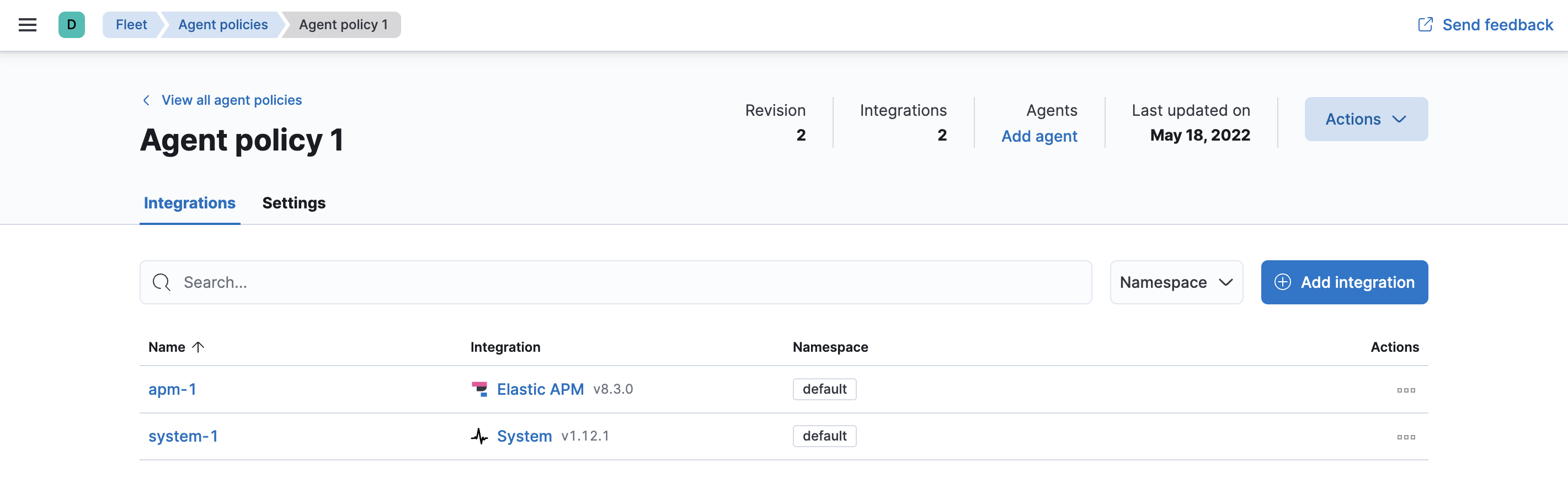

- On the Add Elastic APM integration page, define the host and port where APM Server will listen. Make a note of this value—you’ll need it later.
- Click Save and continue. This step takes a minute or two to complete. When it’s done, you’ll have an agent policy that contains an APM integration policy for the configuration you just specified.
To view the new policy, click Agent policy 1.
Any Elastic Agents assigned to this policy will collect APM data from your instrumented services.

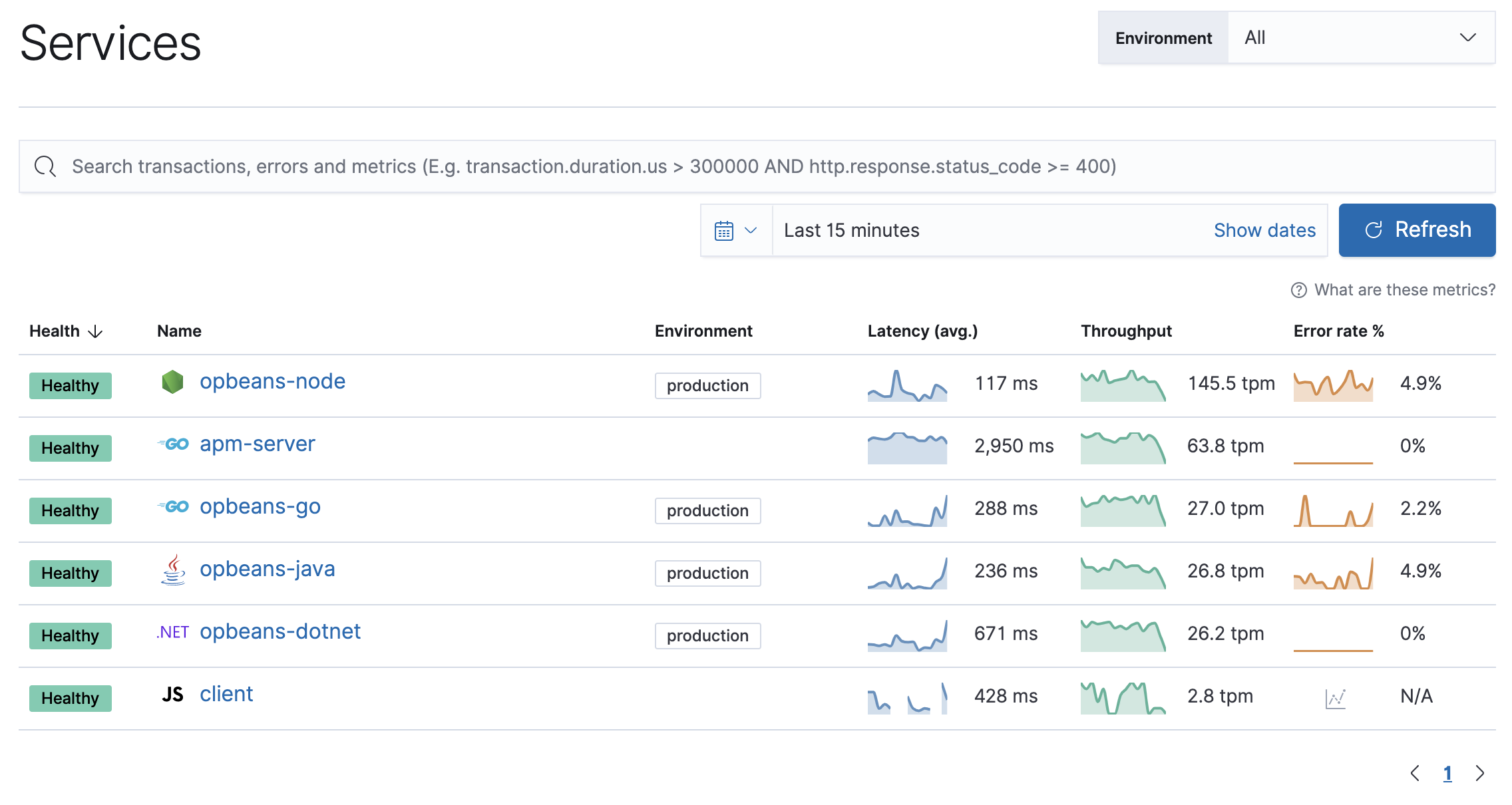

Step 5: View your data
editBack in Kibana, under Observability, select APM. You should see application performance monitoring data flowing into the Elastic Stack!
