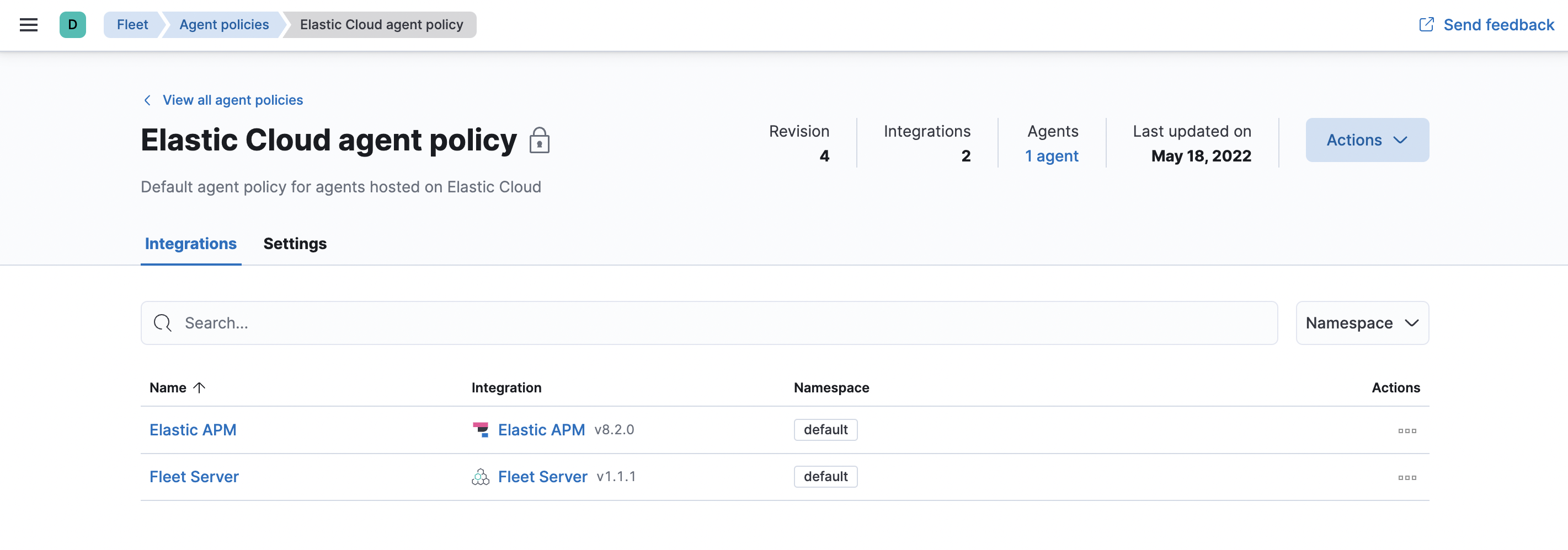

- In Kibana, open the main menu, and go to Management > Fleet.
- On the Agents tab, look for the Elastic Cloud agent policy. This policy is managed by Elastic Cloud, and contains a Fleet Server integration and an Elastic APM integration. You cannot modify the policy. Confirm that the agent status is Healthy.
Don’t see the agent? Make sure your deployment includes an Integrations Server instance. This instance is required to use Fleet.

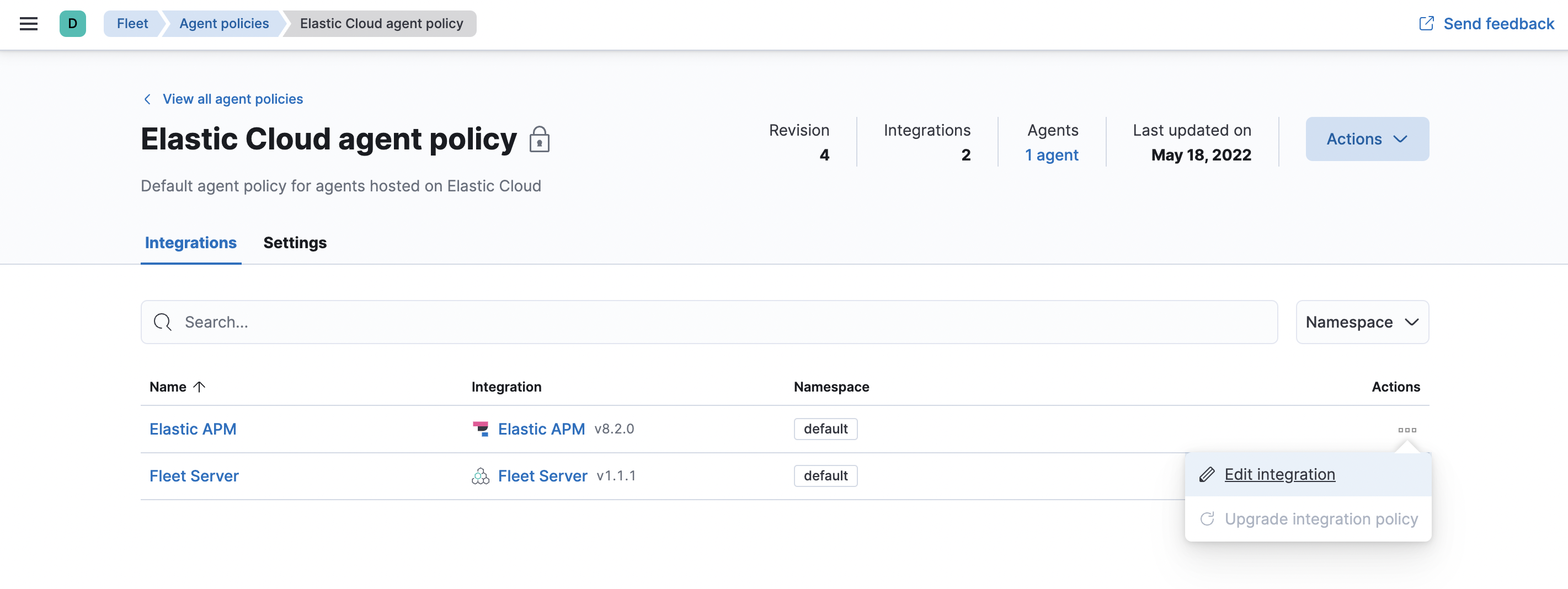

editElastic Cloud runs a hosted version of Integrations Server that includes the APM integration. Self-managed users will need to add the APM integration before configuring it.
In Kibana, navigate to Fleet > Agent policies and select the Elastic Cloud agent policy. This is the default agent policy for Elastic Agents hosted on Elastic Cloud.
Next to Elastic APM in the Actions column, select Edit integration to configure the APM integration.
- Make a note of the predefined URL that the APM Server is listening on—you’ll need this in the next step.
- If you made any changes to your configuration, click save and continue.

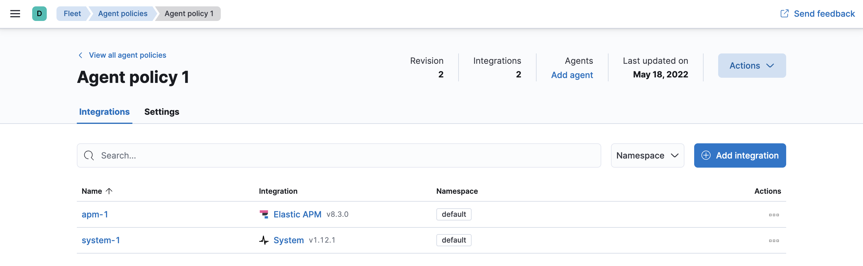

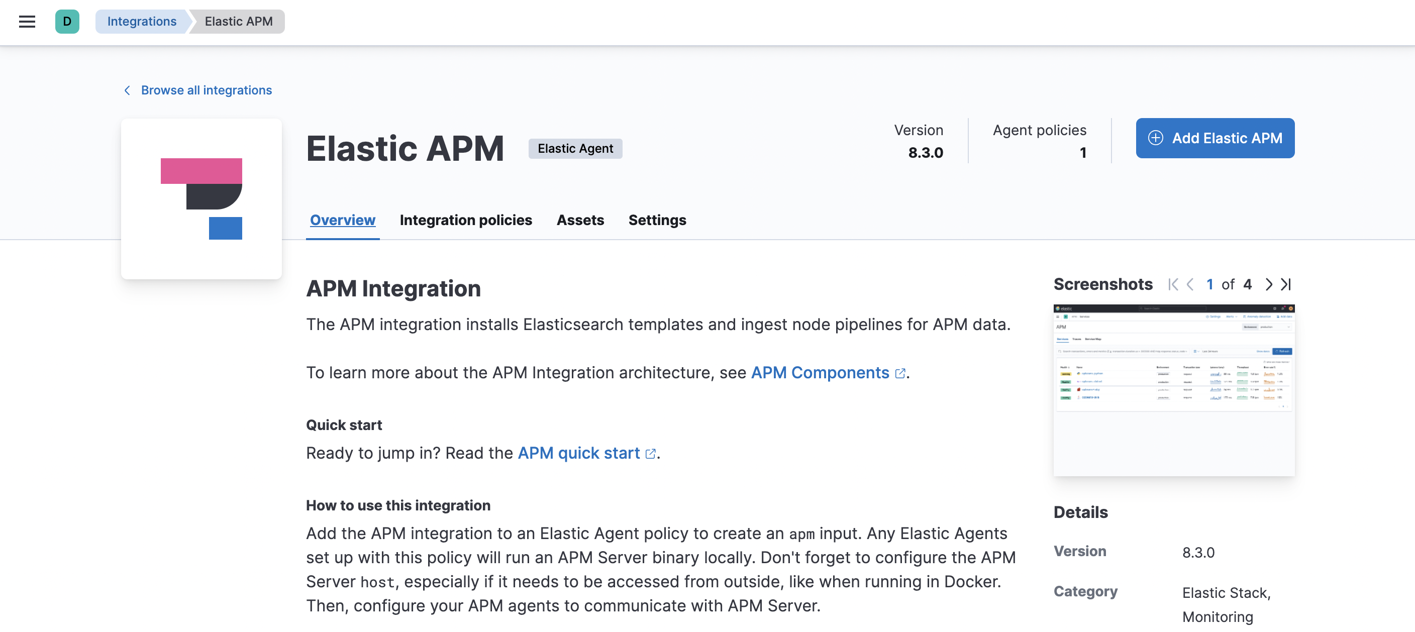

In Kibana, select Add integrations > Elastic APM.
Click Add Elastic APM.
- On the Add Elastic APM integration page, define the host and port where APM Server will listen. Make a note of this value—you’ll need it later.
- Click Save and continue. This step takes a minute or two to complete. When it’s done, you’ll have an agent policy that contains an APM integration policy for the configuration you just specified.
To view the new policy, click Agent policy 1.
