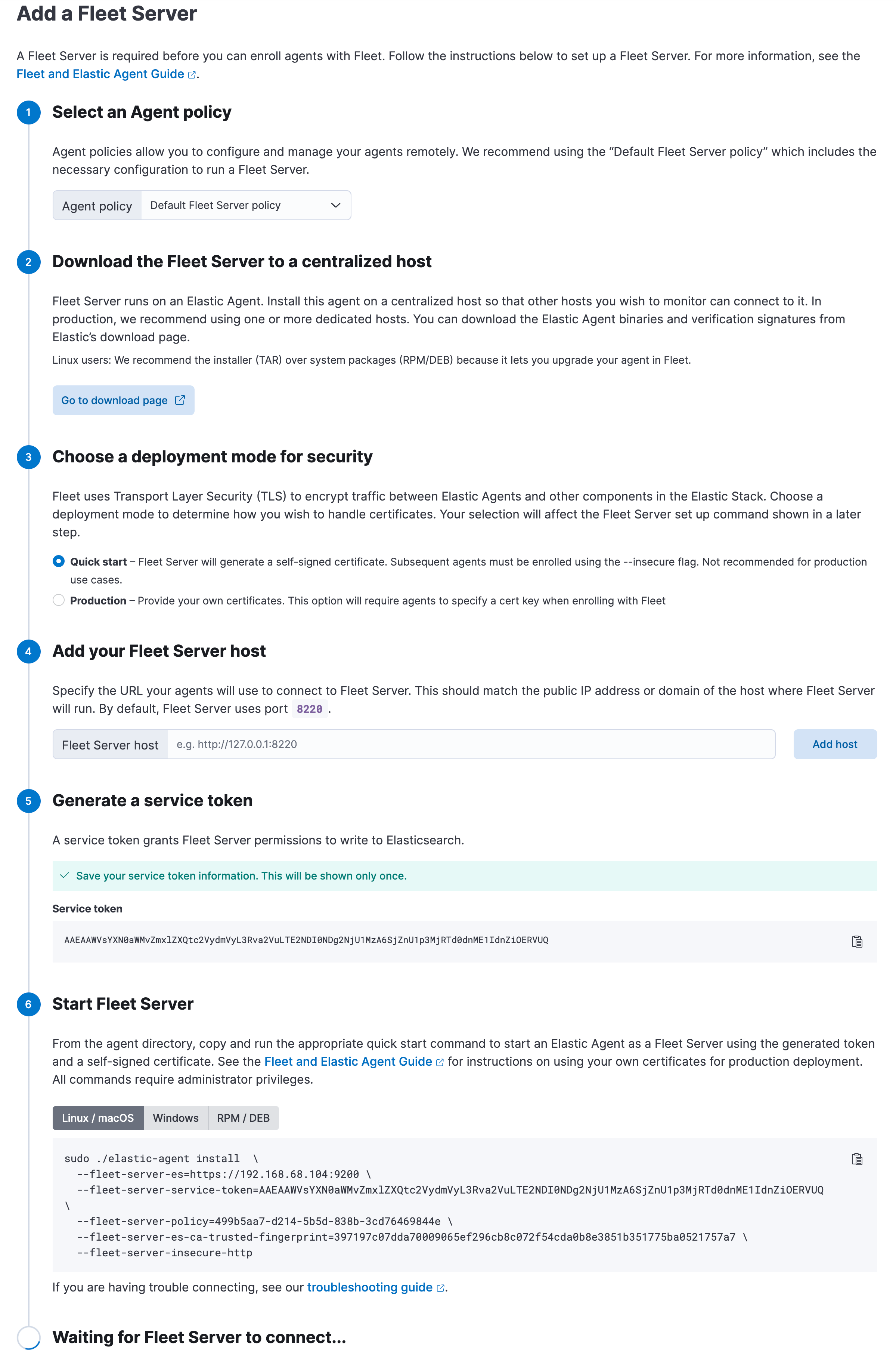

Click the Agents tab and follow the in-product instructions to add a Fleet server:
Notes:
- Make sure you download an x64 architecture installation package.
- For the agent policy, choose one with a Fleet Server integration, or click Create policy to create one now. Alternatively you can create a Fleet Server policy without using the UI, then select the policy here.
- If you choose Production deployment mode, learn how to generate certs in Configure SSL/TLS for self-managed Fleet Servers.
It’s recommended you generate a unique service token for each
Fleet Server. For other ways to generate service tokens, see
elasticsearch-service-tokens. -
The
installcommand installs the Elastic Agent as a managed service and enrolls it in a Fleet Server policy. For example, the following command installs a Fleet Server and uses self-signed certs:sudo ./elastic-agent install \ --fleet-server-es=http://localhost:9200 \ --fleet-server-service-token=AAEbAWVsYXN0aWMvZmxlaXQtc2VydmVzL3Rva2VuLTE2MeIzNTY1NTQ3Mji6dERXeE9XbW5RRTZqNlJMWEdIRzAtZw \ --fleet-server-policy=27467ed1-1bfd-11ec-9b88-a7c3d83e2897 \ --fleet-server-es-ca-trusted-fingerprint=3b24d33844d65532f0584d198b45006747521493522c1912608522bf175bc826 \ --fleet-server-insecure-http
The following command installs a Fleet Server and uses certificates you provide. Make sure you replace the values in angle brackets.
sudo ./elastic-agent install --url=https://192.0.2.1:8220 \ --fleet-server-es=https://192.0.2.0:9200 \ --fleet-server-service-token=AAEAaWVsYXN0aWcvZmxlZXQtc2VydmVyL3rva2VuLTE2MzIzNTYcNTQ3MjI6dER1eE9XbW5RRTZqNlJMWEdIRzAtZw \ --fleet-server-policy=fleet-server-policy \ --fleet-server-es-ca-trusted-fingerprint=a8f3042bc1d2097e94bd8bf75f05v61c0abbaa2eb3e19647c28078bv095ca7c3 \ --certificate-authorities=<PATH_TO_CA> \ --fleet-server-cert=<PATH_TO_FLEET_SERVER_CERT> \ --fleet-server-cert-key=<PATH_TO_FLEET_SERVER_CERT_KEY>
For more Fleet Server commands, see Elastic Agent command reference.

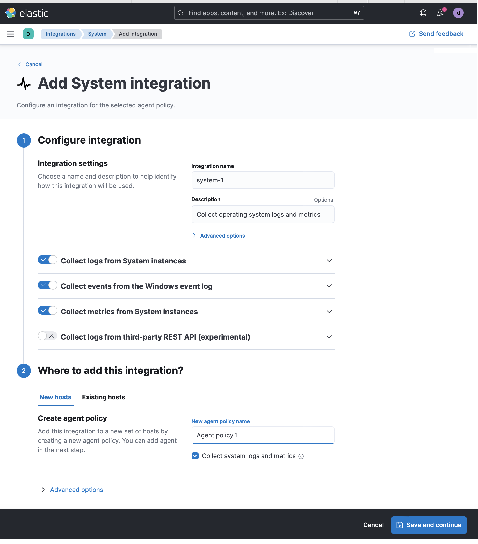

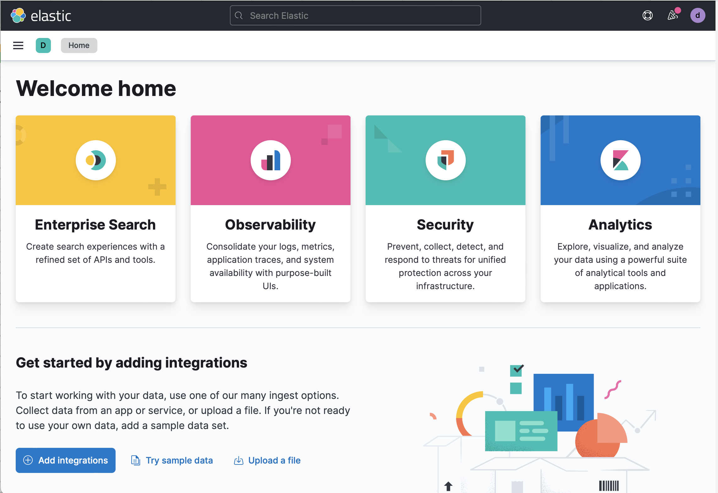

Go to the Kibana home page and click Add integrations.
- In the query bar, search for System and select the integration to see more details about it.
- Click Add System.

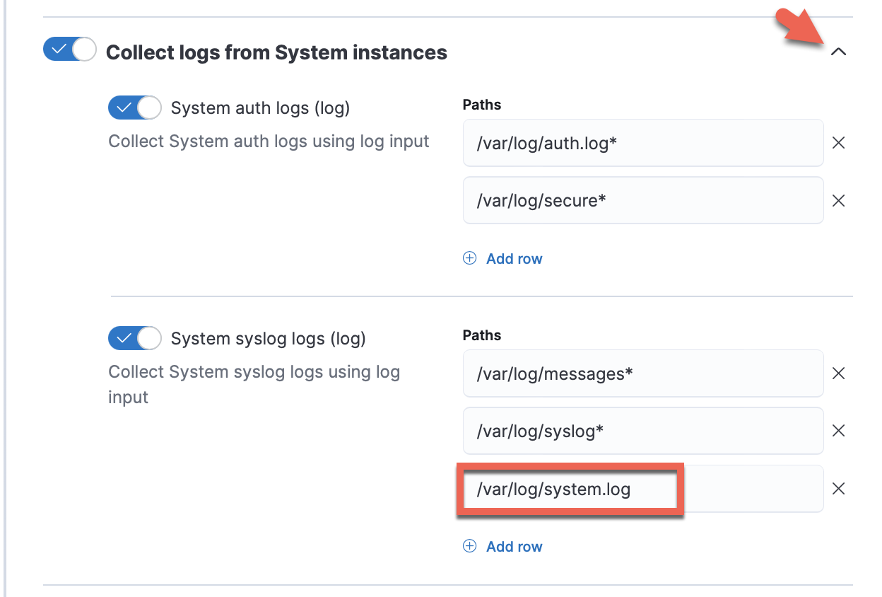

- Configure the integration name and optionally add a description. Make sure that Collect logs from System instances and Collect metrics from System instances are turned on.
Expand each configuration section to verify that the settings are correct for your host. For example, if you’re deploying Elastic Agent on macOS hosts, you need to add a new path to the System syslog logs section by clicking Add row and specifying
/var/log/system.log.
Click Save and continue. This step takes a minute or two to complete. When it’s done, you’ll have an agent policy that contains a system integration policy for the configuration you just specified.

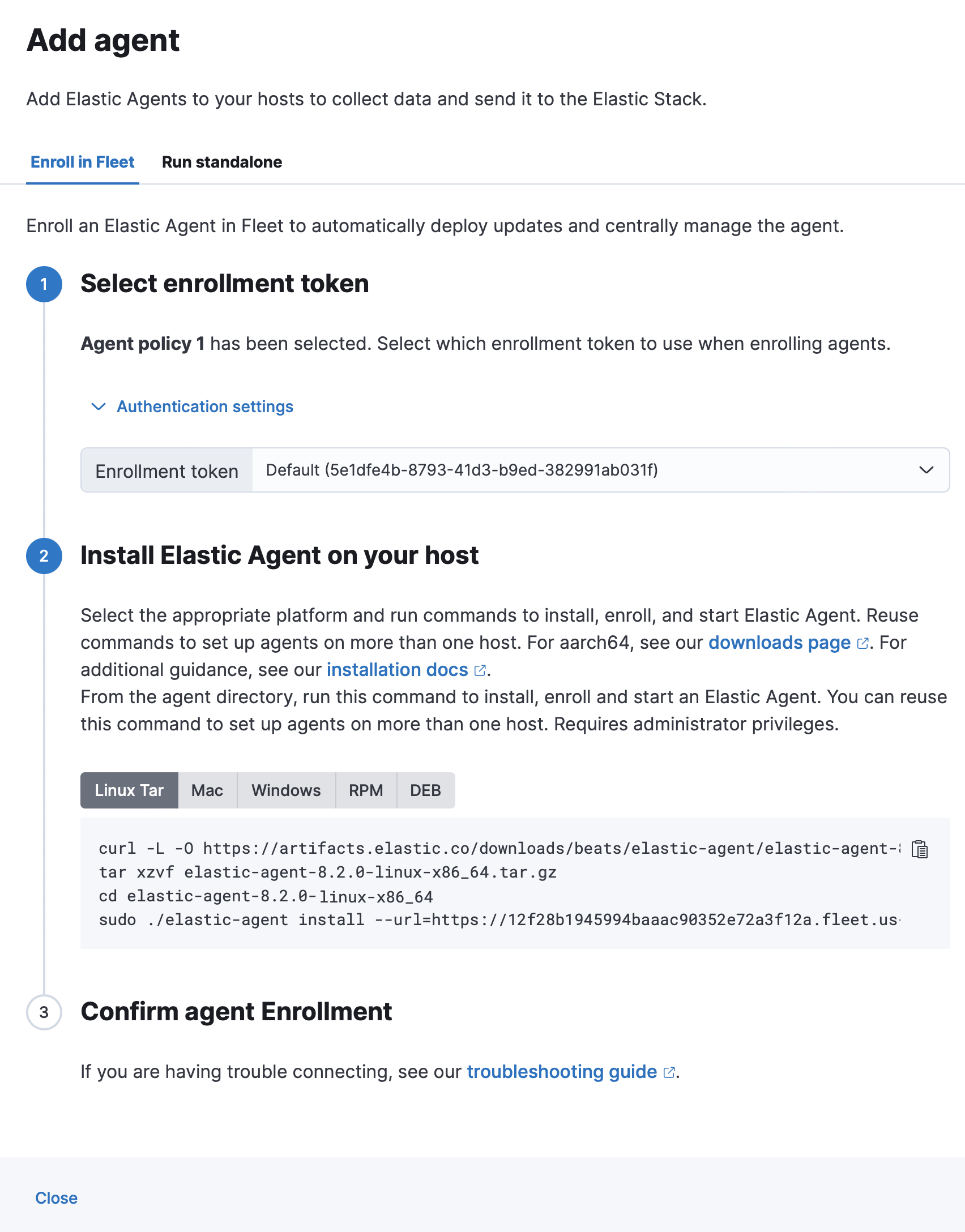

editThe Add agent flyout has two options: Enroll in Fleet and Run standalone. The default is to enroll the agents in Fleet, as this reduces the amount of work on the person managing the hosts by providing a centralized management tool in Kibana.
Skip the Select enrollment token step. The enrollment token you need is already selected.
The enrollment token is specific to the Elastic Agent policy that you just created. When you run the command to enroll the agent in Fleet, you will pass in the enrollment token.
Download, install, and enroll the Elastic Agent on your host by selecting your host operating system and following the Install Elastic Agent on your host step.

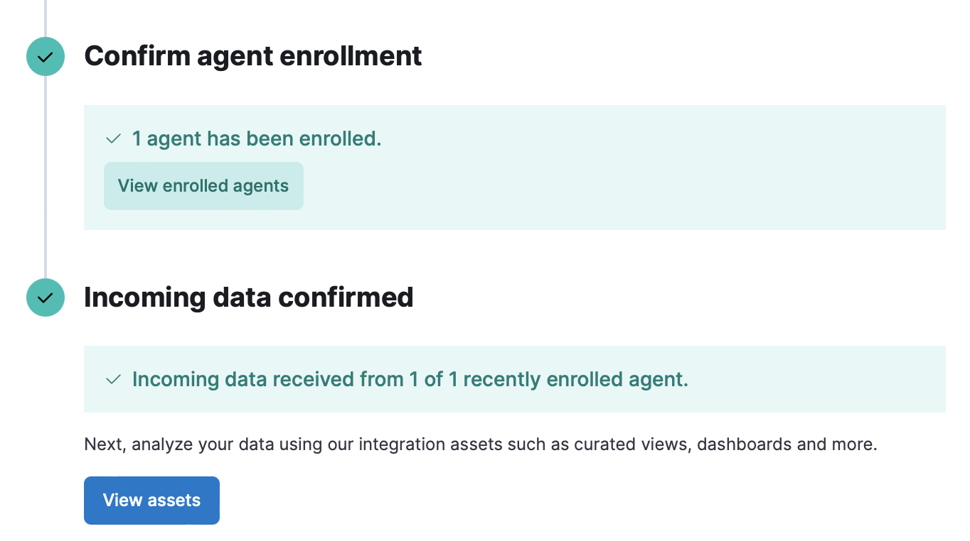

It takes about a minute for Elastic Agent to enroll in Fleet, download the configuration specified in the policy you just created, and start collecting data.
Step 4: Monitor host logs and metrics
edit-

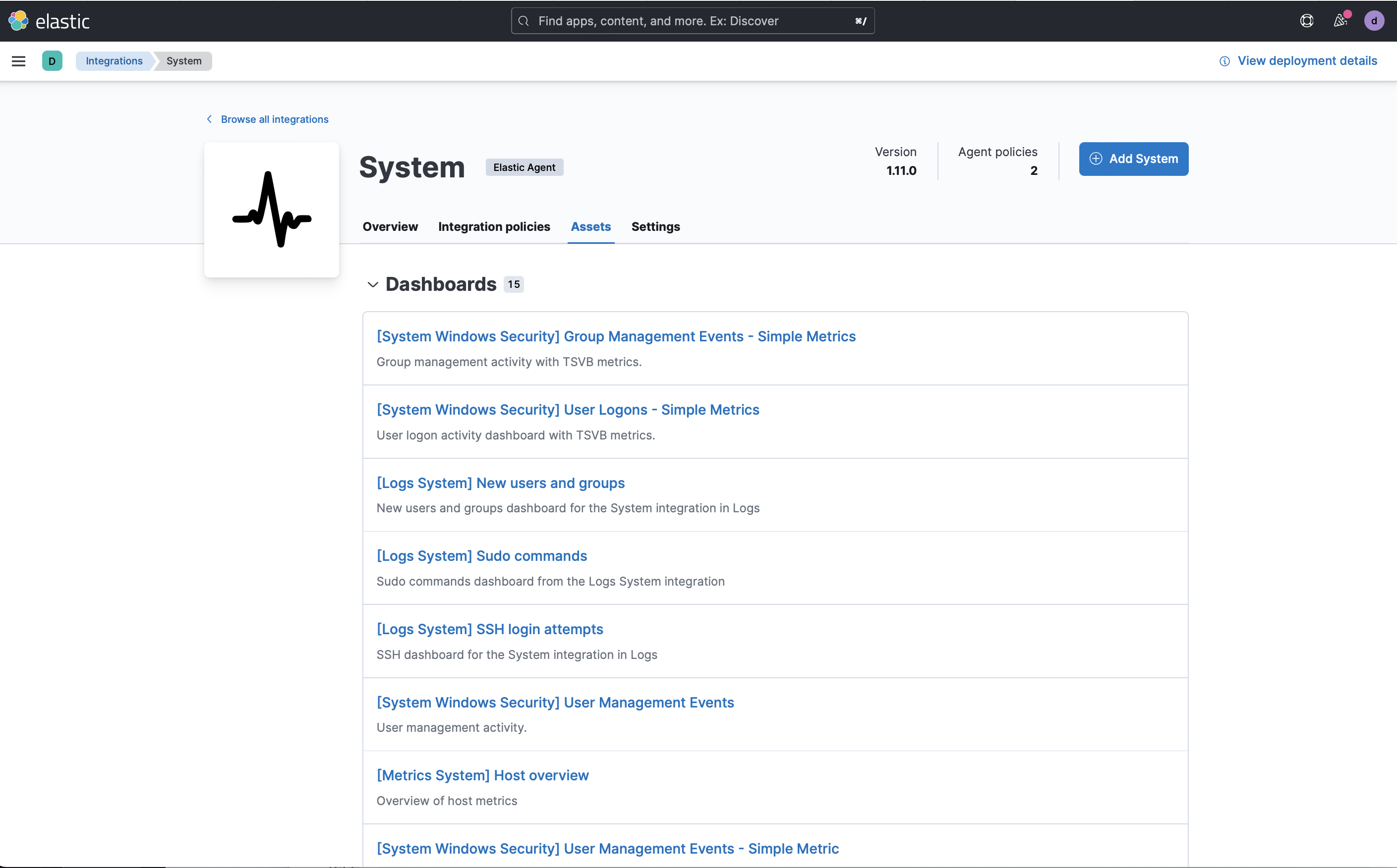

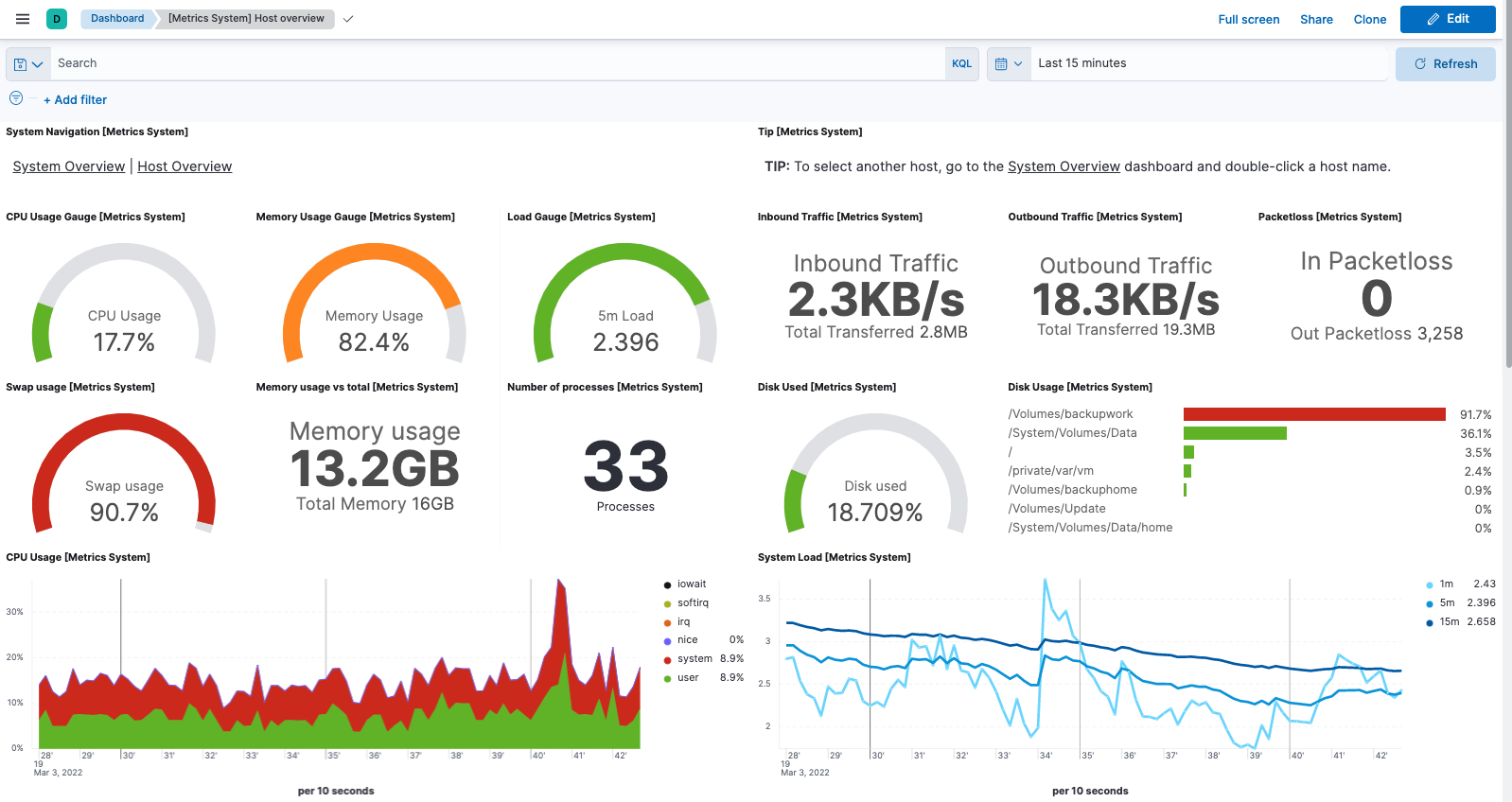

Verify that data is flowing. Wait until agent enrollment is confirmed and incoming data is received, then click View assets to access dashboards related to the System integration.
Choose a dashboard that is related to the operating system of your monitored system. Dashboards are available for Microsoft Windows systems and Unix-like systems (for example, Linux and macOS).
Open the [Metrics System] Host overview dashboard to view performance metrics from your host system.
You can hover over any visualization to adjust its settings, or click the Edit button to make changes to the dashboard. To learn more, refer to Dashboard and visualizations.

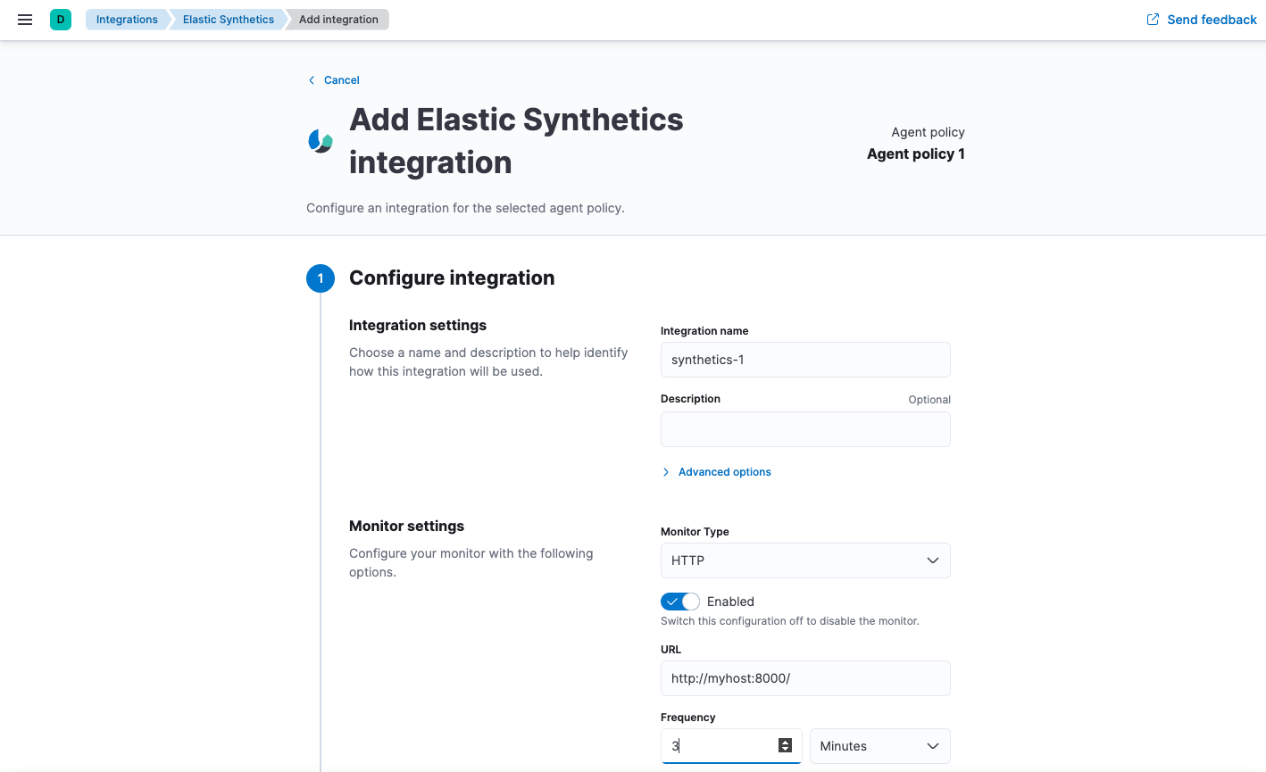

Add the Elastic Synthetics integration to your agent policy. You use policies to manage settings across a group of agents. An agent policy may contain any number of integrations for collecting observability data from the various services running on your host.
- In Kibana, go to the Integrations page (click Add integrations in the home page or main menu).
- In the query bar, search for Elastic Synthetics and select the integration to see more details about it.
- Click Add Elastic Synthetics.
Configure the integration name and select your desired monitor type from the following monitor types:
HTTP
Connects via HTTP and verifies that the host returns the expected response.
For detailed information about HTTP options, refer to our Heartbeat documentation.
TCP
Connects via TCP and verifies the endpoint by sending and receiving a custom payload. By default, the hostname and port are required.
For detailed information about TCP options, refer to our Heartbeat documentation.
ICMP
Uses an ICMP
v4andv6Echo Request to ping the configured hosts. By default, the host name is required.For detailed information about ICMP options, refer to our Heartbeat documentation.
Browser
Runs automated tests using a real Chromium browser via the synthetics agent.
For detailed information about browser options, refer to our Heartbeat documentation.
To create a browser monitor, you must use the elastic-agent-complete Docker container as this contains the dependencies necessary to run browser monitors. To learn more, refer to Set up monitors.
Enter the URL you want to monitor for availability, and select a monitor interval in seconds or minutes. By default, a monitoring schedule of every 3 minutes is selected.

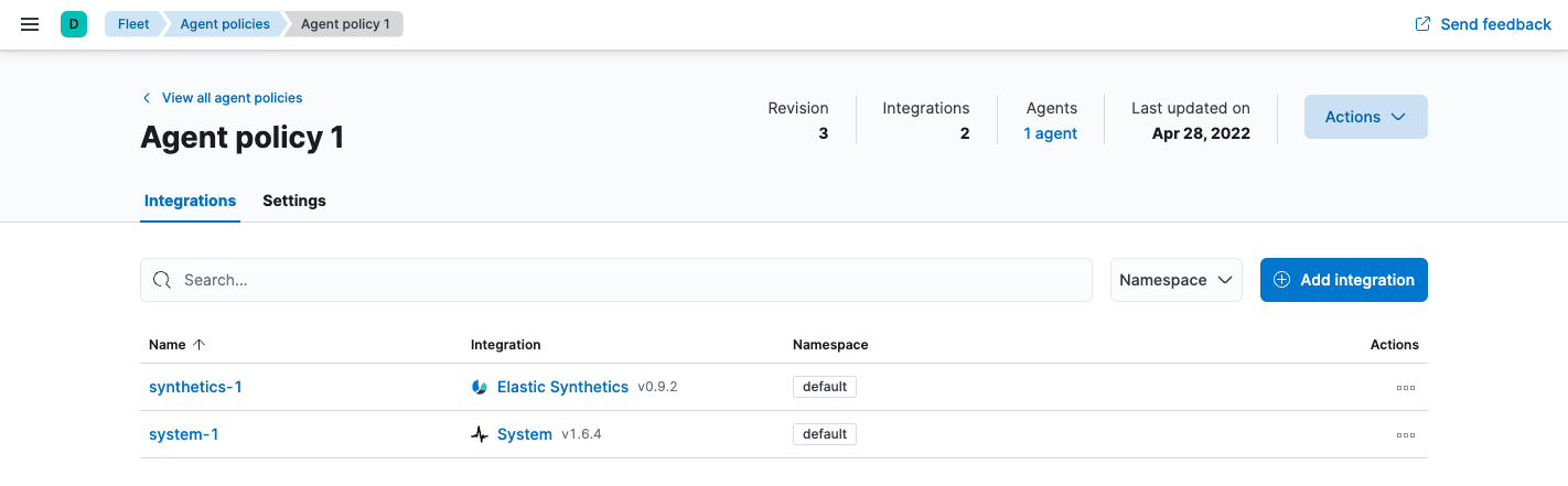

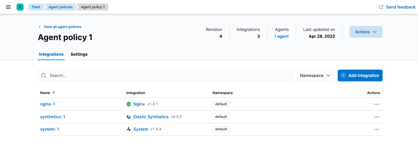

To see the updated policy, click the agent policy link, for example, Agent policy 1.
The newly added Elastic Synthetics integration should appear on the Integrations tab in the agent policy, along with the System integration.
Any Elastic Agents assigned to this policy will collect logs, metrics, and uptime data from the host.
