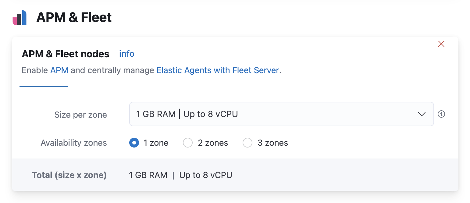

Don’t see the Fleet Server agent? Make sure your deployment includes an APM & Fleet node. This node is required to use Fleet Server.
When using our hosted Elasticsearch Service, it’s recommended that you use our hosted version of Fleet Server. However, you can choose to deploy and self-manage Fleet Servers.

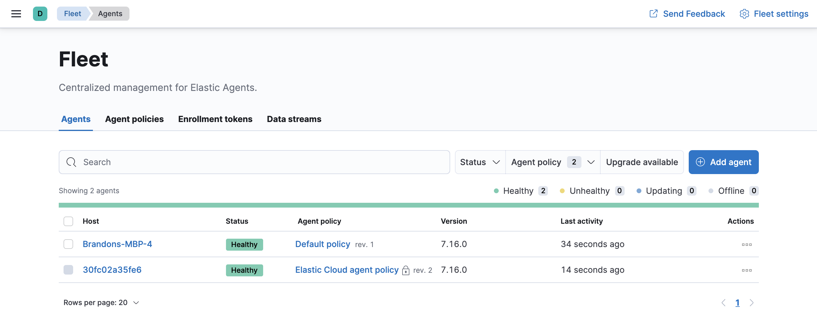

To confirm that Elastic Agent is installed and running, go to the Agents tab in Fleet. Notice that the Default policy is assigned to the agent.
If the status hangs at Enrolling, make sure the elastic-agent
process
is running.

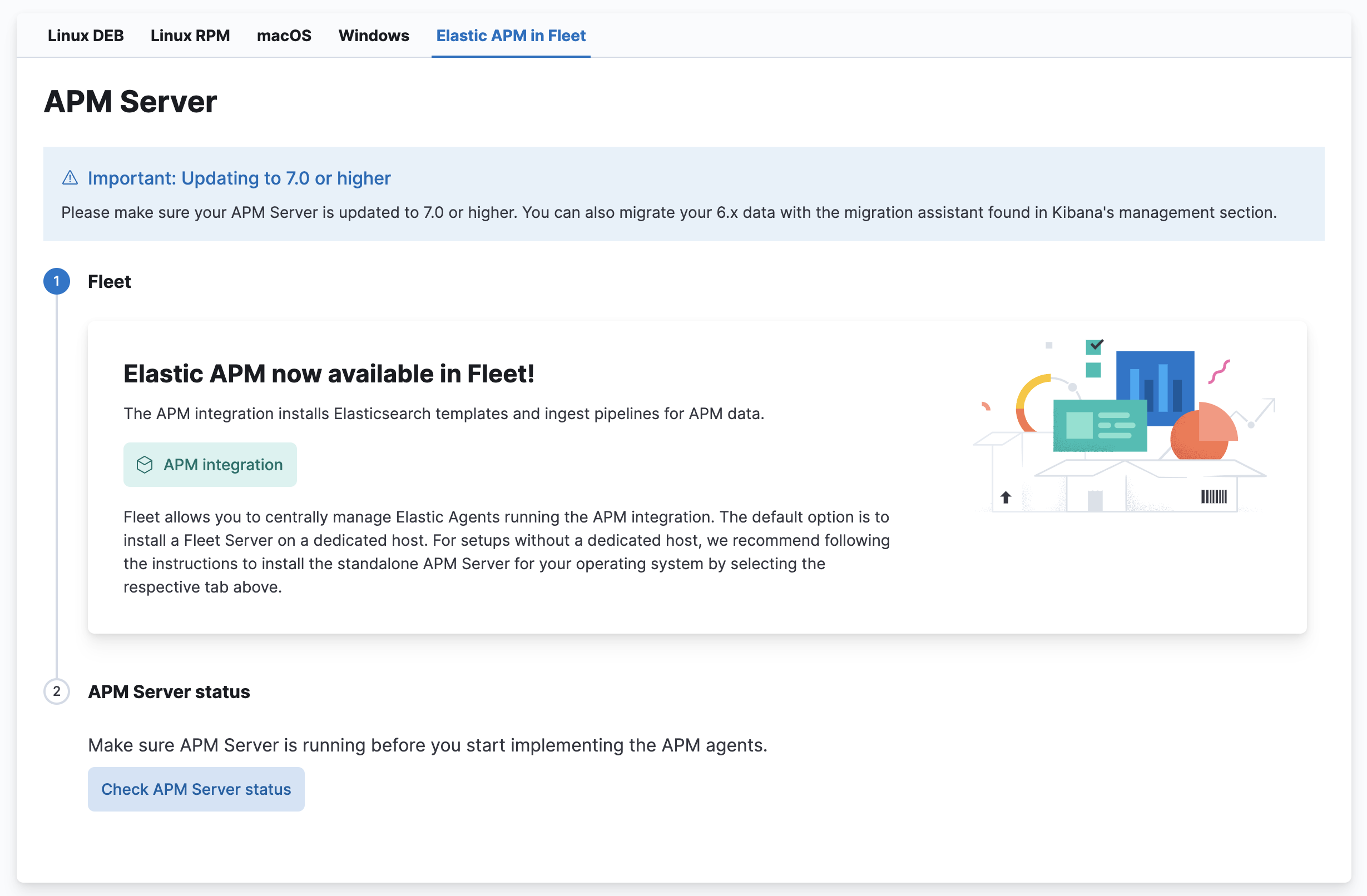

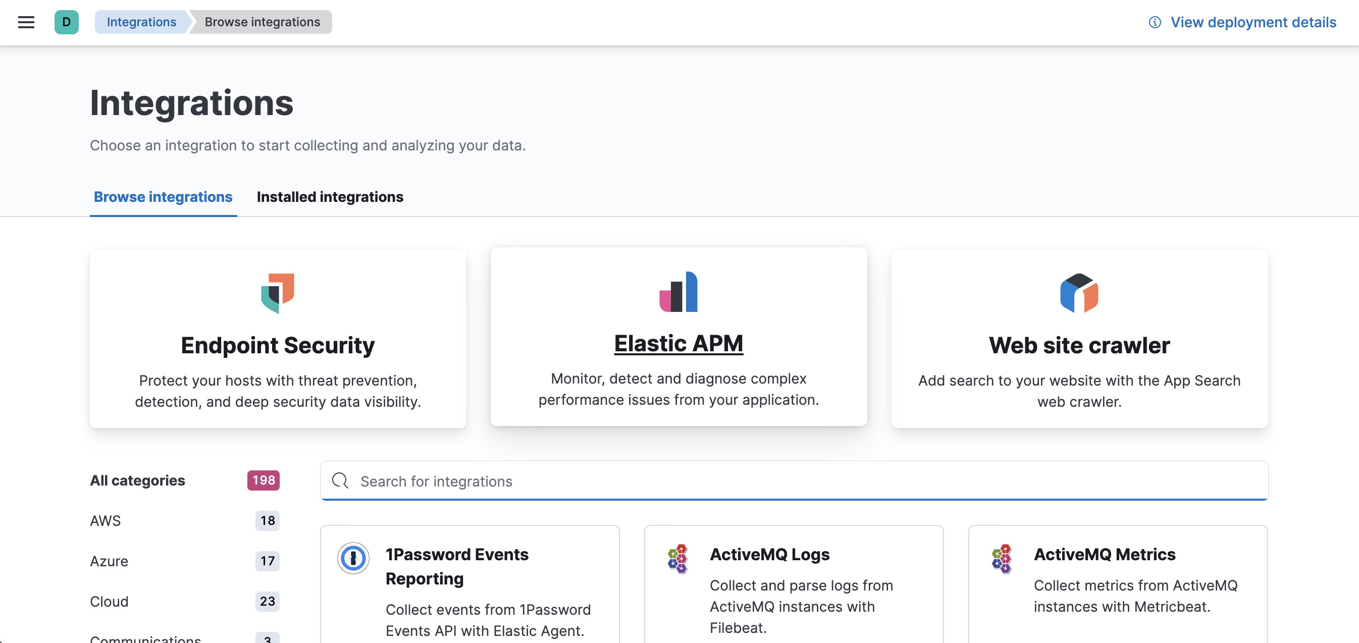

In Kibana, select Add integrations > Elastic APM.
Click APM integration.
Click Switch to Elastic Agent.

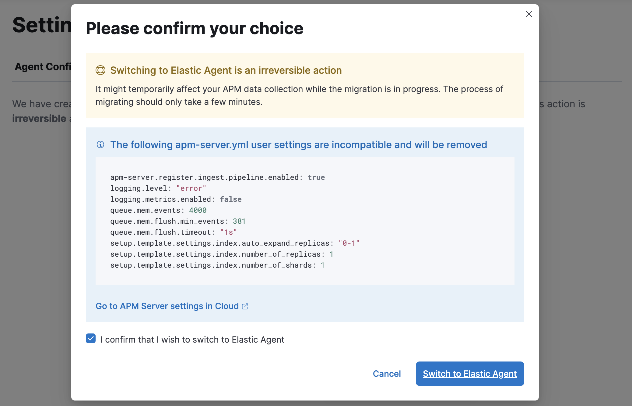

Confirm that you wish to switch to Elastic Agent. Some
apm-server.yml
are incompatible with Elastic Agent and will be removed when Elastic Agent is enabled. Click Switch to Elastic Agent. - When the APM integration finishes setting up, click View the APM integration in Fleet.

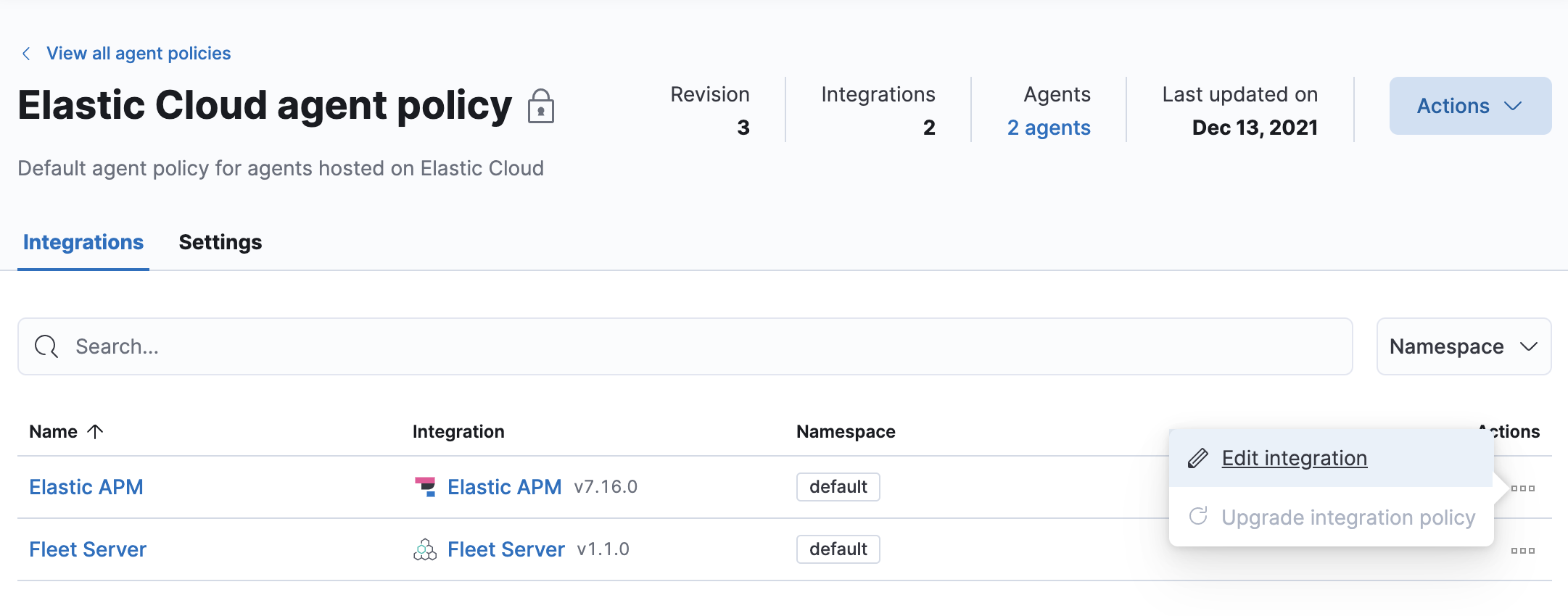

As you can see, the APM integration has been added to the Elastic Cloud Agent policy. This is the default policy for Elastic Agents hosted on Elastic Cloud. Select Actions > Edit integration to configure the APM integration.
- Make a note of the predefined Host and URL that the APM Server is listening on—you’ll need these in the next step. If you made any changes to your configuration, click save and continue.

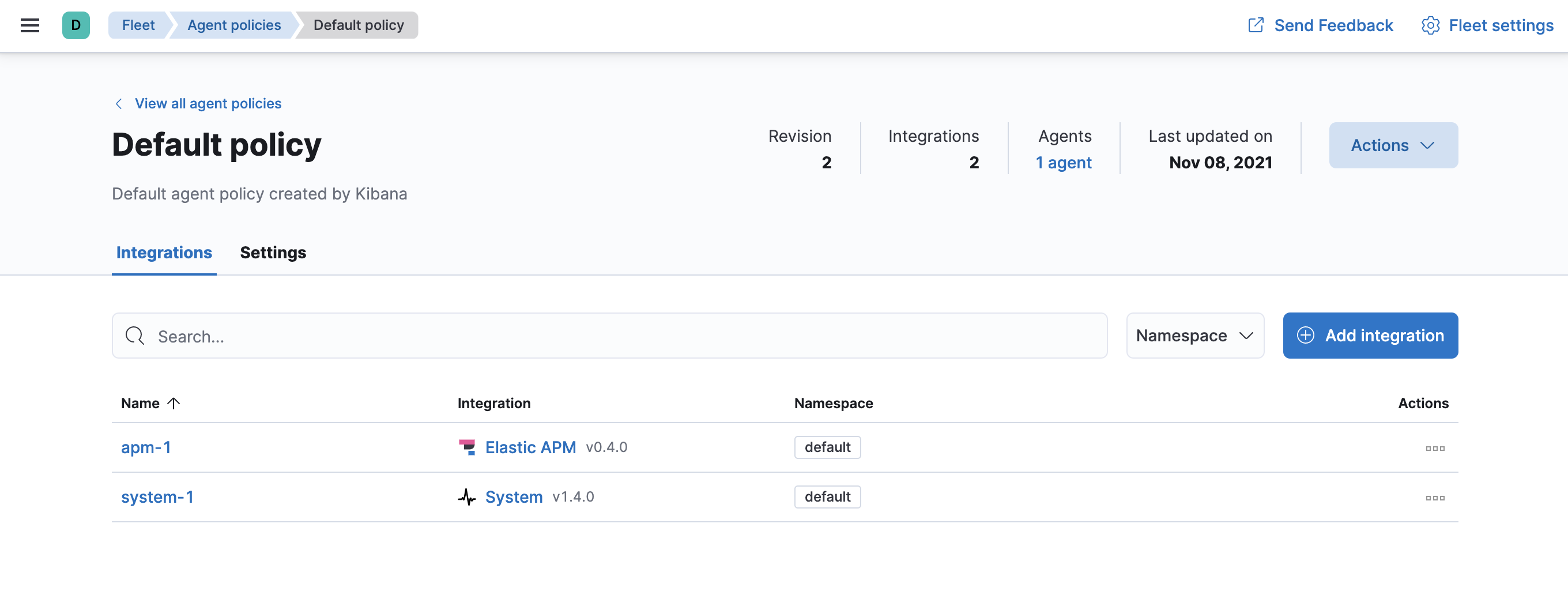

In this guide, you add integrations to the default policy created by Kibana. After you learn the basics, you can create your own policies and assign them to agents.
To see the updated policy, click the Default policy link.

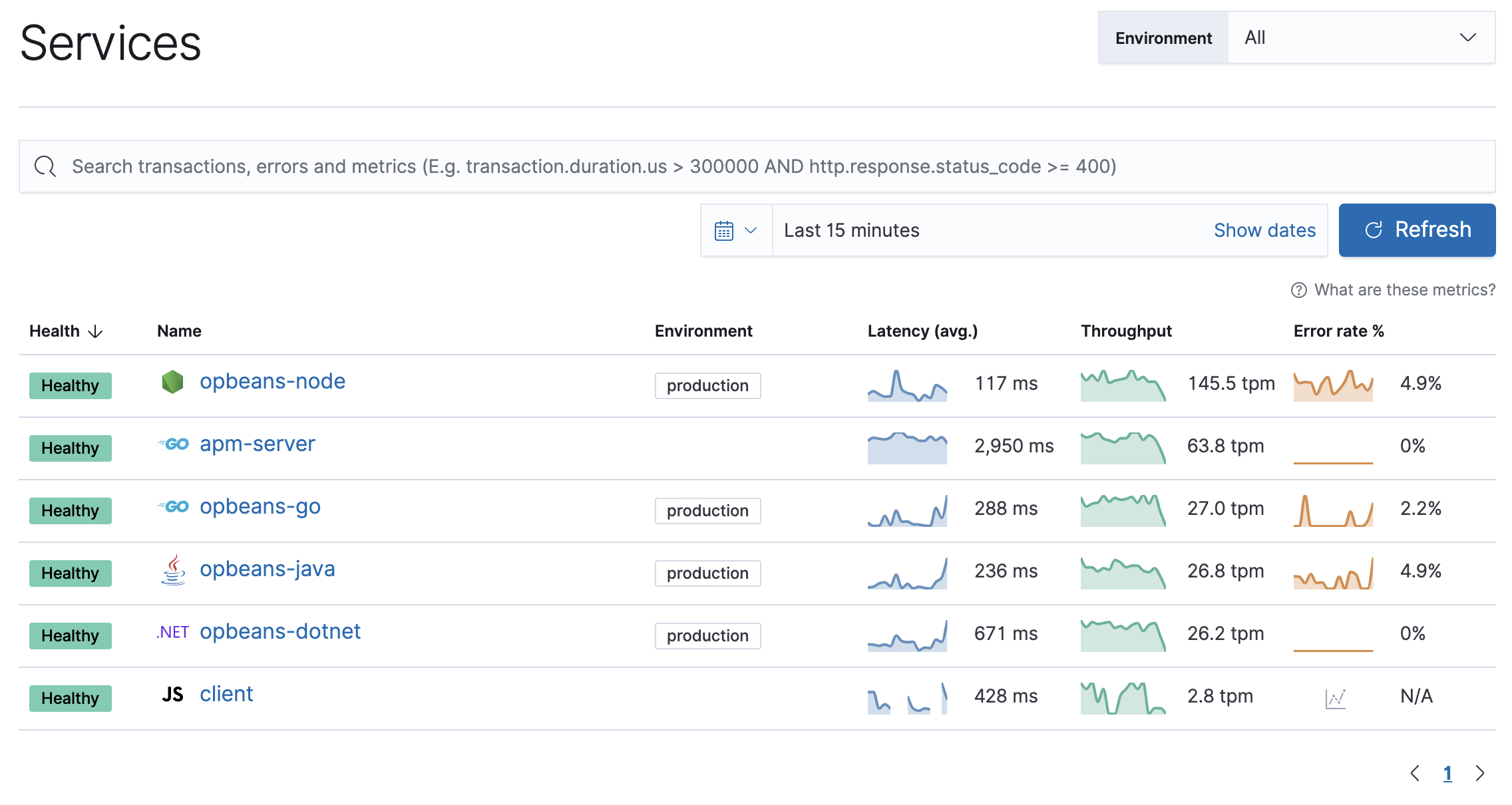

The newly added APM integration should appear under Fleet > Agent policies > Default policy, along with the default System integration.
All Elastic Agents that use this policy will collect APM data from your instrumented services.

Step 5: View your dataedit
Back in Kibana, under Observability, select APM. You should see application performance monitoring data flowing into the Elastic Stack!
The built-in apm_user
role is not compatible with the APM integration
as it only provides read access to apm-*
indices.
For a list of indices users need access to, refer to
APM data streams
