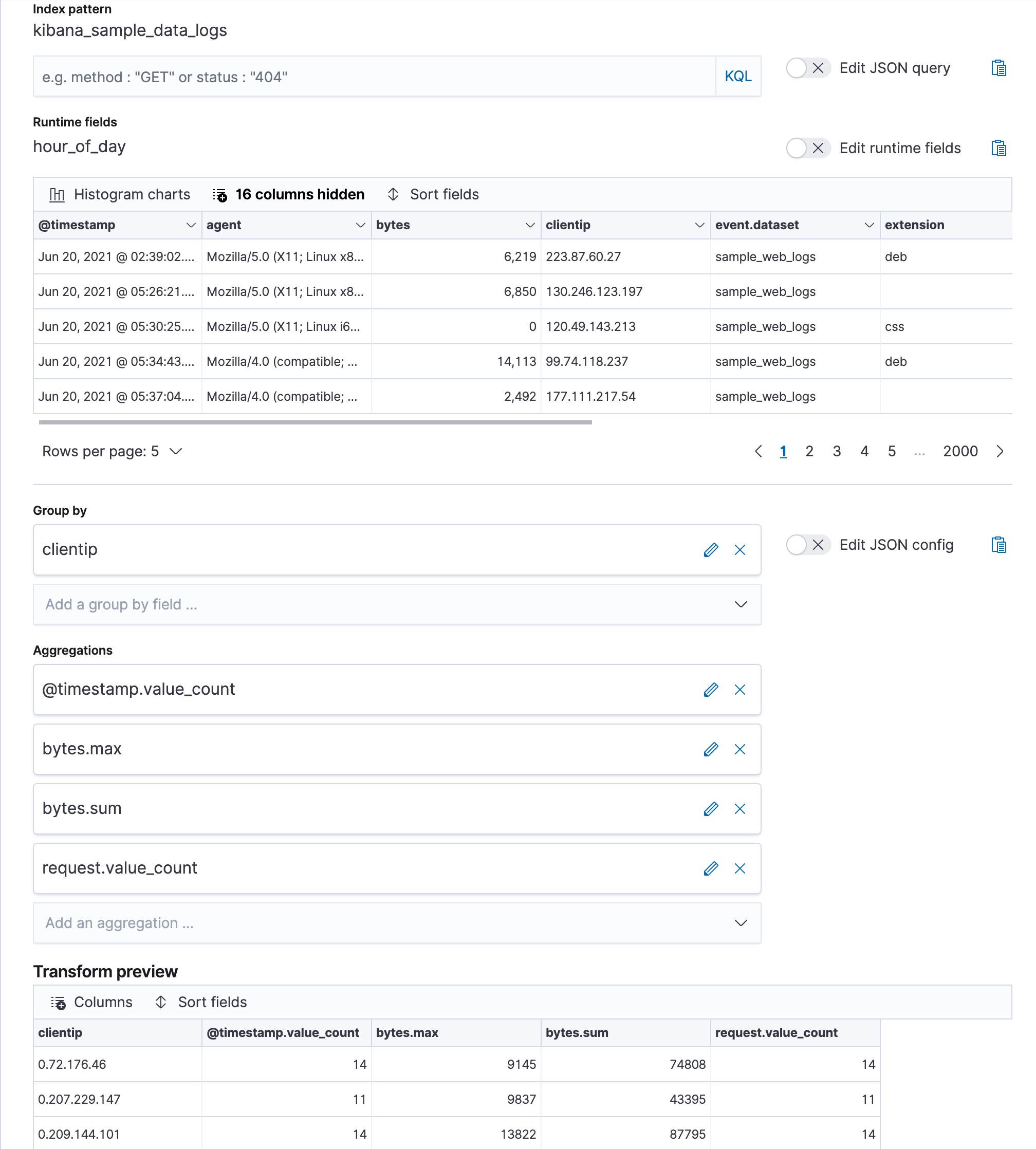

  2. Create a transform that generates an entity-centric index with numeric or boolean data to analyze.
    In this example, we’ll use the web logs sample data and pivot the data such that we get a new index that contains a network usage summary for each client IP.
    In particular, create a transform that calculates the number of occasions when a specific client IP communicated with the network (@timestamp.value_count), the sum of the bytes that are exchanged between the network and the client’s machine (bytes.sum), the maximum exchanged bytes during a single occasion (bytes.max), and the total number of requests (request.value_count) initiated by a specific client IP.
    You can preview the transform before you create it in Stack Management > Transforms:
    Creating a transform in Kibana
    Alternatively, you can use the preview transform API and the create transform API.

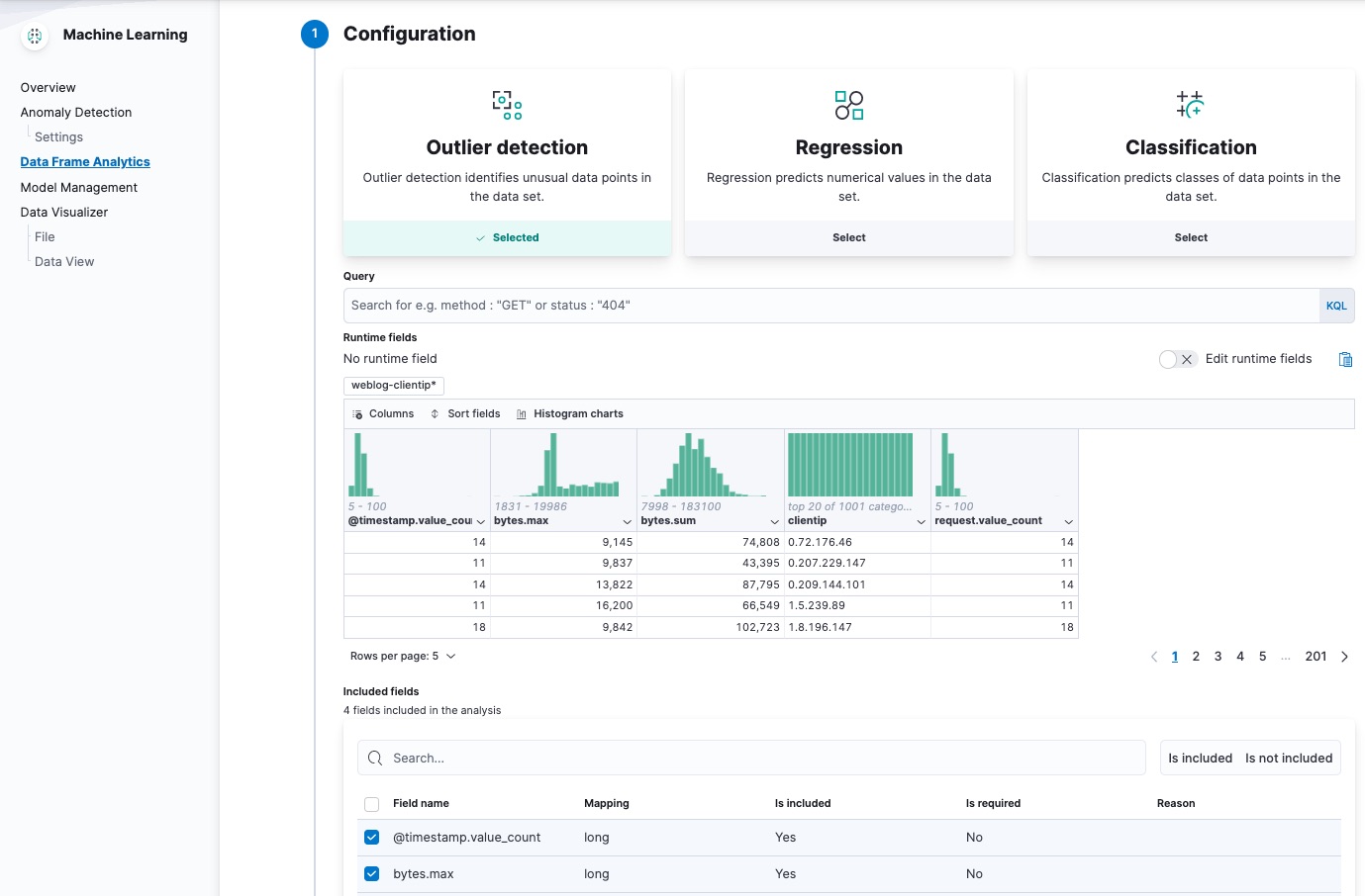

  4. Create a data frame analytics job to detect outliers in the new entity-centric index.
    In the wizard on the Machine Learning > Data Frame Analytics page in Kibana, select your new data view then use the default values for outlier detection. For example:
    Create a data frame analytics job in Kibana

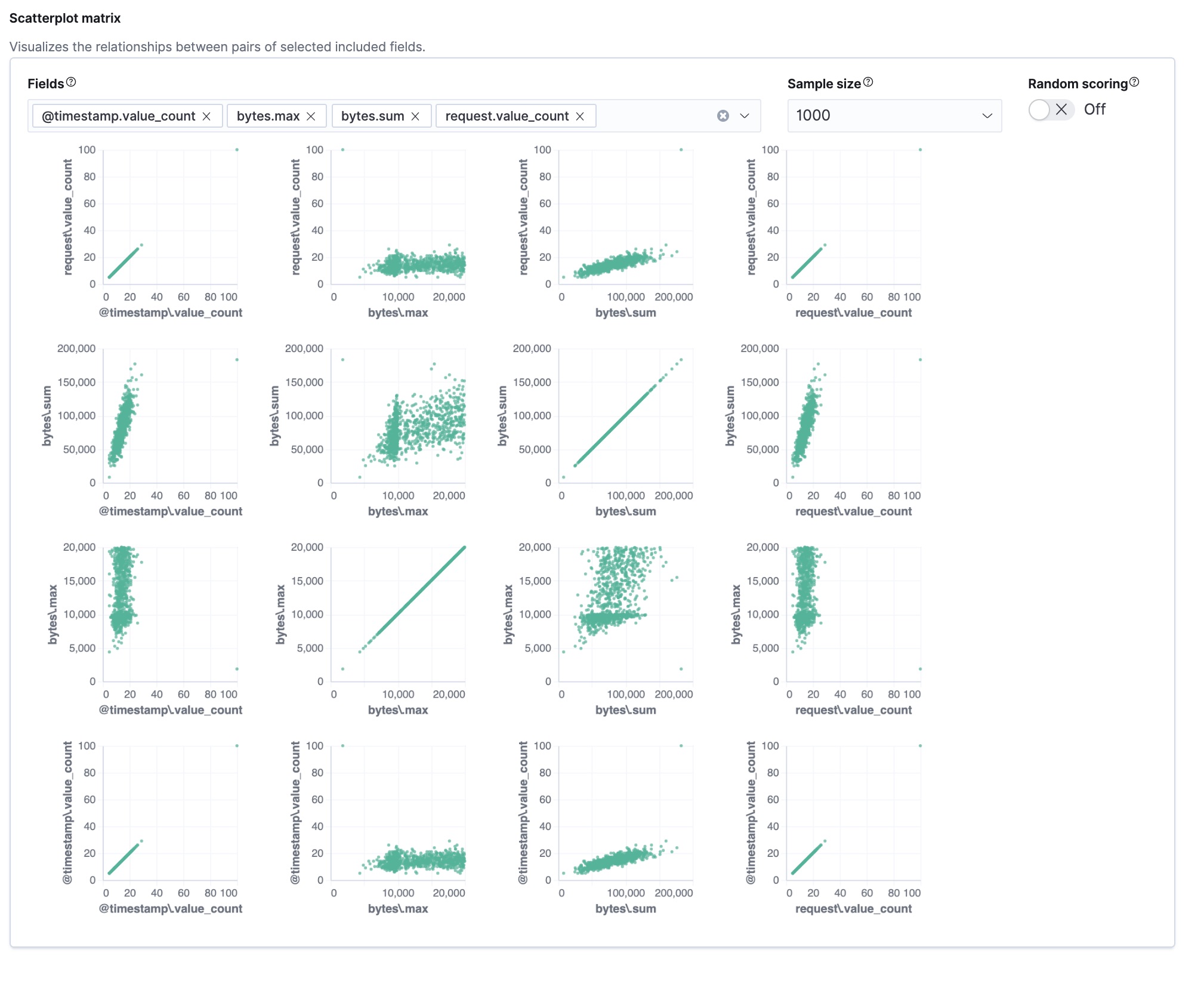

    The wizard includes a scatterplot matrix, which enables you to explore the relationships between the fields. You can use that information to help you decide which fields to include or exclude from the analysis.
    A scatterplot matrix for three fields in Kibana
    If you want these charts to represent data from a larger sample size or from a randomized selection of documents, you can change the default behavior. However, a larger sample size might slow down the performance of the matrix and a randomized selection might put more load on the cluster due to the more intensive query.

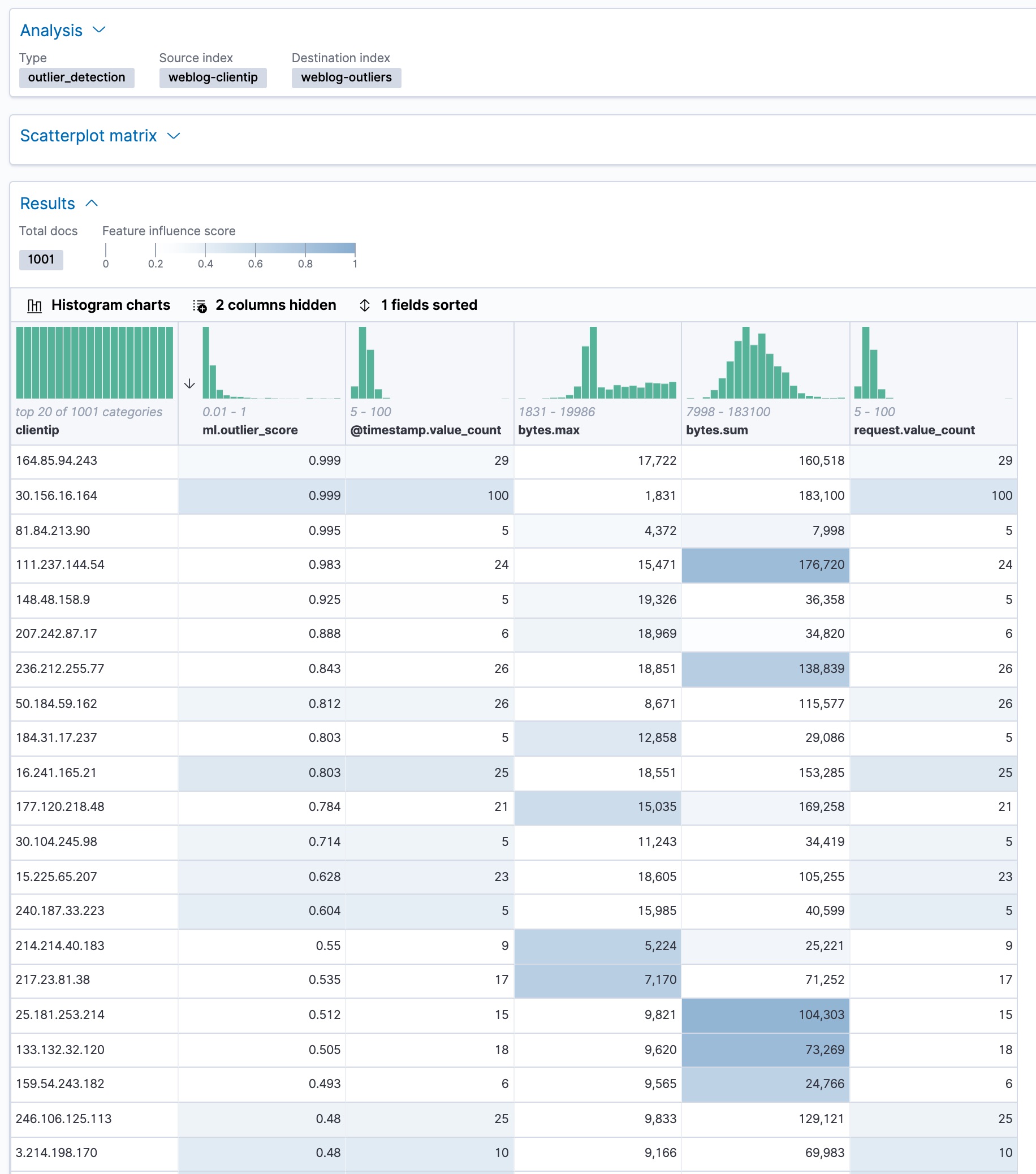

    The data frame analytics job creates an index that contains the original data and outlier scores for each document. The outlier score indicates how different each entity is from other entities.
    In Kibana, you can view the results from the data frame analytics job and sort them on the outlier score:
    View outlier detection results in Kibana
    The ml.outlier score is a value between 0 and 1. The larger the value, the more likely they are to be an outlier. In Kibana, you can optionally enable histogram charts to get a better understanding of the distribution of values for each column in the result.
    In addition to an overall outlier score, each document is annotated with feature influence values for each field. These values add up to 1 and indicate which fields are the most important in deciding whether an entity is an outlier or inlier. For example, the dark shading on the bytes.sum field for the client IP 111.237.144.54 indicates that the sum of the exchanged bytes was the most influential feature in determining that that client IP is an outlier.
    If you want to see the exact feature influence values, you can retrieve them from the index that is associated with your data frame analytics job.

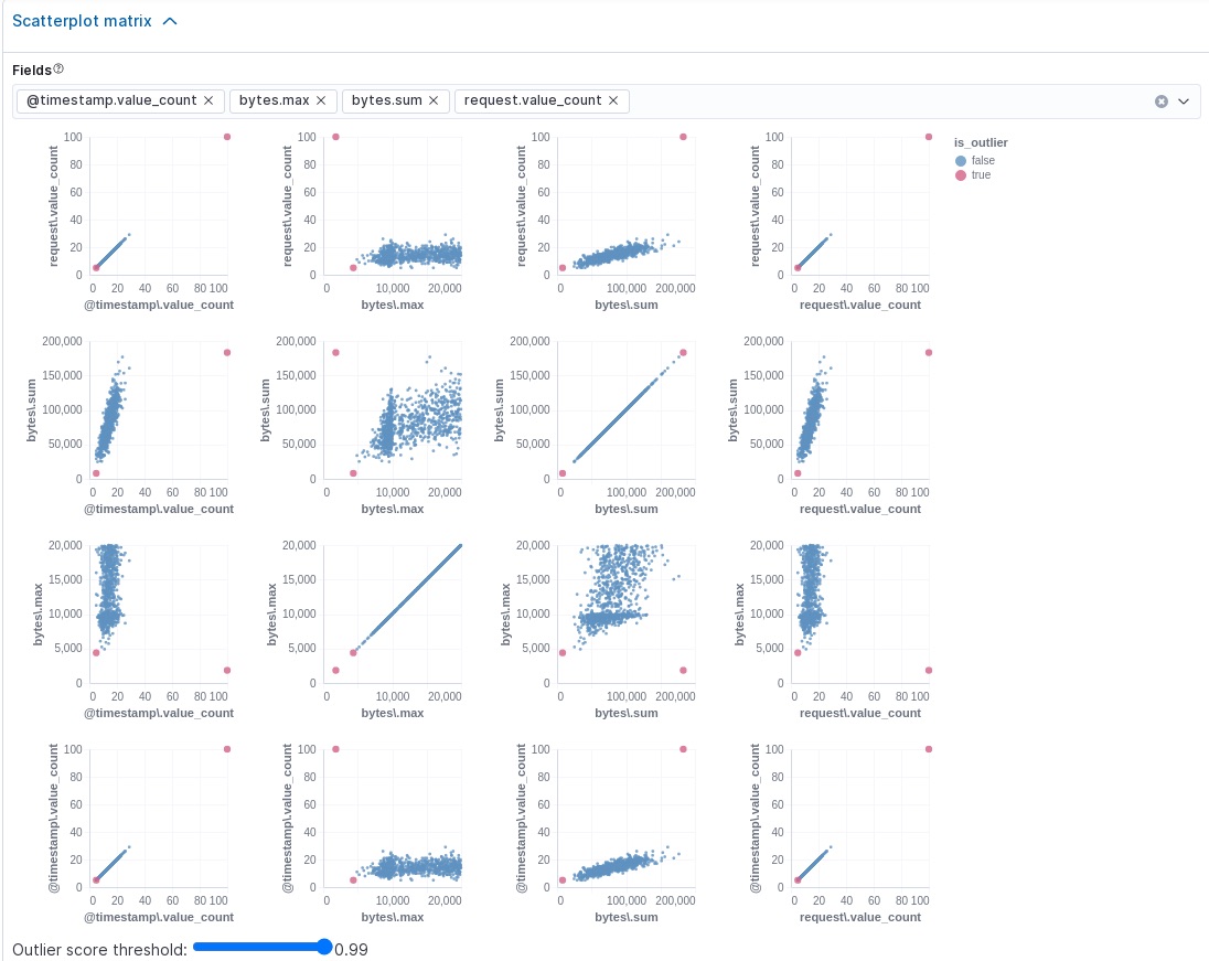

    Kibana also provides a scatterplot matrix in the results. Outliers with a score that exceeds the threshold are highlighted in each chart. The outlier score threshold can be set by using the slider under the matrix:
    View scatterplot in outlier detection results
    You can highlight an area in one of the charts and the corresponding area is also highlighted in the rest of the charts. This function makes it easier to focus on specific values and areas in the results. In addition to the sample size and random scoring options, there is a Dynamic size option. If you enable this option, the size of each point is affected by its outlier score; that is to say, the largest points have the highest outlier scores. The goal of these charts and options is to help you visualize and explore the outliers within your data.
