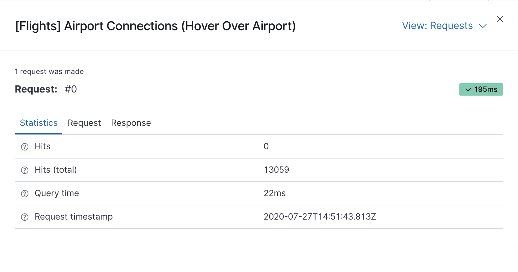

To generate the data, Vega-Lite uses the source_0 and data_0. source_0 contains the results from the Elasticsearch query, and data_0 contains the visually encoded results that are shown on the chart. To debug the warning, compare source_0 and data_0.
  1. In the toolbar, click Inspect.
  2. From the View dropdown, select Vega debug.
  3. From the dropdown, select source_0.

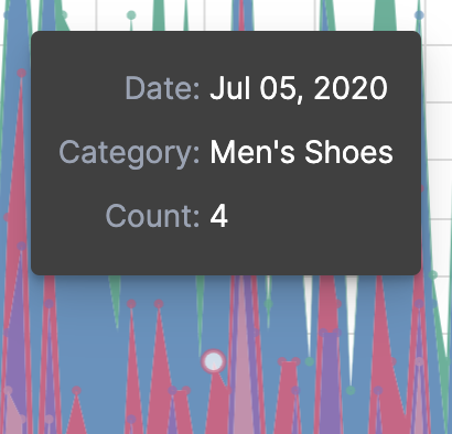

Add hover states and tooltipsedit
With the Vega-Lite spec, you can add hover states and tooltips to the stacked area chart with the selection block.
In the Vega-Lite spec, add the encoding block, then click Update:
  encoding: {
    tooltip: [{
      field: buckets.key
      type: temporal
      title: "Date"
      field: key
      type: nominal
      title: "Category"
      field: buckets.doc_count
      type: quantitative
      title: "Count"
When you hover over the area series on the stacked area chart, a multi-line tooltip appears, but is unable to indicate the nearest point. To indicate the nearest point, add a second layer.

Additional tooltip stylingedit
Kibana has installed the Vega tooltip plugin, so tooltips can be defined in the ways documented there. Beyond that, Kibana also supports a configuration option for changing the tooltip position and padding:
  config: {
    kibana: {
      tooltips: {
        position: 'top',
        padding: 15,
        textTruncate: true,

Inspect Elasticsearch requestsedit
Vega uses the Elasticsearch search API to get documents and aggregation results from Elasticsearch. To troubleshoot these requests, click Inspect, which shows the most recent requests. In case your specification has more than one request, you can switch between the views using the View dropdown.
vega tutorial inspect requests
