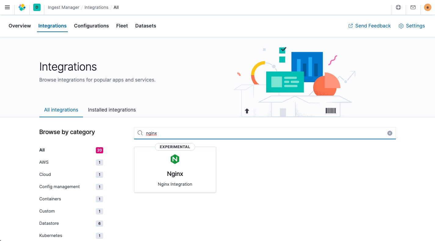

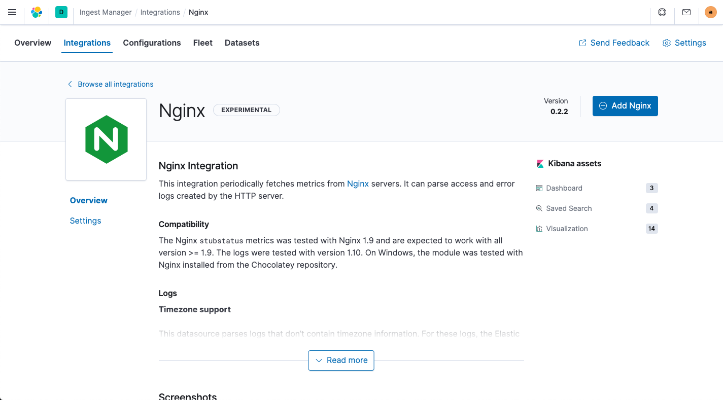

Log in to Kibana and go to Management > Ingest Manager.
In Ingest Manager, click the Integrations tab and use the search bar to find the Nginx integration.

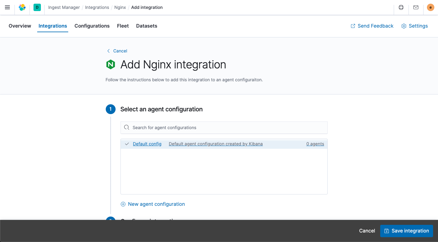

Click the Nginx integration to see more details about it, and then click Add Nginx.
- On the Add Nginx integration page, click the default agent configuration to select it, then scroll down to inspect or change the default settings.
- If your logs are not in the default location, click the down arrow next to enabled streams and change the Paths field.
When you’re done, click Save integration.

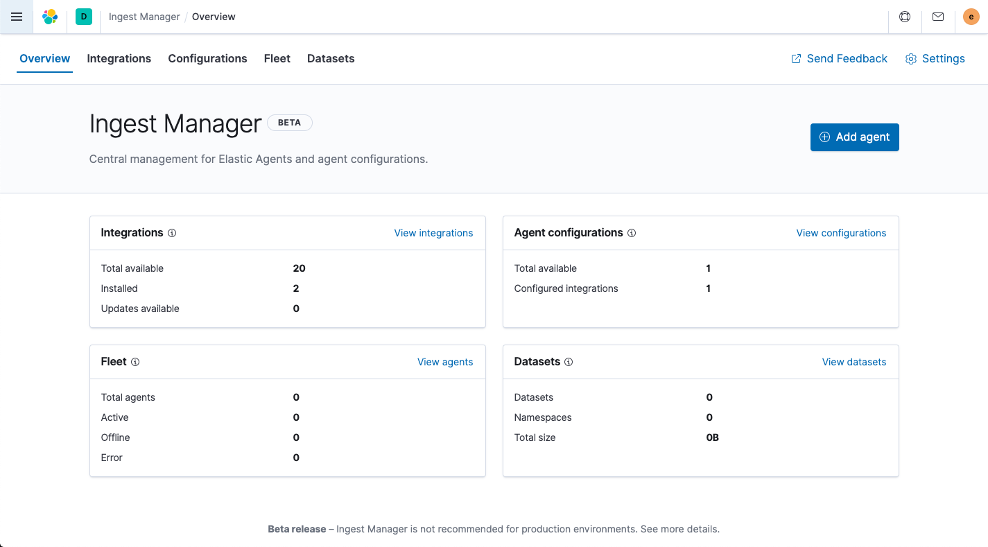

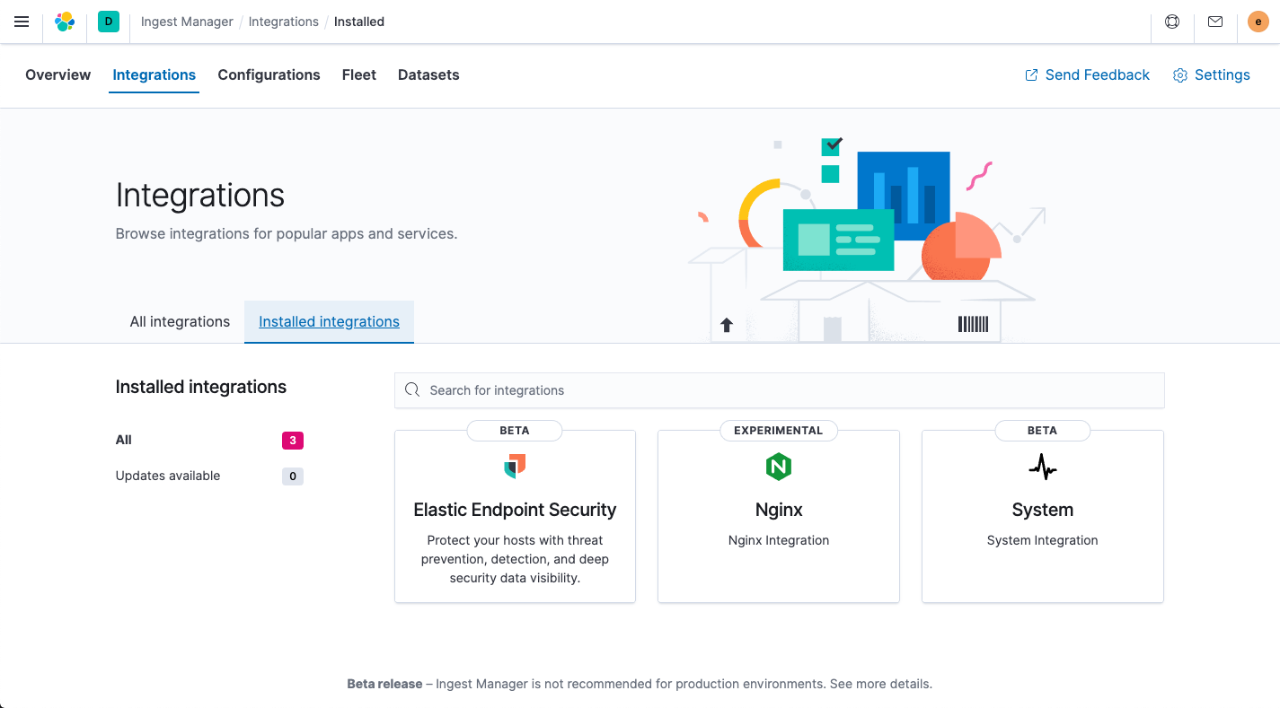

To verify that the integration is installed, click the Integrations tab and then click Installed Integrations.
The Nginx integration has been installed and should show up in this list. Note that the System and Elastic Endpoint Security integrations are installed by default.

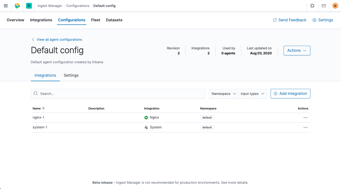

Select the Configurations tab, and in the list of agent configurations, click Default config.
The newly added Nginx integration should appear under Integrations. Note that the
system-1integration has been created by default.

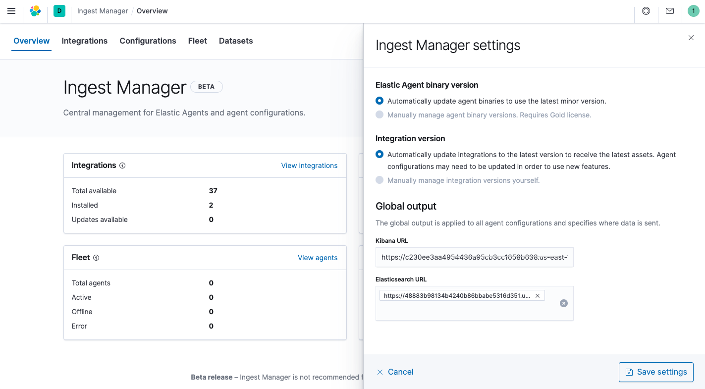

In Ingest Manager, click Settings and change the defaults, if necessary. For self-managed installations, set the URLs for Elasticsearch and Kibana, including the http ports, then save your changes.

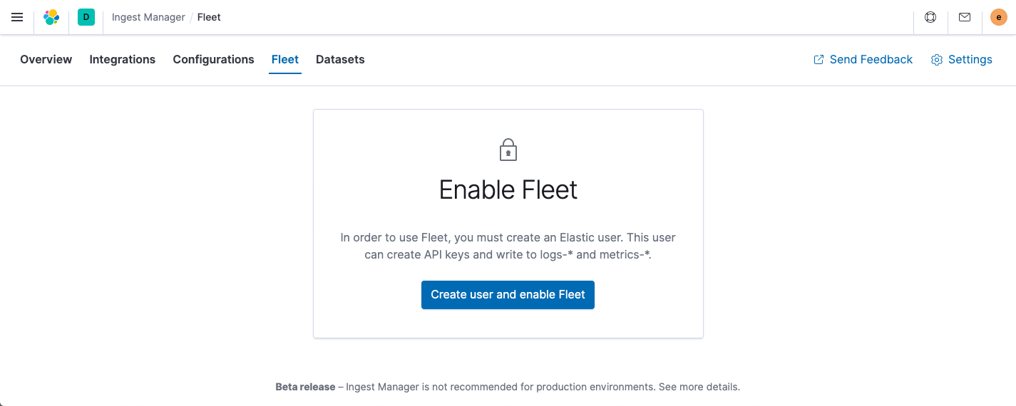

Enable Fleet. Click the Fleet tab and click Create user and enable Fleet.

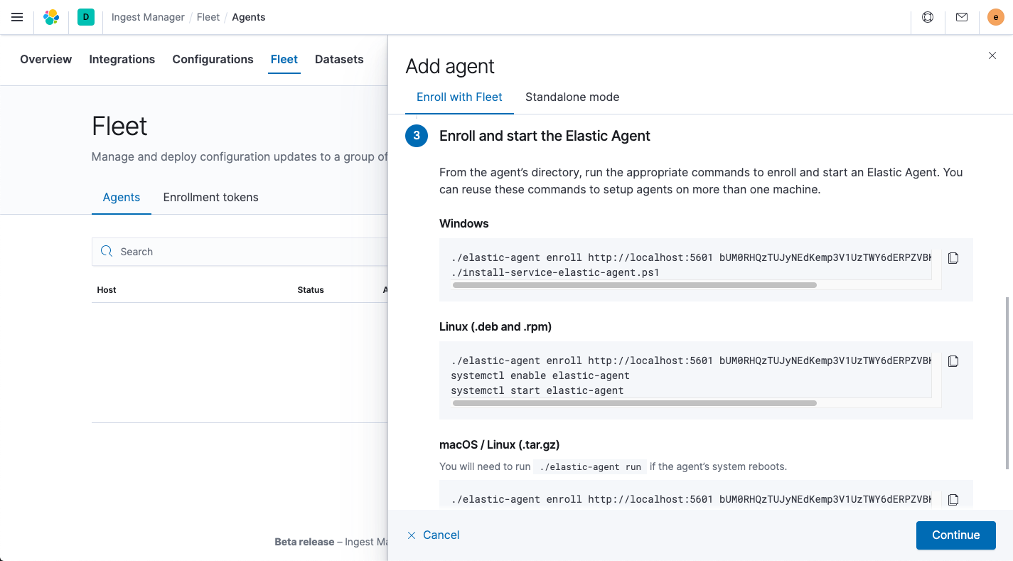

- On the Fleet tab, click Add agent and complete the steps under Enroll with Fleet. Skip the first step because you downloaded Elastic Agent earlier.
- Select an agent configuration (or accept the default).
Copy the command for enrolling the agent.
The copied command contains your Kibana URL and an enrollment key that was generated by Ingest Manager.
In the directory where Elastic Agent is installed, run the command you copied. Note that this command will overwrite the
elastic-agent.ymlfile in that directory.We recommend that you run this command as the root user because some integrations require root privileges to collect sensitive data.
elastic-agent enroll KIBANA_URL ENROLLMENT_KEY

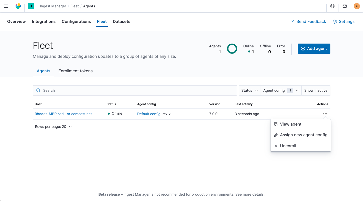

In Ingest Manager, click Continue to go to the Fleet tab, where you should see the newly enrolled agent.
If you run into problems, see Troubleshoot common problems.
To unenroll an agent, see Unenroll Elastic Agent.

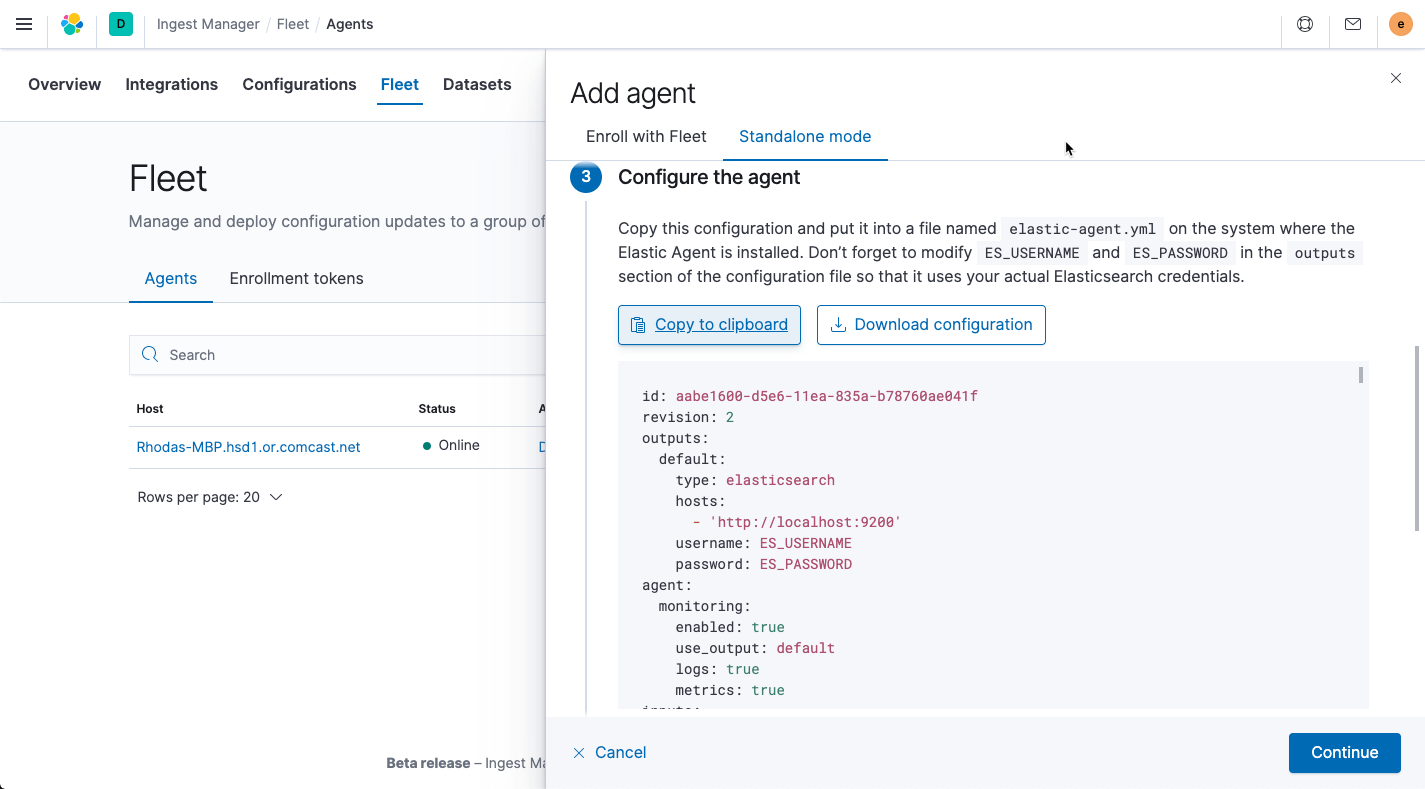

- On the Fleet tab, click Add agent and complete the steps under Standalone mode. Skip the first step because you downloaded Elastic Agent earlier.
Copy the content of the agent configuration and put it into a file named
elastic-agent.ymlon the system where Elastic Agent is installed.
The configuration file generated by Ingest Manager already contains the correct Elasticsearch address and port for your setup. If you run everything locally, the address is
127.0.0.1:9200. If you use our hosted Elasticsearch Service on Elastic Cloud, the address corresponds to the Elasticsearch endpoint URL that you can copy from the Overview page of your deployment. -
Change the Elasticsearch username and password in the
outputssection of the configuration file:[...] outputs: default: type: elasticsearch hosts: - 'HOST:PORT' username: ES_USERNAME password: ES_PASSWORD datasources: [...] -
