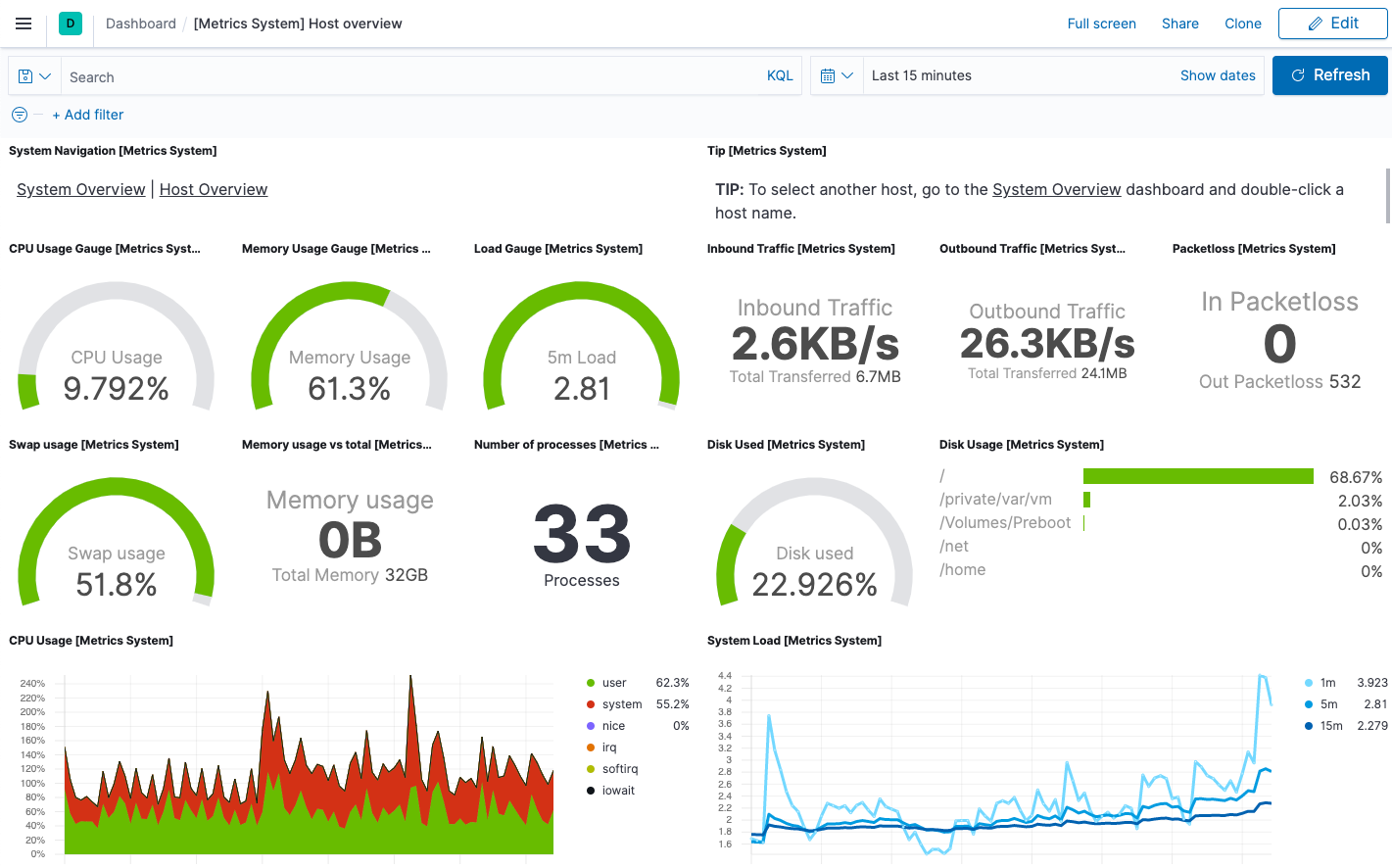

Next, view the data sent by Elastic Agent. Right now, Elastic Agent is only sending data about the host system because you haven’t configured the agent to collect data from other sources yet.
To see host logs and metrics:
- In Fleet, click the Data streams tab.
In the Actions column, navigate to the dashboards corresponding to the data stream. For example, to see host metrics, select one of the system datasets:
Then navigate to the [Metrics System] Host overview dashboard:

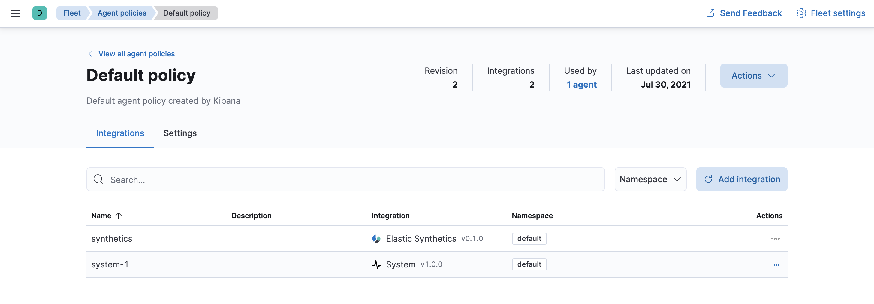

To see the updated policy, click the Default policy link.
The newly added Elastic Synthetics integration should appear under Integrations in the default policy, along with the
system-1
integration.All Elastic Agents that use this policy will collect logs, metrics, and uptime data from the host.
The newly added Nginx integration should appear under Integrations in the default policy, along with the
system-1
andsynthetics-1
integrations.All Elastic Agents that use this policy will collect logs and metrics from the Nginx server and the host, along with uptime data.
