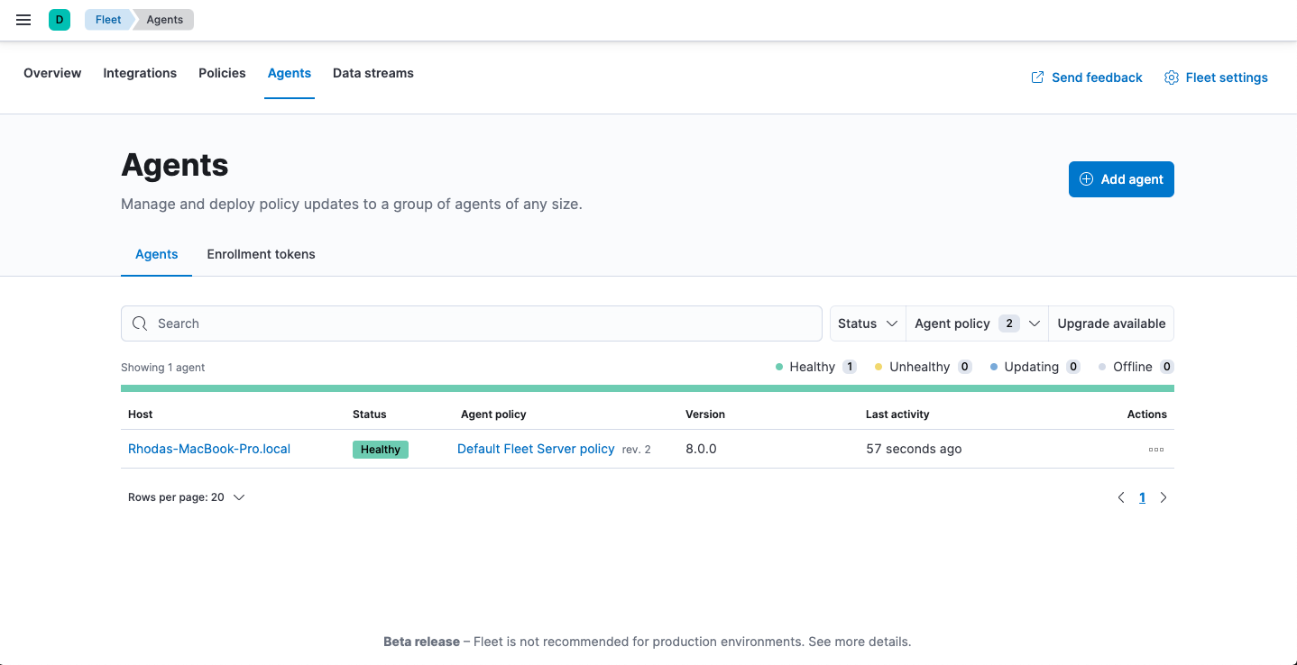

To confirm that Fleet Server is available in your deployment:
- Log in to Kibana and go to Management > Fleet.
- Click the Agents tab.
- Under Agent policy, look for Elastic Cloud agent policy — Fleet Server is the agent enrolled in the Elastic Cloud agent policy. This policy is managed by Elastic Cloud. You cannot modify it. Confirm that the agent status is Healthy.
Don’t see the Fleet Server agent? Make sure your deployment includes an APM & Fleet node. This node is required to use Fleet Server.

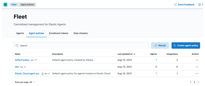

Next modify the Fleet Server configuration by editing the agent policy:
- In Fleet, click Agent Policies. Click on the Elastic Cloud agent policy to edit it.
Open the Actions menu and select Edit integration.
Under Fleet Server, modify Max Connections and other advanced settings as described in Scaling recommendations (Elastic Cloud).

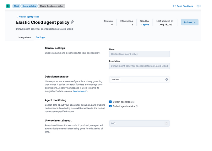

To turn on Fleet Server monitoring in the agent policy:
In Fleet, go to Agent Policies and click on the Elastic Cloud agent policy.
- Click the Settings tab and notice that Agent monitoring is off by default.
Under Agent monitoring, select Collect agent logs and Collect agent metrics.
The agent will now be able to collect logs and metrics from the Fleet Server.
The Fleet Server is deployed as yet another agent in the system.
Next, set the Default namespace.
Setting the default namespace lets you segregate Fleet Server monitoring data from other collected data. This makes it easier to search and visualize the monitoring data. By default the monitoring data is sent to the default namespace.
- To confirm your change, click Save changes.
