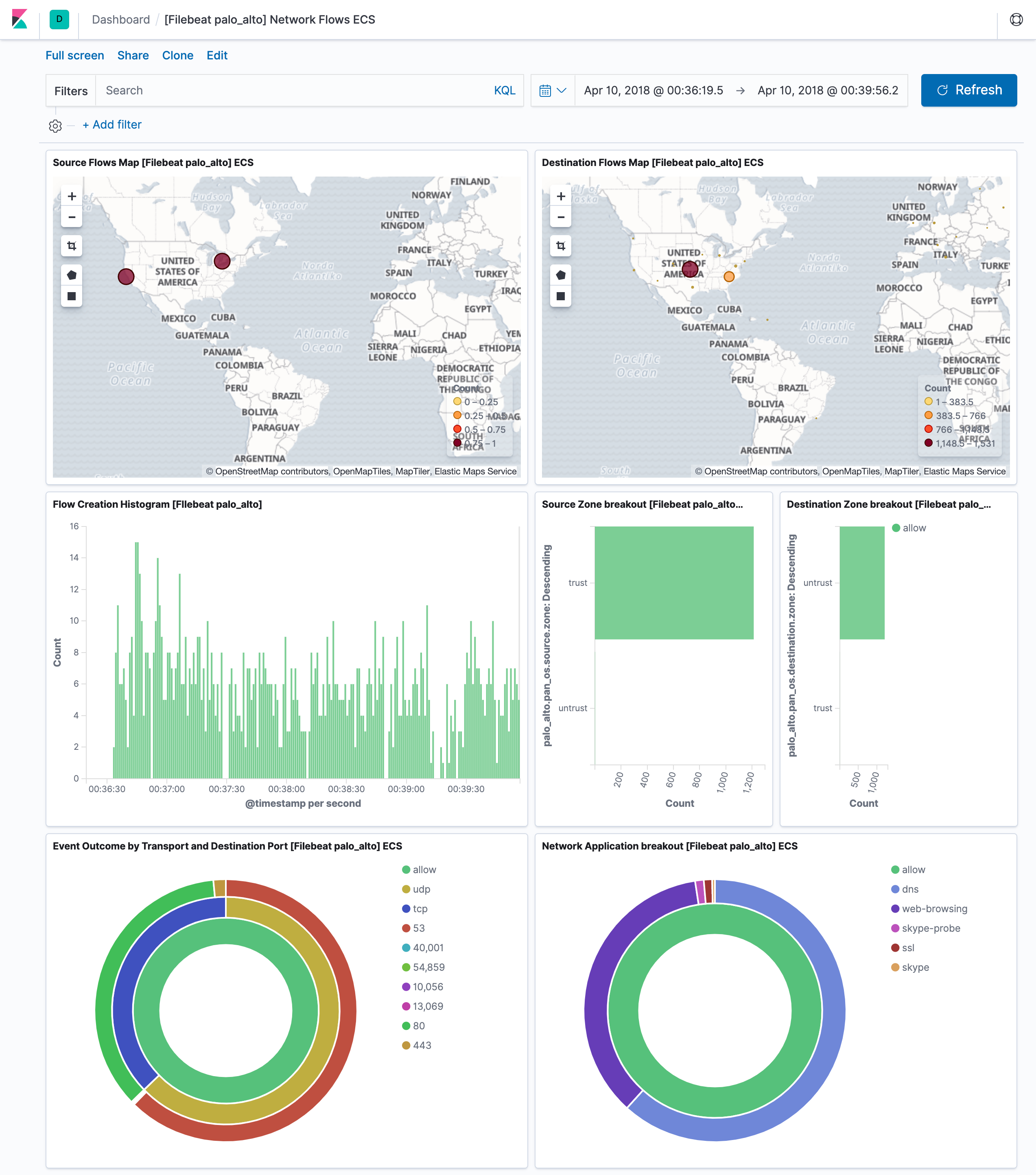

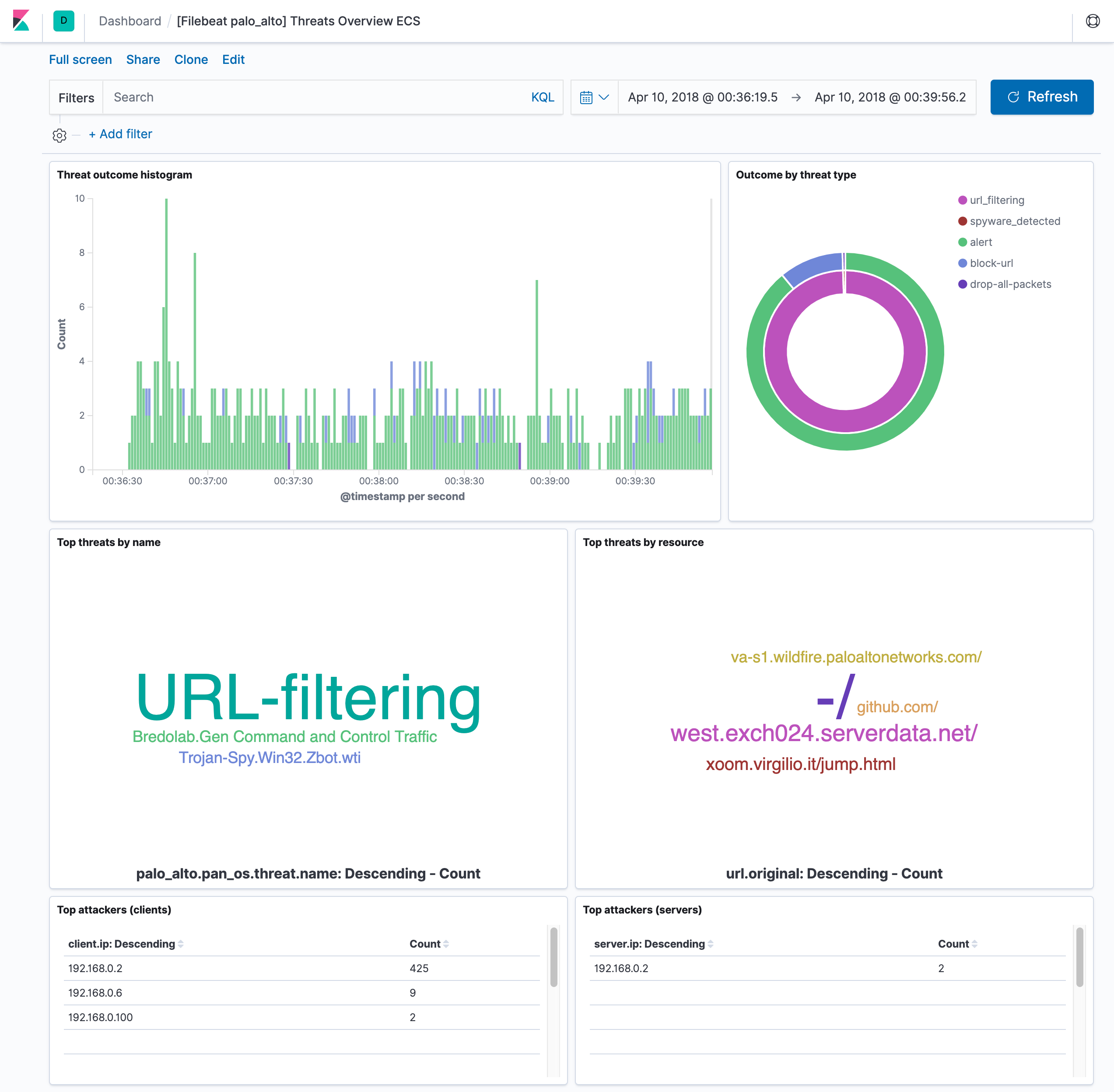

Example dashboardedit
This module comes with two sample dashboards:
