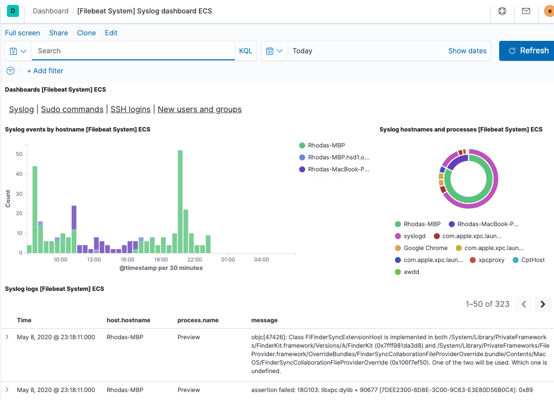

Example dashboardedit
Here’s an example of the syslog dashboard:
Syslog dashboard
