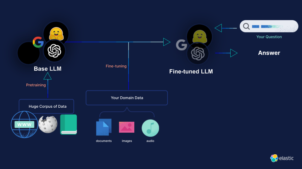

Pre-training
Fine-tuning
Retrieval Augmented Generation

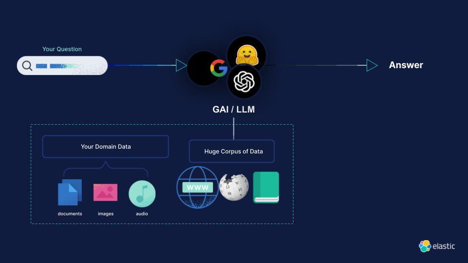

Introduction to domain specific generative AI
Generative AI technologies, built on large language models (LLMs), have substantially progressed our ability to develop tools for processing, comprehending, and generating text. Furthermore, these technologies have introduced an innovative information retrieval mechanism, wherein generative AI technologies directly respond to user queries using the stored (parametric) knowledge of the model.
However, it's important to note that the parametric knowledge of the model is a condensed representation of the entire training dataset. Thus, employing these technologies for a specific knowledge base or domain beyond the original training data does come with certain limitations, such as:
  • The generative AI's responses might lack context or accuracy, as they won't have access to information that wasn't present in the training data.
  • There is potential for generating plausible-sounding but incorrect or misleading information (hallucinations).
Different strategies exist to overcome these limitations, such as extending the original training data, fine-tuning the model, and integrating with an external source of domain-specific knowledge. These various approaches yield distinct behaviours and carry differing implementation costs.

Domain specific fine-tuning for LLMs
Fine-tuning for LLMs involves training a pre-trained model on a specific task or domain to enhance its performance in that area. It adapts the model's knowledge to a narrower context by updating its parameters using task-specific data, while retaining its general language understanding gained during pre-training. This approach optimises the model for specific tasks, saving significant time compared to training from scratch.

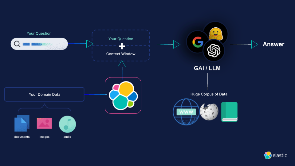

Enhancing LLMs with Retrieval Augmented Generation (RAG)
LLMs store factual knowledge in their parameters, and their ability to access and precisely manipulate this knowledge is still limited. This can lead to LLMs providing non-factual but seemingly plausible predictions (hallucinations) - particularly for unpopular questions. Additionally, providing references for their decisions and updating their knowledge efficiently remain open research problems.
A general purpose recipe to address these limitations is RAG, where the LLM's parametric knowledge is grounded with external or non-parametric knowledge from an information retrieval system. This knowledge is passed as additional context in the prompt to the LLM and specific instructions are given to the LLM on how to use this contextual information. This keeps it more inline with the discussion so far about parametric knowledge. The advantages of this approach are:
  • Unlike fine-tuning and pre-training, LLM parameters do not change and so there are no training costs
  • Expertise required to simple implementation is low (although more advanced strategies exist)
  • Response can be tightly constrained to context returned from the information retrieval system, limiting hallucinations
  • Smaller task specific LLMs can be used - as the LLM is being used for a specific task rather than a knowledge base.
  • Knowledge base is easily updatable as it requires no changes to the LLM
  • Responses can cite sources for human verification and link outs

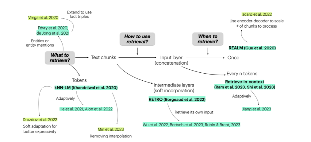

Strategies to combine this non-parametric knowledge (i.e. retrieved text) with an LLM’s parametric knowledge is an active area of research.
Some of these approaches involve modifying the LLM in conjunction with the retrieval strategy and so can not be classified as distinctly as the definitions in this blog. We will dive into more details in further blogs.

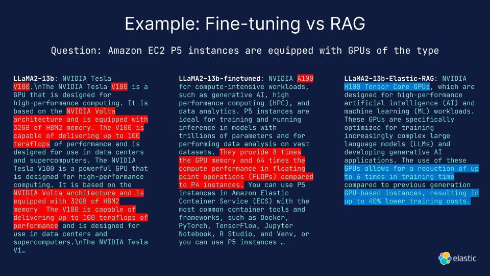

Example
In a simple example, we utilised a fine-tuned LLaMA2 13B model, which was based on the information from this blog. This model underwent fine-tuning using AWS blog posts published after the LLaMA2 pre-training and fine-tuning data cutoff date, specifically those from July 23rd, 2023. We also ingested these documents into a Elasticsearch and established a simple RAG pipeline. In this pipeline, model responses are generated based on the retrieved documents serving as context. Red highlights indicate incorrect responses, and blue highlights correct responses.
However, it's important to note that this is just a single example and does not constitute a comprehensive evaluation of fine-tuning versus RAG, but provides an example of fine-tuning before useful for form, not facts.. We plan to conduct more thorough comparisons in upcoming blogs.
