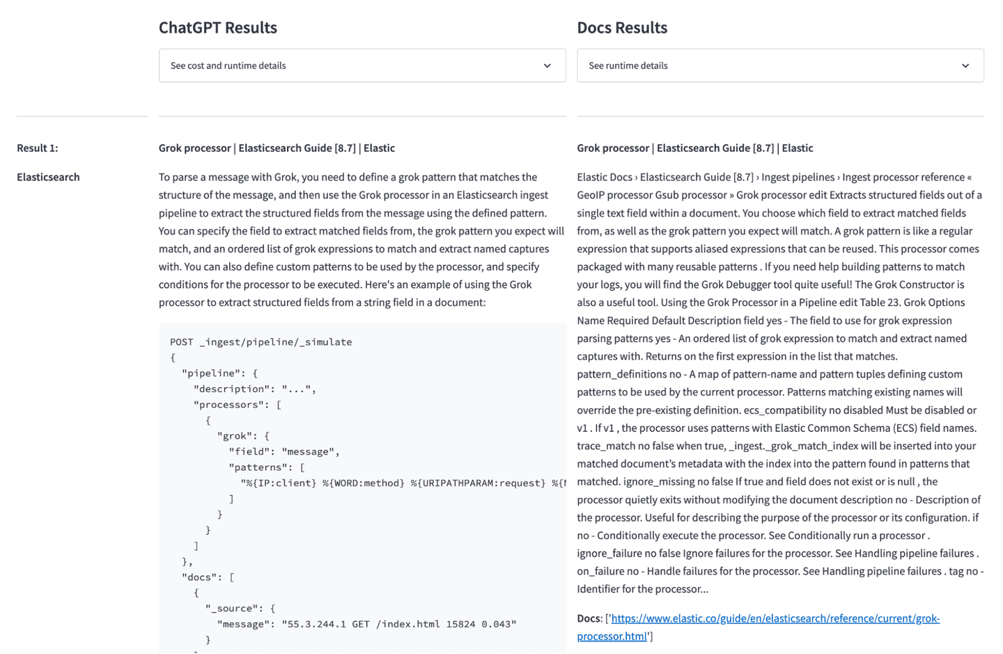

Comparing ChatGPT and Elasticsearch results
To improve the user experience of our sample application, we've added a feature that displays the raw results alongside the ChatGPT-created response. This will help users better understand how ChatGPT works.
Since our source data set is only crawled, the structure in the documents makes it difficult to read for a human. To show this difference and therefore the value that ChatGPT can bring, we added the raw result next to the GPT created response.

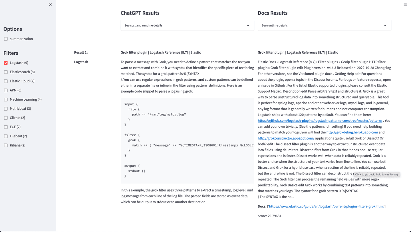

Leveraging aggregations, facets, and filtering in Elasticsearch to enhance ChatGPT
To address this limitation, one of the biggest advantages of Elasticsearch is its robust faceting and filtering framework. When a user is searching for something, they may have additional preferences or context they can provide to dramatically increase the likelihood of obtaining the correct result. By leveraging Elasticsearch's faceting and filtering framework, we can allow users to refine their search based on various parameters such as date, location, or other relevant criteria.
It’s also important to note that many users have gotten used to having facet filtering options available when searching for something. Let us look at an example.
Searching for “How can I parse a message with Grok?” results in a document for ingest pipelines to be returned as the top result. This is not wrong, as ingest pipelines also support Grok expressions, but what if the user was interested in parsing his data using Logstash?
Using a simple terms aggregation as part of the request to fetch the hits, we can get a list of the top 10 product categories and offer these as a filtering option for a user.
If the user now selects “Logstash” on the left side, all results will be filtered for Logstash. It’s important to note that this all works while still using the same hybrid query model that we’ve talked about in the previous blog. We’re still using a combination of BM25 and kNN search to match our documents.

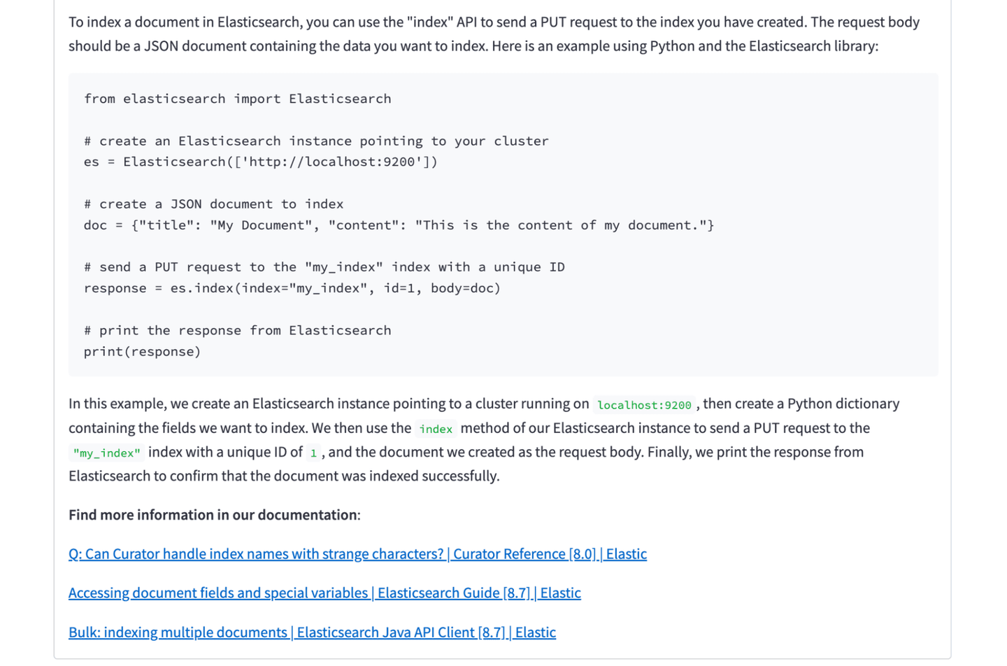

Citations for your ChatGPT results
One downside of large language models (LLMs) is their overconfidence and tendency to hallucinate. You ask a question, you get an answer. Whether the answer is actually correct is for you to decide. The model rarely admits that it does not know something. Providing the context and telling it to respond with a specific answer as we did above helps mitigates this to some extent.
But the provided context alongside getting the model to admit that it can’t answer a question also allows us to provide more accurate citations for the responses.
In the last section, we summarized our set of 10 answers into one global answer. In addition to just providing this global answer, we can also provide a list of all source documentation pages that we used to compile the result — basically any page where the model did not respond "The provided page does not answer the question."
In this screenshot, you can see the summary answer on a set of 10 results from Elasticsearch. Even though we inspected 10 results, we are only displaying the three links to the documentation that are actually relevant to answer the question. In this case, the other seven documents returned by Elasticsearch had something to do with documents or indices, but they didn’t specifically talk about how to index something.
