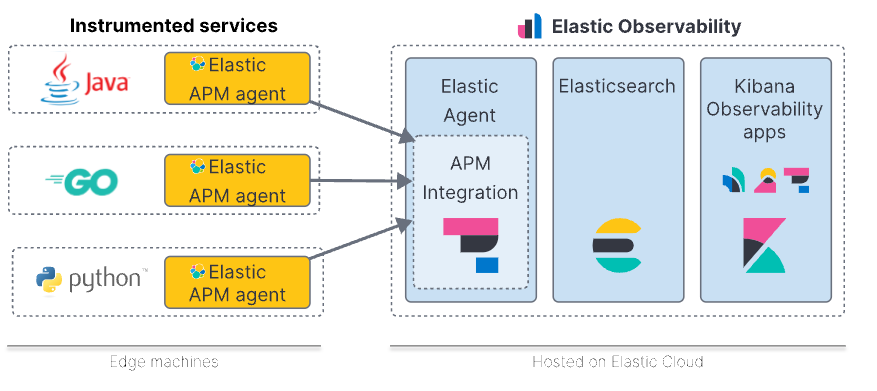

Logical architecture
Elastic APM relies on the APM Integration inside Elastic Agent, which forwards application trace and metric data from applications instrumented with APM agents to an Elastic Observability cluster. Elastic APM supports multiple agent flavors:
  • Native Elastic APM Agents, available for multiple languages, including Java, .NET, Go, Ruby, Python, Node.js, PHP, and client-side JavaScript
  • Code instrumented with OpenTelemetry
  • Code instrumented with OpenTracing
  • Code instrumented with Jaeger
In this blog, we'll provide a quick example of how to instrument code with the native Elastic APM Python agent, but the overall steps are similar for other languages.
Please note that there is a strong distinction between the Elastic APM Agent and the Elastic Agent. These are very different components, as you can see in the diagram above, so it's important not to confuse them.

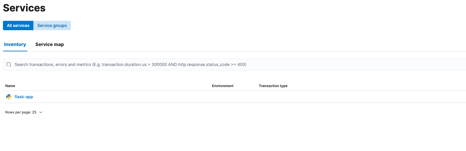

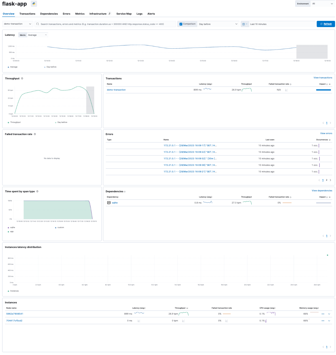

Back in Kibana, navigate back to the APM app (hamburger icon, then select APM ) and you should see our new flask-app service (I let mine run so it shows a bit more history):

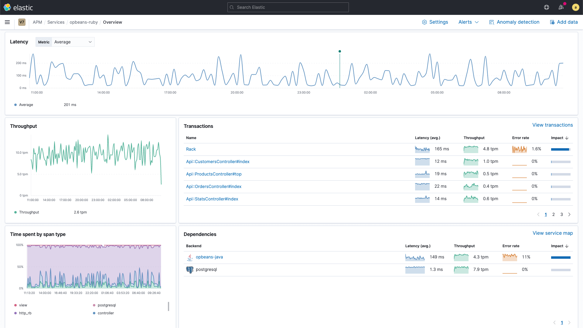

The Service Overview page provides an at-a-glance summary of the health of a service in one place. If you're a developer or an SRE, this is the page that will help you answer questions like:
  • How did a new deployment impact performance?
  • What are the top impacted transactions?
  • How does performance correlate with underlying infrastructure?

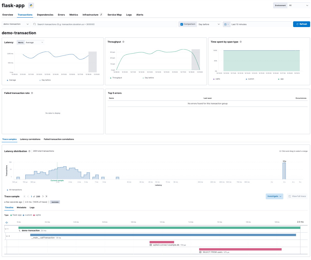

This view provides a list of all of the applications that have sent application trace data to Elastic APM in the specified period of time (in this case, the last 15 minutes). There are also sparklines showing mini graphs of latency, throughput, and error rate. Clicking on flask-app takes us to the service overview page, which shows the various transactions within the service (recall that my script is hitting the %2F endpoint, as seen in the Transactions section). We get bigger graphs for Latency , Throughput , Errors , and Error Rates.
When you're instrumenting real applications, under real load, you'll see a lot more connectivity (and errors!)
Clicking on a transaction in the transaction view, in this case, our sample app's demo-transaction transaction, we can see exactly what operations were called:

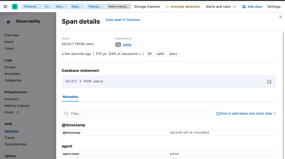

This includes detailed information about calls to external services, such as database queries:
