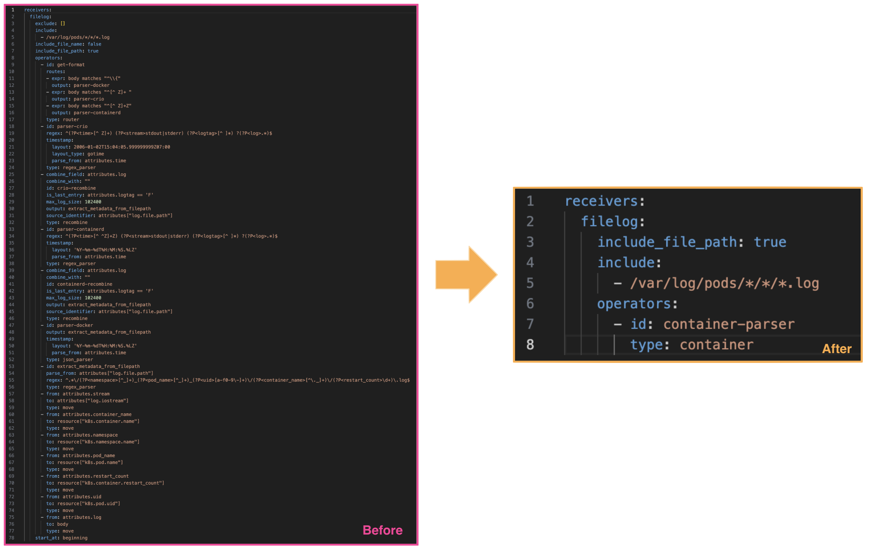

Improving the Kubernetes container logs parsing
The filelog receiver has been able to parse Kubernetes container logs for some time now. However, properly parsing logs from Kubernetes Pods required a fair bit of configuration to deal with different runtime formats and to extract important meta information, such as k8s.pod.name, k8s.container.name, etc. With this in mind we proposed to abstract these complex set of configuration into a simpler implementation specific container parser and contributed this new feature to the filelog receiver. With that new feature, setting up logs collection for Kubernetes is by magnitudes easier - with only eight lines of configuration vs. ~ 80 lines of configuration before.
You can learn more about the details of the new container logs parser in the corresponding OpenTelemetry blog post.
