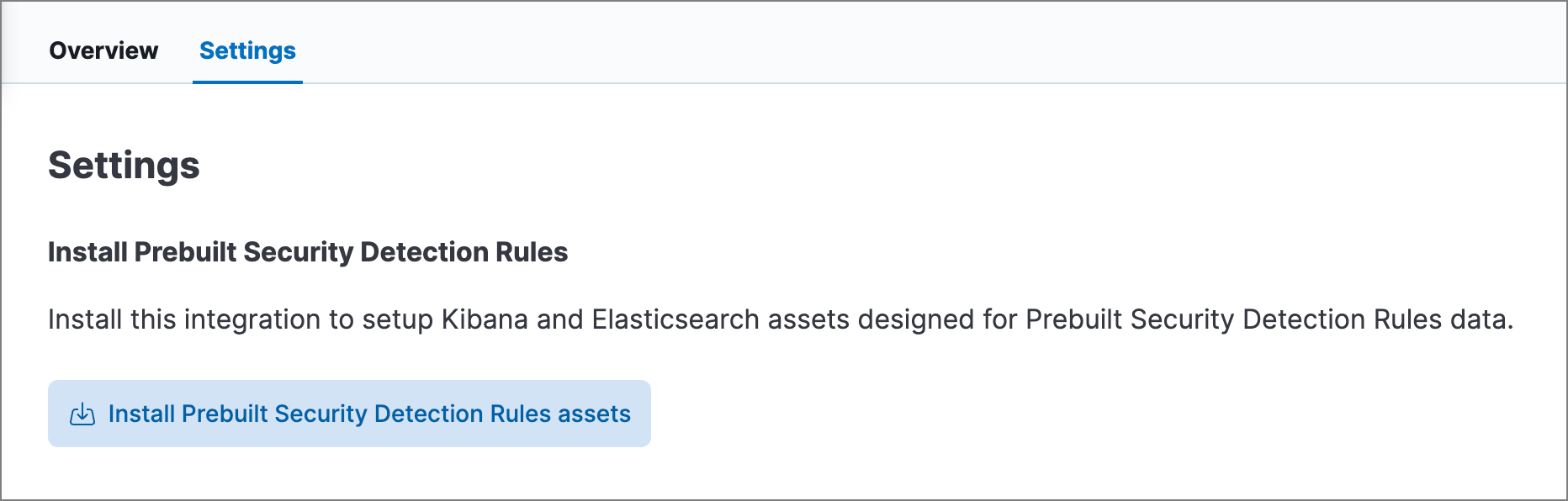

Download latest prebuilt Elastic rules
As of Elastic Stack >=7.13.0, you can download the latest version of Elastic prebuilt rules outside of a regular release cycle. This feature ensures you have the latest detection capabilities before upgrading to the latest Elastic Stack.
To download the latest version of prebuilt rules:
  1. In Kibana, go to Management → Integrations.
  2. Search for "Prebuilt Security Detection Rules."
  3. Select the integration, then select the Settings tab. The integration settings page is displayed.
    install prebuilt settings

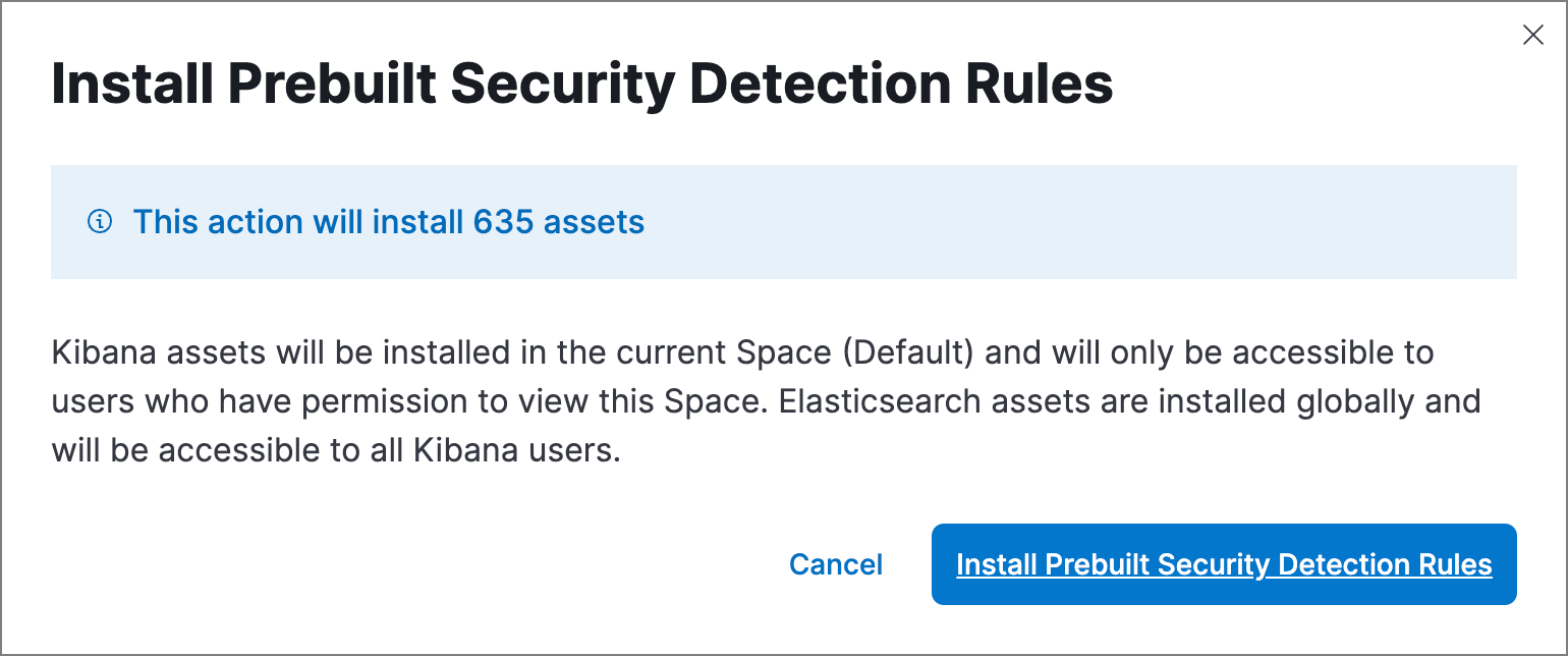

  4. Click Install Prebuilt Security Detection Rules assets.
  5. Click Install Prebuilt Security Detection Rules to confirm the installation.
    install prebuilt rules
