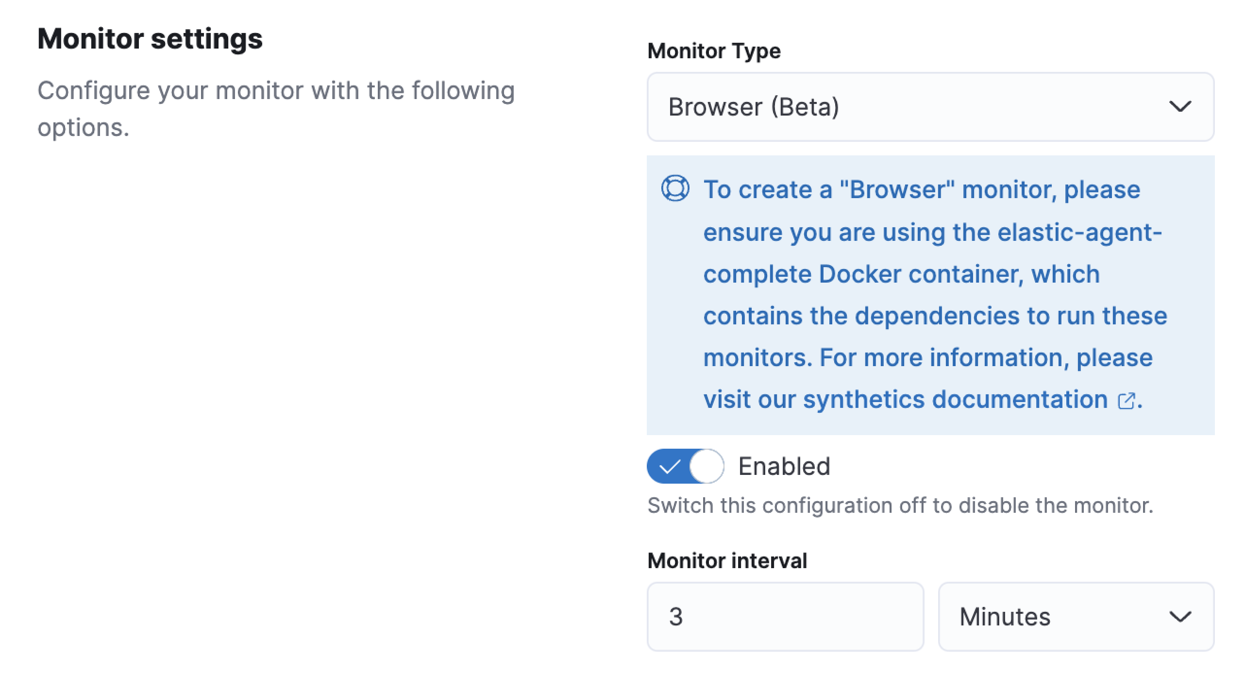

Elastic Agent
editUse Elastic Agent to configure and create browser monitors similarly to how you would set up any other type of monitor.
Read more about the benefits of this approach in the setup guide’s Elastic Agent section.
When using this approach to create multiple monitors from a project, all monitors will use a single configuration.

Click Advanced Browser options to see more ways to configure your monitor.
- Use the Synthetics agent options to provide fine-tuned configuration for the synthetics agent. Read more about available options in Command reference.
- Use Throttling options to control the monitor’s network speed. You can control the monitor’s download and upload speeds and its latency to simulate your application’s behavior on slower or laggier networks.

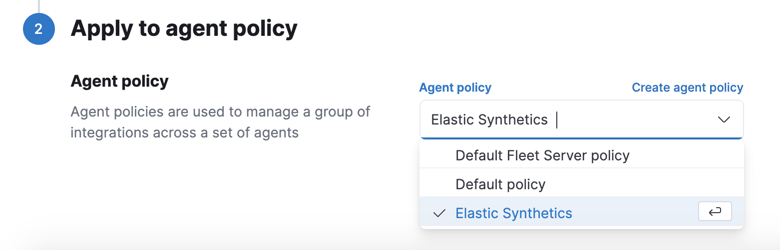

When applying the integration policy to an Elastic Agent policy, make sure to select your dedicated synthetics agent policy.

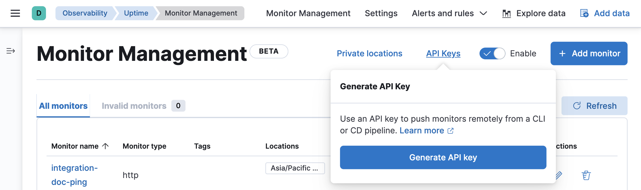

To generate an API key:
- Go to Monitor Management in the Uptime app.
- Click API Keys.
- Click Generate API key.
If you are pushing to a private location, you must use an API key generated in 8.4 or higher.
For more details on using the push command, see elastic-synthetics push.

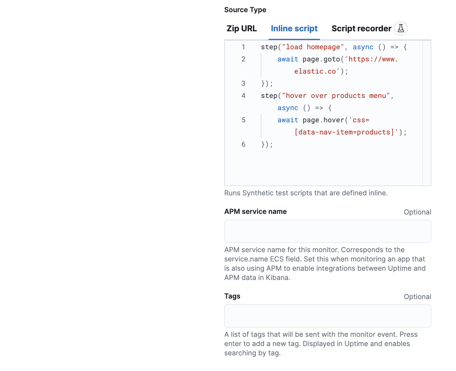

Create an inline monitor
editAlternatively, you can create an inline monitor.
An inline monitor is a single journey that you manage individually. Inline monitors can be quick to set up, but can also be more difficult to manage. Each inline monitor can contain only one journey, which must be maintained directly in Kibana or in your Heartbeat configuration file.
If you depend on external packages, have your journeys next to your code repository, or wish to embed and manage more than one journey from a single monitor configuration, see Configure monitor instead.
When writing an inline monitor, the journey keyword isn’t required, and variables like page and params will be part of your script’s scope. To create an inline monitor, copy the steps from inside a journey and paste them into your Elastic Synthetics integration or heartbeat.yml depending on the approach you chose to set up.
Copy and paste your test steps into heartbeat.yml.
Heartbeat spawns a separate Node.js process, schedules your tests, and runs them on a Chromium browser.
For a full list of configuration options, see Browser options in the Heartbeat documentation.
- type: browser id: elastic-website name: Elastic website schedule: "@every 1m" source: inline: script: |- step("load homepage", async () => { await page.goto('https://www.elastic.co'); }); step("hover over products menu", async () => { await page.hover('css=[data-nav-item=products]'); });
Each |
In this example, a synthetic journey is defined inline. This is a two-step script that first loads a homepage and then hovers over a product menu. See Write a synthetic test for more information. |
[beta] This functionality is in beta and is subject to change. The design and code is less mature than official GA features and is being provided as-is with no warranties. Beta features are not subject to the support SLA of official GA features. Add an inline monitor when configuring the Elastic Synthetics integration. In Monitor settings, use the Monitor Type Browser.
Then switch the Source Type to Inline script.
Add steps to the code block directly.
The journey keyword isn’t required, and variables like page and params will be part of your script’s scope.
You cannot import any dependencies when using inline monitors.
