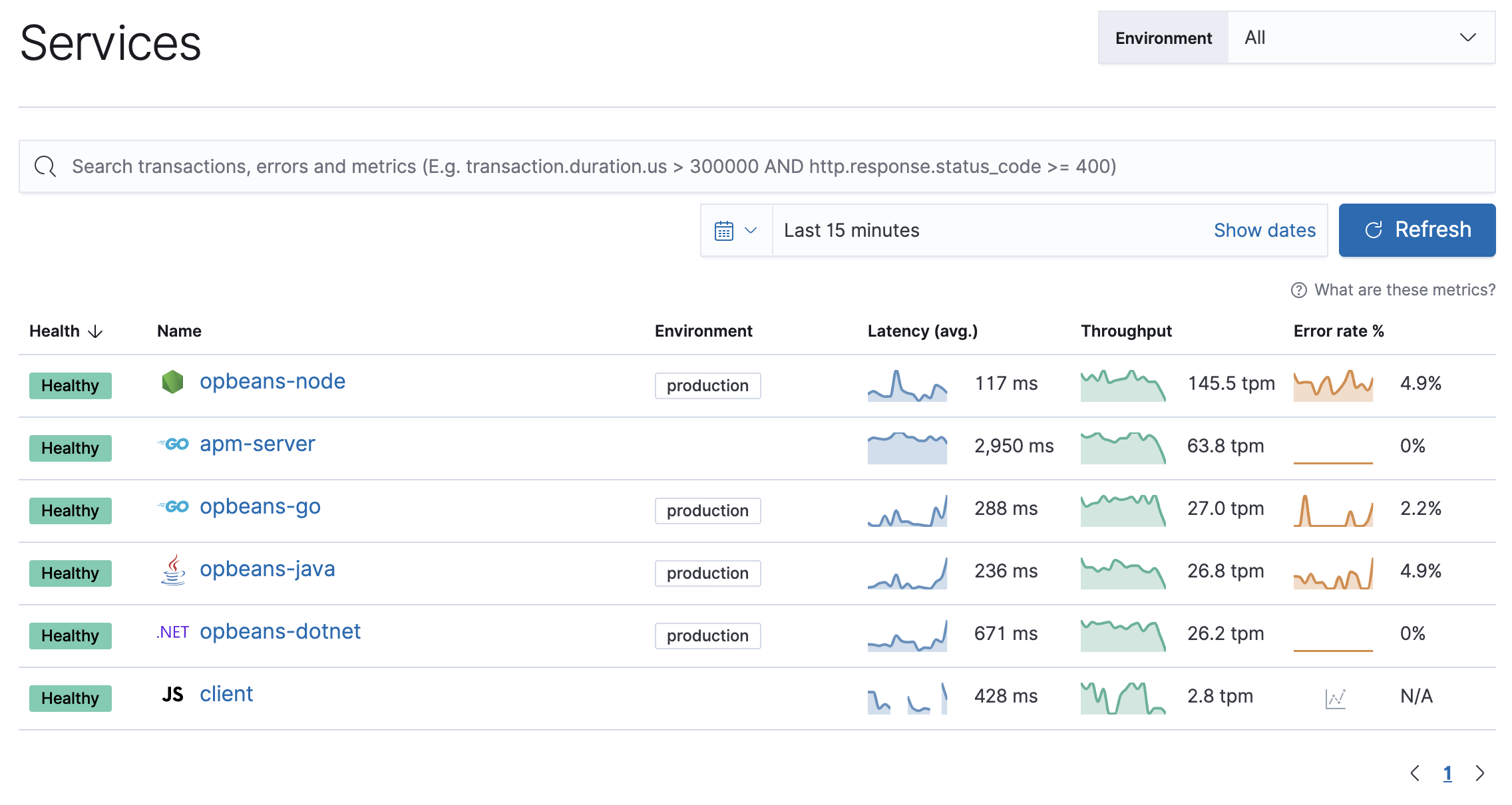

- Kibana for visualizing with the Applications UI.

Step 4: Install APM agents

Step 5: View your data
editOnce you have at least one APM agent sending data to APM Server, you can start visualizing your data in the Kibana Applications UI.
