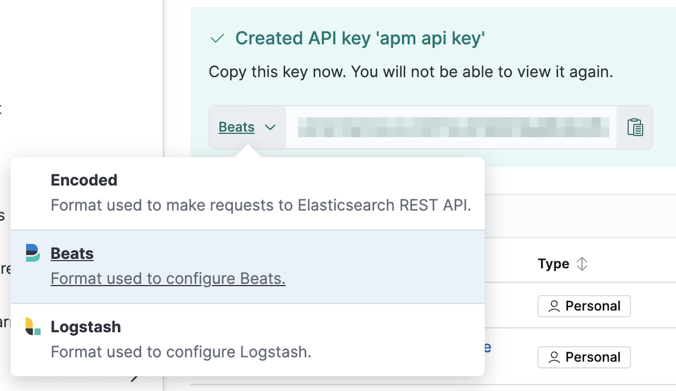

output.elasticsearch: hosts: ["<YOUR_ES_HOST_URL>:9200"] api_key: "ZCV7VnwBgnX0T19fN8Qe:KnR6yE41RrSowb0kQ0HWoA"
You must set the API key to be configured to Beats. Base64 encoded API keys are not currently supported in this configuration. For details on how to create and configure a compatible API key, refer to Create an API key for writing events. |

api_keyInstead of using a username and password, you can use API keys to secure communication
with Elasticsearch. The value must be the ID of the API key and the API key joined by a colon: id:api_key.

To use token-based API key authentication, specify the
api_keyunderoutput.elasticsearch. For example:This API key must have the privileges required to publish events to Elasticsearch. You must set the API key to be configured to Beats. Base64 encoded API keys are not currently supported in this configuration. For details on how to create and configure a compatible API key, refer to Create an API key for writing events.
