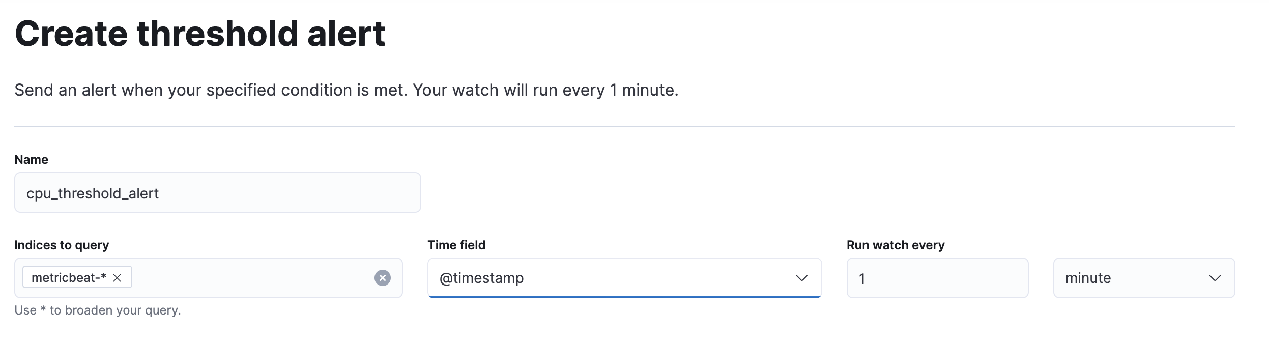

Define the watch input and scheduleedit
  1. Click Create and then select Create threshold alert.
    You’re navigated to a page where you’re asked to define the watch name, the data that you want to evaluate, and how often you want to trigger the watch.
  2. Enter a name that you want to call the alert, for example, cpu_threshold_alert.
  3. In the Indices to query field, enter metricbeat-* and select @timestamp as the time field.
  4. Use the default schedule to run the watch every 1 minute.
    Input and schedule for threshold alert

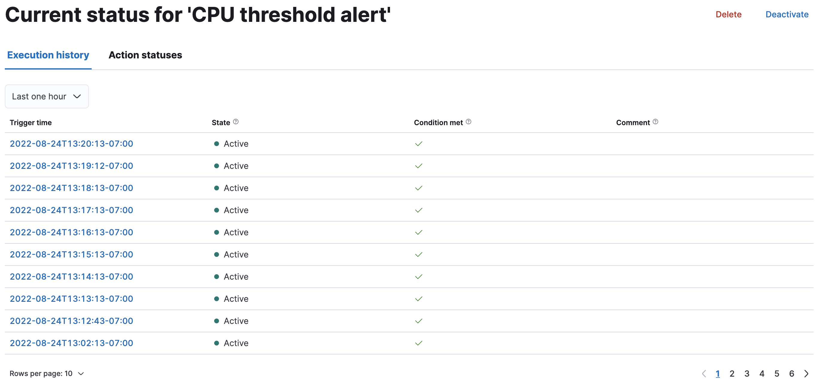

View watch historyedit
The Execution history tab shows each time the watch is triggered and the results of the query, whether the condition was met, and what actions were taken.

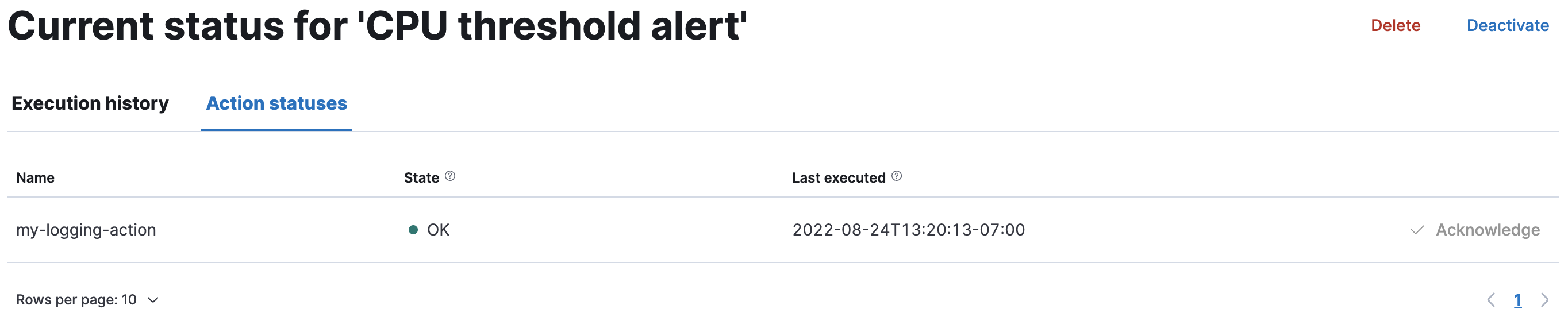

Acknowledge action statusedit
The Action statuses tab lists all actions associated with the watch and the state of each action. Some actions can be acknowledged, which will prevent too many executions of that action for the relevant watch. See Acknowledgement and throttling for details.

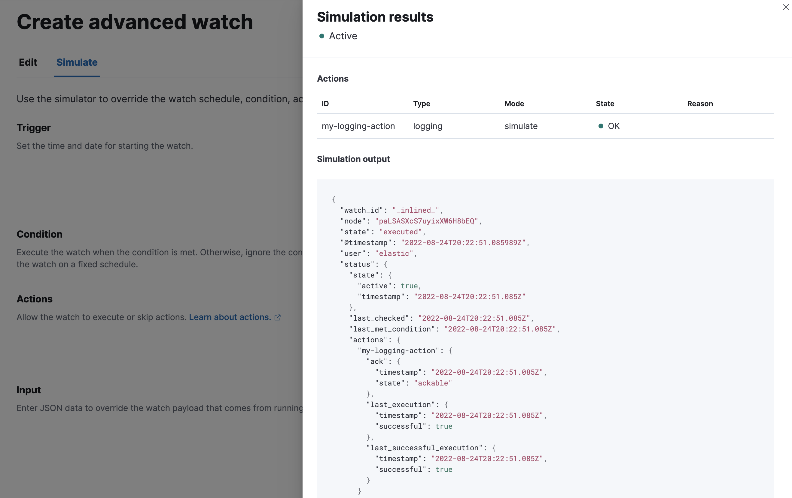

Simulate the watchedit
The Simulate tab allows you to override parts of the watch, and then run a simulation. Be aware of these implementation details on overrides:
  • Trigger overrides use date math.
  • Input overrides accepts a JSON blob.
  • Condition overrides indicates if you want to force the condition to always be true.
  • Action overrides support multiple options.
Some watches, such as those using basic auth credentials, contain passwords. For security reasons, these passwords will be stripped from any watches that are loaded by the Watcher UI. You will need to manually re-enter these passwords to simulate the watch.
After starting the simulation, you’ll see a results screen. For more information on the fields in the response, see the Execute watch API.
