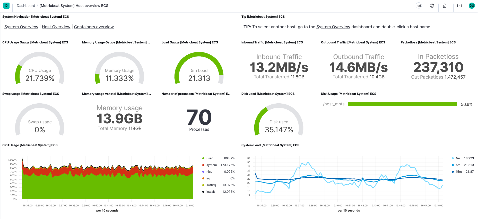

Metricbeat helps you monitor your servers and the services they host by collecting metrics from the operating system and services.
This guide describes how to get started quickly with metrics collection. You’ll learn how to:
- install Metricbeat on each system you want to monitor
- specify the metrics you want to collect
- send the metrics to Elasticsearch
- visualize the metrics data in Kibana
![Metricbeat System dashboard](./images/metricbeat-system-dashboard.png)

Metricbeat should begin streaming metrics to Elasticsearch.
Step 6: View your data in Kibanaedit
Metricbeat comes with pre-built Kibana dashboards and UIs for visualizing log
data. You loaded the dashboards earlier when you ran the setup
command.
To open the dashboards:
Launch Kibana:
- Log in to your Elastic Cloud account.
- Navigate to the Kibana endpoint in your deployment.
Point your browser to http://localhost:5601, replacing
localhost
with the name of the Kibana host. -
In the side navigation, click Discover. To see Metricbeat data, make sure the predefined
metricbeat-*
index pattern is selected.If you don’t see data in Kibana, try changing the time filter to a larger range. By default, Kibana shows the last 15 minutes.
- In the side navigation, click Dashboard, then select the dashboard that you want to open.
