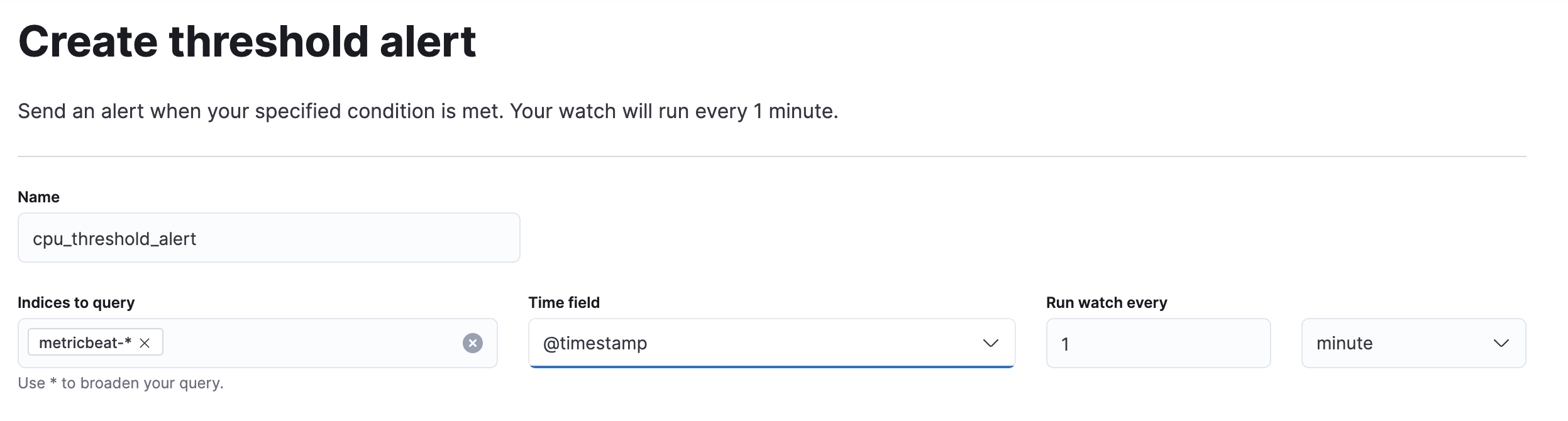

Click Create and then select Create threshold alert.
You’re navigated to a page where you’re asked to define the watch name, the data that you want to evaluate, and how often you want to trigger the watch.
Enter a name that you want to call the alert, for example,
cpu_threshold_alert. -
In the Indices to query field, enter
metricbeat-*and select@timestampas the time field. -
Use the default schedule to run the watch every 1 minute.

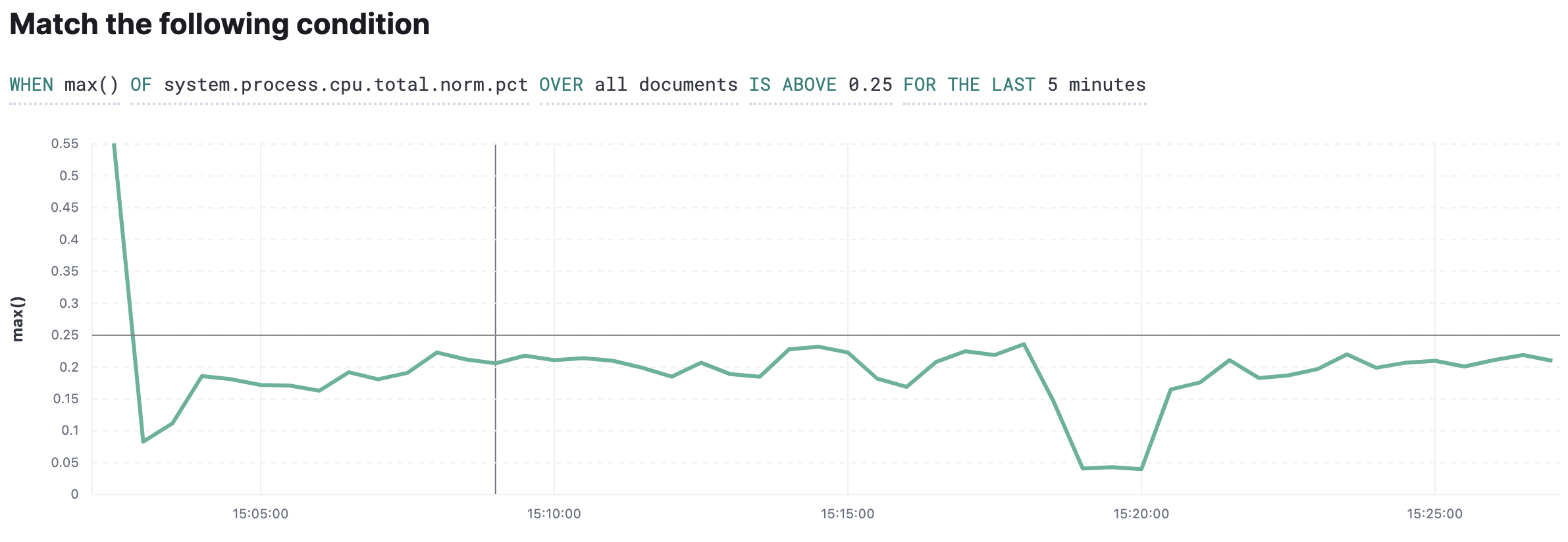

editYou should now see a panel with default conditions and a visualization of the data based on those conditions. The condition evaluates the data you’ve loaded into the watch and determines if any action is required.
Click the
WHENexpression and change the value tomax().The
OFexpression now appears. -
Search for
system.process.cpu.total.norm.pctand select it from the list. -
Select the
IS ABOVEexpression and change the value to.25to trigger an alert whenever the CPU is above 25%.As you change the condition, the visualization is automatically updated. The black line represents the threshold (25%), while the green fluctuating line represents the change in CPU over the set time period.

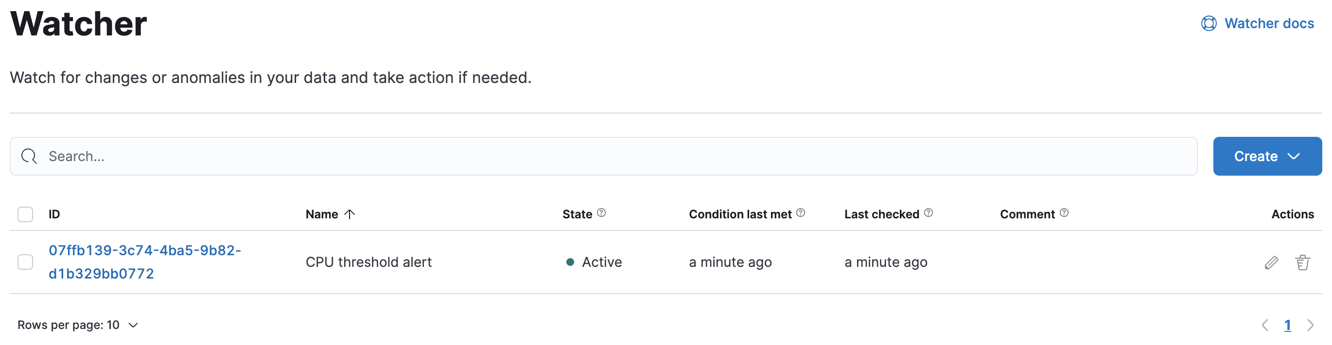

Click Create alert.
The alert appears on the Watcher overview page, where you can drill down into the watch history and status.

editThe Watcher overview page lists your watches, including the state of each watch, when its condition was last met, when the condition was last checked, and whether any of its actions have been acknowledged, throttled, or failed to execute. Each watch can be in one of three states:
- Active. The watch is working properly.
- Inactive. The watch is working properly, but is deliberately disabled, so it won’t execute any actions.
- Error. The watch is not working properly.

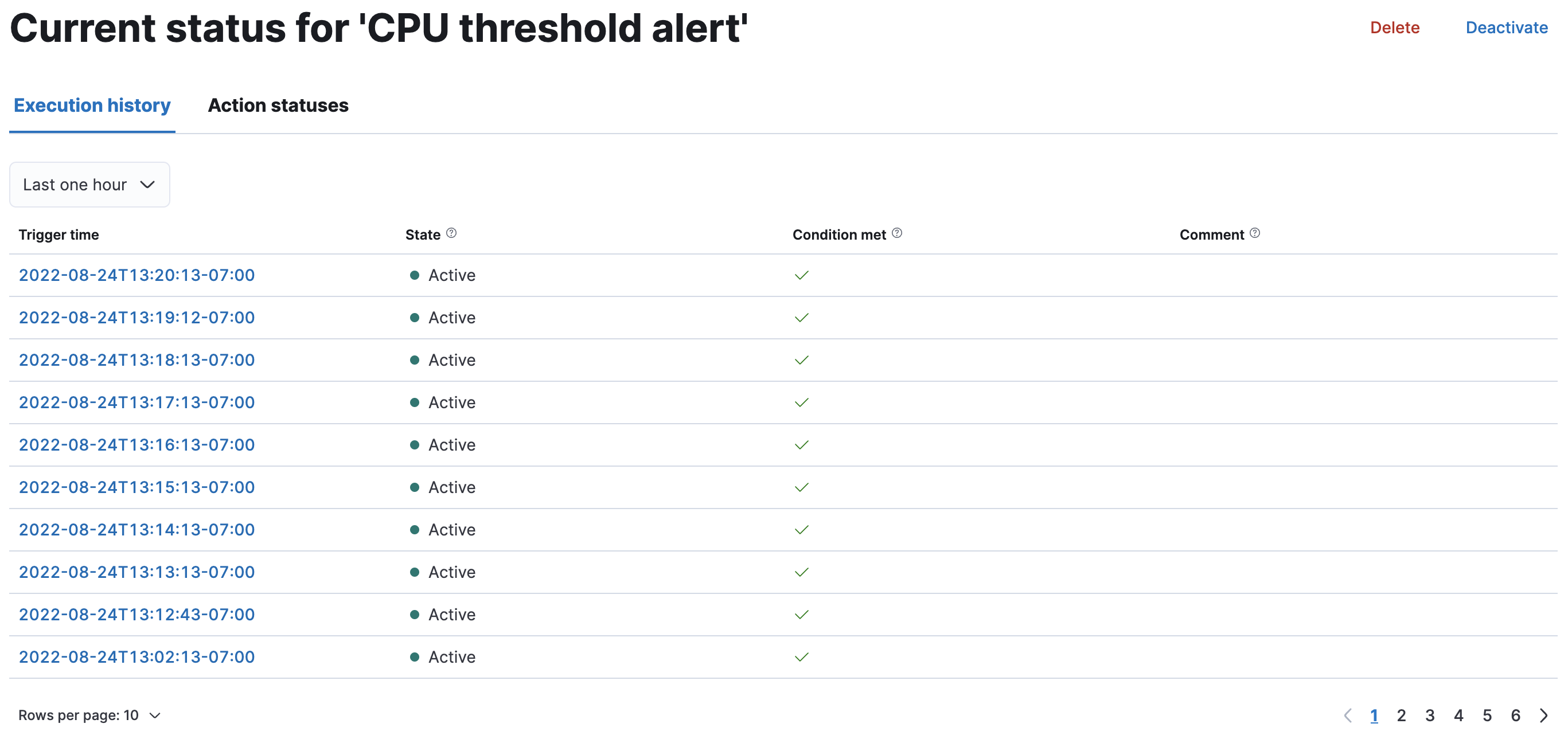

View watch history
editThe Execution history tab shows each time the watch is triggered and the results of the query, whether the condition was met, and what actions were taken.

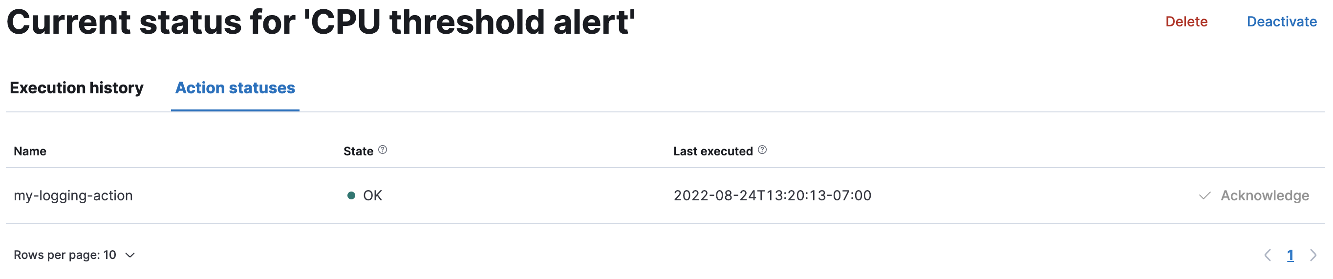

Acknowledge action status
editThe Action statuses tab lists all actions associated with the watch and the state of each action. Some actions can be acknowledged, which will prevent too many executions of that action for the relevant watch. See Acknowledgement and throttling for details.

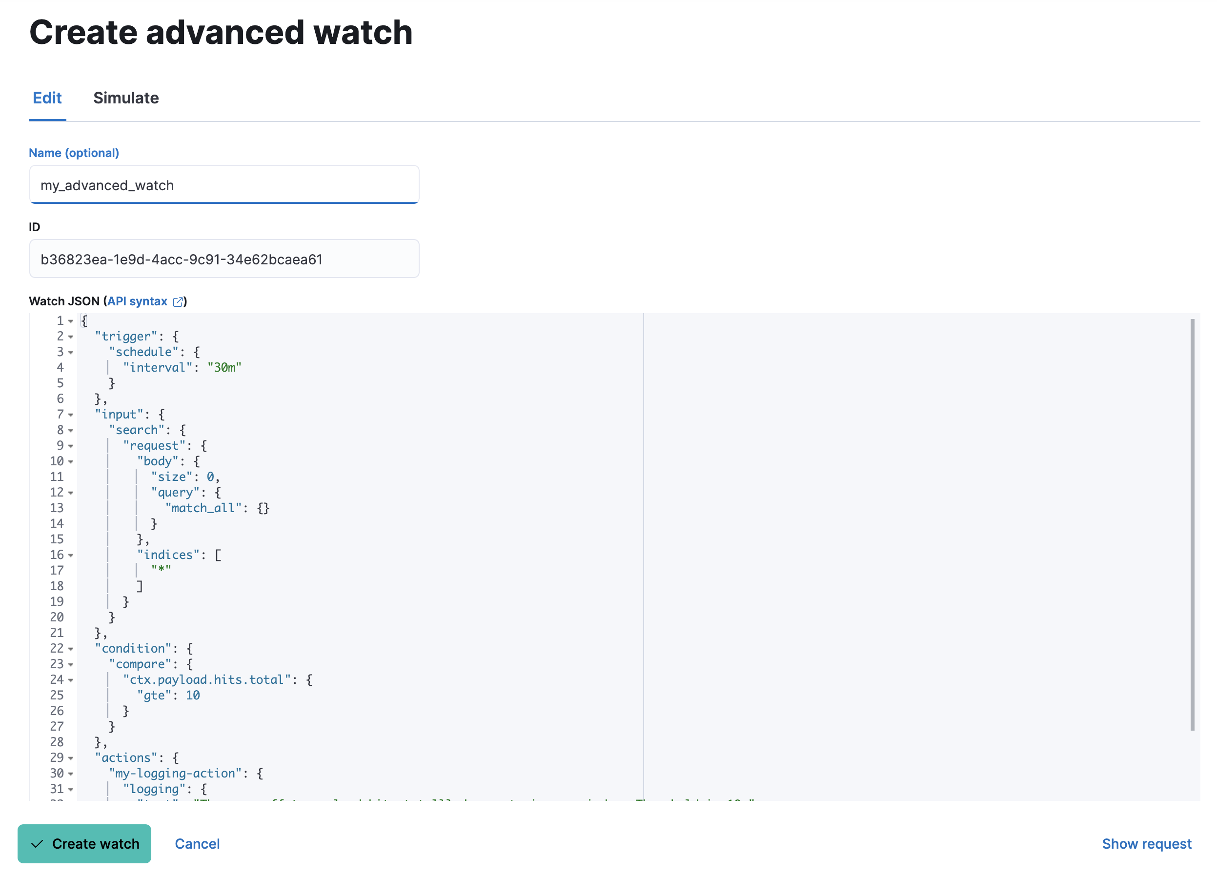

Create an advanced watch
editAdvanced watches are for users who are more familiar with Elasticsearch query syntax and the Watcher framework. The UI is aligned with using the REST APIs. For more information, see Query DSL.
Create the watch
editOn the Watch overview page, click Create and choose Create advanced watch. An advanced watch requires a name and ID. Name is a user-friendly way to identify the watch, and ID refers to the identifier used by Elasticsearch. Refer to Watch definition for how to input the watch JSON.

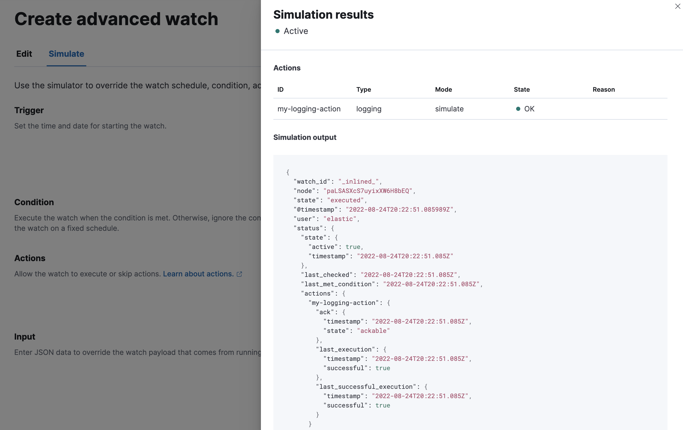

Simulate the watch
editThe Simulate tab allows you to override parts of the watch, and then run a simulation. Be aware of these implementation details on overrides:
- Trigger overrides use date math.
- Input overrides accepts a JSON blob.
Condition overrides indicates if you want to force the condition to always be
true. - Action overrides support multiple options.
Some watches, such as those using basic auth credentials, contain passwords. For security reasons, these passwords will be stripped from any watches that are loaded by the Watcher UI. You will need to manually re-enter these passwords to simulate the watch.
After starting the simulation, you’ll see a results screen. For more information on the fields in the response, see the Execute watch API.
