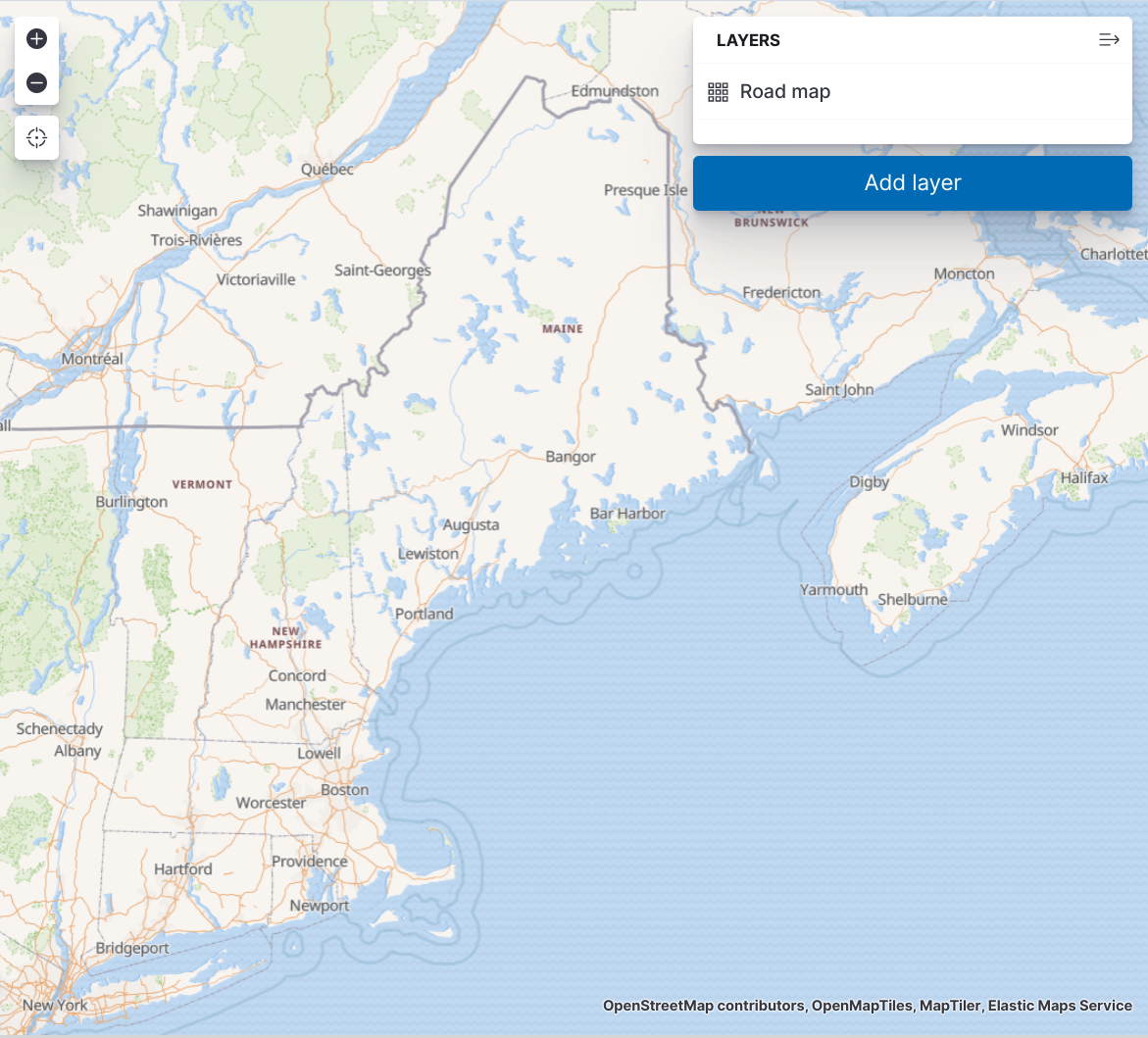

edit- Create a new map.
Zoom in on the New England area in the northeast United States.
You’re adding flight paths to this area, and this sets up the map for a good view of the data.
