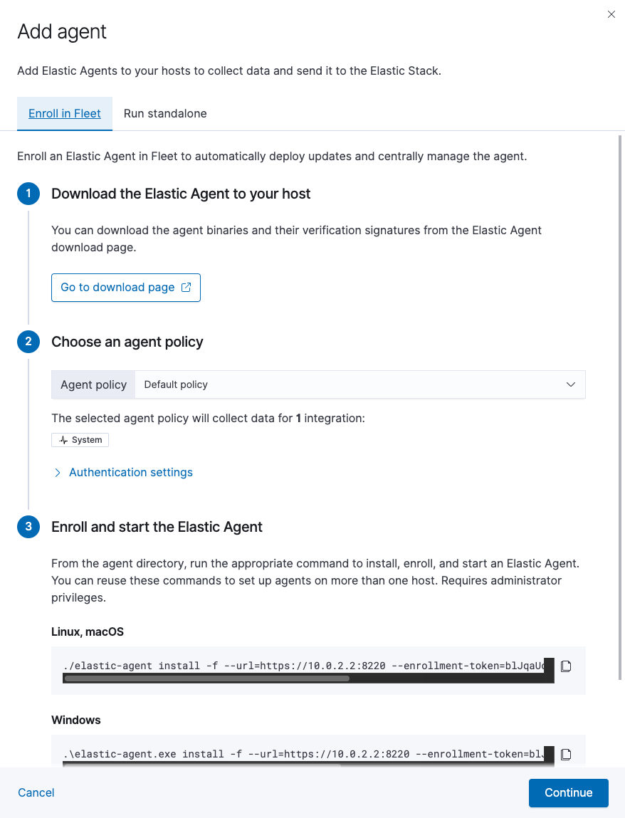

- On the Agents tab in Fleet, click Add agent.
Under Enroll in Fleet, follow the in-product installation steps.
See the download page for other installation options.
Notes:
- Use the default agent policy to get started quickly. This policy includes a system integration for collecting logs and metrics from the host system. You can change the policy later.
The
installcommand installs the Elastic Agent as a managed service, enrolls it in the selected policy, and starts the service. For example:./elastic-agent install -f --url=https://10.0.2.2:8220 \ --enrollment-token=blJqaUdua0JqYXA0bmNscVVjUkE6ZGh4WWNRSHRRek9aSS1paEs2cHdFQQ==
- Because Elastic Agent is installed as an auto-starting service, it will restart automatically if the system is rebooted.
- To see where files are installed, see Installation layout.
If installation is successful, you’ll see the agent on the Agents tab in Fleet. Notice that the Default policy is assigned to the agent.

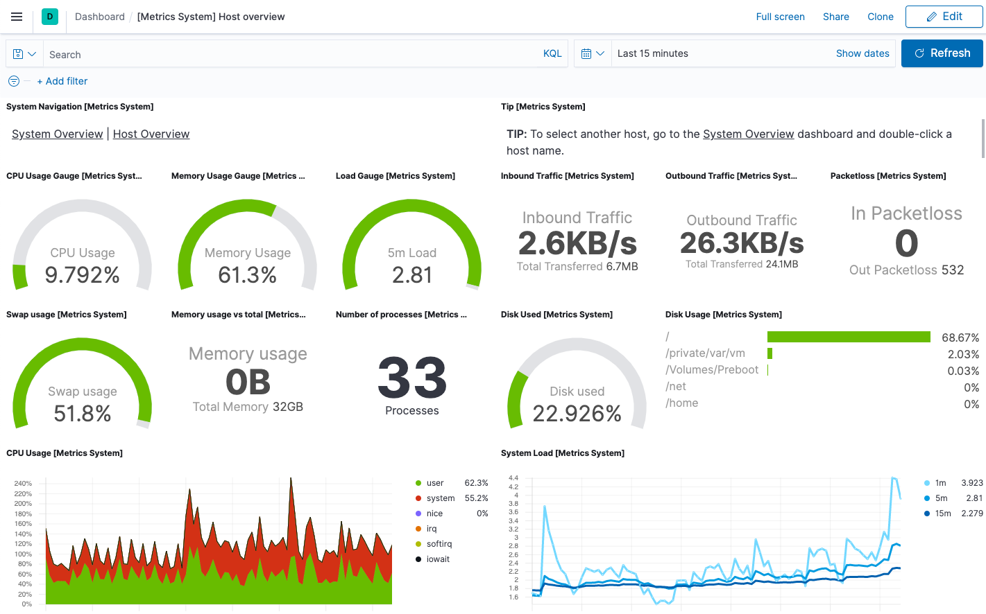

Step 3: Monitor host logs and metrics
editNext, view the data sent by Elastic Agent. Right now, Elastic Agent is only sending data about the host system because you haven’t configured the agent to collect data from other sources yet.
To see host logs and metrics:
- In Fleet, click the Data streams tab.
In the Actions column, navigate to the dashboards corresponding to the data stream. For example, to see host metrics, select one of the system datasets:
Then navigate to the [Metrics System] Host overview dashboard:

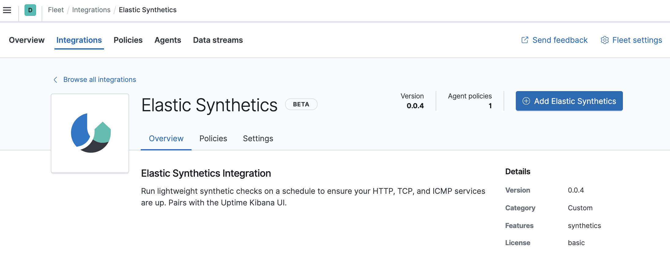

Step 4: Monitor HTTP, TCP, and ICMP services
edit[beta] This functionality is in beta and is subject to change. The design and code is less mature than official GA features and is being provided as-is with no warranties. Beta features are not subject to the support SLA of official GA features. Next, you’ll add the Elastic Synthetics integration, enabling you to monitor the status and response times of applications and services in real time. You can monitor the availability of network endpoints via HTTP, TCP, or ICMP.
Add the Elastic Synthetics integration to the default policy used by your agent. You use policies to manage settings across a group of agents. An agent policy may contain any number of integrations for collecting observability data from the various services running on your host.

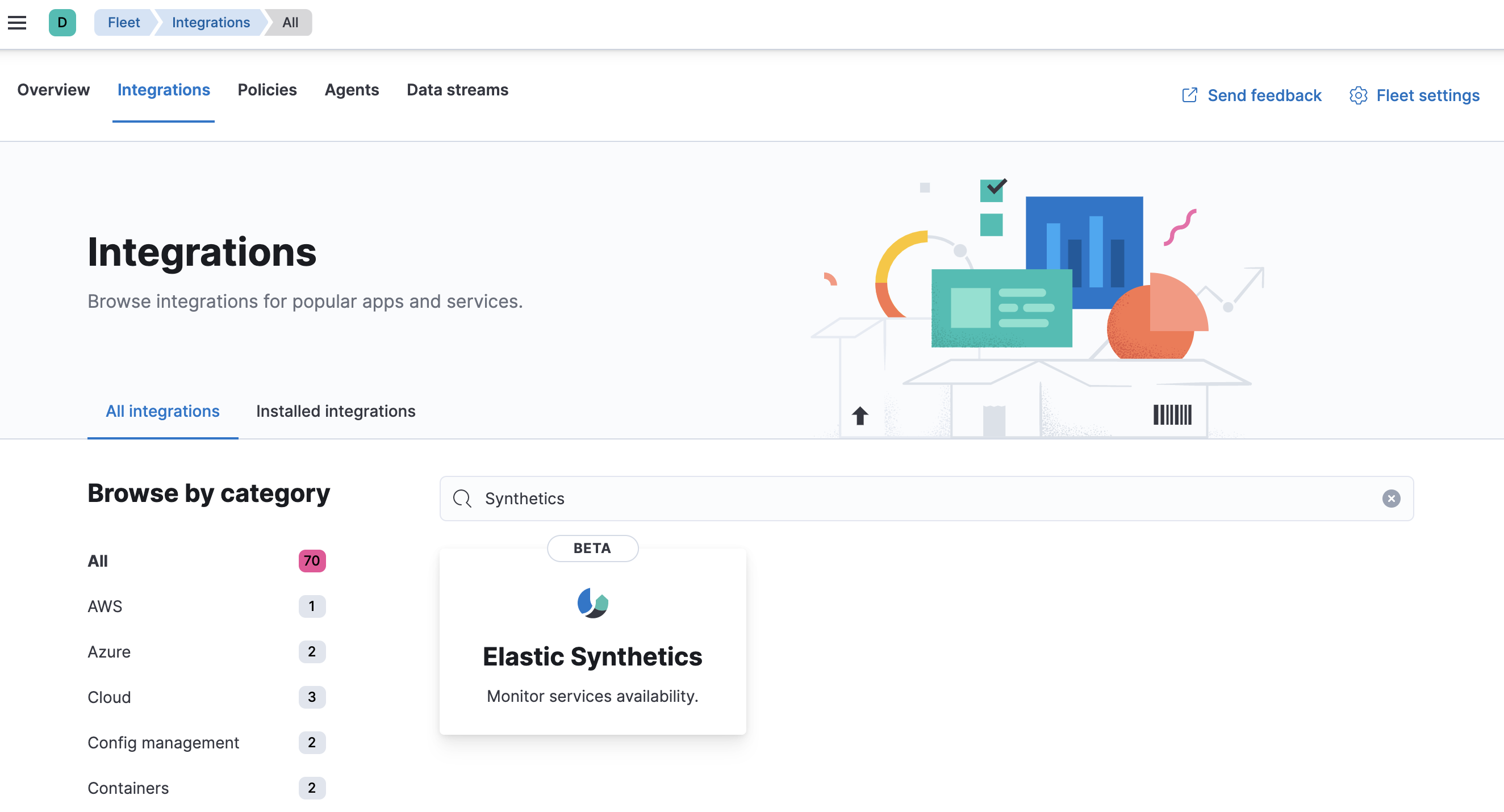

In Kibana, go back to Management > Fleet, and click the Integrations tab. Use the search bar to find the Elastic Synthetics integration.
Click the Elastic Synthetics integration to see more details about it, then click Add Elastic Synthetics.

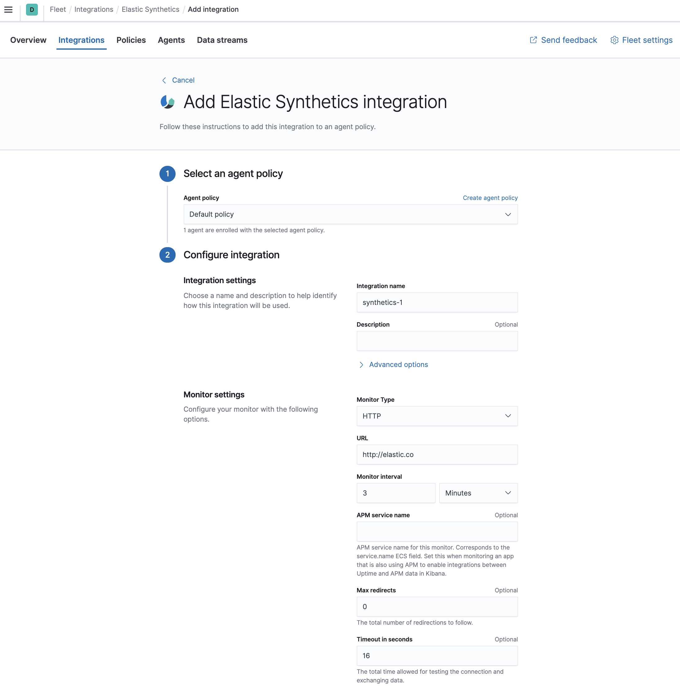

On the Add Elastic Synthetics integration page, select the
default policy.
Under Configure integration, enter the integration name and select HTTP from the following monitor types:
HTTP
Connects via HTTP and verifies that the host returns the expected response.
For detailed information about HTTP options, see our Heartbeat documentation.
TCP
Connects via TCP and verifies the endpoint by sending and receiving a custom payload. By default, the hostname and port are required.
For detailed information about TCP options, see our Heartbeat documentation.
ICMP
Uses an ICMP
v4andv6Echo Request to ping the configured hosts. By default, the host name is required.For detailed information about ICMP options, see our Heartbeat documentation.
- Enter the URL you want to monitor for availability and select a monitor interval in seconds or minutes. By default, a monitoring schedule of every 3 minutes is selected.
- The HTTP and TCP monitor types both support TLS. Under TLS settings, select Enable TLS configuration. Click the down arrow next to advanced HTTP or TCP options, and then enter your required settings.
- When you’re done, click Save integration to deploy the changes.

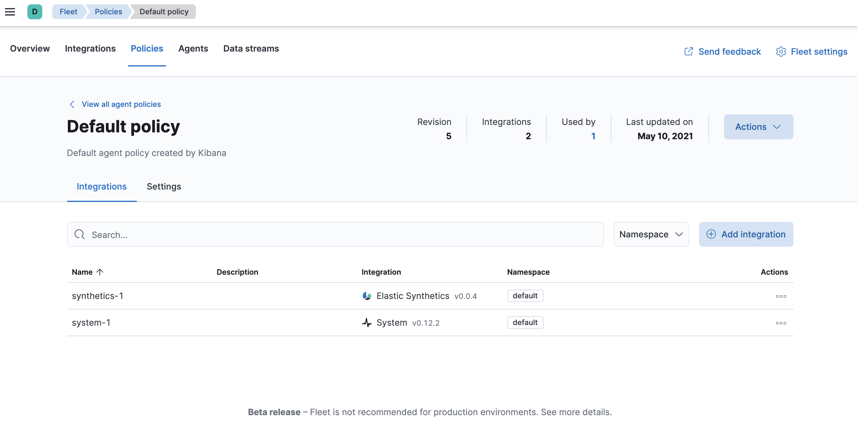

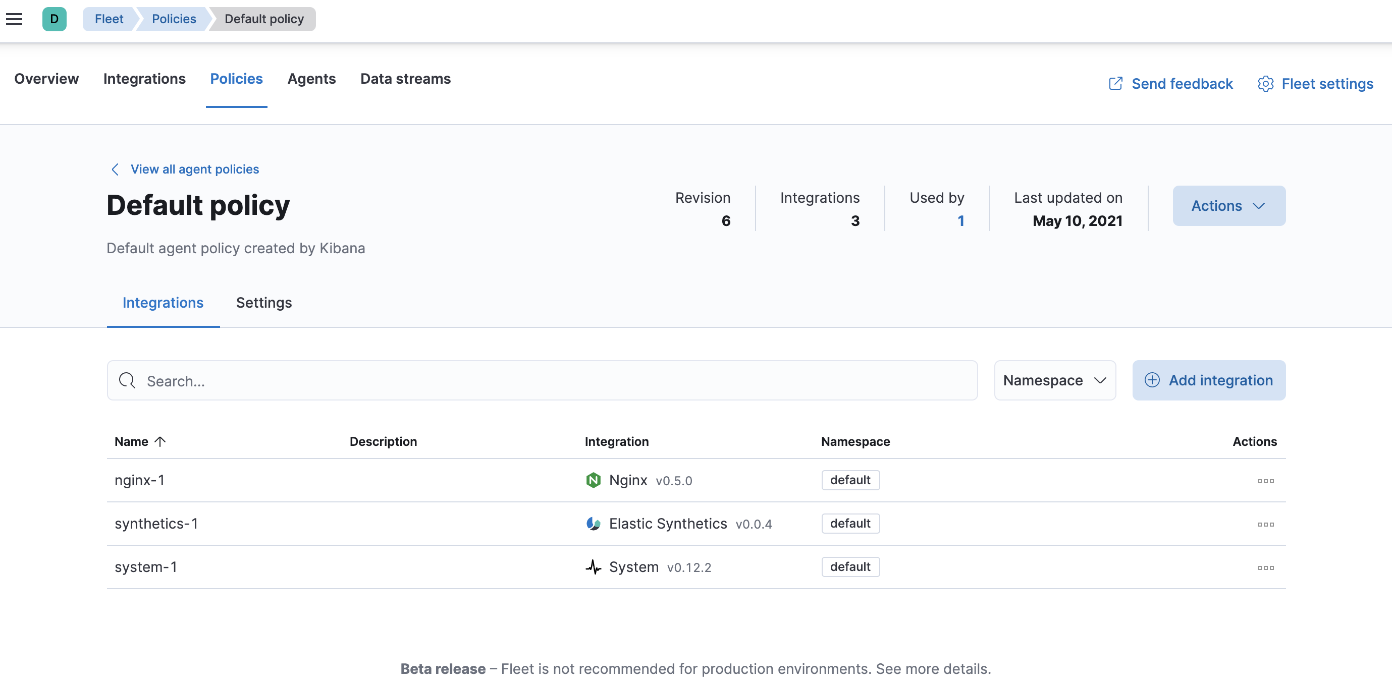

To see the updated policy, click the Policies tab, then click the Default policy link.
The newly added Elastic Synthetics integration should appear under Integrations in the default policy, along with the
system-1integration.
All Elastic Agents that use this policy will collect logs, metrics, and uptime data from the host.

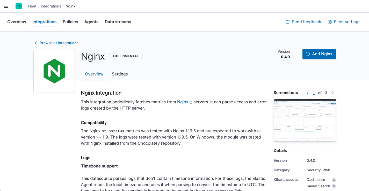

Step 5: Monitor Nginx logs and metrics
editNext, you’ll browse a catalog of integrations, then add an Nginx integration to the default policy used by your agent.
For these steps, we assume that you have nginx running on some of your
infrastructure, and want to collect logs and metrics from it.

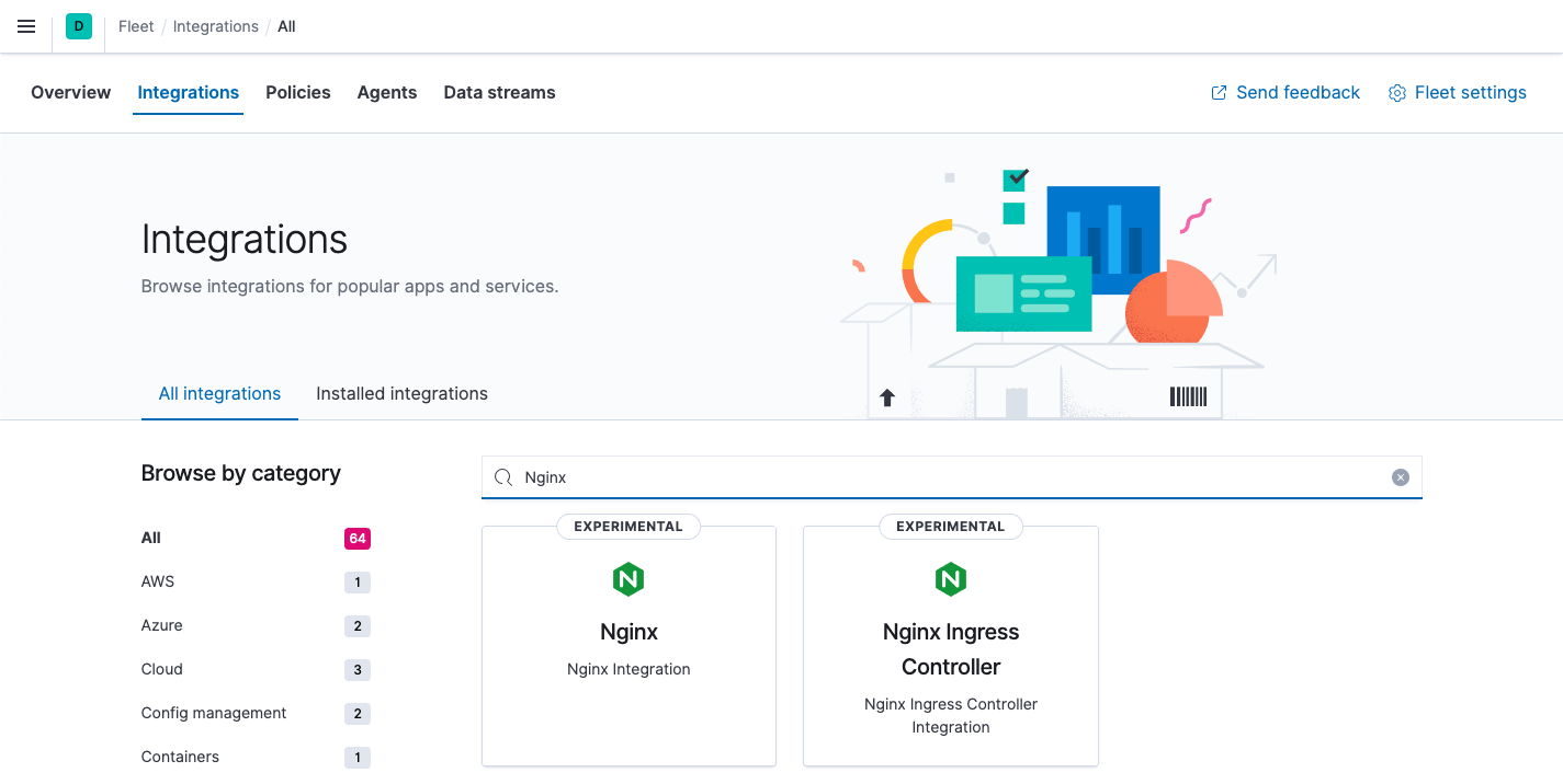

In Kibana, go back to Management > Fleet, and click the Integrations tab. Use the search bar to find the Nginx integration.
Click the Nginx integration to see more details about it, then click Add Nginx.
On the Add Nginx integration page, select the default policy.
In this guide, you add integrations to the default policy created by Kibana. After you learn the basics, you can create your own policies and assign them to agents.
- Under Configure integration, click the down arrow next to enabled streams and make sure the Paths are correct for your host. Inspect or change other settings
- When you’re done, save and deploy the changes.
The newly added Nginx integration should appear under Integrations in the default policy, along with the
system-1andsynthetics-1integrations.
All Elastic Agents that use this policy will collect logs and metrics from the Nginx server and the host, along with uptime data.
