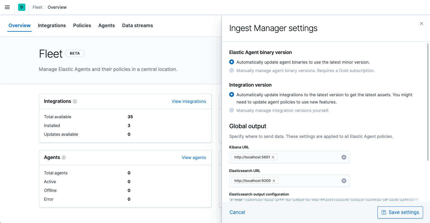

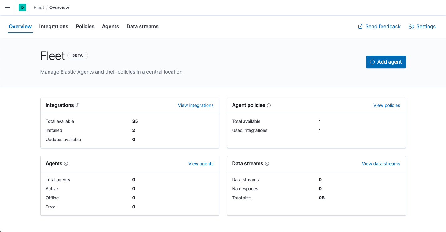

Log in to Kibana and go to Management > Fleet.
In Fleet, click Settings and change the defaults, if necessary. For self-managed installations, set the URLs for Elasticsearch and Kibana, including the http ports, then save your changes.

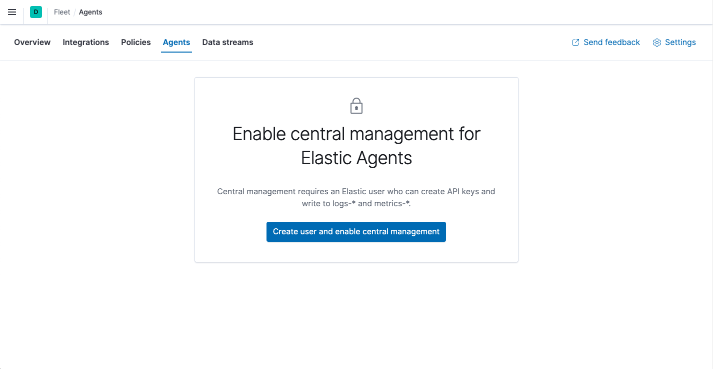

Enable central management. Click the Agents tab and click Create user and enable central management.

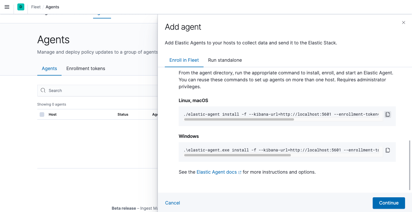

- On the Agents tab in Fleet, click Add agent, and look at the deployment instructions under Enroll in Fleet.
As instructed, download and extract the Elastic Agent to your host. To do this quickly from the command line, run:
curl -L -O https://artifacts.elastic.co/downloads/beats/elastic-agent/elastic-agent-7.11.2-darwin-x86_64.tar.gz tar xzvf elastic-agent-7.11.2-darwin-x86_64.tar.gz
curl -L -O https://artifacts.elastic.co/downloads/beats/elastic-agent/elastic-agent-7.11.2-linux-x86_64.tar.gz tar xzvf elastic-agent-7.11.2-linux-x86_64.tar.gz
- Download the Elastic Agent Windows zip file from the downloads page.
- Extract the contents of the zip file.
To simplify upgrading to future versions of Elastic Agent, we recommended that you use the tarball distribution instead of the DEB distribution.
curl -L -O https://artifacts.elastic.co/downloads/beats/elastic-agent/elastic-agent-7.11.2-amd64.deb sudo dpkg -i elastic-agent-7.11.2-amd64.deb
To simplify upgrading to future versions of Elastic Agent, we recommended that you use the tarball distribution instead of the RPM distribution.
curl -L -O https://artifacts.elastic.co/downloads/beats/elastic-agent/elastic-agent-7.11.2-x86_64.rpm sudo rpm -vi elastic-agent-7.11.2-x86_64.rpm
See the download page for other installation options.
- Back in Fleet, under Choose an agent policy, notice that the default policy is selected. The default policy includes a system integration for collecting logs and metrics from the host system. Use the default policy to get started quickly.
Under Enroll and start the Elastic Agent, copy the install command if it’s available for your platform, or make a note of the Kibana URL and enrollment token that was generated by Fleet.
From the agent directory, run the appropriate command to install, enroll, and start an Elastic Agent. Note that this command installs Elastic Agent files in the locations described in Installation layout.
You must run this command as the root user because some integrations require root privileges to collect sensitive data.
Open a PowerShell prompt as an Administrator (right-click the PowerShell icon and select Run As Administrator).
From the PowerShell prompt, change to the directory where you installed Elastic Agent, and run:
sudo elastic-agent enroll <kibana_url> <enrollment_token> sudo systemctl enable elastic-agent sudo systemctl start elastic-agent
kibana_urlis the Kibana URL where Fleet is running, andenrollment_tokenis the enrollment token acquired from Fleet.The DEB package includes a service unit for Linux systems with systemd. On these systems, you can manage Elastic Agent by using the usual systemd commands. If you don’t have systemd, run
sudo service elastic-agent start.You must run this command as the root user because some integrations require root privileges to collect sensitive data.
kibana_urlis the Kibana URL where Fleet is running, andenrollment_tokenis the enrollment token acquired from Fleet.The RPM package includes a service unit for Linux systems with systemd. On these systems, you can manage Elastic Agent by using the usual systemd commands. If you don’t have systemd, run
sudo service elastic-agent start.Because Elastic Agent is installed as an auto-starting service, it will restart automatically if the system is rebooted.

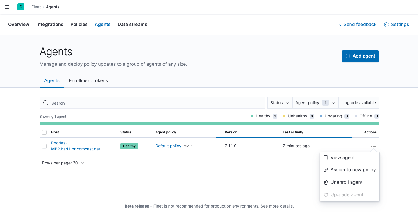

In Fleet, click Continue to go to the Agents tab, where you should see the newly enrolled agent.
If the status hangs at Enrolling, make sure the elastic-agent process
is running.
If you run into problems, see Troubleshoot common problems.

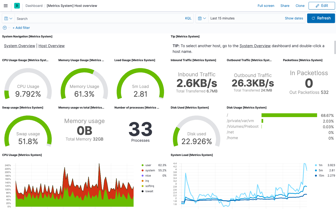

Step 3: Monitor host logs and metrics
editNext, view the data sent by Elastic Agent. Right now, Elastic Agent is only sending data about the host system because you haven’t configured the agent to collect data from other sources yet.
To see host logs and metrics:
- In Fleet, click the Data streams tab.
In the Actions column, navigate to the dashboards corresponding to the data stream. For example, to see host metrics, select one of the system datasets:
Then navigate to the [Metrics System] Host overview dashboard:

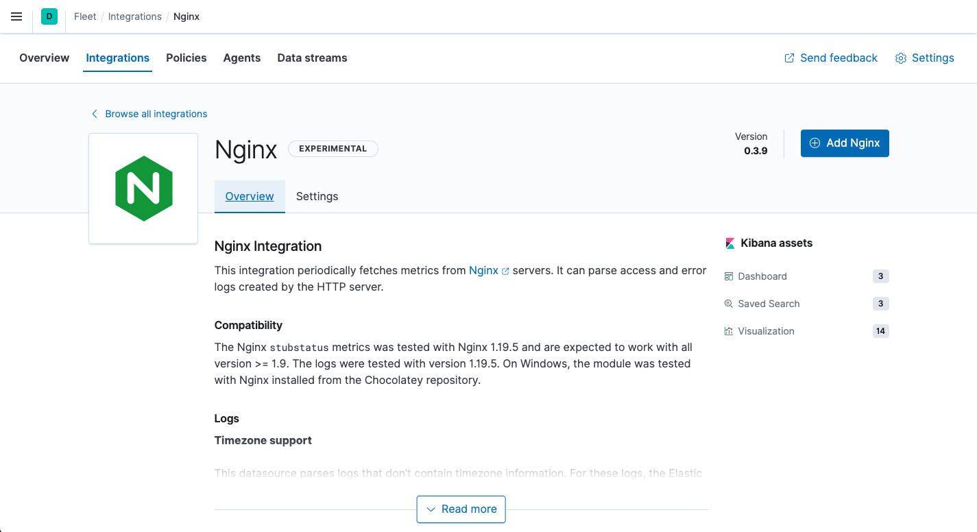

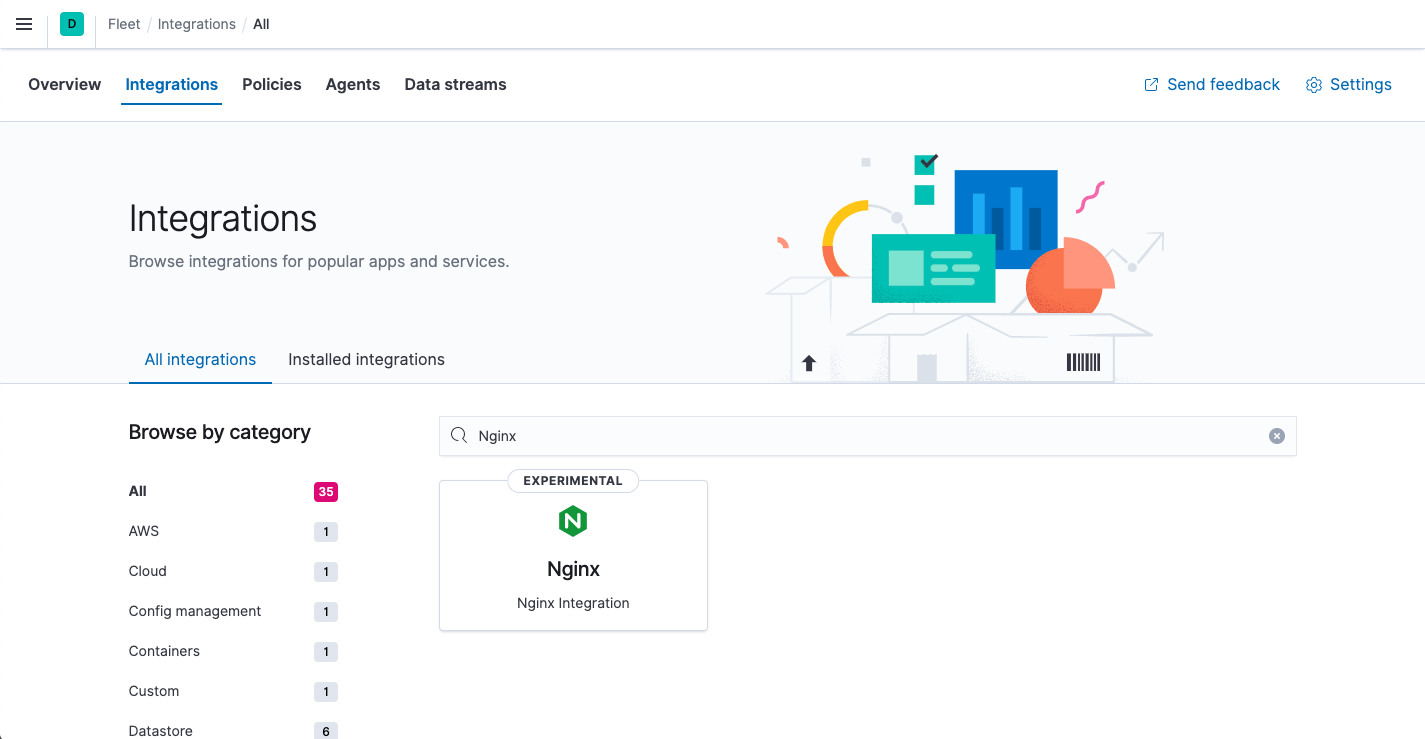

In Kibana, go back to Management > Fleet, and click the Integrations tab. Use the search bar to find the Nginx integration.
Click the Nginx integration to see more details about it, then click Add Nginx.

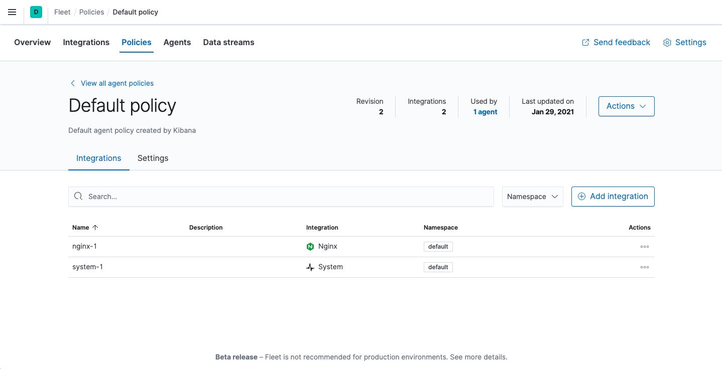

On the Add Nginx integration page, select the default policy.
In this guide, you add integrations to the default policy created by Kibana. After you learn the basics, you can create your own policies and assign them to agents.
- Under Configure integration, click the down arrow next to enabled streams and make sure the Paths are correct for your host. Inspect or change other settings
When you’re done, save and deploy the changes.
The newly added Nginx integration should appear under Integrations in the default policy, along with the
system-1integration that you used earlier to collect host data.
All Elastic Agents that use this policy will collect logs and metrics from the Nginx server and the host.
