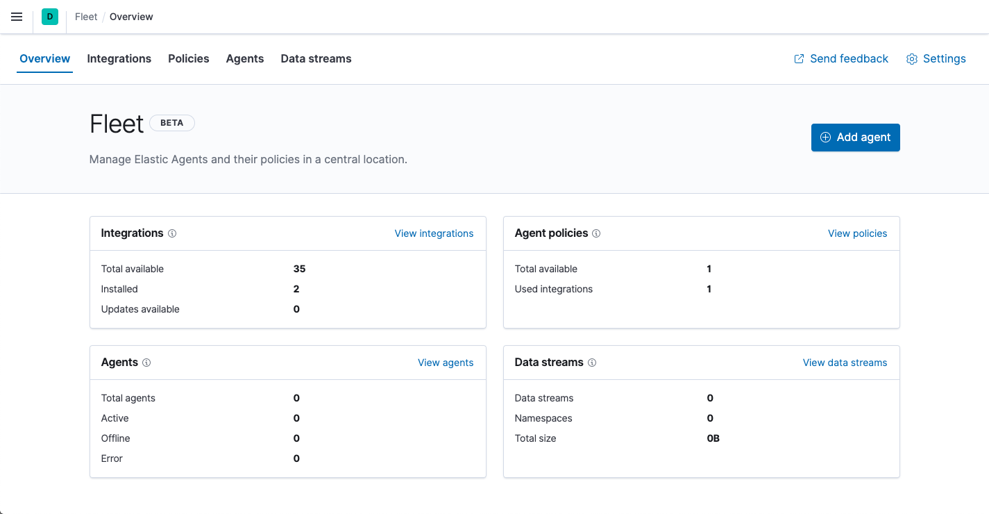

Step 1: Set up Fleet
editThe best way to get logs, metrics, and security data into the Elastic Stack is by using Fleet in Kibana.
Not using Fleet? Advanced users who want to configure and manage Elastic Agents manually can run agents standalone.
The first time you use Fleet, you need to set it up:
Log in to Kibana and go to Management > Fleet.

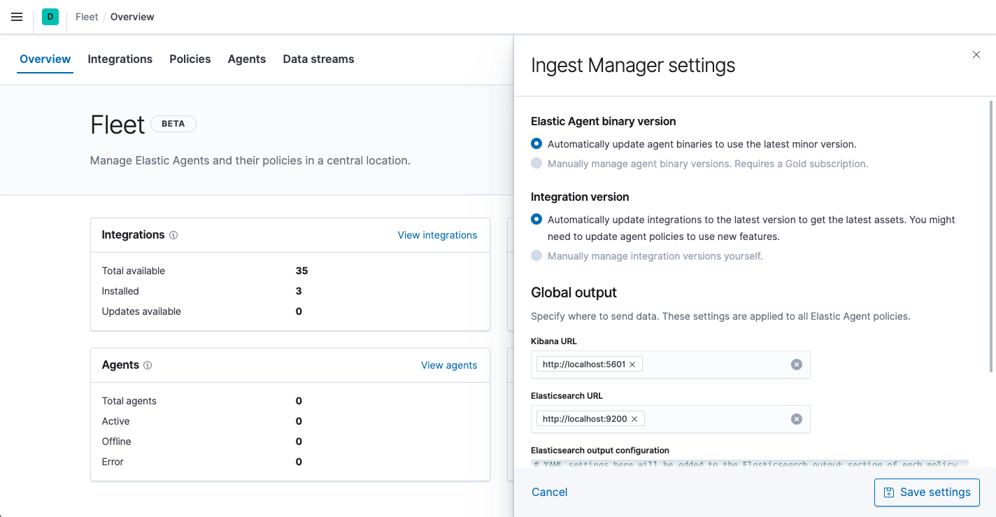

In Fleet, click Settings and change the defaults, if necessary. For self-managed installations, set the URLs for Elasticsearch and Kibana, including the http ports, then save your changes.

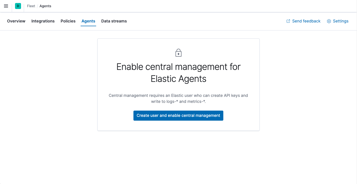

Enable central management. Click the Agents tab and click Create user and enable central management.

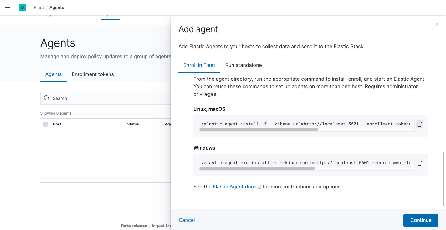

Step 2: Add an Elastic Agent to Fleet
editElastic Agent is a single, unified agent that you can deploy to hosts or containers to collect data and send it to the Elastic Stack. Behind the scenes, Elastic Agent runs the Beats shippers or Elastic Endpoint required for your configuration.
To send logs and metrics to the Elastic Stack:
- On the Agents tab in Fleet, click Add agent, and look at the deployment instructions under Enroll in Fleet.
As instructed, download and extract the Elastic Agent to your host:
curl -L -O https://artifacts.elastic.co/downloads/beats/elastic-agent/elastic-agent-7.10.2-darwin-x86_64.tar.gz tar xzvf elastic-agent-7.10.2-darwin-x86_64.tar.gz
curl -L -O https://artifacts.elastic.co/downloads/beats/elastic-agent/elastic-agent-7.10.2-linux-x86_64.tar.gz tar xzvf elastic-agent-7.10.2-linux-x86_64.tar.gz

- Back in Fleet, under Choose an agent policy, notice that the default policy is selected. The default policy includes a system integration for collecting logs and metrics from the host system.
Under Enroll and start the Elastic Agent, copy the install command if it’s available for your platform, or make a note of the Kibana URL and enrollment token that was generated by Fleet.
From the agent directory, run the appropriate command to install, enroll, and start an Elastic Agent. Note that this command will overwrite the
elastic-agent.ymlfile in that directory.You must run this command as the root user because some integrations require root privileges to collect sensitive data.

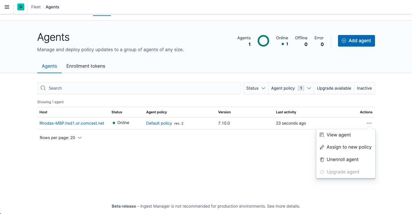

In Fleet, click Continue to go to the Agents tab, where you should see the newly enrolled agent.
If the status hangs at Enrolling, make sure the elastic-agent process
is running.

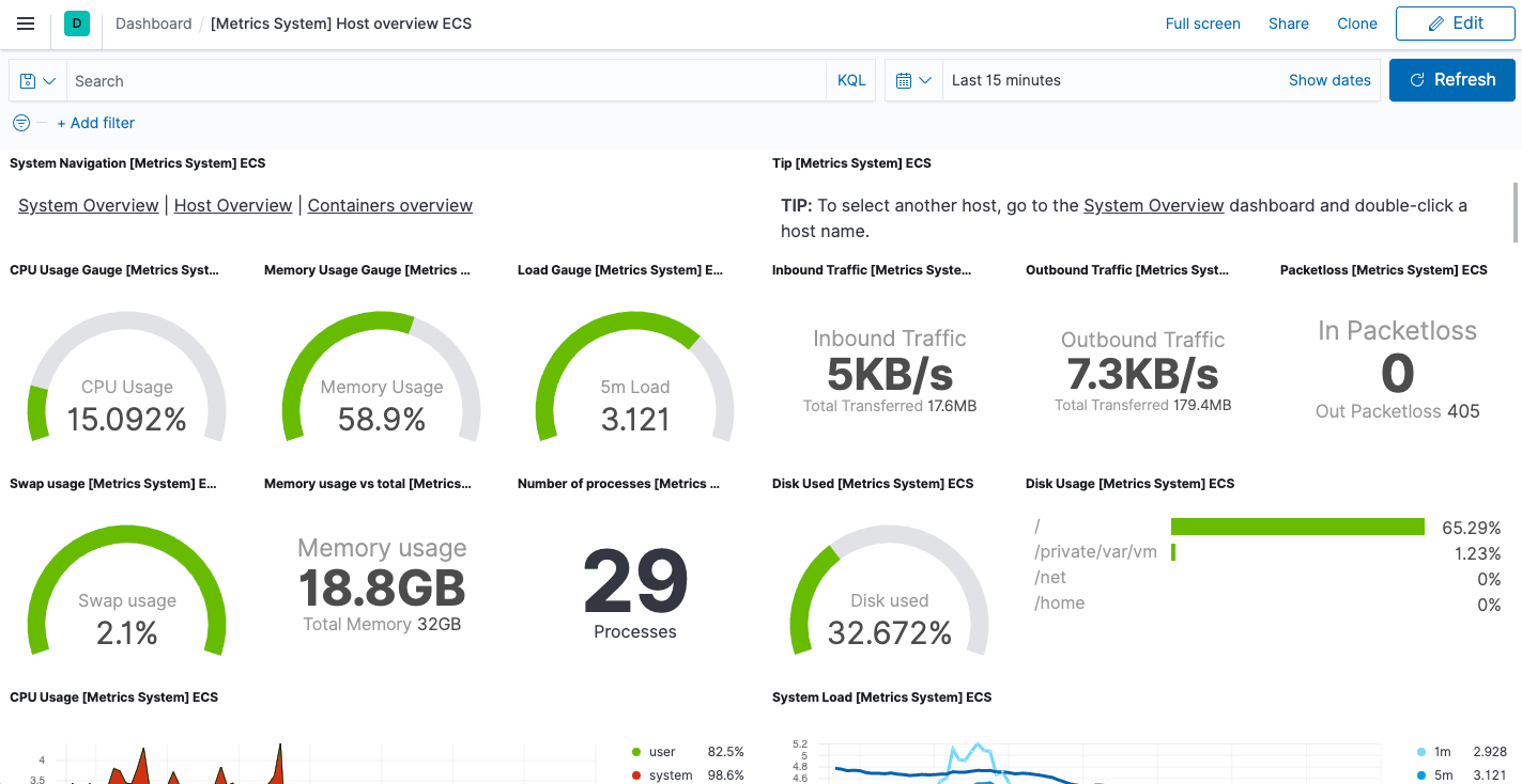

In the Actions column, navigate to the dashboards corresponding to the data stream. For example, to see host metrics, select one of the system datasets:
Then navigate to the [Metrics System] Host overview dashboard:

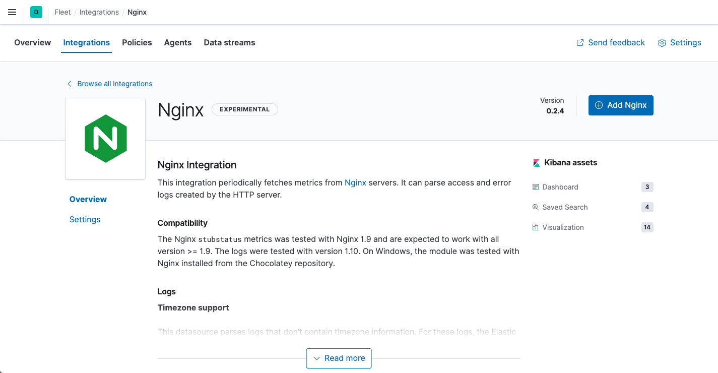

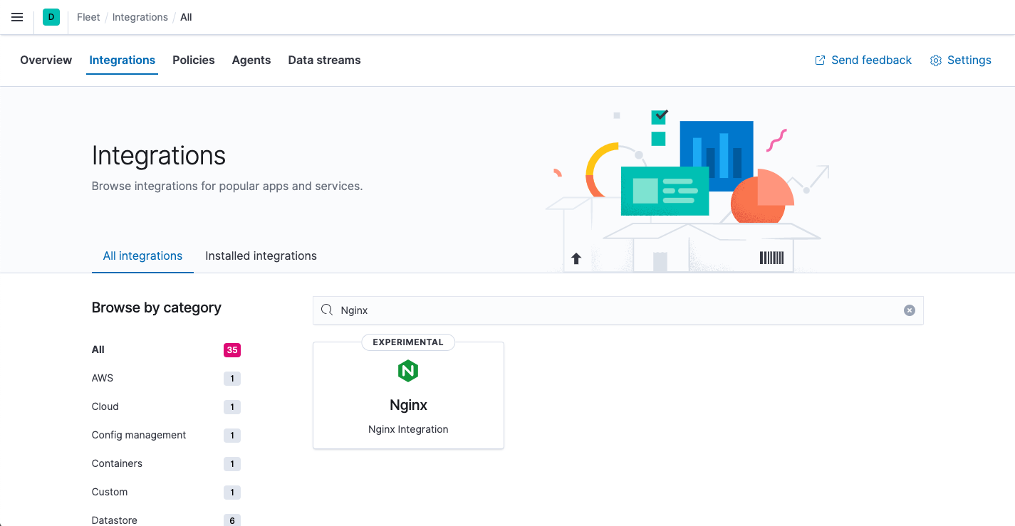

In Kibana, go back to Management > Fleet, and click the Integrations tab. Use the search bar to find the Nginx integration.
Click the Nginx integration to see more details about it, then click Add Nginx.

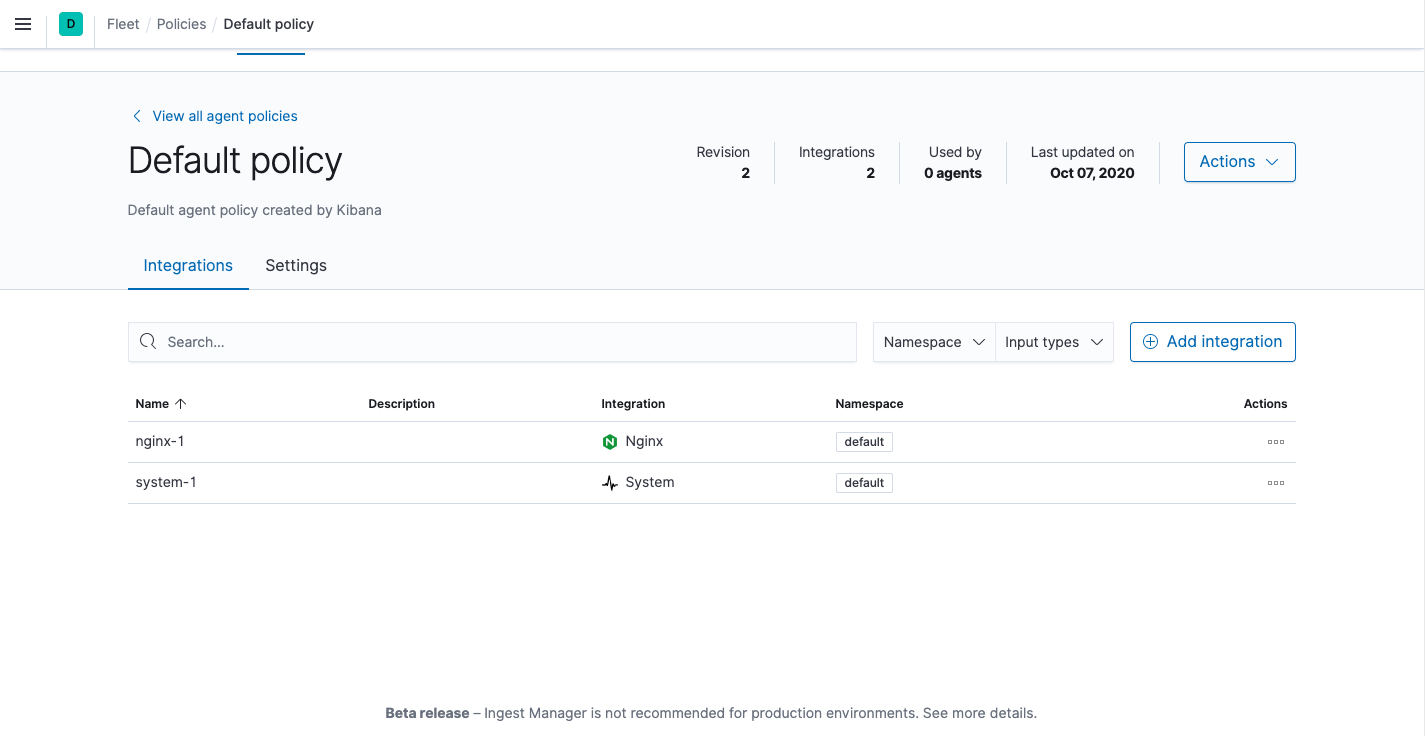

On the Add Nginx integration page, select the default policy.
In this guide, you add integrations to the default policy created by Kibana. After you learn the basics, you can create your own policies and assign them to agents.
- Under Configure integration, click the down arrow next to enabled streams and make sure the Paths are correct for your host. Inspect or change other settings
When you’re done, save and deploy the changes.
The newly added Nginx integration should appear under Integrations in the default policy, along with the
system-1integration that you used earlier to collect host data.
All Elastic Agents that use this policy will collect logs and metrics from the Nginx server and the host.
