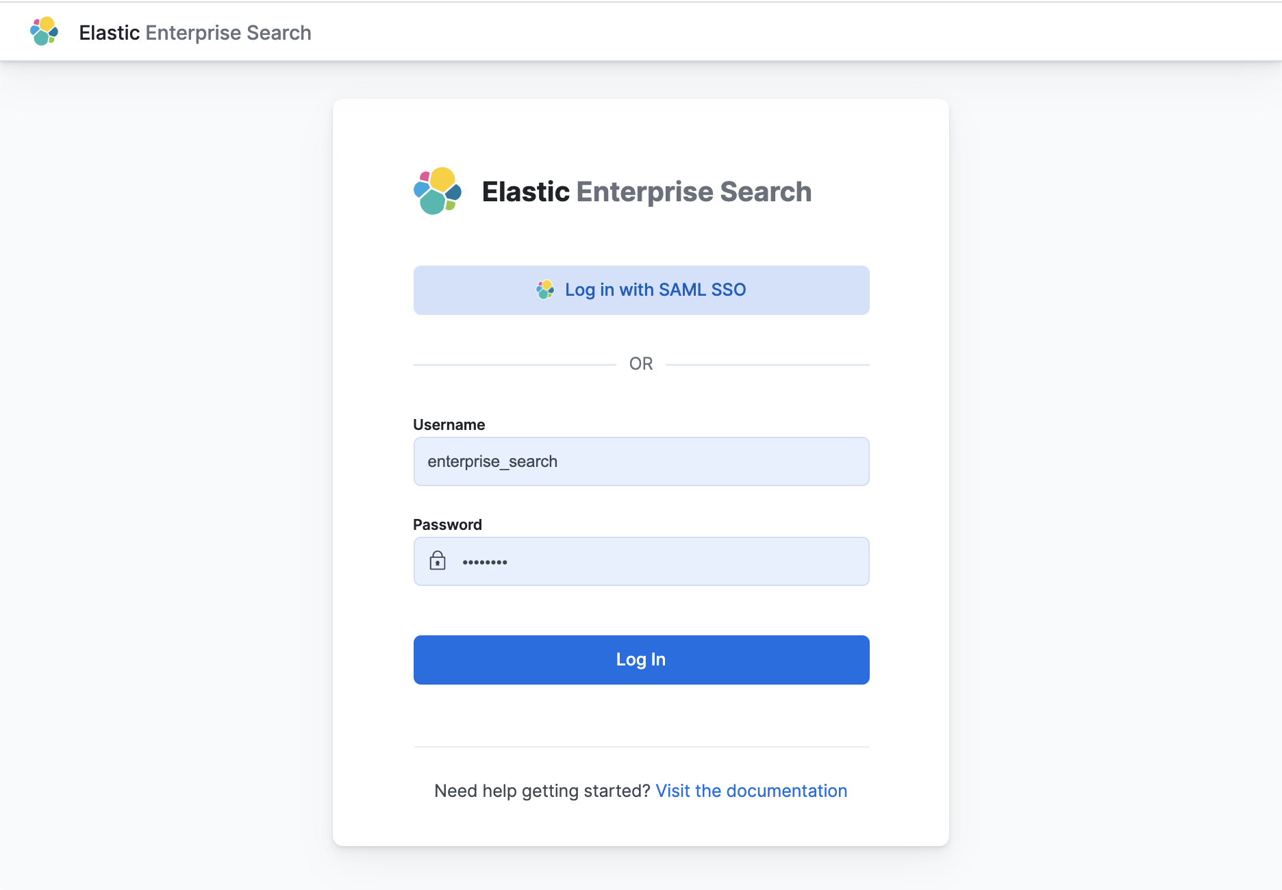

Enterprise Search with SAML login

Save these settings, and wait for your cluster to restart. The next time you select Launch Enterprise Search, you’ll have the option to log in with Okta SSO.
