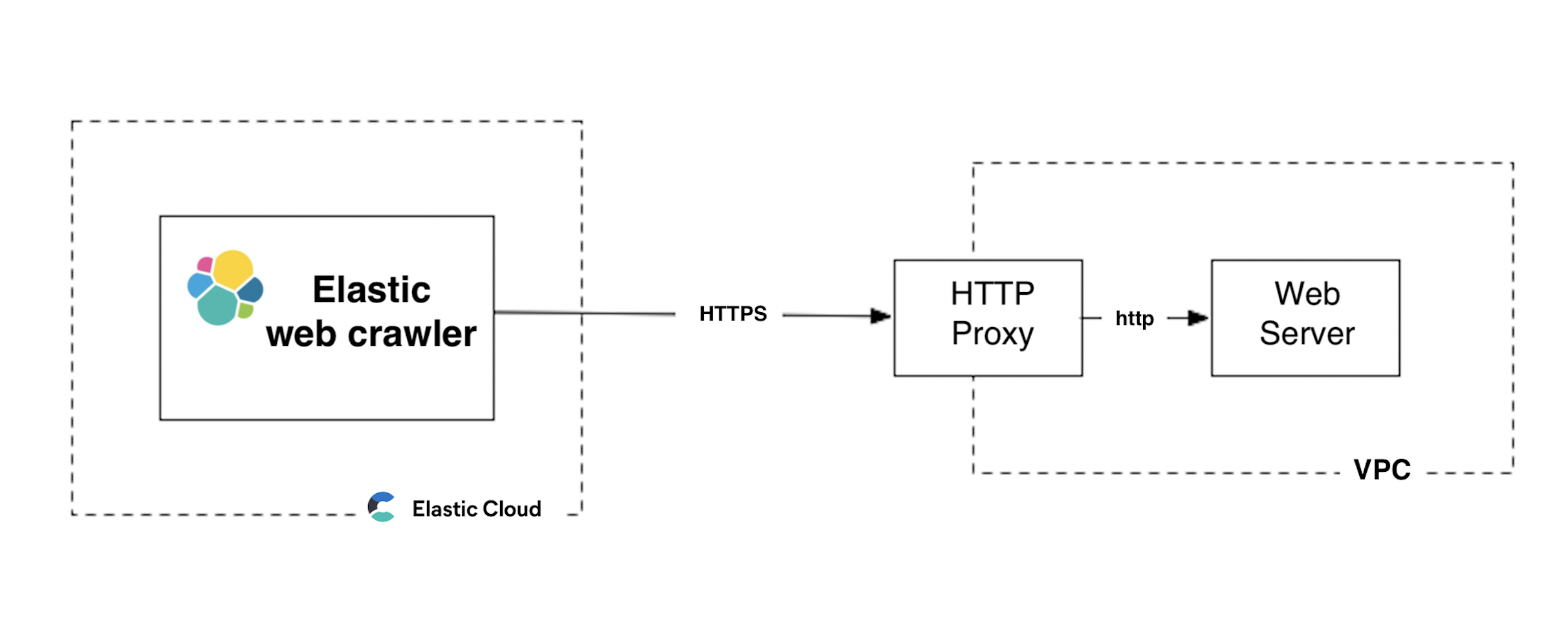

Infrastructure overview
editTo demonstrate the authenticated proxy server functionality for the web crawler, we will use the infrastructure outlined in this schematic diagram:
This example includes all the components needed to understand the use case:
- A VPC (virtual private network) deployed within Google Cloud
The VPC contains two cloud instances:
web-serverandproxy:- The web-server hosts a private website, that is only accessible from within the VPC, using a private domain name: http://marlin-docs.internal.
The proxy server has basic HTTP authentication set up with the username
proxyuserand passwordproxypass. It is accessible from the public internet using the host nameproxy.example.comand the port number3128.
An Enterprise Search deployment running outside of the VPC, in Elastic Cloud.
- This deployment has no access to the private network hosting our content.
The web crawler supports both HTTP and HTTPS. However, we recommend configuring TLS to protect your content and proxy server credentials.
Refer to your proxy server software documentation for more details on how to set this up.

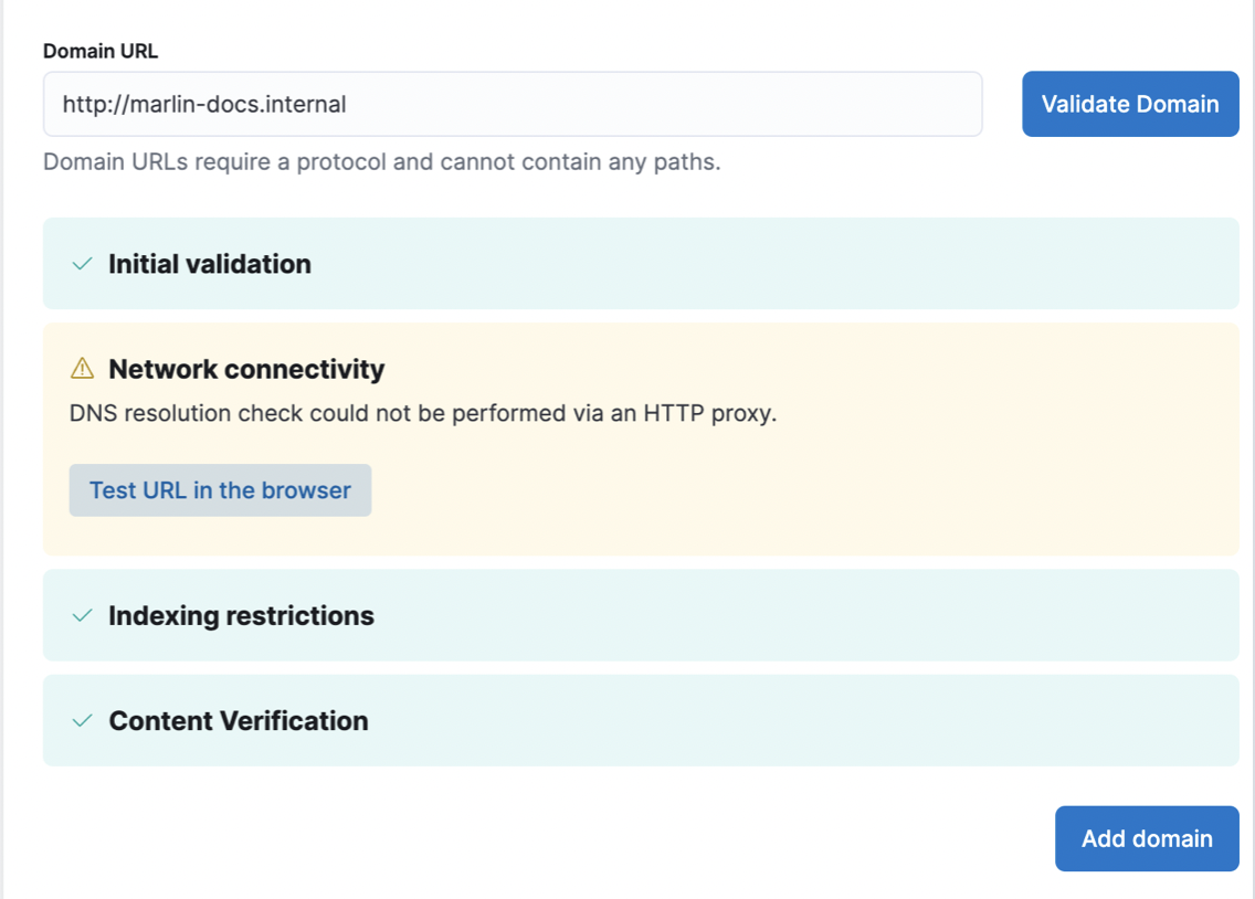

- Go to Enterprise Search in Kibana.
- Create an Elasticsearch index.
- Choose the Use the Web Crawler ingestion method.
- Add your domain URL to be validated by the crawler.
The validation process will look like the one in this image:
The validation process for adding a domain to the web crawler configuration will skip a number of networking-related checks, since these do not work through a proxy. If you do not see the warning like in the above image, check your deployment configuration to ensure you have configured the proxy correctly.
Our private domain is now added to the configuration. We can start the crawl, and the content should be ingested into the deployment. If there are failures, check your crawler logs and proxy server’s logs for clues about what might be going wrong.
