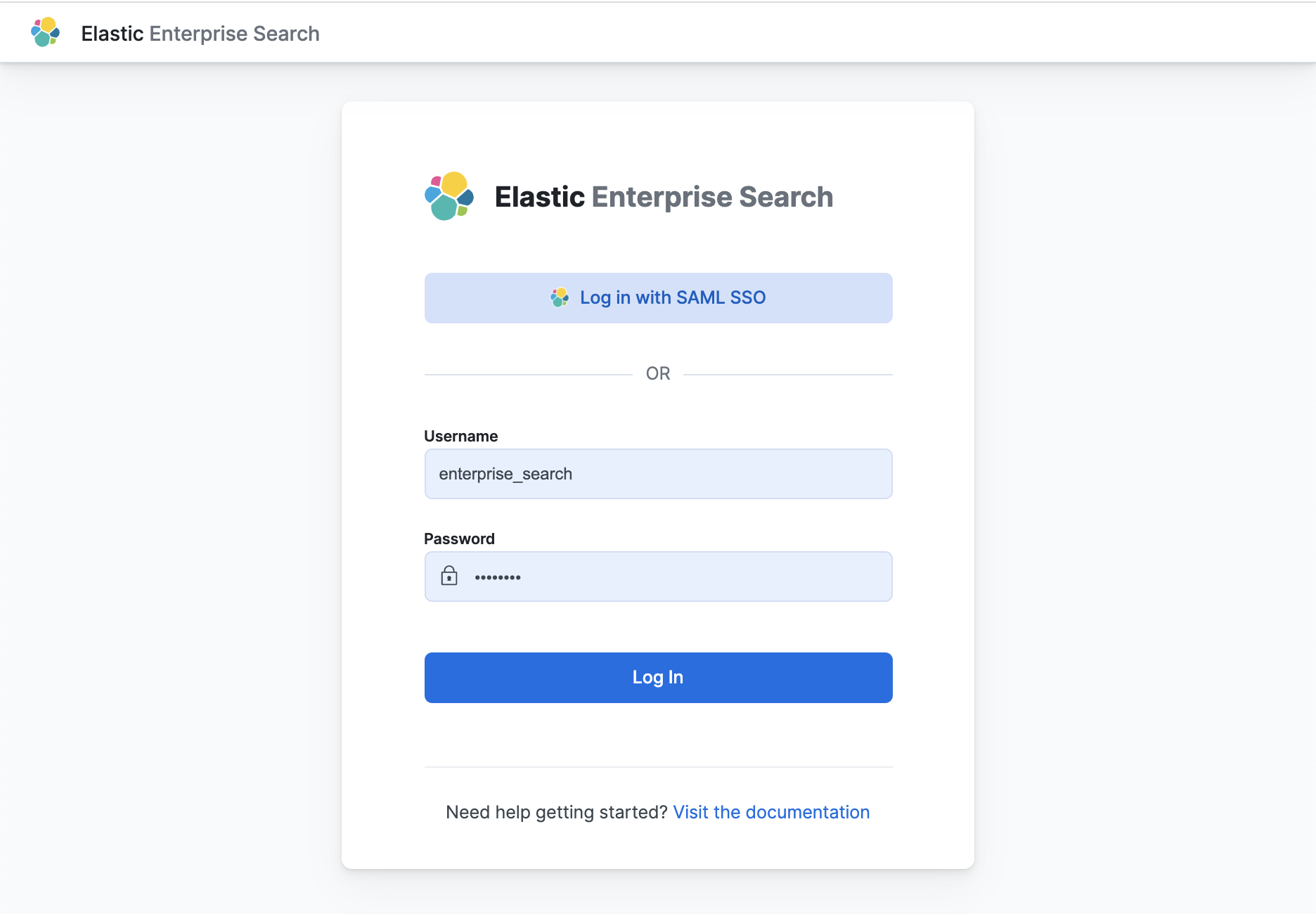

Save these settings, and wait for your cluster to restart. The next time you select Launch Enterprise Search, you’ll have the option to log in with Okta SSO.
