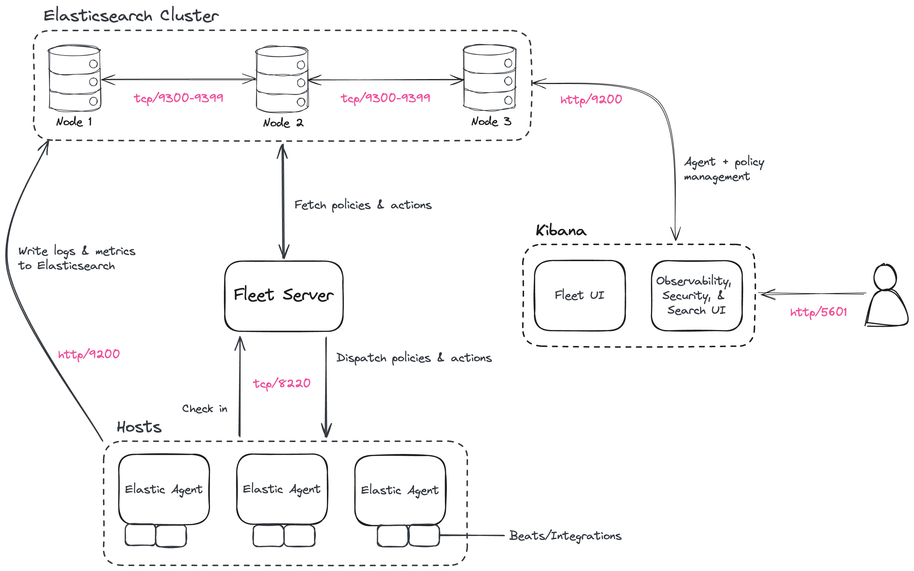

Elastic Stack overviewedit
Before starting, take a moment to familiarize yourself with the Elastic Stack components.
Image showing the relationships between stack components
To learn more about the Elastic Stack and how each of these components are related, refer to An overview of the Elastic Stack.
