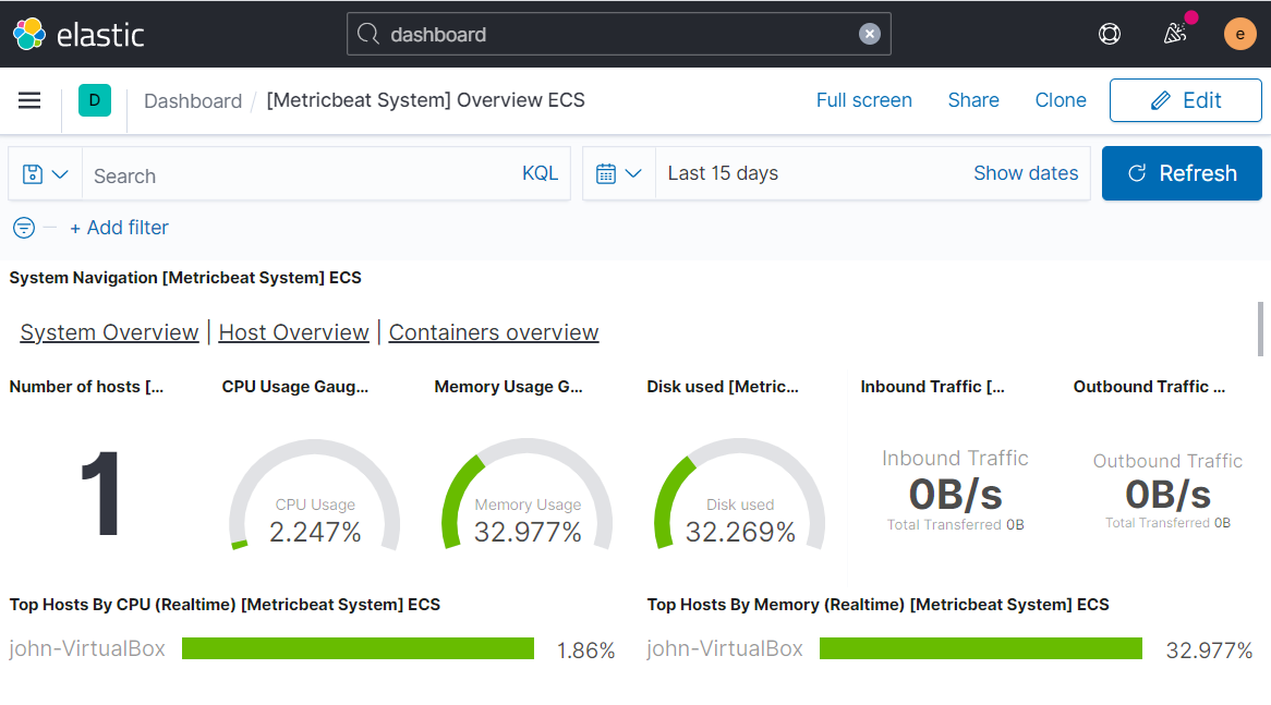

Load the Metricbeat Kibana dashboards
Metricbeat comes packaged with example dashboards, visualizations, and searches for visualizing Metricbeat data in Kibana. Before you can use the dashboards, you need to create the data view (formerly index pattern) metricbeat-*, and load the dashboards into Kibana. This needs to be done from a local Beats machine that has access to the Elastic Cloud Enterprise deployment.

Your results should be similar to the following:
Index setup finished.
Loading dashboards (Kibana must be running and reachable)
Loaded dashboards

The data views for filebeat-* and metricbeat-* are now available in Elasticsearch. To verify:
  1. Login to Kibana.
  2. Open the Kibana main menu and select Stack Management, then Data views.
  3. In the search bar, search for data views.
  4. In the search results, choose Kibana / Data Views Management.

  1. Login to Kibana.
  2. Open the Kibana main menu and select Analytics, then Dashboard.
  3. In the search box, search for metricbeat system. The search results show several dashboards available for you to explore.
  4. In the search results, choose [Metricbeat System] Overview ECS. A Metricbeat dashboard opens:
A screencapture of the Kibana dashboard named Metricbeat System Overview ECS
