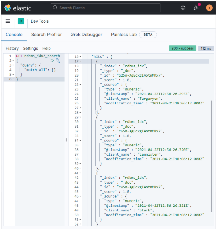

  6. Logstash outputs the MySQL data to your Elastic Cloud Enterprise deployment. Let’s take a look in Kibana and verify that data:
    1. Log into the Cloud UI.
    2. On the deployments page, select your deployment.
      Narrow the list by name, ID, or choose from several other filters. To further define the list, use a combination of filters.
    3. From your deployment menu, select Kibana, then Launch.
    4. Open the side-menu panel using the three vertical line button.
    5. Scroll down and expand Management.
    6. Select Management and then Dev Tools.
    7. Copy and paste the following API GET request into the Console pane, and then use the Play arrow. This queries all records in the new rdbms_idx index.
      GET rdbms_idx/_search
        "query": {
          "match_all": {}
    8. The Results pane lists the client_name records originating from your MySQL database, similar to the following example:
      A picture showing query results with three records
Now, you should have a good understanding of how to configure Logstash to ingest data from your relational database through the JDBC Plugin. You have some design considerations to track records that are new, modified, and deleted. You should have the basics needed to begin experimenting with your own database and Elasticsearch.
