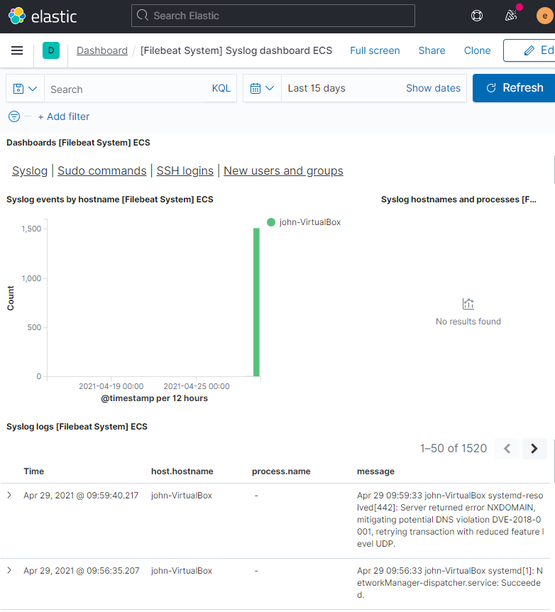

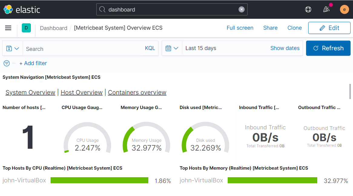

The data views for filebeat-* and metricbeat-* are now available in Elasticsearch. To verify:
  1. Login to Kibana.
  2. Open the Kibana main menu and select Stack Management, then Data views.
  3. In the search bar, search for data views.
  4. In the search results, choose Kibana / Data Views Management.
Finish configuring Filebeat

View the Metricbeat dashboard
  1. Login to Kibana.
  2. Open the Kibana main menu and select Analytics, then Dashboard.
  3. In the search box, search for metricbeat system. The search results show several dashboards available for you to explore.
  4. In the search results, choose [Metricbeat System] Overview ECS. A Metricbeat dashboard opens:
A screencapture of the Kibana dashboard named Metricbeat System Overview ECS
View the Filebeat dashboard
  1. Open the Kibana main menu and select Analytics, then Dashboard.
  2. In the search box, search for filebeat system.
  3. In the search results, choose [Filebeat System] Syslog dashboard ECS. A Filebeat dashboard displaying your Filebeat data:
A screencapture of the Kibana dashboard named Filebeat System ECS
