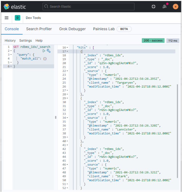

  6. Logstash outputs the MySQL data to your Elastic Cloud Enterprise deployment. Let’s take a look in Kibana and verify that data:
    1. Log into the Cloud UI.

    7. Copy and paste the following API GET request into the Console pane, and then use the Play arrow. This queries all records in the new rdbms_idx index.
      GET rdbms_idx/_search
        "query": {
          "match_all": {}
    8. The Results pane lists the client_name records originating from your MySQL database, similar to the following example:
      A picture showing query results with three records
