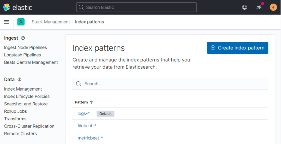

The index patterns for filebeat-* and metricbeat-* are now available in Elasticsearch. To verify:
- Login to Kibana.
- Open the Kibana main menu and click Stack Management and then Index Patterns.
- In the search bar, search for index patterns.
In the search results, click Kibana / Index Patterns Management. The display should be similar to the following:

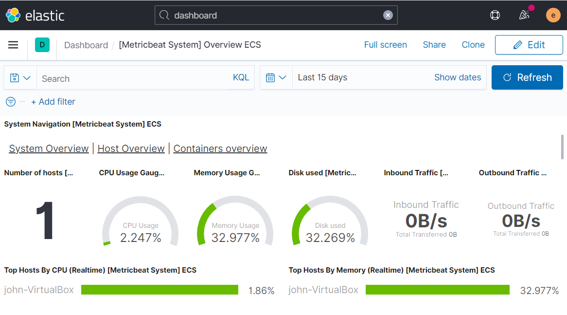

- Login to Kibana.
- Open the Kibana main menu and click Analytics and then Dashboard.
- In the search box, search for metricbeat system. The search results show several dashboards available for you to explore.
- In the search results, click [Metricbeat System] Overview ECS. A Metricbeat dashboard opens:

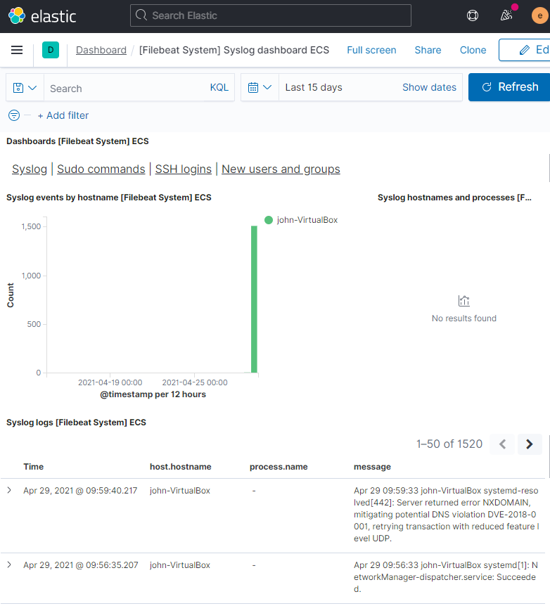

- In the search box, search for filebeat system.
- In the search results, click [Filebeat System] Syslog dashboard ECS. A Filebeat dashboard displaying your Filebeat data:
