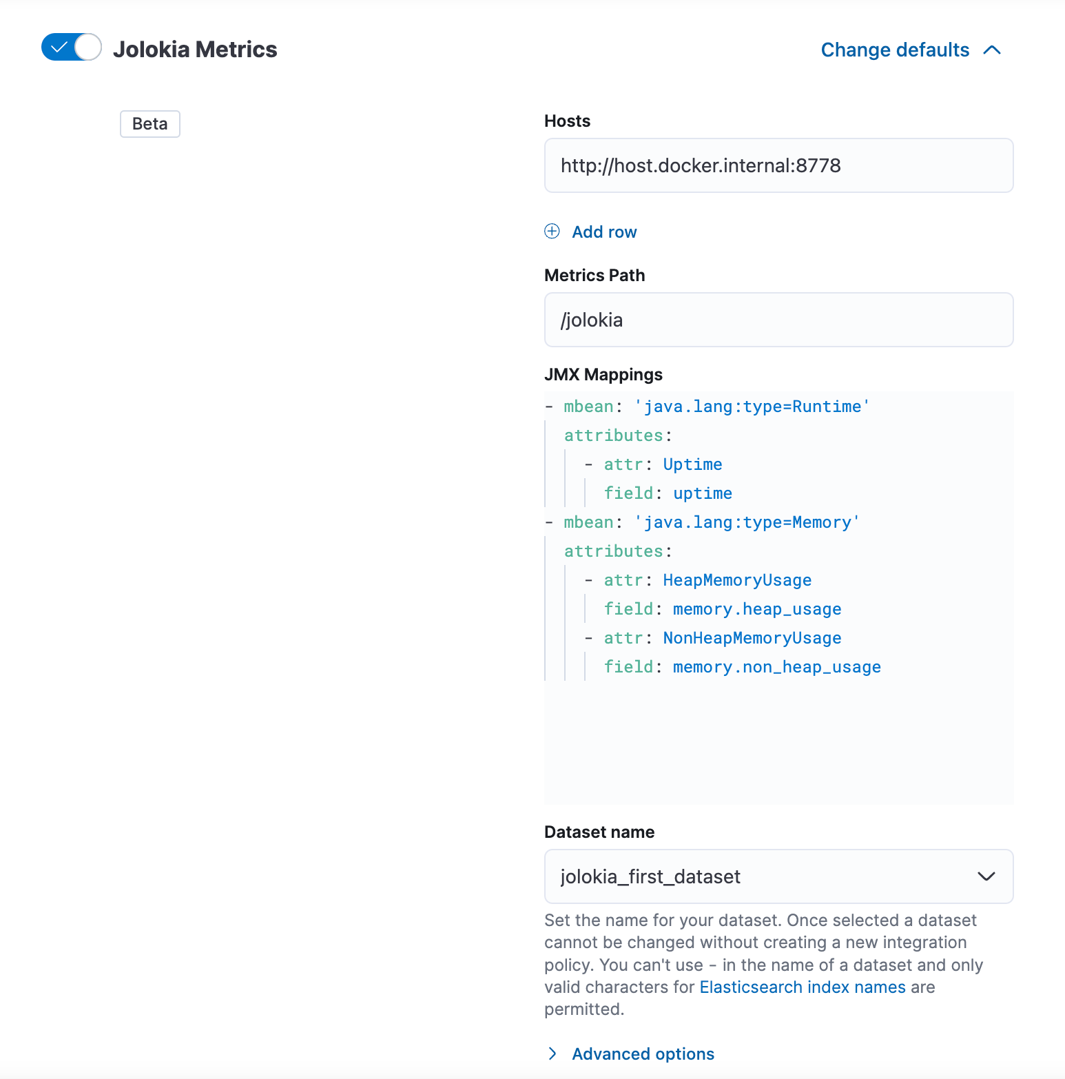

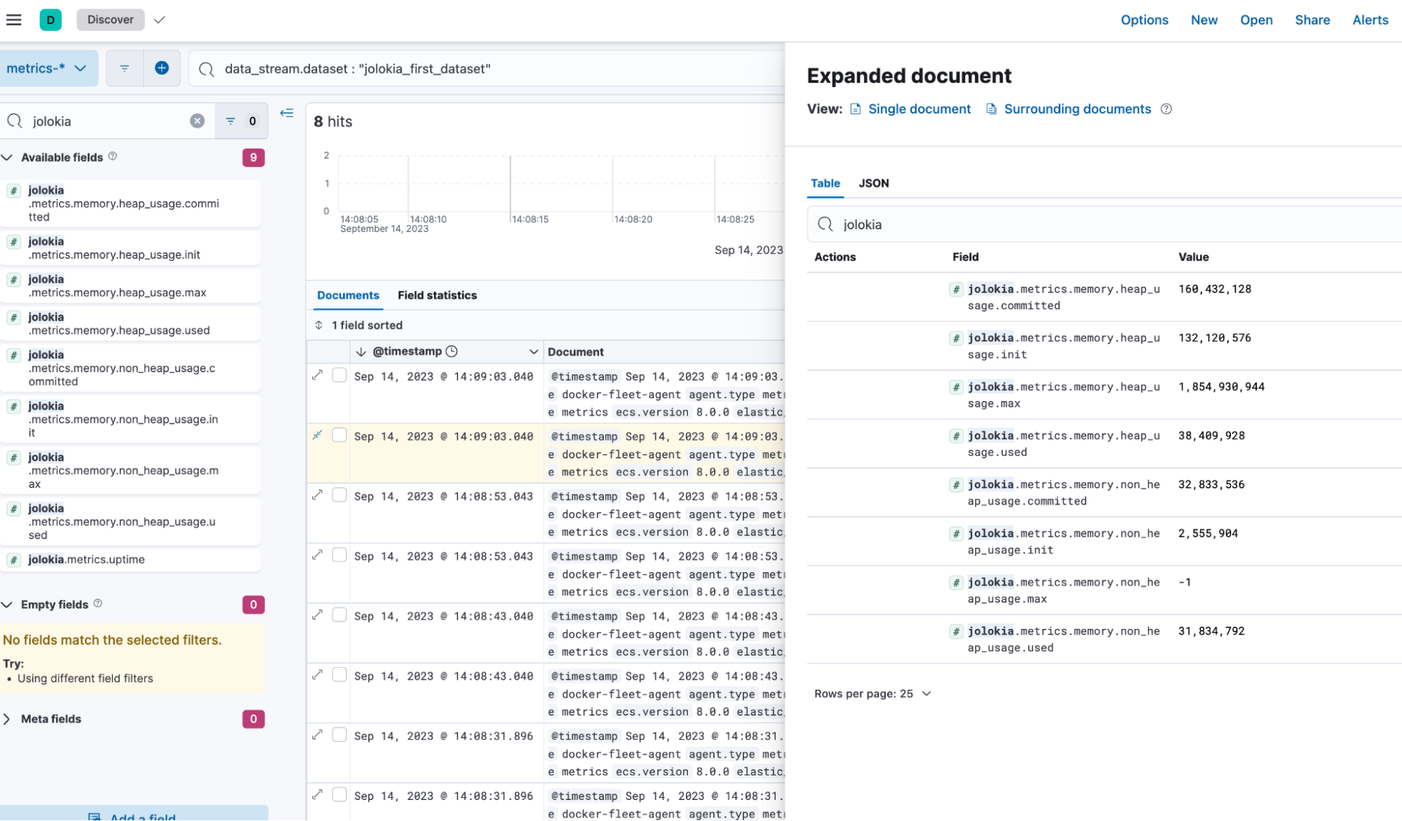

Julia can add the configuration of Jolokia input package as below, fulfilling the first requirement.
hostname, JMX Mappings for the fields you want to fetch for the JVM application, and the data set name to which the response fields would get mapped.

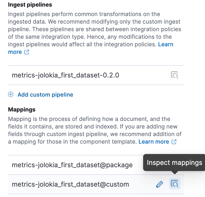

Julia can customize her data by writing her own ingest pipelines and providing her customized mappings. Also, she can then build her own bespoke dashboards, hence meeting her second requirement.

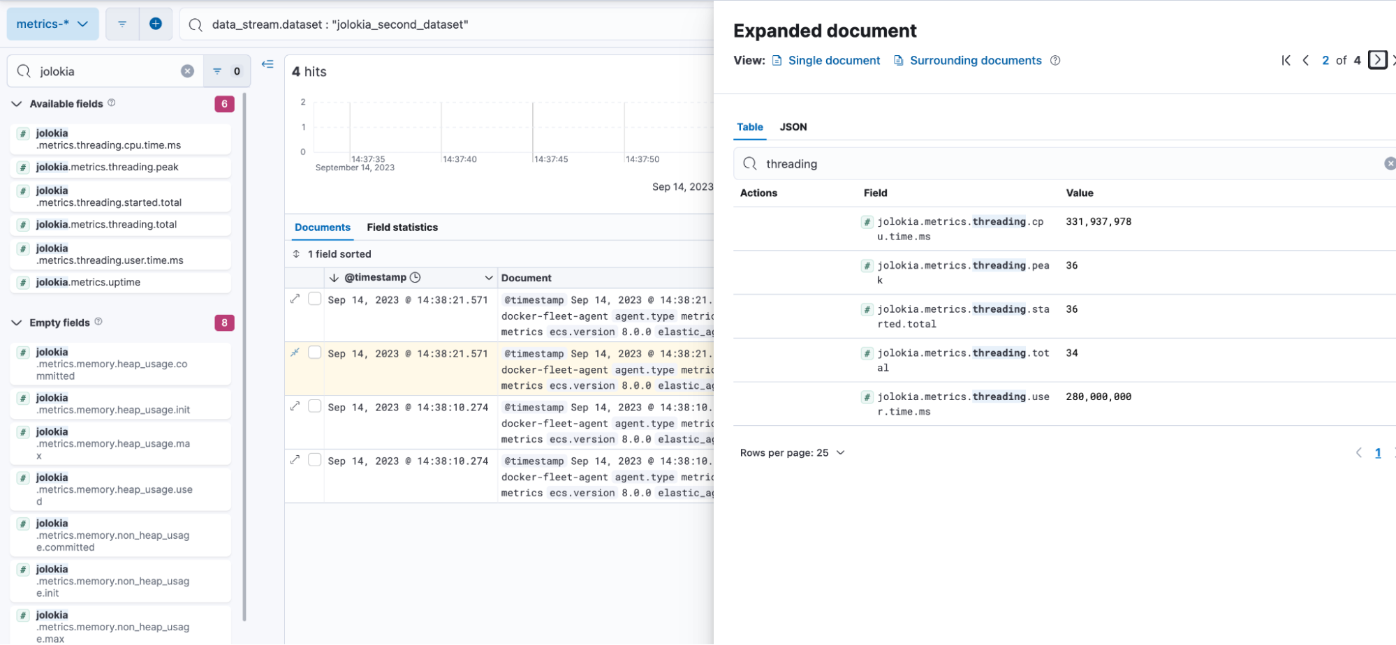

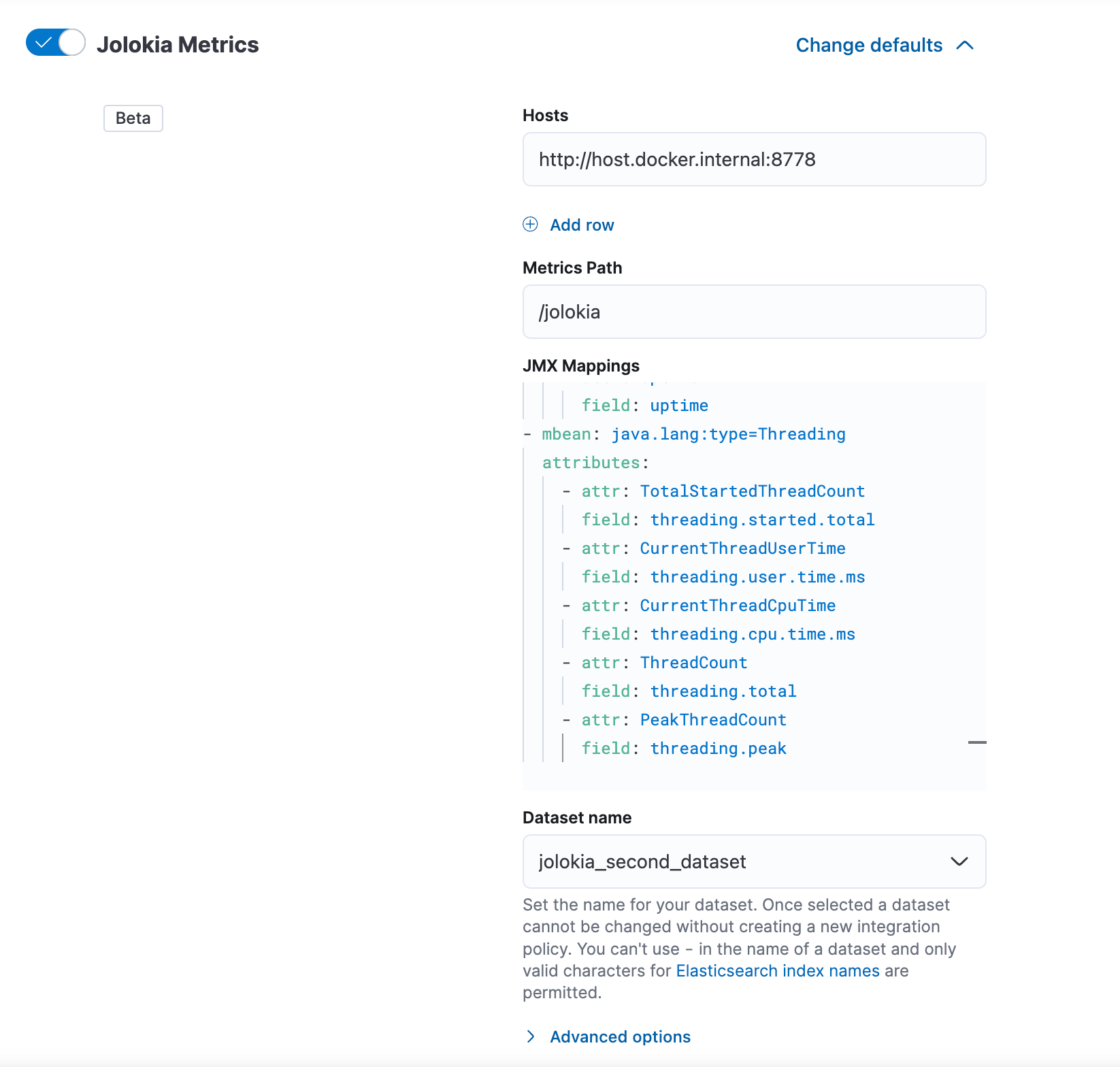

Let’s say now Julia wants to use another instance of Oracle Weblogic and get a different set of metrics.
This can be achieved by adding another instance of Jolokia input package and specifying a new data set name as shown in the screenshot below. The resultant metrics will be mapped to a different index/data set hence fulfilling her third requirement. This will help Julia to differentiate metrics coming in from two different instances of Oracle Weblogic.
The resultant metrics of the query will be indexed to the new data set, jolokia_second_dataset in the below example.
As we can see above, the Jolokia input package provides the flexibility to get new metrics by specifying different JMX Mappings, which are not supported in the default Oracle Weblogic integration (the user gets metrics from a predetermined set of JMX Mappings).
